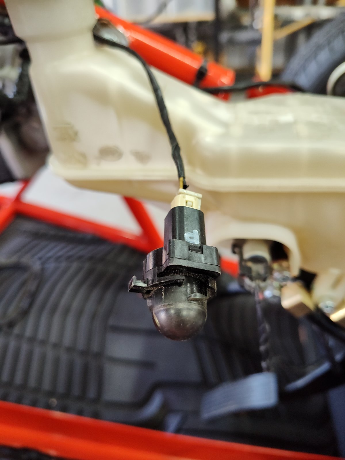

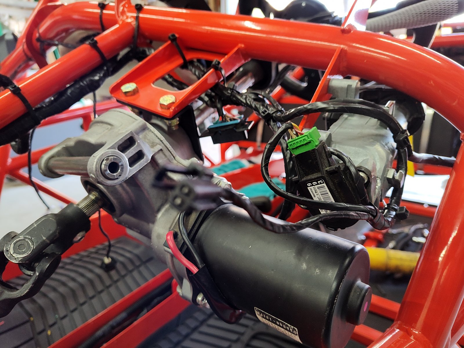

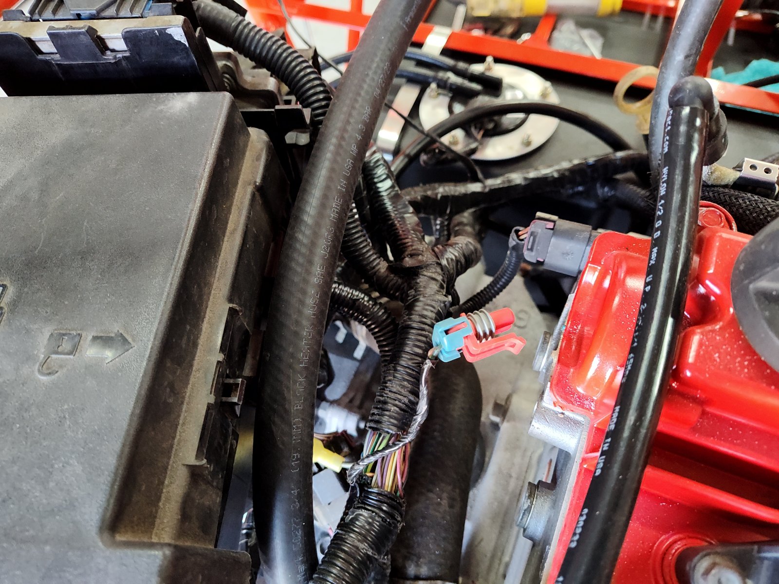

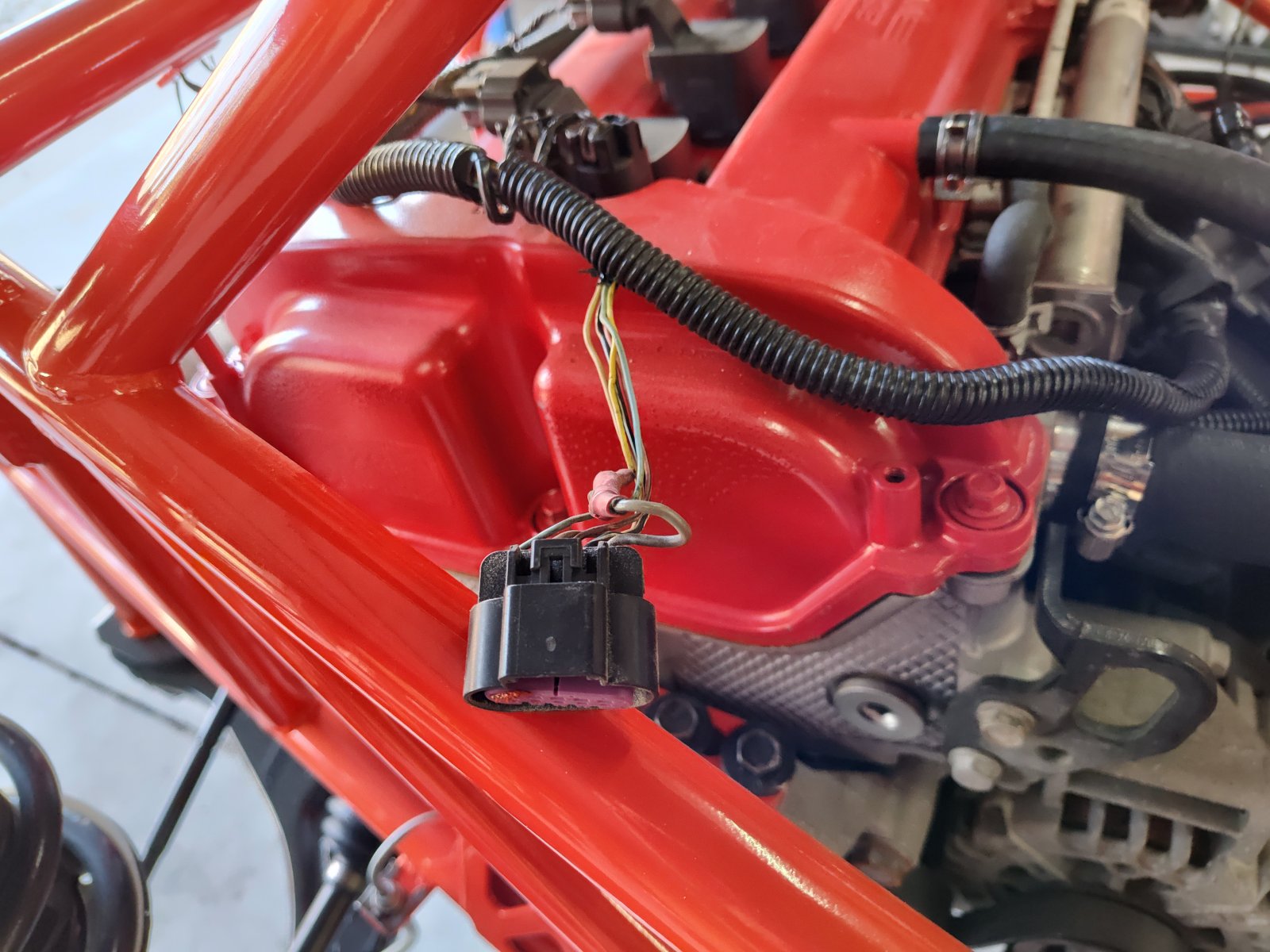

I have received the harness and have installed it. I have 4 connectors that I don't know where they go or they are not used.
Photos attached.
No 1 Looks like the Light sensor. Is that what it is and where would it mount.
No 2 and 5 are connectors that is on the engine harness they used.
No 4 is a small connector in the ignition switch wiring harness and I don't see any place to plug it in.

Pic #1 Light sensor, just make sure it is somewhere that it is always in the sunlight, it was formerly at the top of the dash near the windshield. Pic #2 is the purge valve for the charcoal cannister, an emissions item. If you are deleting emissions it is not used. #3 I am guessing, Maybe it goes to the Electric Power Steering box on the under side? #4 My guess, MAF sensor which was on the intake pipe between the filter and the throttle body? Find the original intake pipe and see if that sensor plugs in there. Your car is non-turbo/ supercharger so the MAF is in a different place than the turbo motors.
