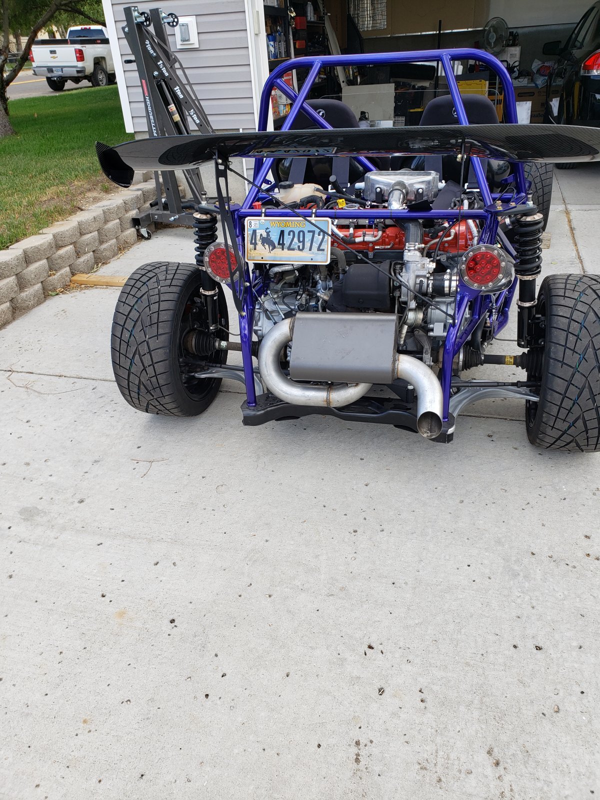

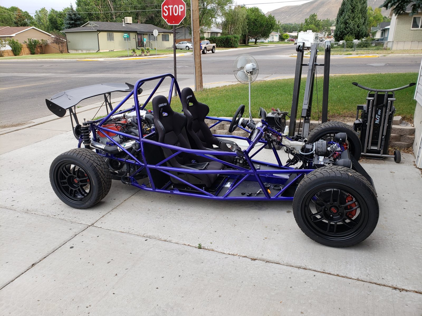

I was hoping to have my first start this weekend but ran into a problem. I dropped the ball and should of removed the fuel pump from the cobalt tank sooner. The donor had sugar in the fill tube but ran great. I pulled the pump and there is a bunch of sugar in the donor tank as well. Even though the pump does work I don't want to contaminate the goblin fuel system, so time for a new pump. So seeing as I couldn't start the car this weekend I got the headlights and tail lights on, dash button panel on and wired. Still need to tie up wires and such. The steering column is all together. Been trying to figure out if I want to run the shift cables in the tunnel or on top. I think it would be cleaner in the tunnel but worried about having too much in there and rubbing wires or the intercooler tubes. So close to registration and driving but seems to be slowing down due to small problems here and there. Still need to figure out where to put a second o2 bung and where to hook up and aftermarket boost gauge. I opted to go aftermarket with the boost gauge seeing as all I was finding for oem was as much as the aftermarket or more and not guaranteed to work either.
