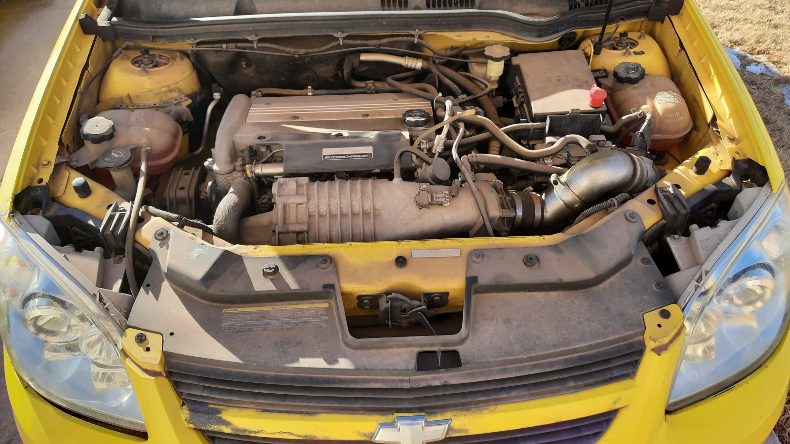

I should be getting my frame sometime this summer, which gives me plenty of time to strip down my Cobalt and do some work on the engine while I have it out on a stand. I've put parts together all kinds of ways, but this will be the first time for me doing internal engine work. My intention is to basically just shore it up. I'm planning to install new rings, gaskets all around, maybe new timing chain, definitely new bolt and tensioner for the timing as well. Also MLS head gasket and head studs from ZZP are planned. These will help if I put the Harrop back on it (I was maxing out the MAP sensor running 20 PSI boost with that on!).

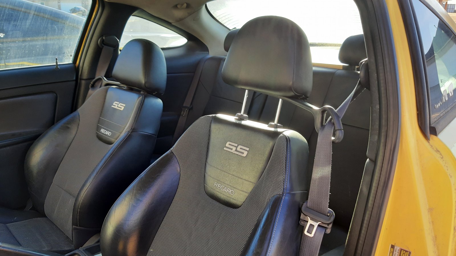

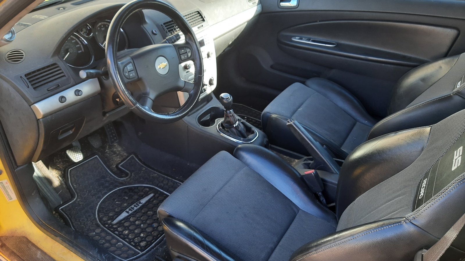

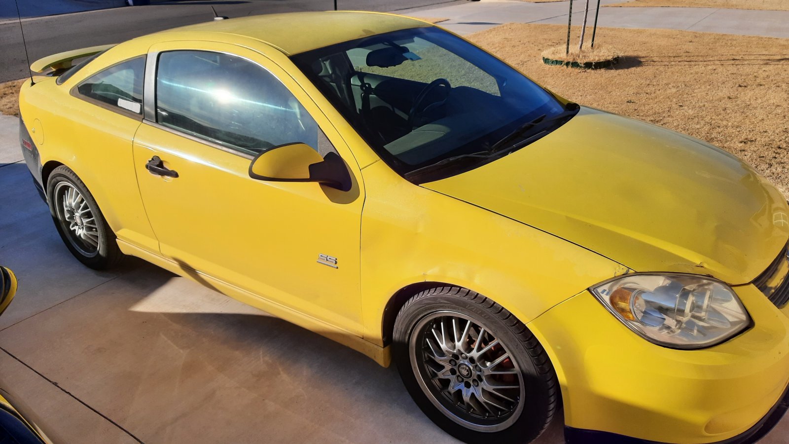

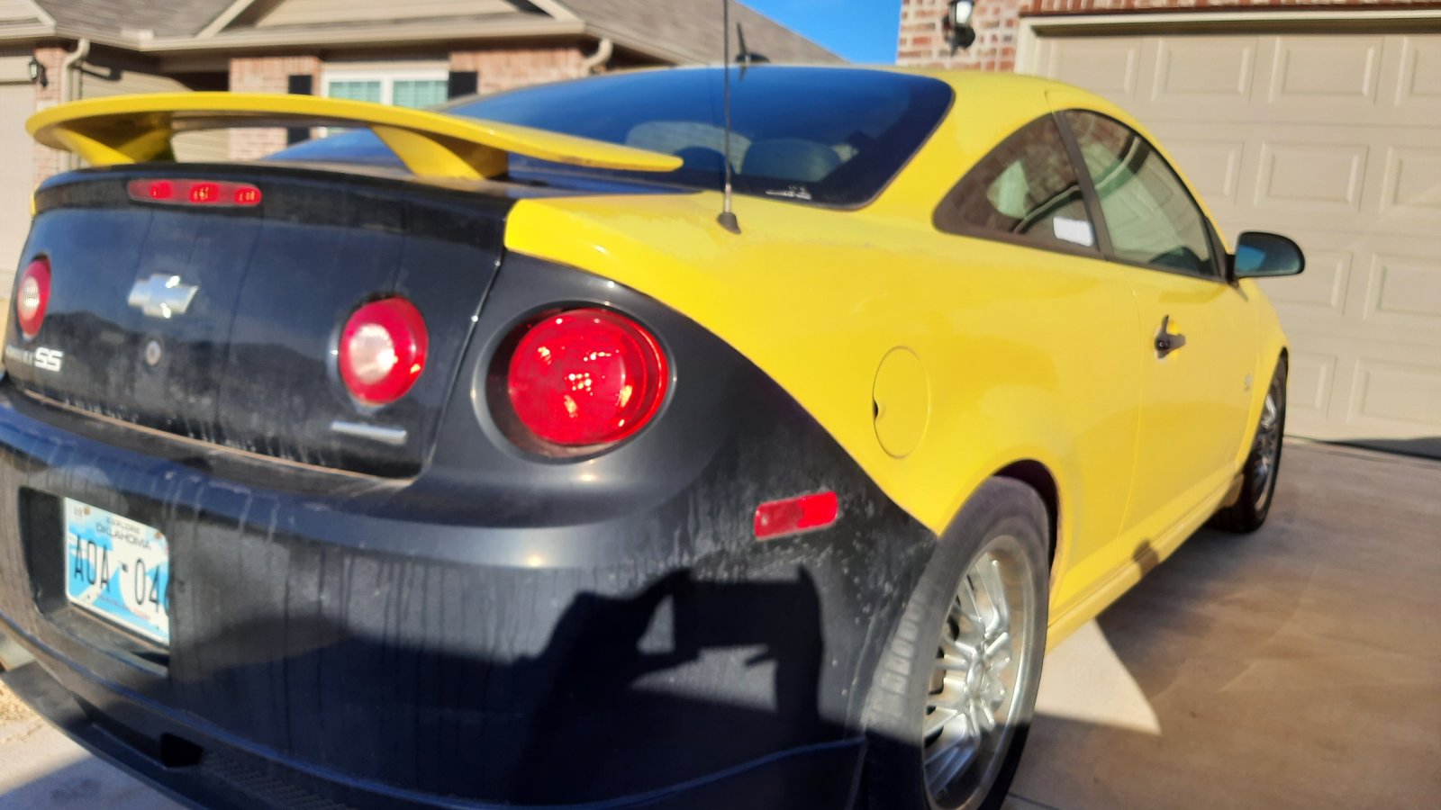

I will try to dig up some pics of the original black car, but attached are some pics of the car as of just a few days ago. The black trunk lid and rear bumper are all that remains of the exterior of the original car. I've already spent time looking through the forums and hopefully will be able to learn a lot from what everyone else has done. Maybe I can even add something to the community knowledge base myself! :) Thanks!
