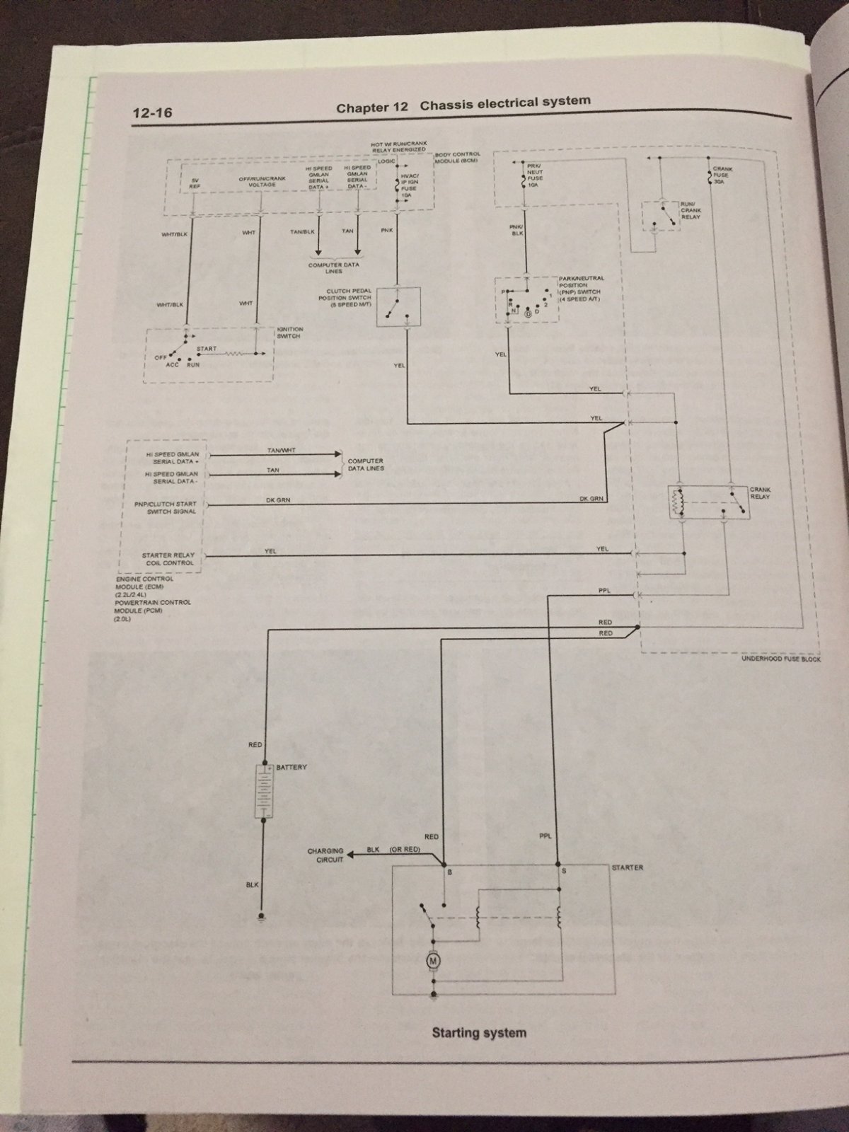

i am suspecting it MAY be the neutral switch/clutch petal switch. The switch is fine it self, tested it.
But i can beep out that the pink wire is still connected but the yellow wire i have no idea where its running (may have cut it in the process of thinning...)
any ideas on where the yellow wire goes?
Andy
This is what I found in the manual.

Seems like the conditions aren't being met because of some kind of safety relay or something like it. the transmission is mechanically in neutral position but is there something electrical looking at it?
also i mentioned above the yellow wire coming from clutch sensor...where is it going in fuse box? i may have cutting while thinning. please let me know! thanks
Youre correct insofar as there are a lot of conditions that have to be met to start. Is the little theft lock icon lit on your dash? Do you have the clutch pressed down? the reason I ask is the clutch switch is a potentiometer and it will only work when in the correct position. You can not tape the switch closed it has to be connected to the pedal and the pedal depressed.
There is no electrical switch in the transmission or shift linkage.

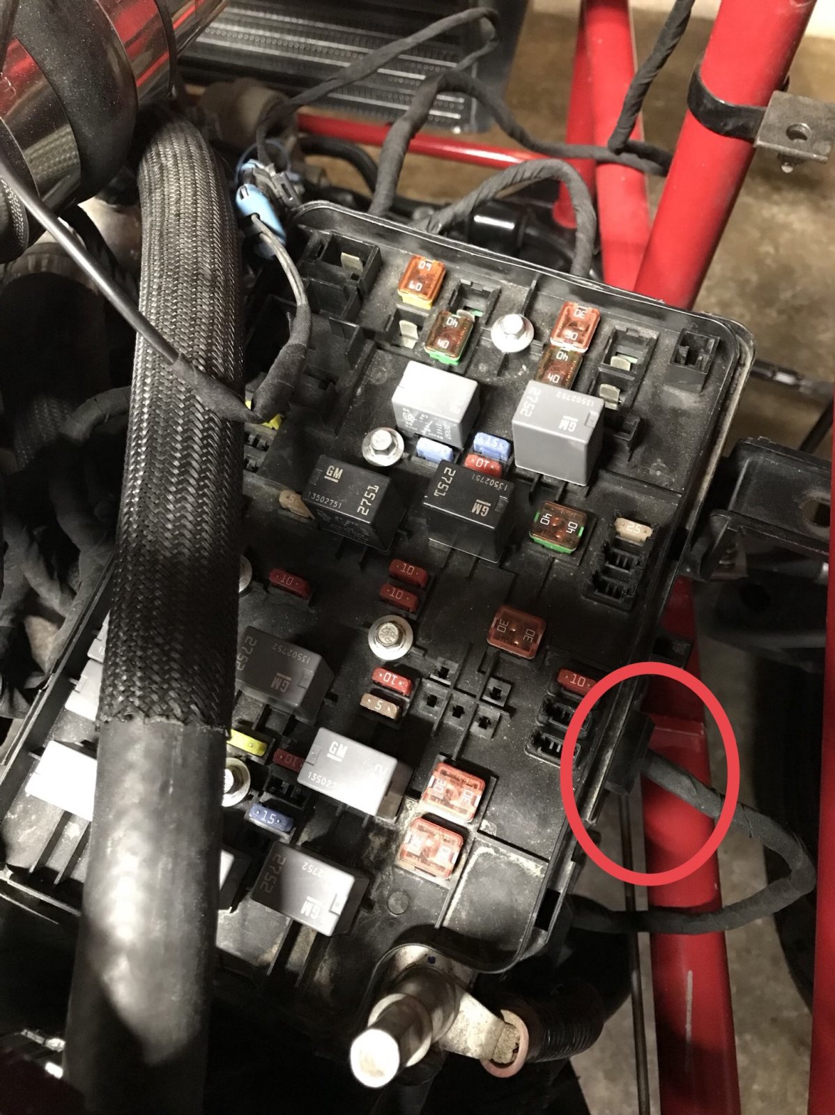

There is also a separate ground wire coming out of the fuse box that must be connected. Some people overook this one because its apart of the headlight or taillight harness.
Its been a long time I dont remember the specifics but I am willing to bet you this is a missing ground problem...

The theft Icon comes up for a second then goes away before turning the key. I’ve looked up threads about the theft protection and I don’t think it’s that. I’m still thinking it may be the clutch sensor. Andy sent me a diagram from the book so I think I’m going to try and diagnose from there. I was able to beep out the pink wire from the clutch switch and it seems ok. Still can’t find the other end of the yellow wire. That may be the culprit.
JSATX
If it goes away then it’s working correctly. The ground I was referring to comes out of the fuse box on this side. Make sure that fuse box is grounded.
It's posts like this is the reason I read every post everyday on this forum. This probably just saved me a ton of headaches. I wasn't planning on connecting this connector in the fuse box when first starting the motor. I didn't figure I needed the front headlights. Obviously we do.
Where is that ground mounted or attached? Was it just drilled to the frame. I'm currently working on all of the grounds (I didn't exactly follow the build videos on the wiring) and trying to figure out where and how I want to ground everything.
Attach it wherever you want. I attached it to a ground bolt on the engine because that was closest.
