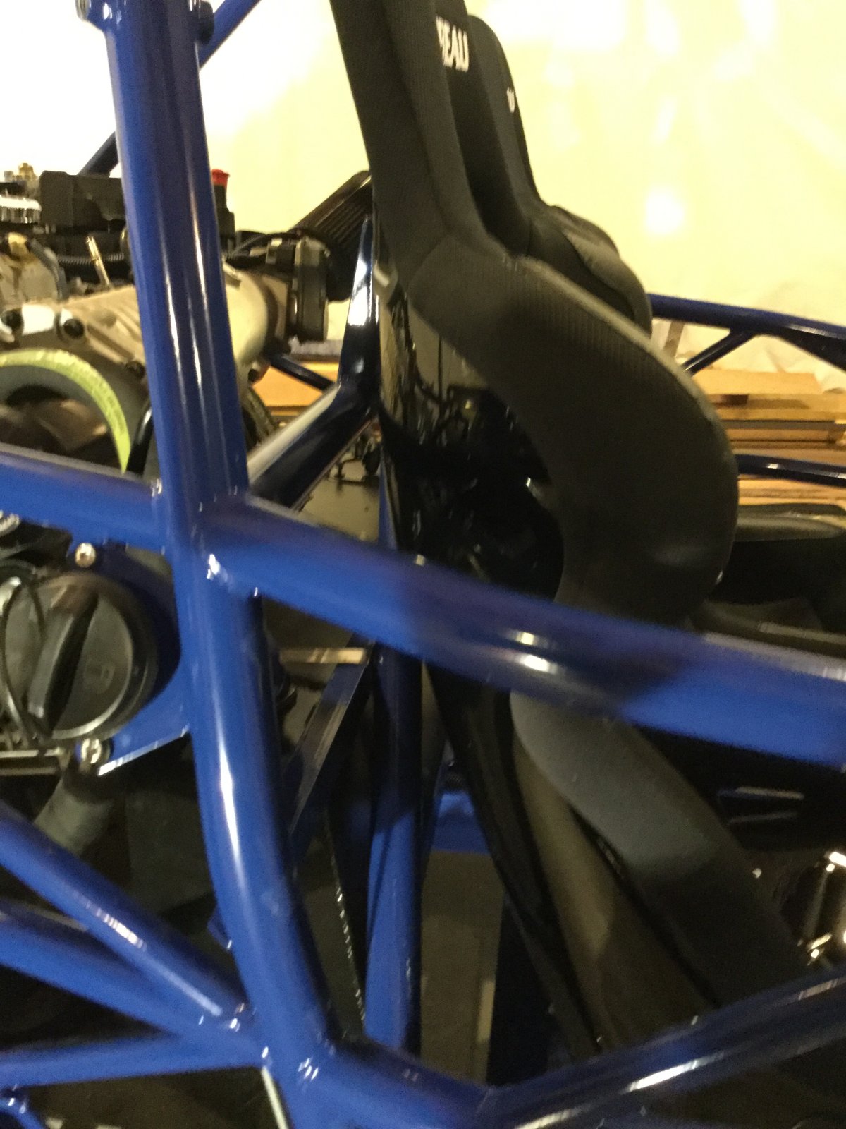

Those R100 seats are exactly the ones I plan on getting. I want some level of adjustment, do you think you'll be able to recline at all? The corbeau seats pretty much look like they are all the way back against the frame already.
BAR-AIR
Here are a couple of photos of the Corbeau seats installed. I'm 5-10 and have them set to the aft position very comfortable but the seat back is right on the rear cross member.

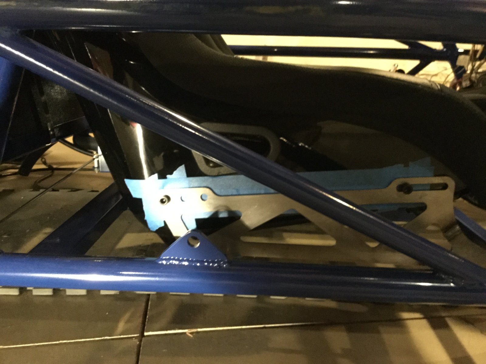

Looks like Bar-air just answered that question! The R100's do have a more traditional style bottom slide-rail mounting system. I bought universal sliders + cobalt adapters and will be test fitting them before sending the frame out for powdercoat. That way I can weld in the adapters or make adjustments as necessary.
Question for you Bar-Air, are there any other items you would mount/fab before sending out for powdercoat? I remember you mentioning this a couple times (maybe you were mounting your intercooler radiator?) I plan on mounting mine with the radiator up front. But I'd love if someone said (I wish there was a nut-sert welded right here ---------> )
