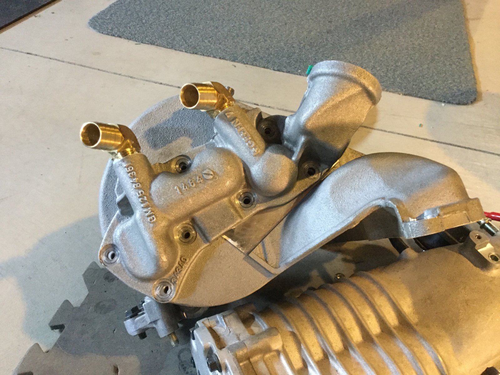

BAR-AIR
I ended up taking out the nipples. Drill and tapping 1/2" NPT and put brass 90's in only issue, you have to kind of guesss the routing direction of the hoses. Plus if you do have a leak the whole supercharger has to come off to turn those fittings.

BAR-AIR
I'm not going with the dual bypass. So this is a different application but here is the stock supercharger bypass with the nipples removed and brass threaded 90 degree elbows replacing them. Gave me a lot more room to work with between the hoses and the gas tank.
