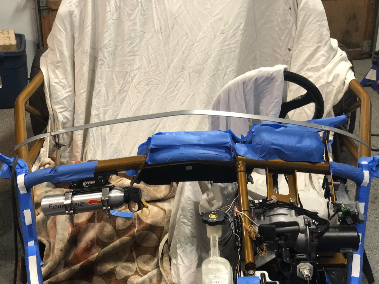

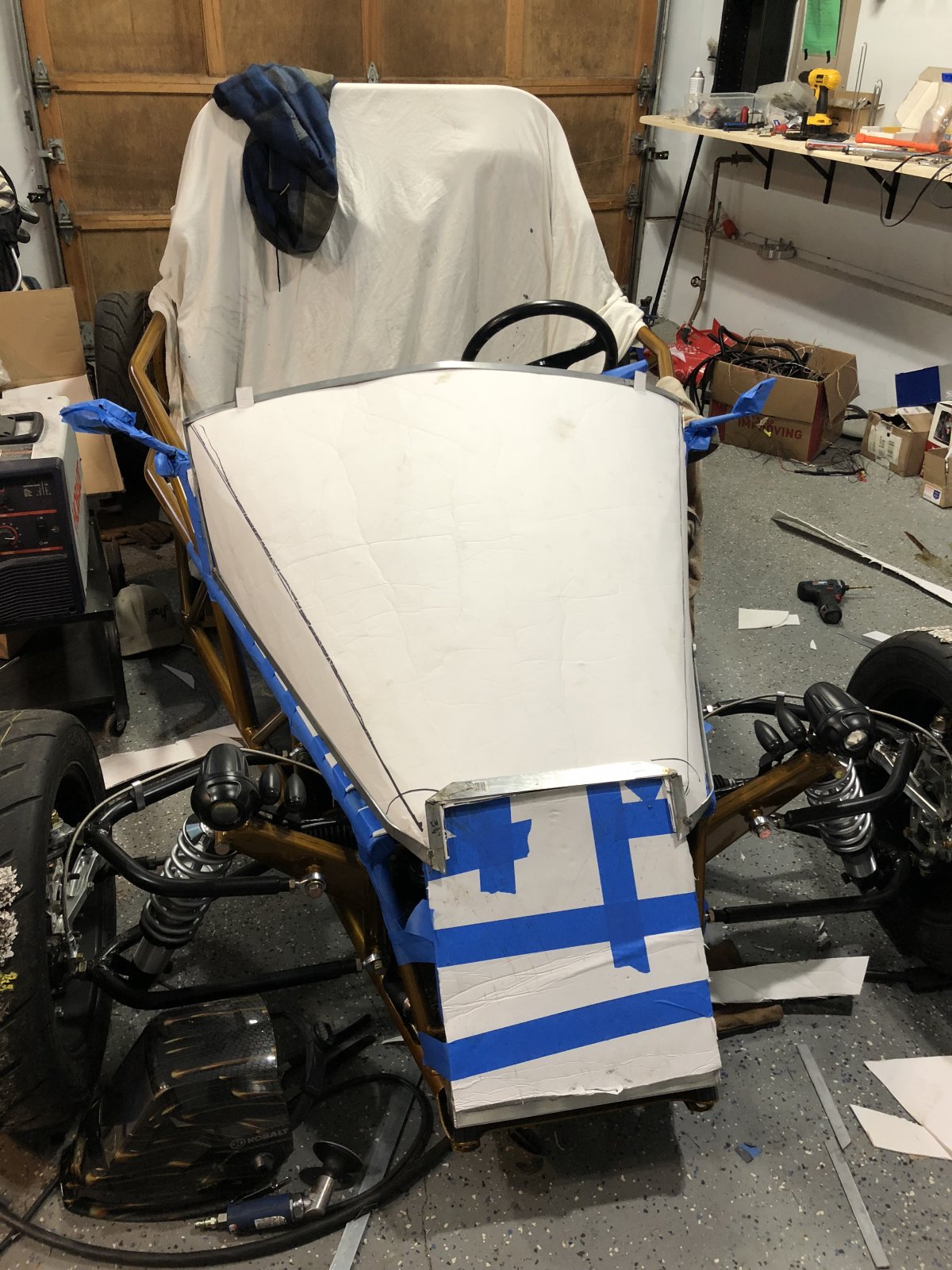

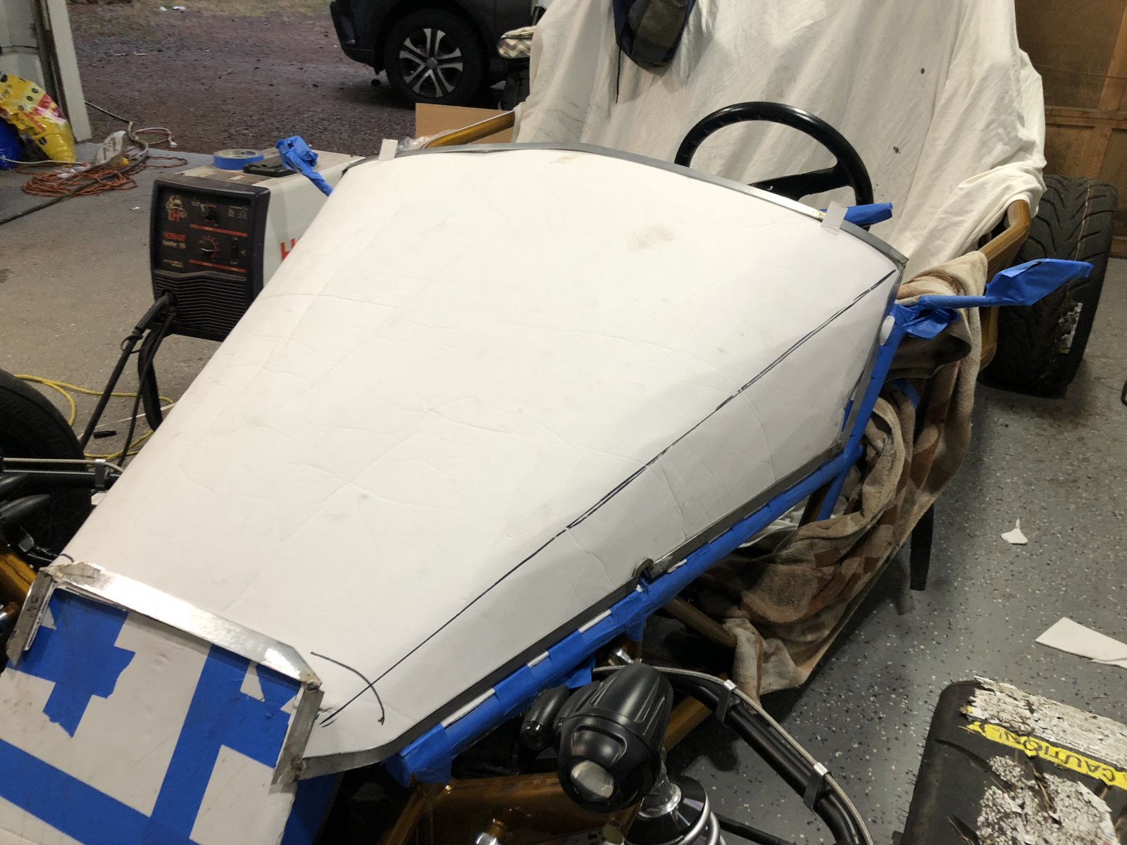

Started making a fiberglass hood this week. The plan is to make a small hood that hinges up for access, and doesn’t cover the frame tubes (except for the cowl/hinge piece). Also needs to be sturdy enough to mount a lexan windshield to at some point. Not going to include a nose cone. Gonna use hood pins to attach at the front.
Started by welding up a steel frame with attached hinge points. Then shaped a huge piece of 1/4” foam board into a 1 piece form and glued it to the frame.
Next step will be applying a release layer. I’ve used aluminum foil before, but might try something different.
I also need to find some suitable fleece for the stretch layer.

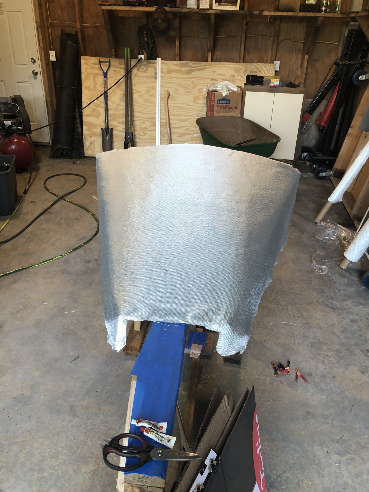

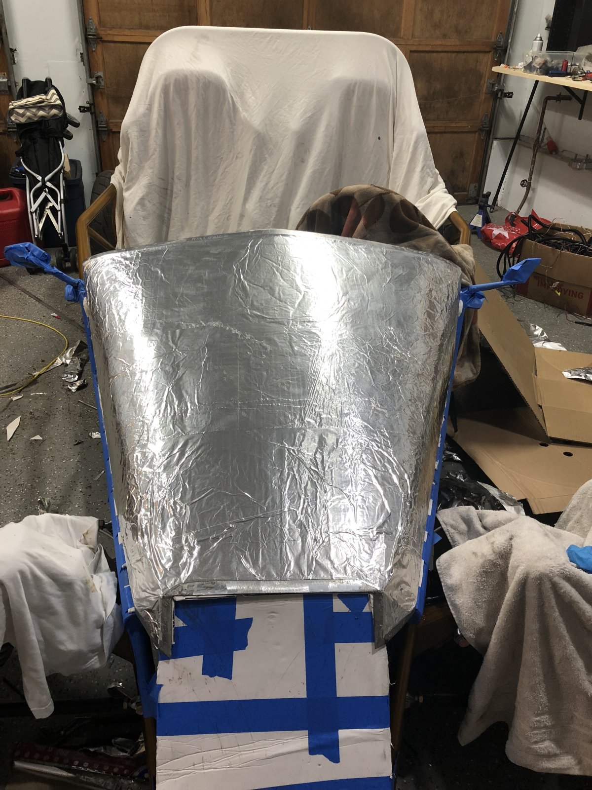

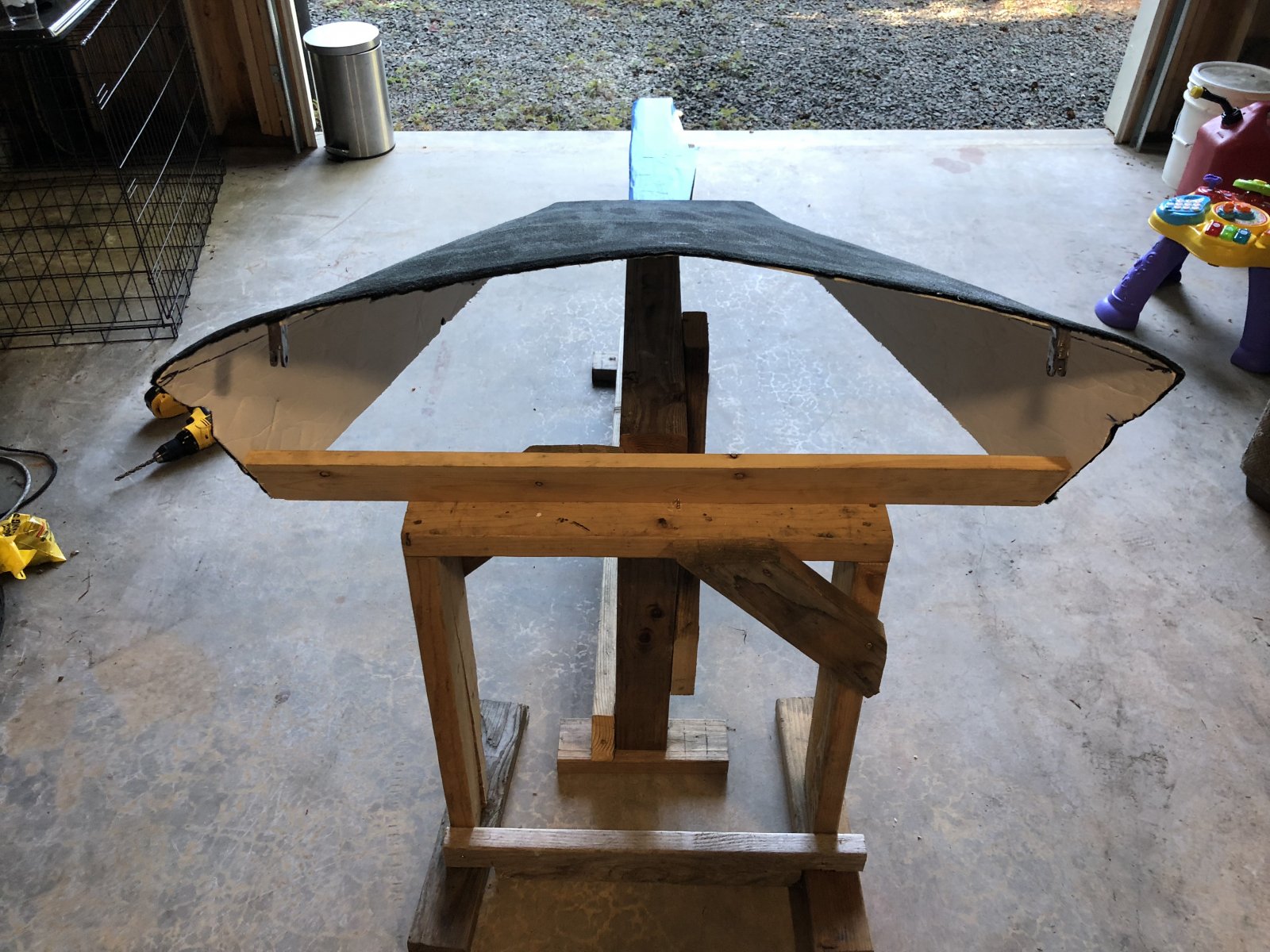

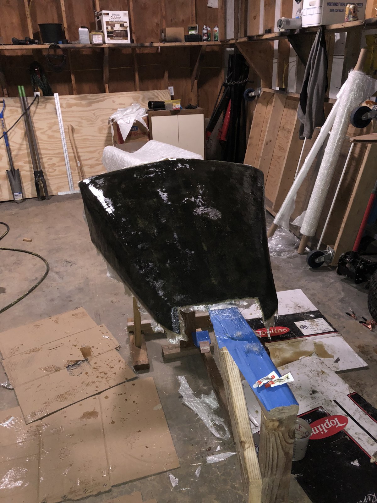

I finally sourced some 50” roll fiberglass cloth locally, and currently have 3 top layers done. Ready to pull the foam out the back and do 2 layers on the underside before bodywork:
Used aluminum foil for release:

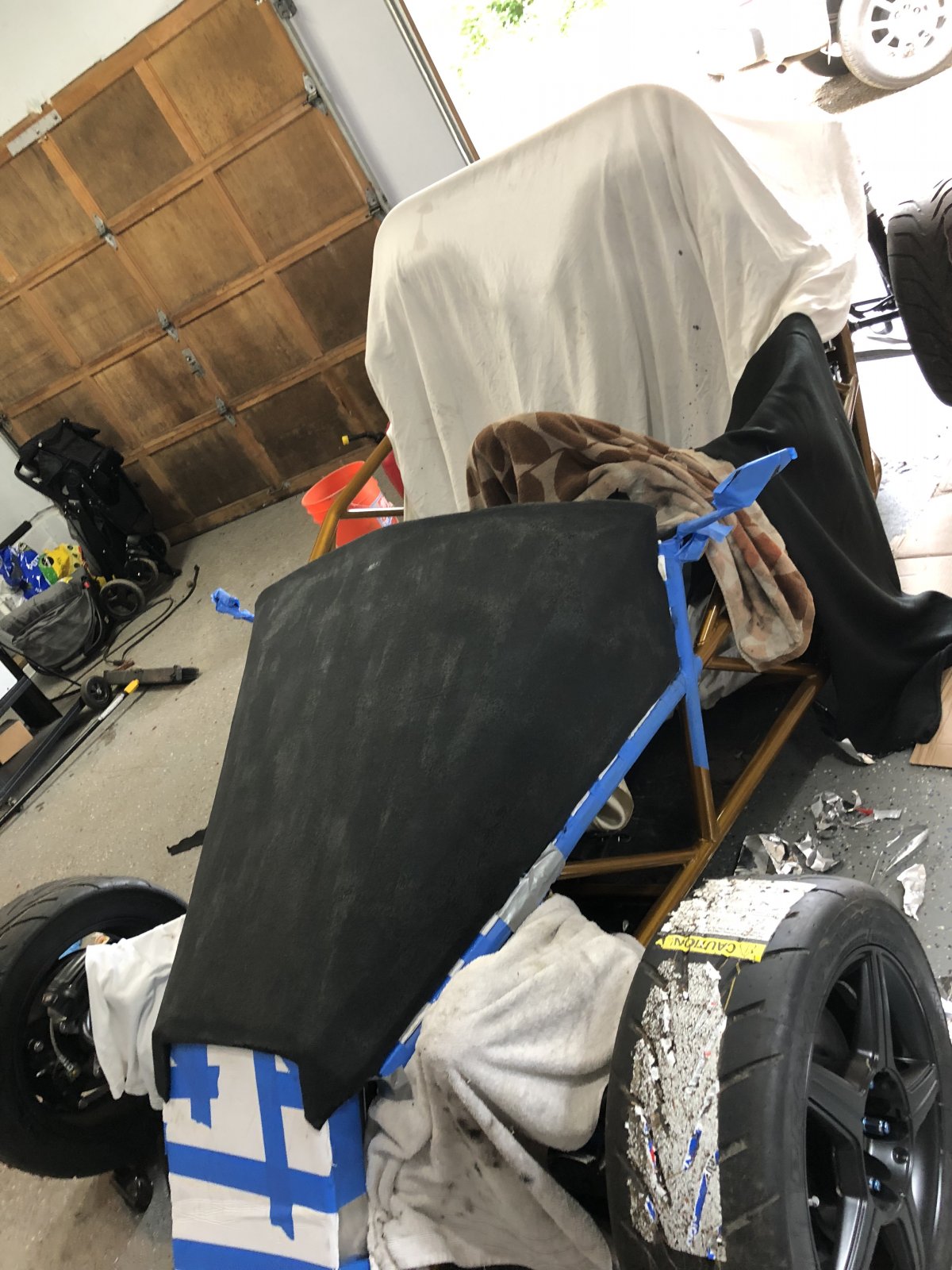

Contoured some with duct tape, then stretched and glued the thinnest fleece I could find

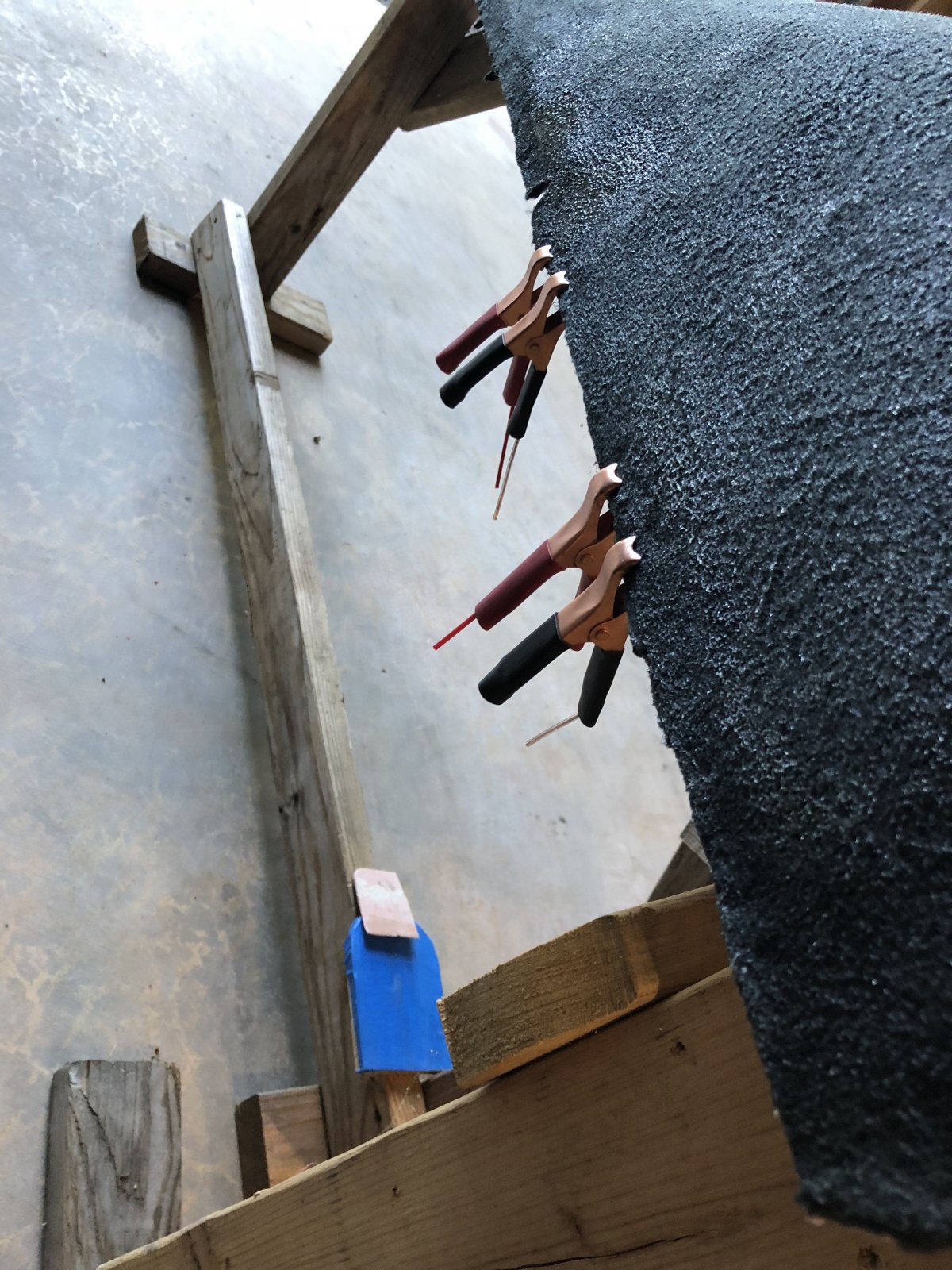

Wetted that out, attached to sawhorses to keep its shape while glassing. Some edges were popping, so epoxied and clamped down
First layer of glass, dry then wetted
