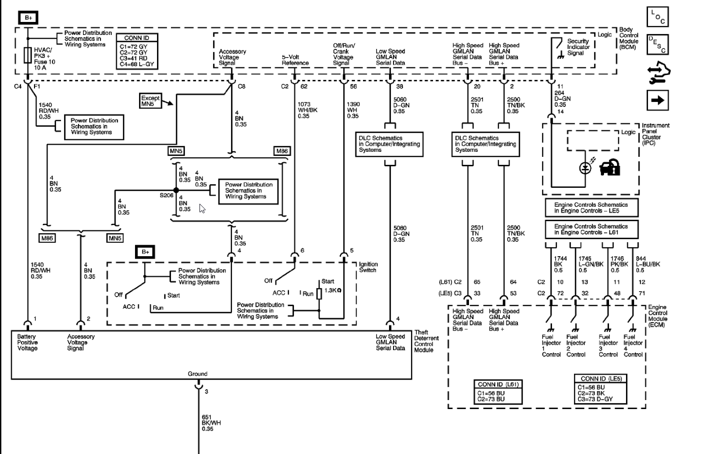

If it is a data wire issue how might I go about testing.
40277
I know the data wire coming out of the alarm module is number 4
40278
And then it seems to go to pin 38 on the bcm,
That is the extent of my knowledge currently but I will keep looking around for more info and do some more testing.

From my understanding pin 1 which is low-speed GMLAN is the one that connects to the anti-theft and its reading close to zero so that seems to be an issue.
Edit: Have been researching a little and figured out that the low-speed GMLAN should be 5V
Pin 1 voltage at 0.3v might be a problem, although trying to check with a volt meter can be difficult. The voltage you are reading is an average, and the circuit voltage will depend on the activity of the modules, which there aren't a lot of on a Goblin.
Check your supply voltages and ground on the TDM.

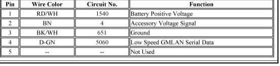

Went through the voltages and the grounds of the TDM. Pin 1 got 12 Volts, pin 2 which is accessory power had no volts, pin 3 no volts which would make sense because it is ground to ground. Pin 4 which is low speed GMLAN was fluctuating between 0 and .3 volts.
I am measuring these with the connector unplugged as there is not a way to get to the cables with it plugged in.
Did you confirm continuity to ground on pin 3, not voltage? Although if it wasn't grounded, you would have seen voltage there.
Hard to tell from the diagram above if you are supposed to get voltage at pin 2, but I think so. Need to check the power distribution schematics to confirm.
K
Yes there is continuity to ground from pin 3. The only one that does not get ground is pin 4.
Edit: I think the schematic above shows that pin 2 should get voltage.
K
Ok went through and checked the voltage on the BCM and it looks like C8 on BCM C4 (c4 is which multi plug not a pin) is getting no voltage, on top of that I went through every other BCM connection and on BCM C4 pin D1 had no voltage. D1 is listed as a battery-positive voltage. On BCM C3 pin B5 which is listed as acessory voltage is also not getting any power.
