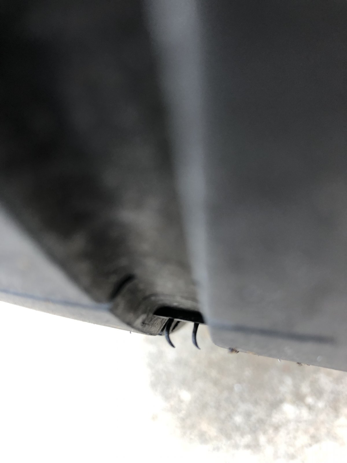

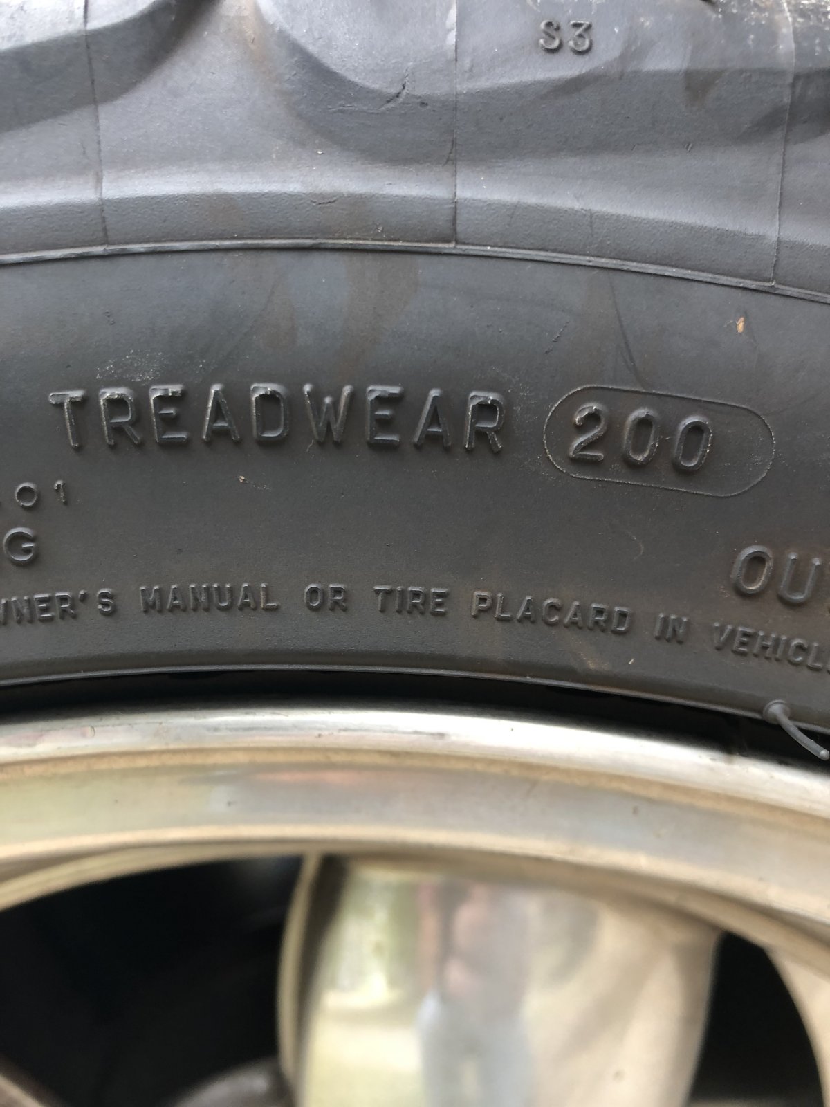

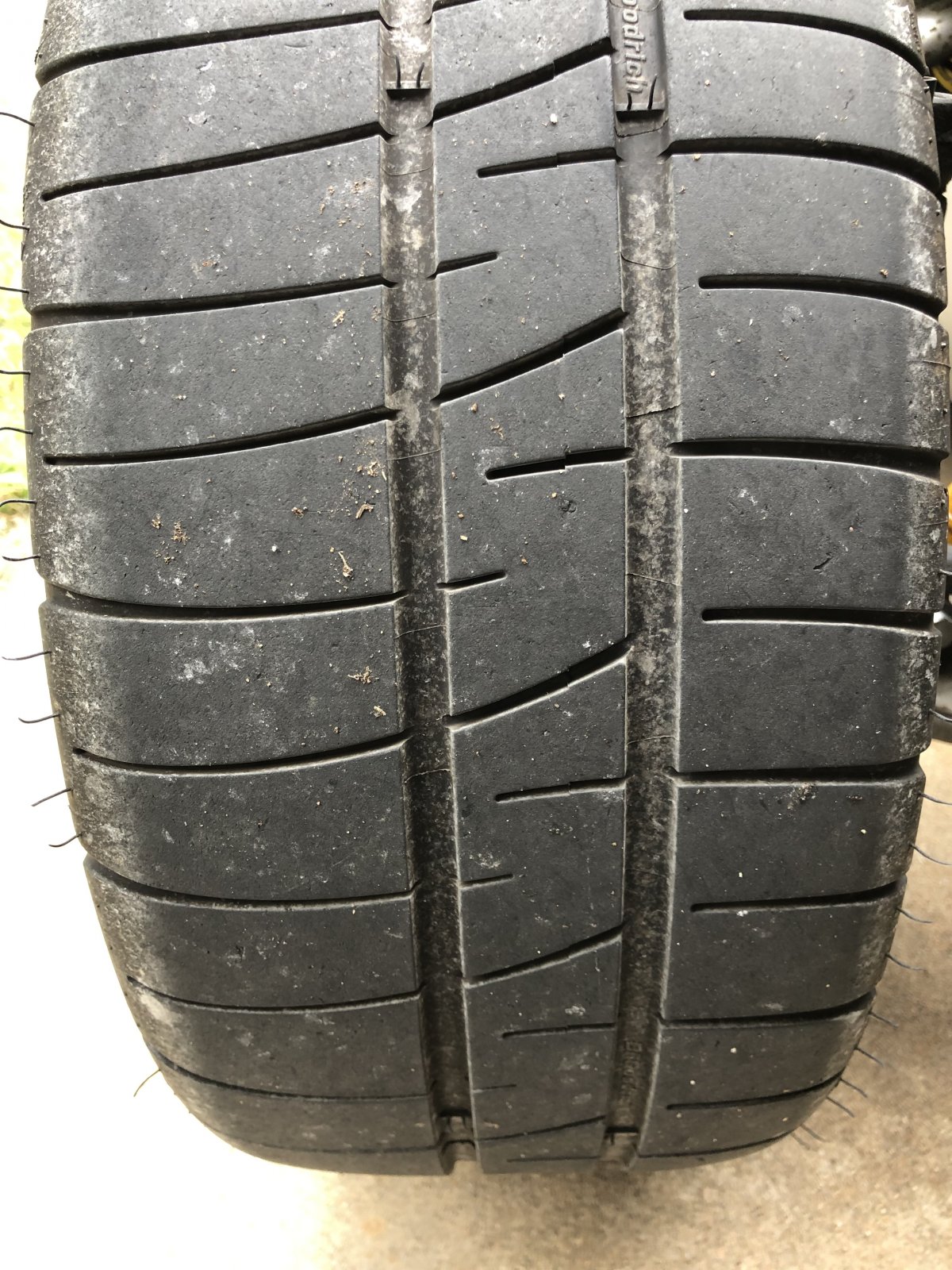

Dale
These tires are on my Stalker and are three years old now. They have a few autocross runs, drives in the Georgia, Carolina, Tennessee roads and tail of the dragon. They have been to 3 seven/Goblin meetups.
Toe is 1/16 - 1/8, camber .5ish, 20 pounds street and 24 - 26 pounds autocross. I don't know how you all Goblin folks are wearing out tires so quickly! Just an old guy still trying to learn!
