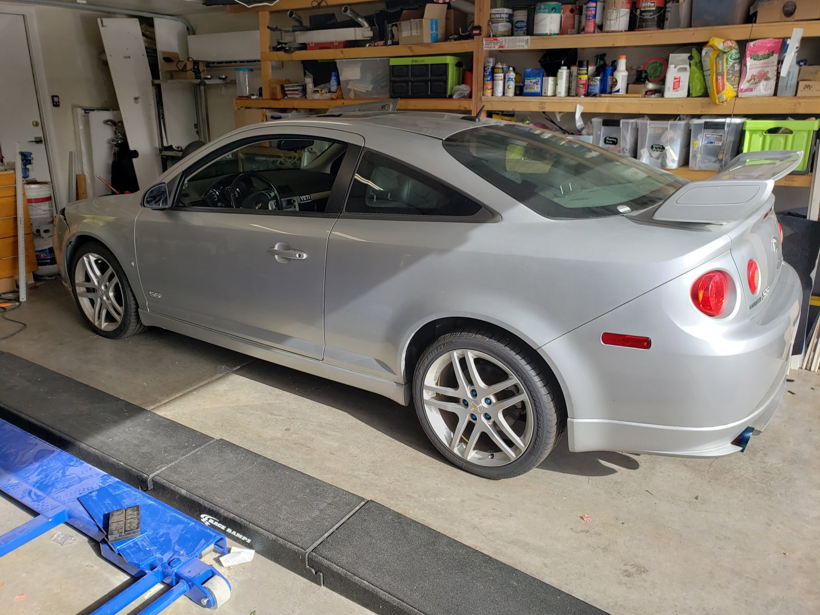

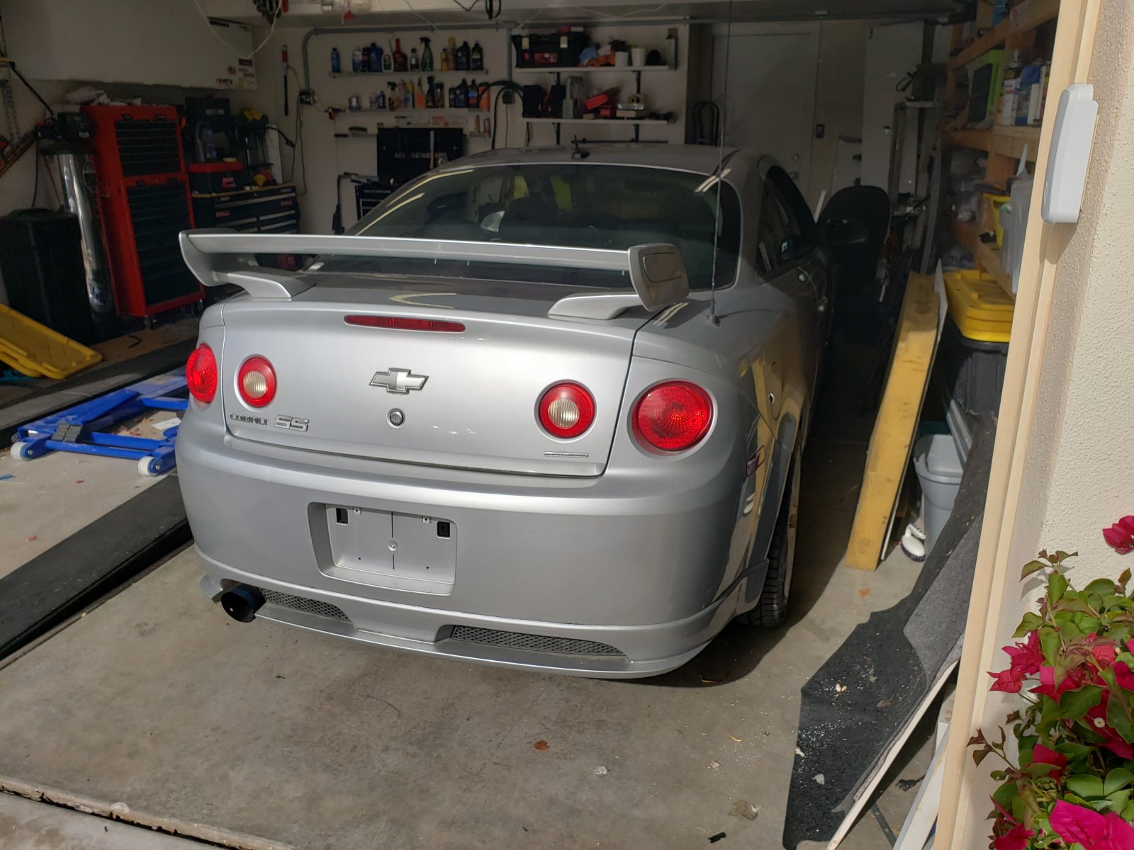

Donor is in. It's a 2009 Cobalt SS with 67K miles. Paid a bit of a premium for it but hopefully I'll be able to recoup some of the cost as the body and interior are in very good shape. It's a Florida car and there is a fair bit of surface corrosion on all of the exposed metal parts. It doesn't look like it should be too difficult to clean off.

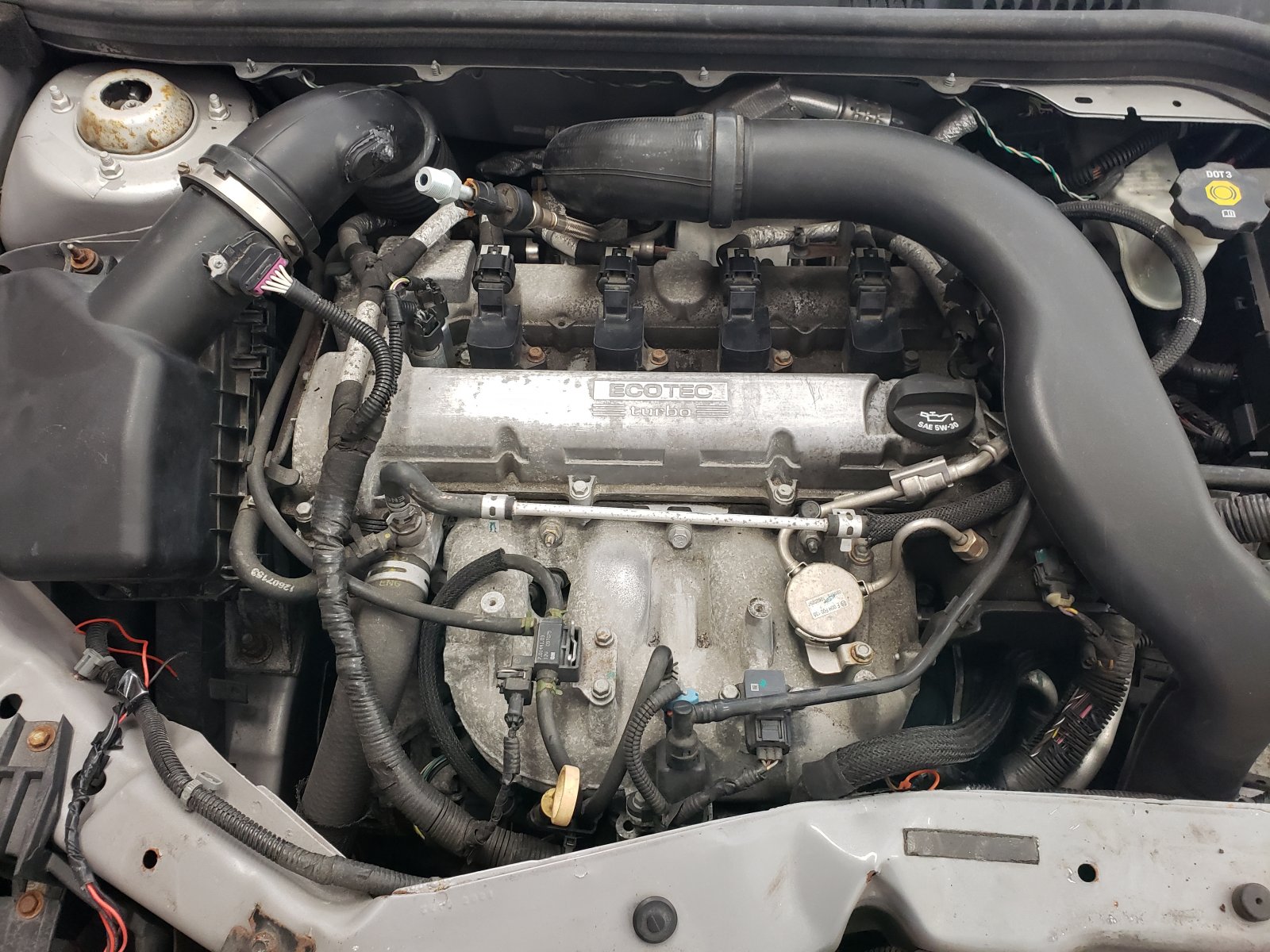

The donor was delivered with no coolant as the radiator was leaking in a couple of places. I got that fixed and the radiator reinstalled. Also repaired the PCV connection at the intake. Started the car up and brought it up to temp.
Only one code: P2187 -> System too lean at idle. Gauge shows 18 in/Hg. My Solstice GXP with the same engine was around 28 at idle so it appears that I have a vacuum leak. I sprayed carb cleaner along the intake path after the intercooler and the idle jumped up to a smooth 1500 rpm and stayed there. I'm pretty satisfied with that. I'm not going to chase down an intake leak on a car that has been in a front end collision.

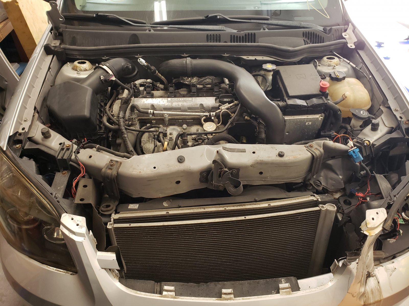

Next up I want to perform a compression test and get HPTuners up and running.
Anything else I should check before tearing everything apart?
Did you already check the drivetrain? Take it out for a test drive. Does it shift well? Any suspension issues? How does the oil look? Oh, and does the stereo rock? Wait, that is my inner kid.
AZmoto
After they pulled it off of the carrier I drove it to the end of the street and back and then into the garage. First, second and reverse worked fine. I didn't notice any problems.

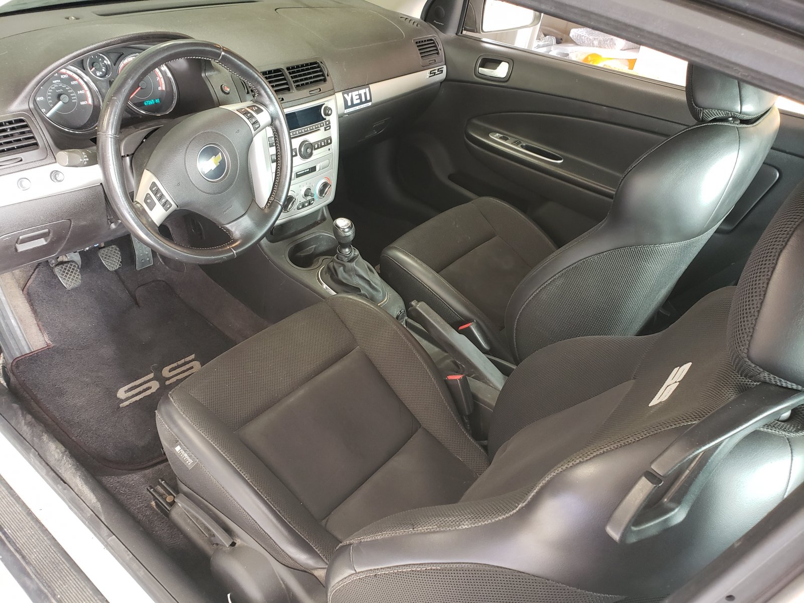

The LNF Cobalts did not have a Recaro option. Those are the stock SS seats. They're quite nice, I'd probably have re-used mine if one guy had not bought every piece of my donor's interior for his girlfriend's LS->SS conversion.

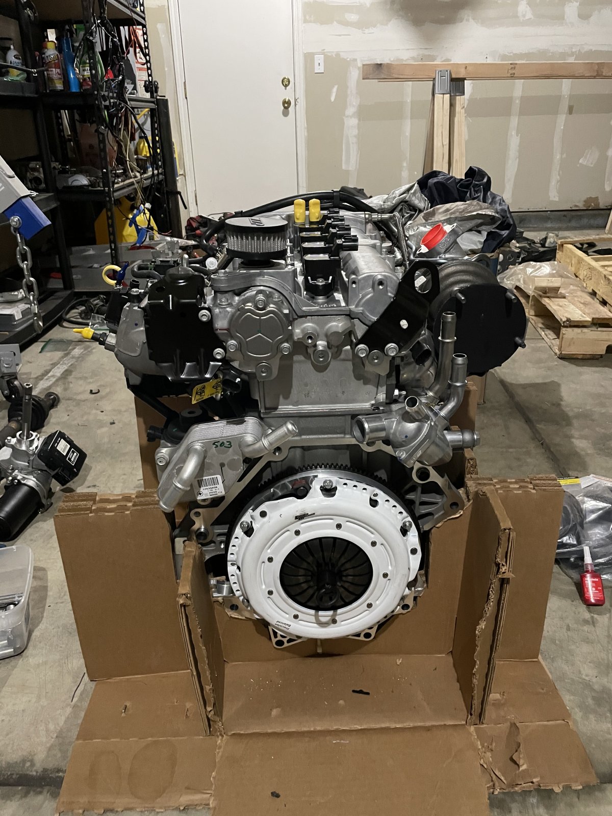

Well I bit the bullet and just ordered a new ATK longblock.
I figure a 67k mile longblock should be be able to recoup almost half of the cost. After seeing Desert Sasquatch's new ATK motor it's just too good of a deal to pass up.
It is tempting... but I would need to buy a ECU & harness. Maybe a gauge cluster too.
A stand alone ECU, cluster & harness will cost as much as the engine!
