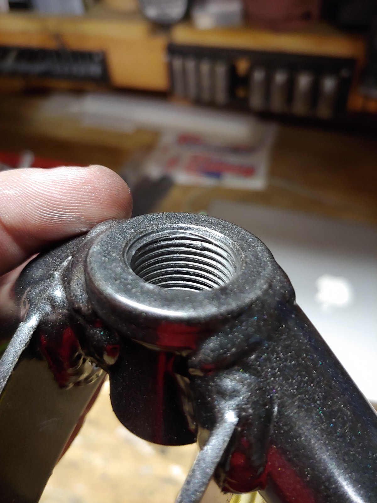

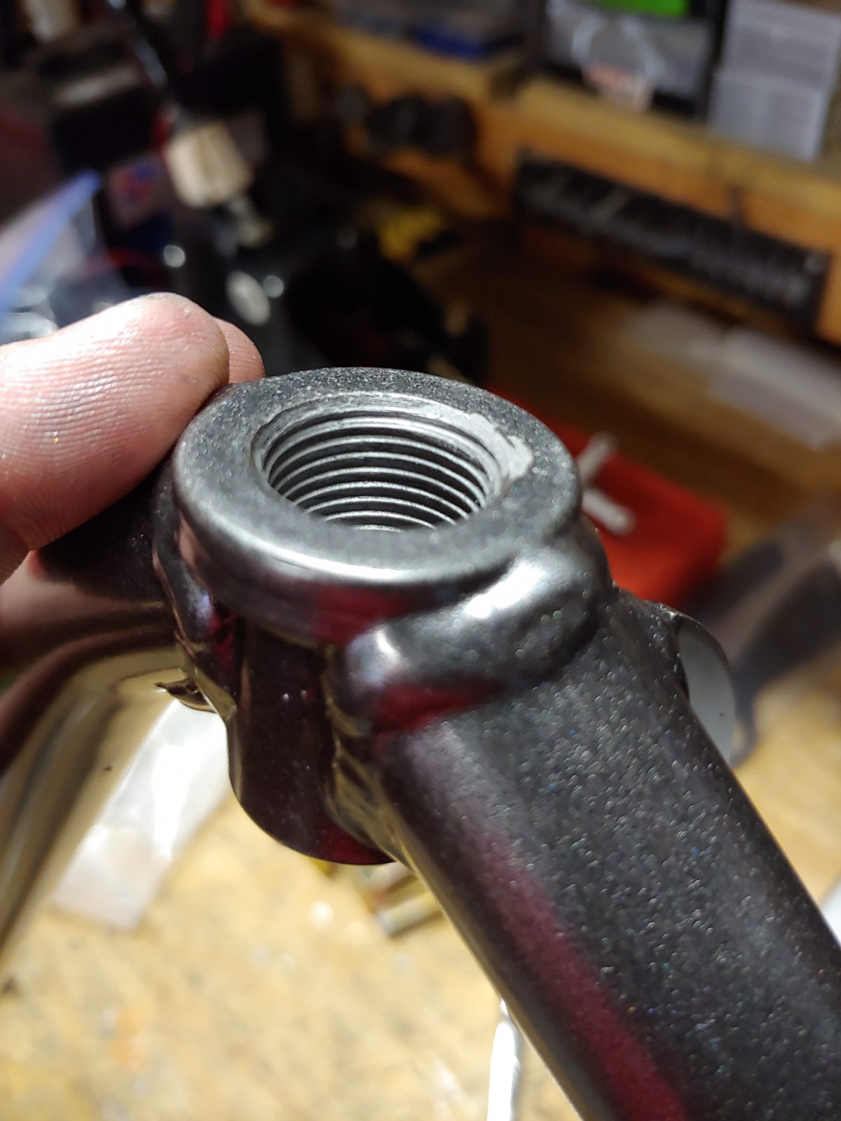

I'm working on the front suspension and I'm running into issues getting the larger rod ends into the control arms. No issues threading in the 1/2" and 3/4" rod ends for the upper control arms. Are the lower control arm 3/4" holes supposed to be left hand threaded? It's hard to capture the thread direction on pictures but each time I hand start the rod ends, they start to walk off straight and don't even make it 1.5 turns before full stop. I'm hesitant to put a wrench since the upper control arms assembled easily. I have 4 right hand threaded 3/4" rod ends.
10309
This image shows where the right hand thread of the rod end was trying to cut threads in.
10310
If I hold the control arm up and visually follow the thread pattern, I have to turn the piece clockwise in my hands to go inward (same things as saying I'd have to walk around it counterclockwise if it was held still on the floor. I don't have any left hand thread rod ends in my kit, and don't have any random bolts in my garage to test my theory.
Those are all right hand threads. Your last picture shows a bit of cross threading on the first thread. Can you run a bolt thru from the backside, to help align the threads?
We were sent a batch of left hand threaded bungs and decided to order left handed rod ends and jam nuts and just use them for our in-house builds.
We thought we had caught all of them before they got out but obviously we did not.
We can either send you a different lower control arm set or send you left hand hardware. It's totally up to you. Functionally the control arms are the same just let us know.

Since my control arms are powder coated already, the left hand hardware would be perfect. I only caused 1 level of cross threading since I tried it gently to see if it was a paint buildup. Pretty sure the left hand hardware would still thread nicely.

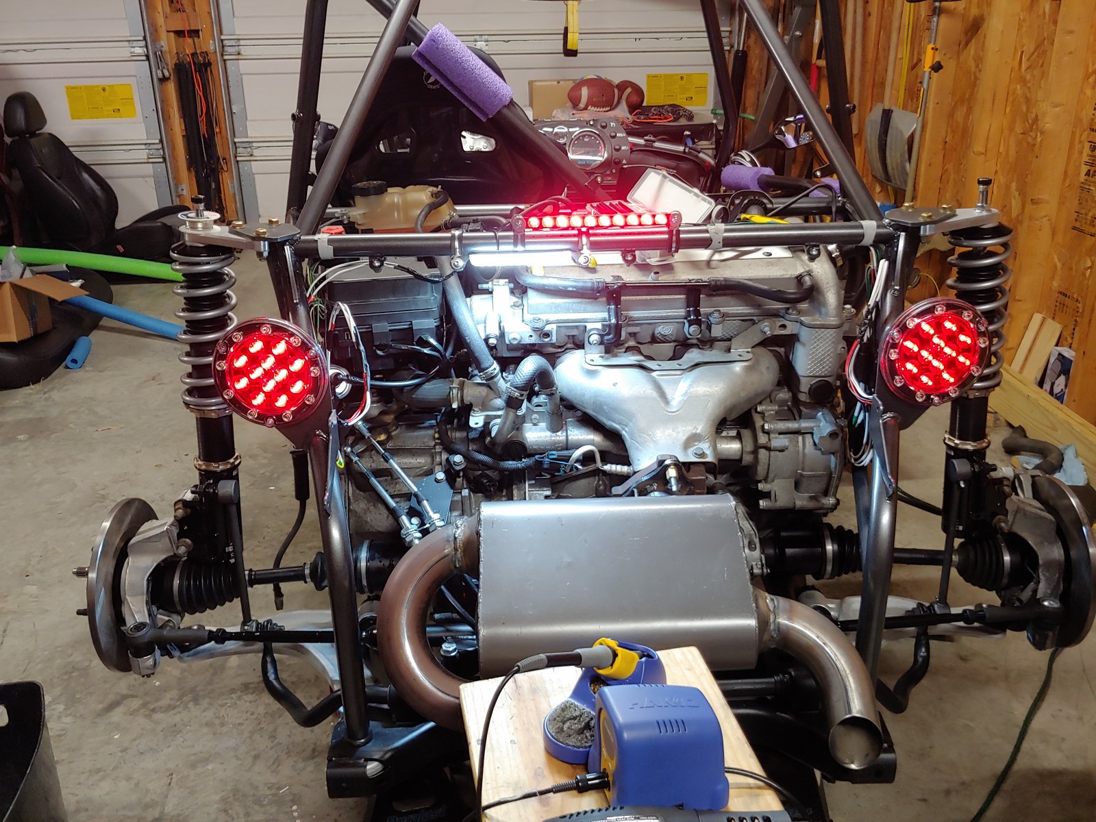

Wheels are in and I've soldered in all of my rear light wiring/connectors.
I'll probably add some electrical tape on the license plate bracket so it doesn't shine up/back so much.
10448
Didn't expect the 3rd brake light to be the only brake light that shines when pedal is pressed and the key is out or off but it looks like this is normal for cobalts. All of the rear lighting works as expected though I'll have to figure out which wires at the bcm side are the rear lights to add in my tow bar kit harness.
My 3rd brake light has the wiring to have running out brake light function, increased visibility is good so I connected it off the brown (marker/running) light circuit too.

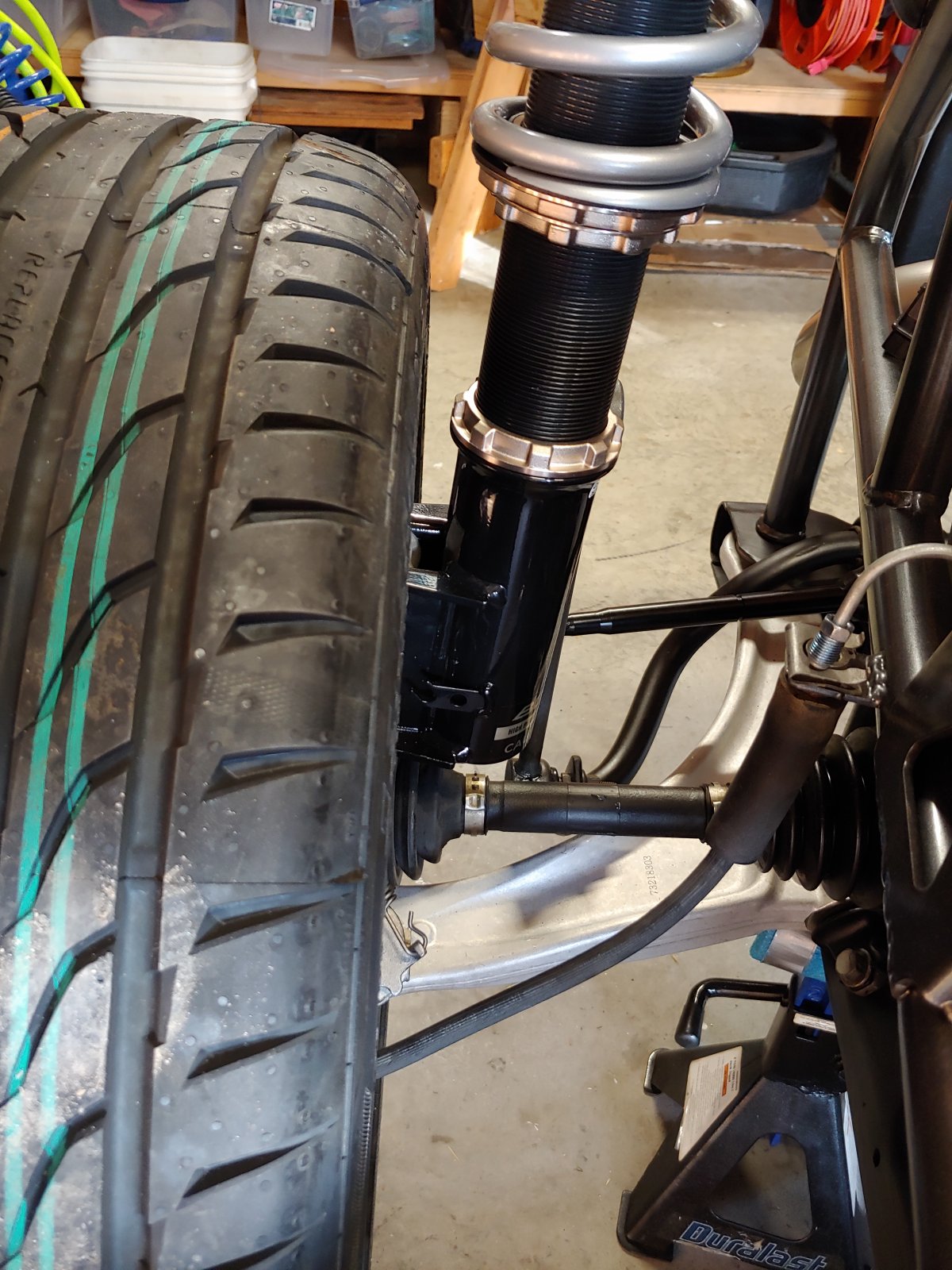

I might end up going with wheel adapters anyways, just as push the wheels slightly further out. My rear wheels/tires clear without issue but the front bump the upper control arm slightly. Because of my tires not bulging out on the sidewall but being fairly square, the wheel or tire could both rub.
If the outer rod ends are all the way shortened, both wheels would touch on the rear surface of the upper control arm (driver side wheel when turning left, passenger wheel when turning right). I have all the large rod ends turned out to 8 turns from minimum length. The tires don't contact the control arm by themselves at that rod end length (I'm still up on jack stands under the frame) but if I push lightly on the tire while it's turned it'll touch the control arm. At 4 turns the wheels touched pretty hard. 8 turns out seems like it's still halfway or just over halfway inserted for the large rod ends, knowing how much force goes through that rod end, even in a parking lot, I don't really want to go to the range of 4-7 threads engaged. I know moving the upright further out would help decrease the rub chance to the upper control arm but I think I'd feel better by bolting on hub adapters (same bolt pattern, I like the wheels).
Last night I circled back and read Ross was using 39mm adapters but didn't include the rotor thickness in that calc. The wheels I've got do have slight cavity back setup where the original studs can go without interference. I hope to measure things tonight to figure out what my minimum will be. I do have the solstice rear rotors so I'll have to measure both the front and rear for adapter thickness. I think I prefer the full adapter setup (bolts to existing studs and then has 5 new studs offset for the wheel to bolt to) instead of the basic spacer disc.
For clarity, my tires are 225/45r17 on 17x7.5 wheels with 45mm offset (6.02" backspace). When I compared against stock SS/SC wheels (I don't have a set since my donor had cheap lug-centric aftermarket wheels with plastic hub rings), my tires should be ~8mm further in than the stock wheels. Even if I used a 1/4" spacer disc, I think my suspension adjustment could still allow for rub; I'd have to go >8mm to prevent rub risk.

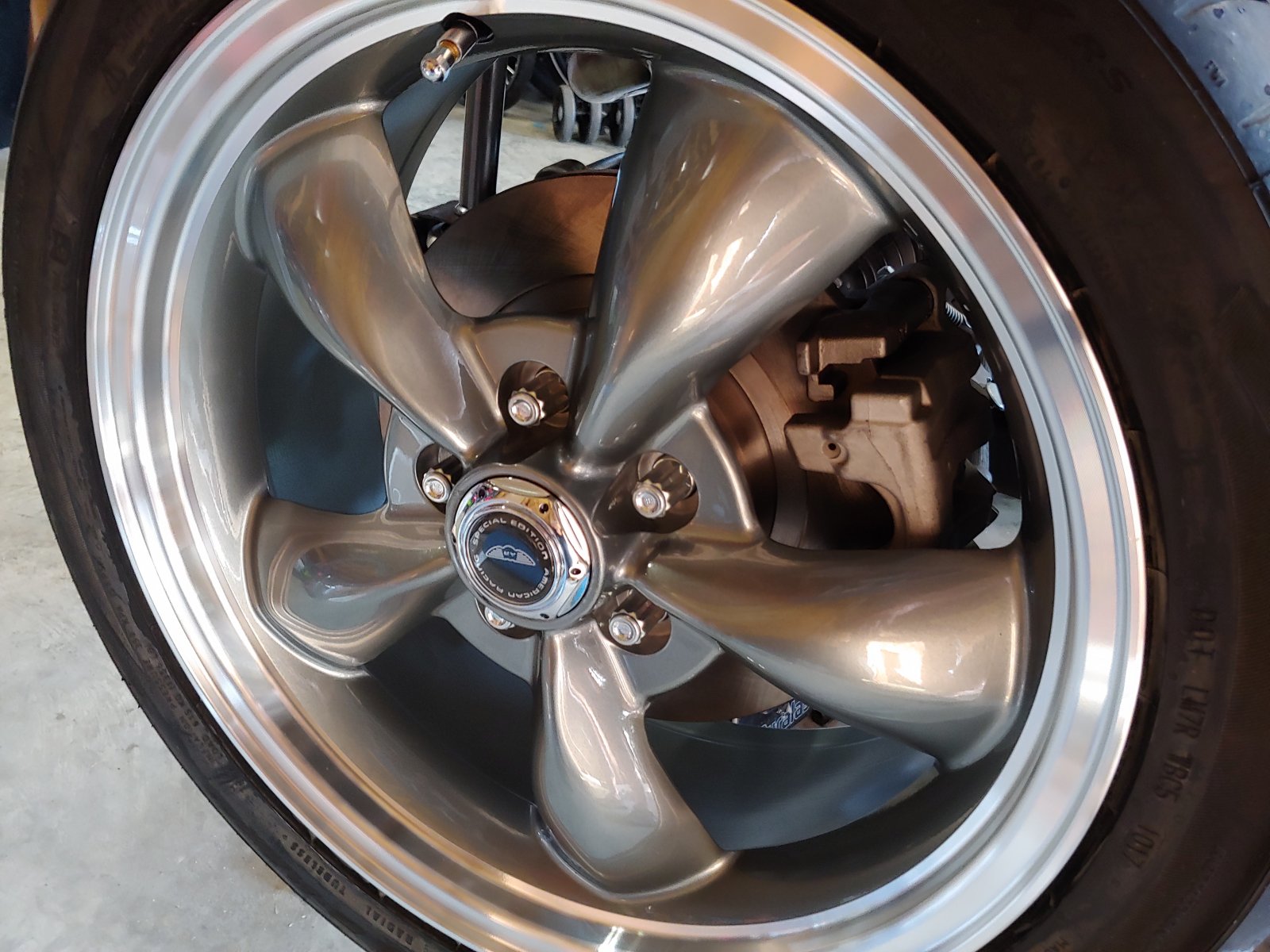

The stock wheel is 7" wide with an offset of 42. So going with a wider wheel and a bigger offset would be why it is hitting. When I got my American Racing Torq Thrusts, that was one of the reasons I went with the 16" x 7". I could get a smaller offset of 35, pushing them out just a bit more than the stock ones. I think they fit awesome. The only thing that I would change with mine, is a wider wheel in the rear. Maybe some day I will find that. So in your case, you will just need to add a spacer in the front to clear. Maybe like a 10mm. Or get some adapters, which is never my favorite thing to do.
