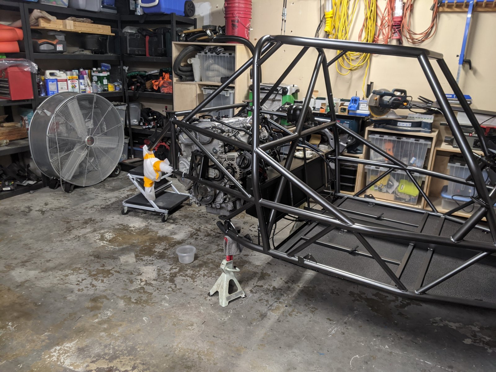

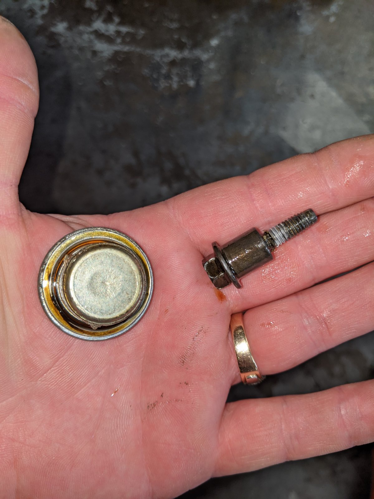

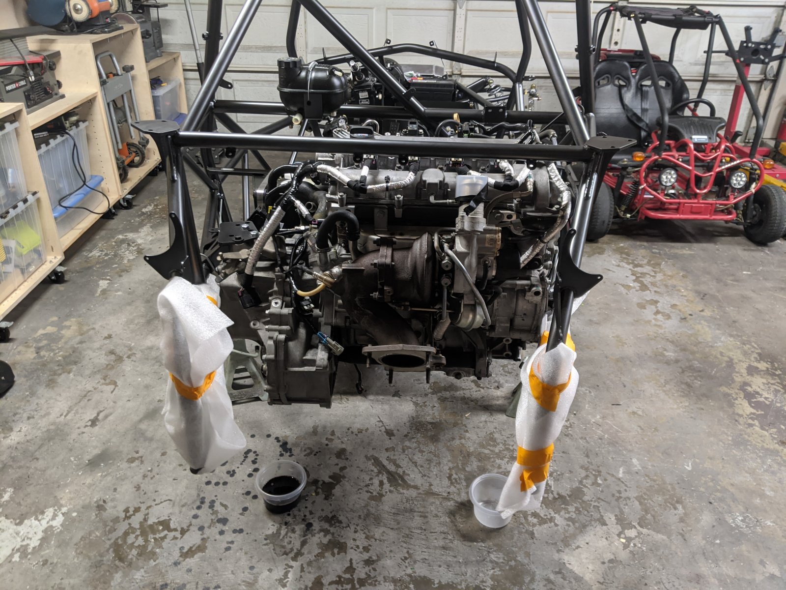

Replaced the timing bolt today. Also installed the engine. I didn't have any donor bolts that would attach to the transmission through the spacers but home depot had some that worked.
Up next is to install the subframe / transmission mounts / rear suspension then maybe tackle the steering wheel. Still waiting on my wiring harness and seats but they will get here when they get here.
Now I have the great bolt pattern debacle. Initially, I found a set of wheels available in 5x110 that I liked. They were 18x8 but the lead time is crazy long, several months. Then I got the ride in JBINTX's Goblin and I realized that I need as much tire as reasonably possible which puts me in wider wheels and the need to change bolt patterns to 5x114. I found a jig to line up all the holes if I choose to drill the hubs and rotors myself but I don't have a press to press in the studs. Also the jig is 100+ dollars. I have reached out to DF to see what they can do.
Obligatory engine install pictures attached.
PXL_20201113_030035762.jpgPXL_20201113_030027029.jpgPXL_20201112_221058129.jpgPXL_20201112_221040575.jpgPXL_20201112_221029720.jpg

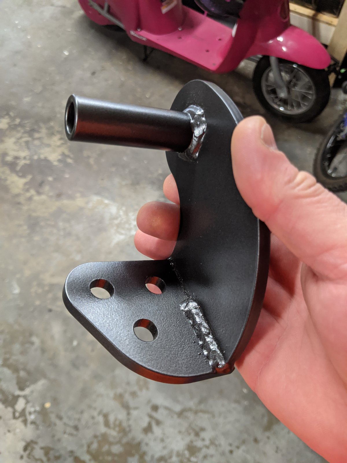

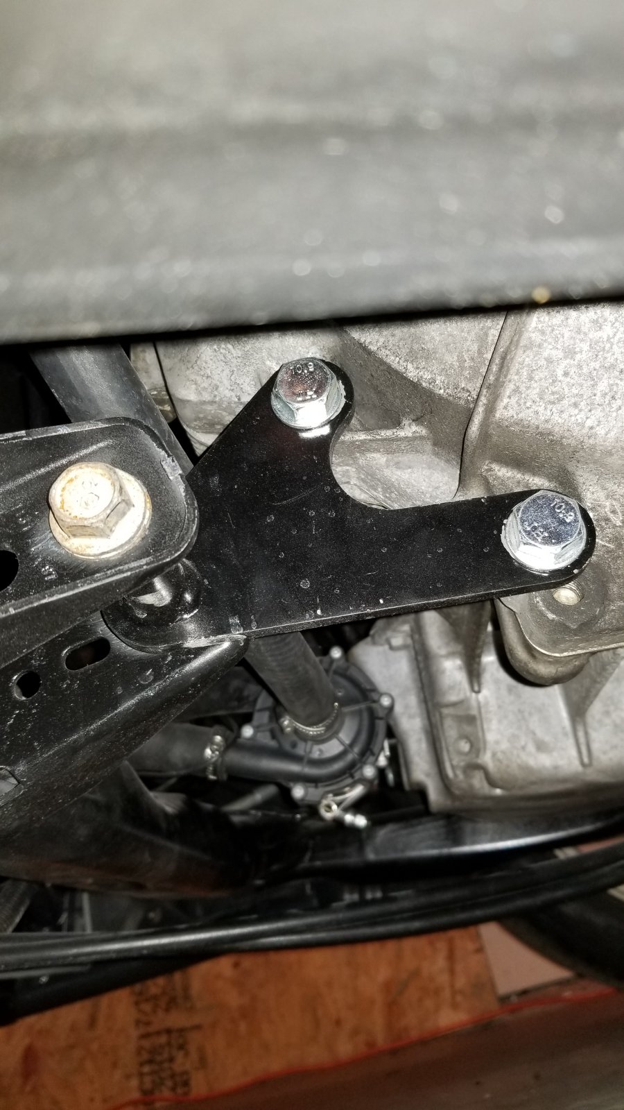

While staring at parts between work calls. I think I have the sub frame and rear mount figured out but I cannot figure out the front mount. It looks like they have changed the design based on the pictures on the forum.
Here is the front mount that I have. What I cannot visualize is where the flat part with the three holes attaches too on the f35 transmission.
18324

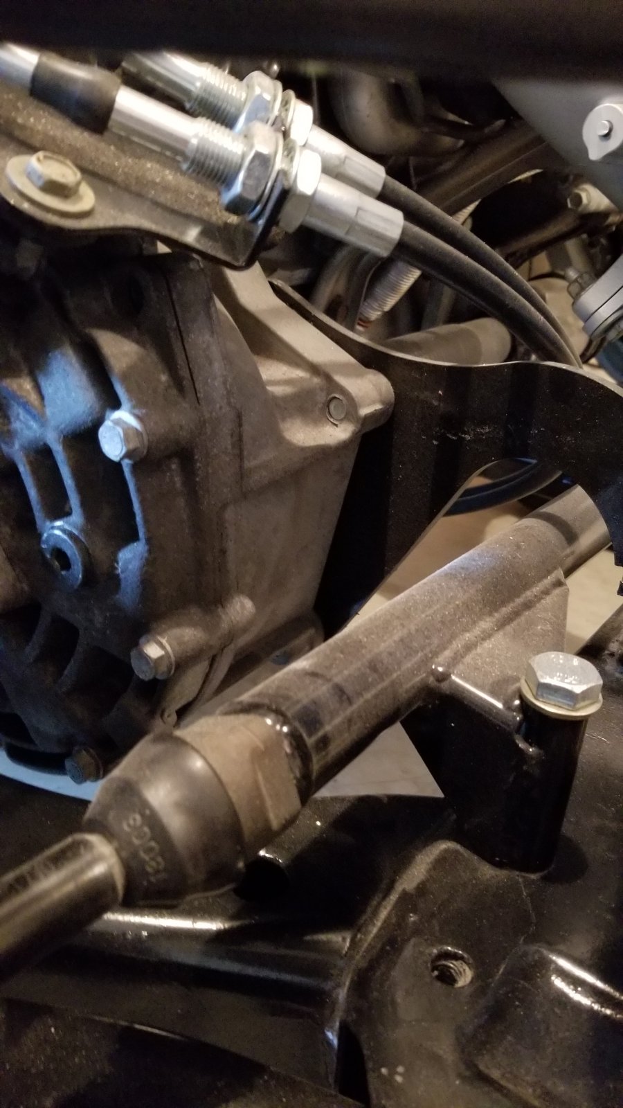

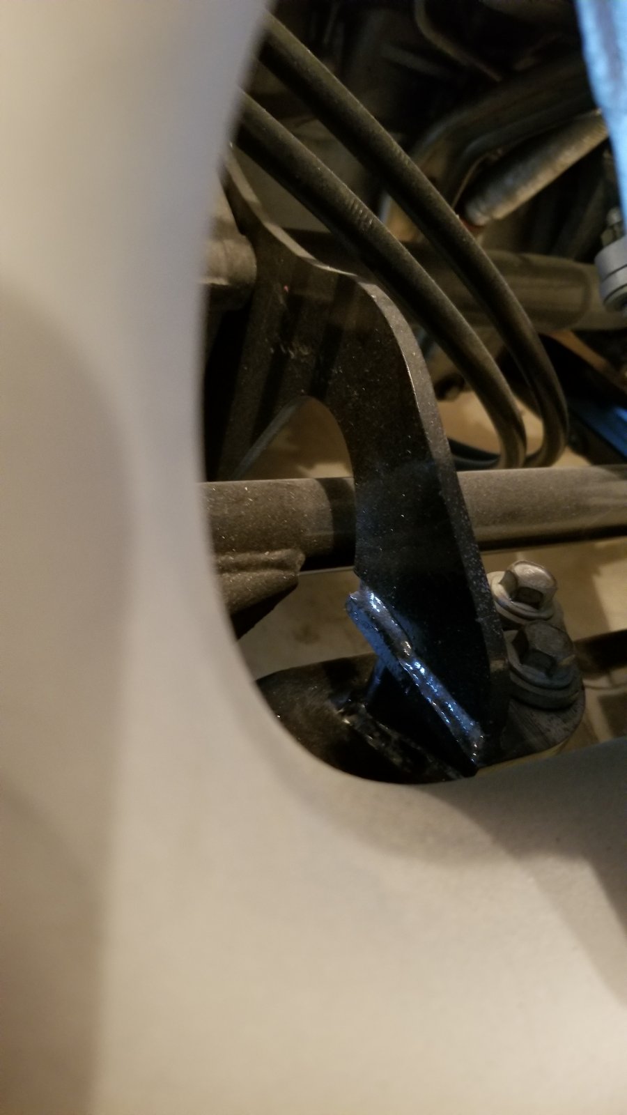

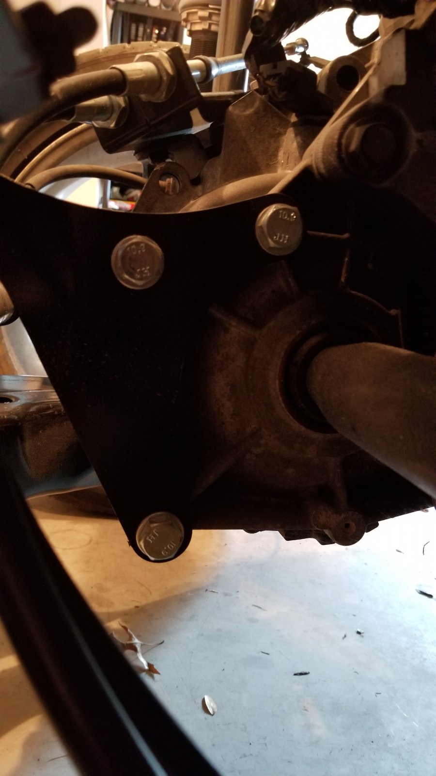

Sorry for the pic quality, it's not easy to get good pics under there.
*edit* Wait, what the heck, yours is different than mine. Sorry about that!
Brett
Actually, those photos do help for the rear mount.
The one I am looking at that I have is the front mount. I might have the wrong one but not sure. Going to reach out to Adam in a bit and see what he says.
Yeah, now I am really confused, your front mount looks like some sort of Frankenstein melding of my front and back mounts.
Goblin Graber

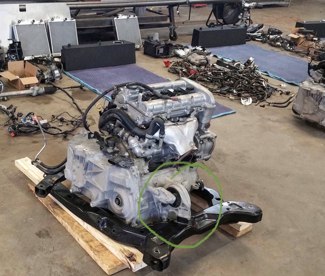

That is the rear mount. The three holes bolt to the cobalt subframe. It replaces the one I circled.
