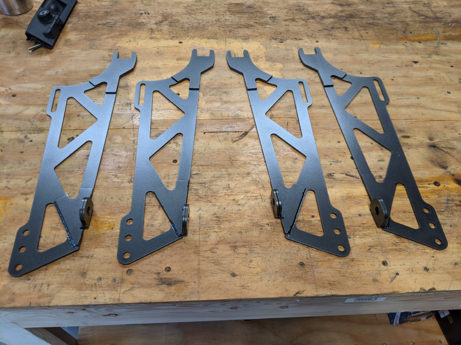

For some reason, I have 4 supports for a spoiler. Is this right? Am I gonna go double height?

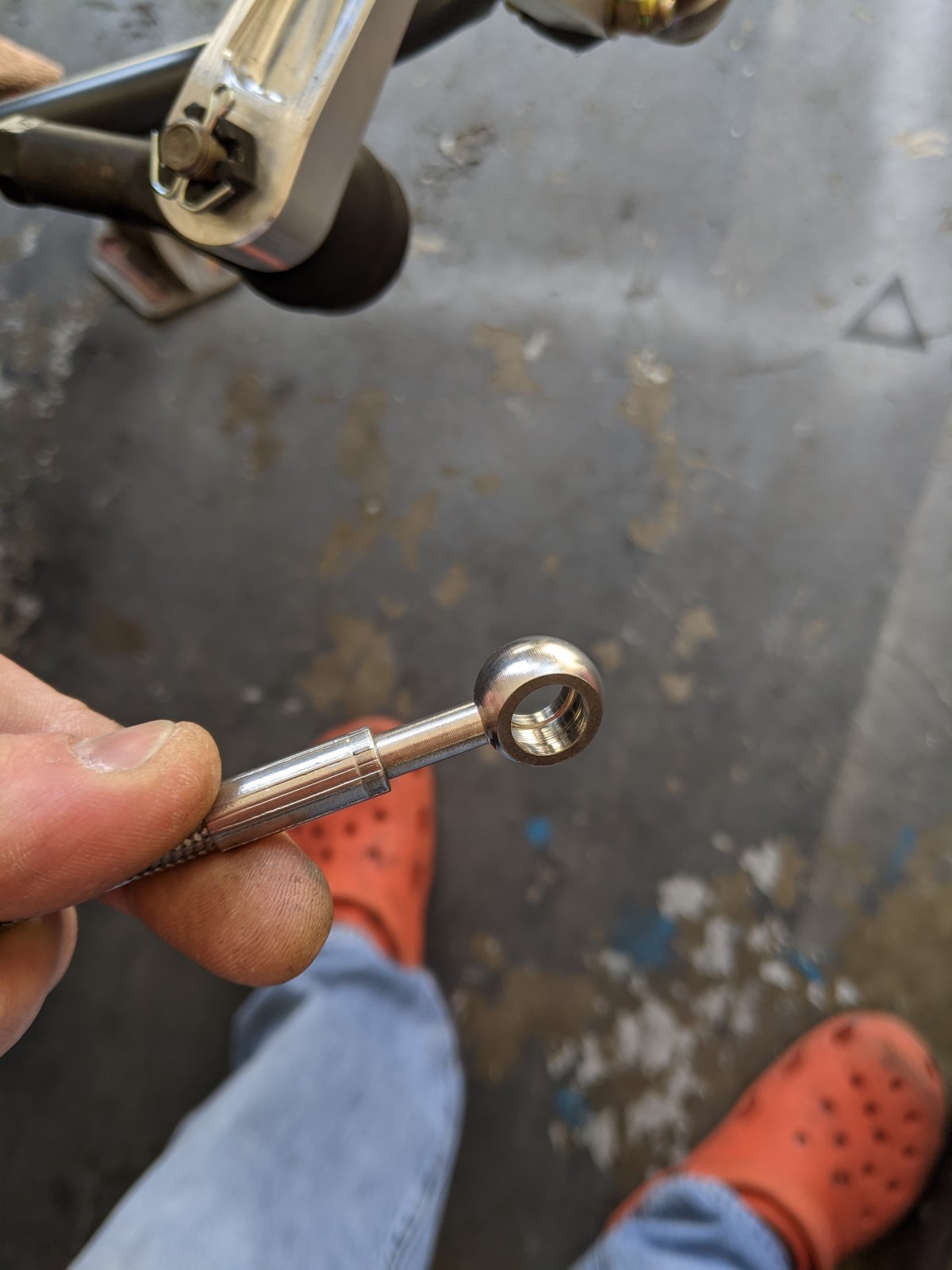

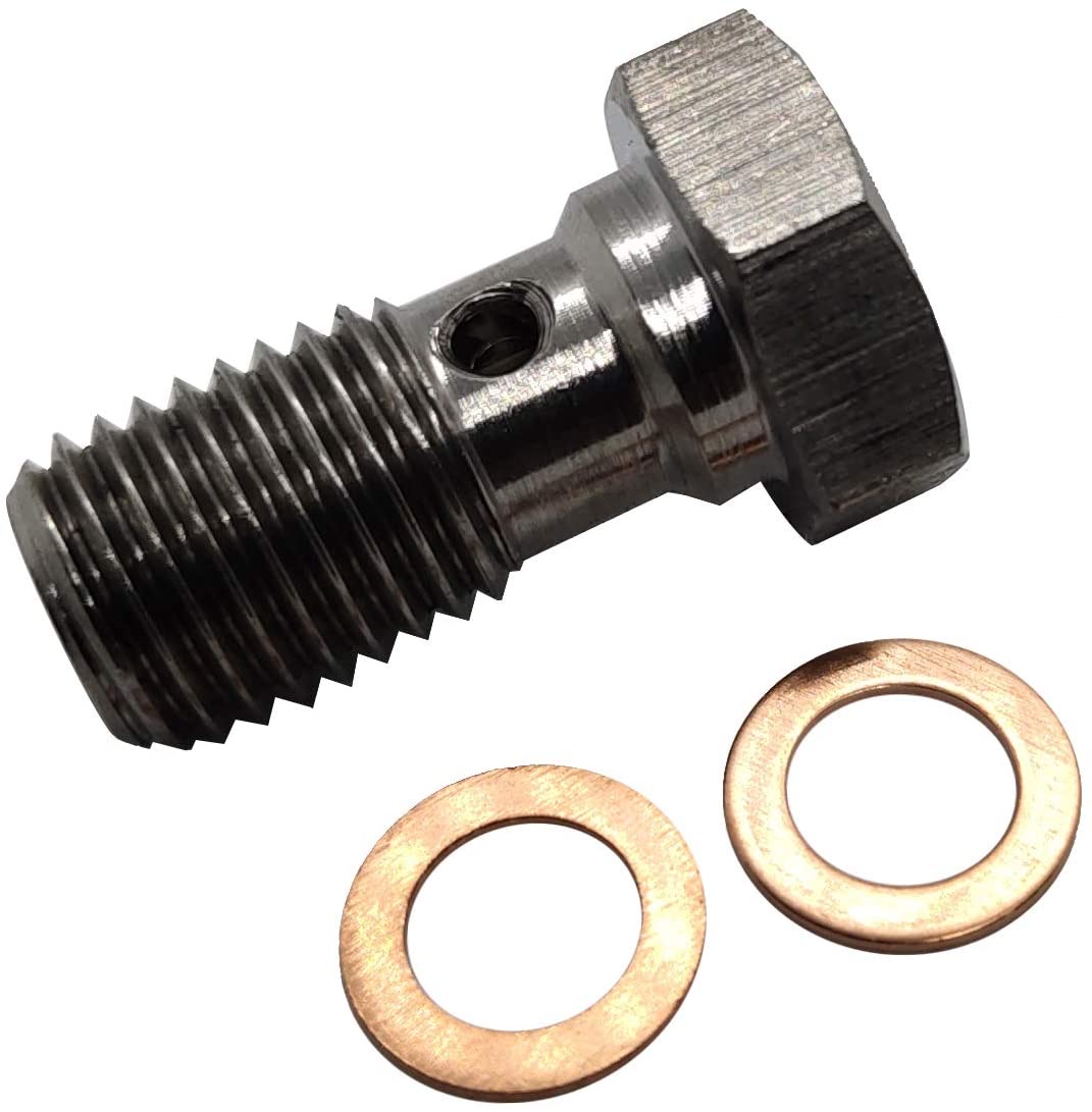

Also, I am not familiar with how the brake lines attach to the calipers. Maybe I am overthinking it. How do they attach? Just a bolt or am I lacking a piece?

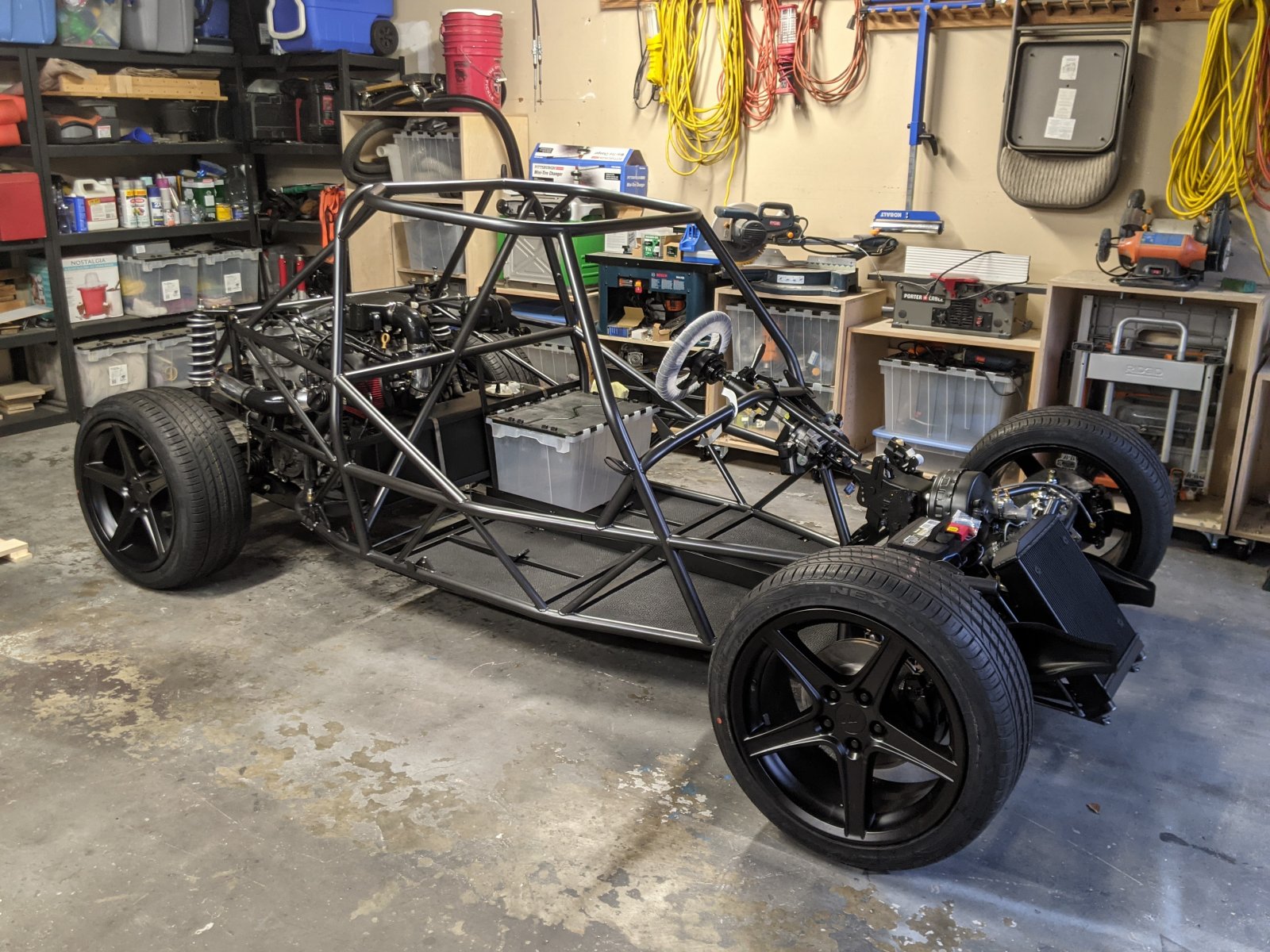

Ok, time for an update. I got tires / wheels / brakes / painted the radiator with the proper paint. Mounted the ducts for the heat exchanger and in general fine tuned a bunch of stuff while I was waiting for the wiring harness.

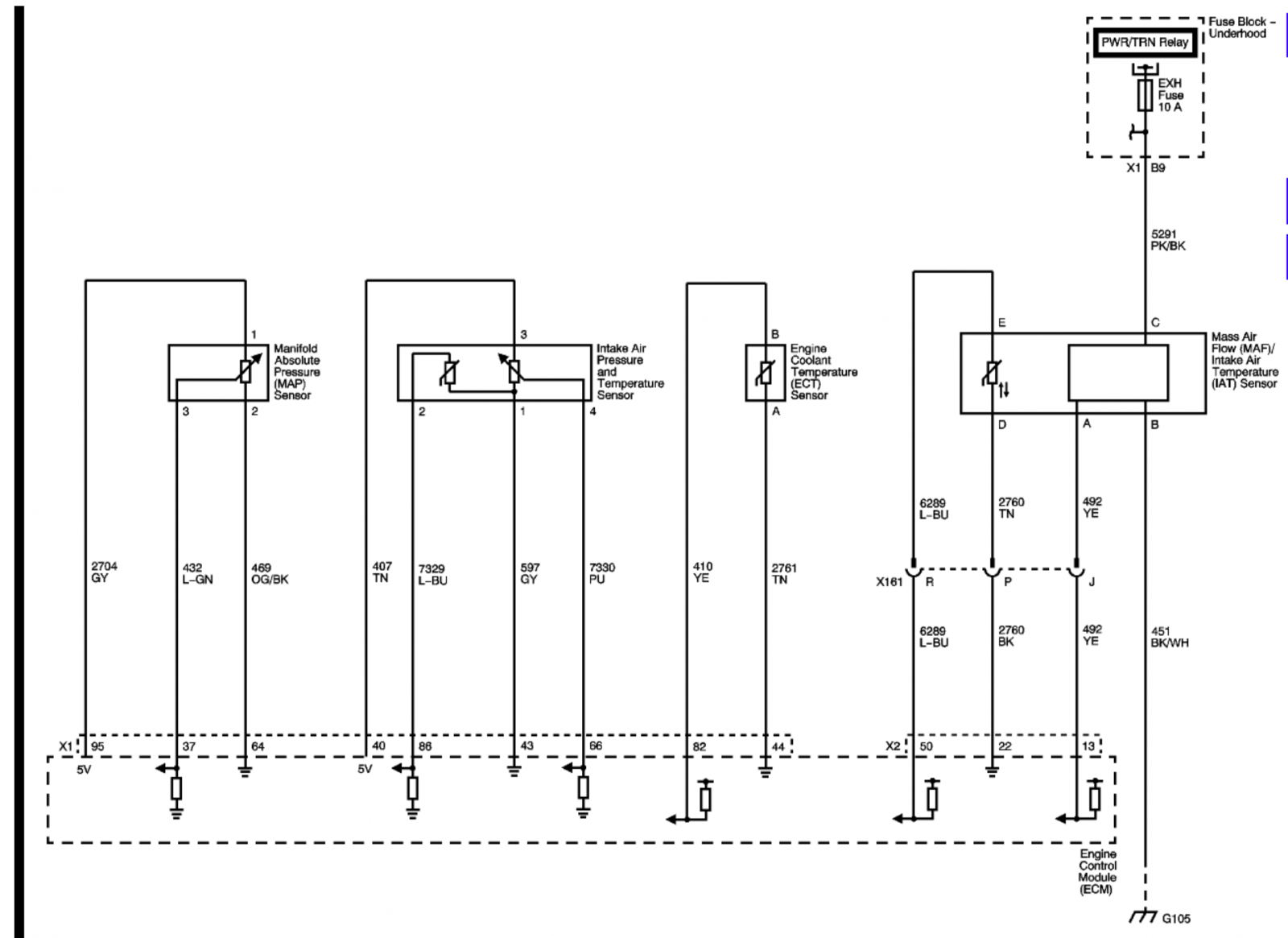

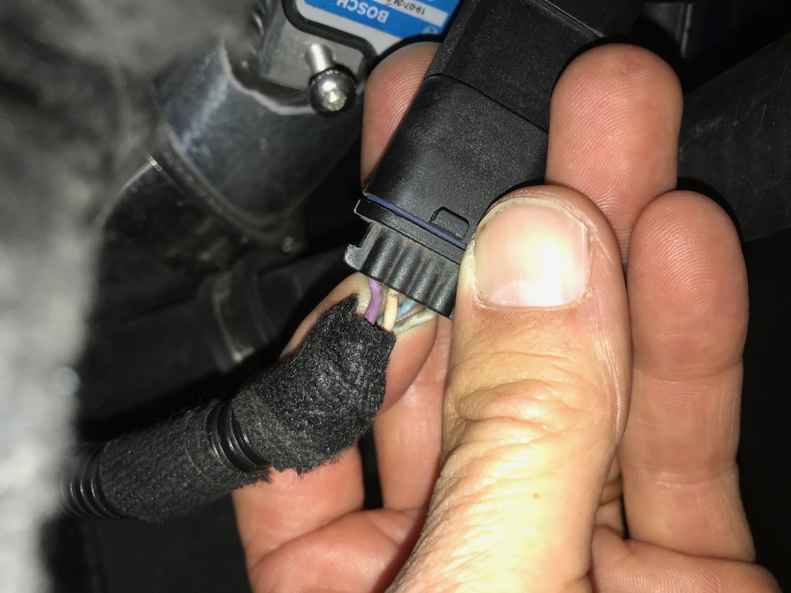

Now, I received the wiring harness today and it confirmed my suspensions. When I was cleaning up the engine harness, I appear to have remove the 4 pin map sensor wires and connector. Why, I don't know. The is the map sensor right before the throttle body. I have a replacement pigtail coming that should allow me to fix the wiring but I need to figure out where the map sensor wires go to in the connector.
Does anyone have a wiring diagram for a 2009 SS? Anyone know what pins on what connector I need to be looking at?

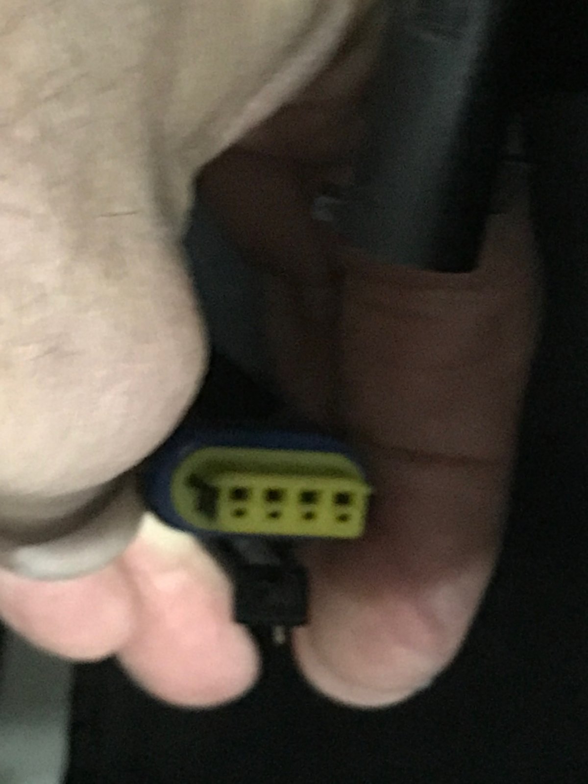

here is the plug and the wire colors. Maybe that is all you need?
Brett
I could not find that diagram. Sorry.
Someone with access to a data site?
View attachment 19049View attachment 19050
Signed up for all data diy and did some digging and found the diagram with pinouts that coresponds to Jason's photos. I think I am all set, just have to dig into the harness, find the cut wires, splice in the ones I got coming and I should be good to go.
19065
