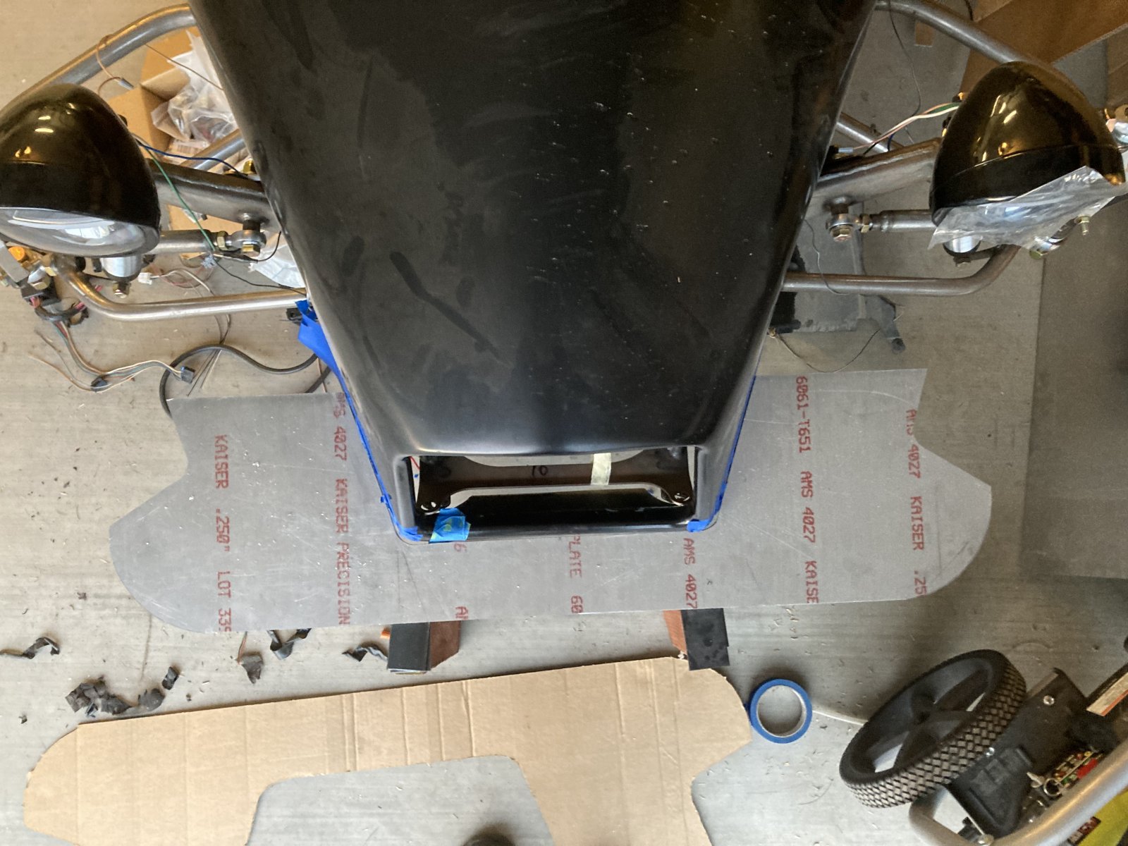

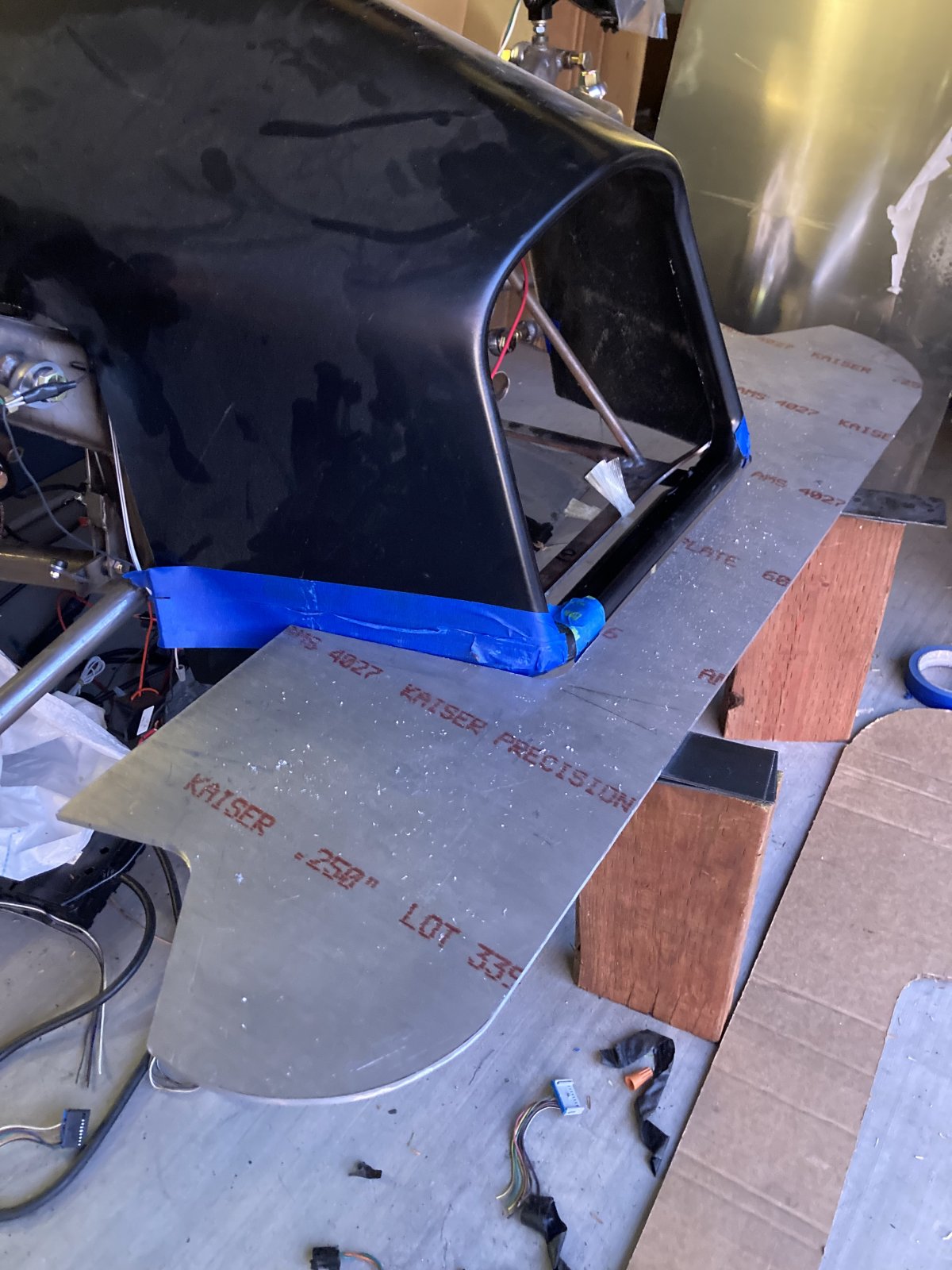

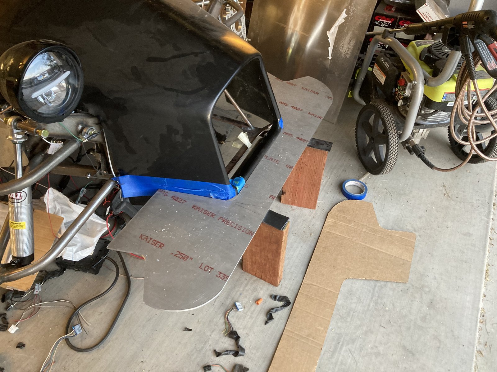

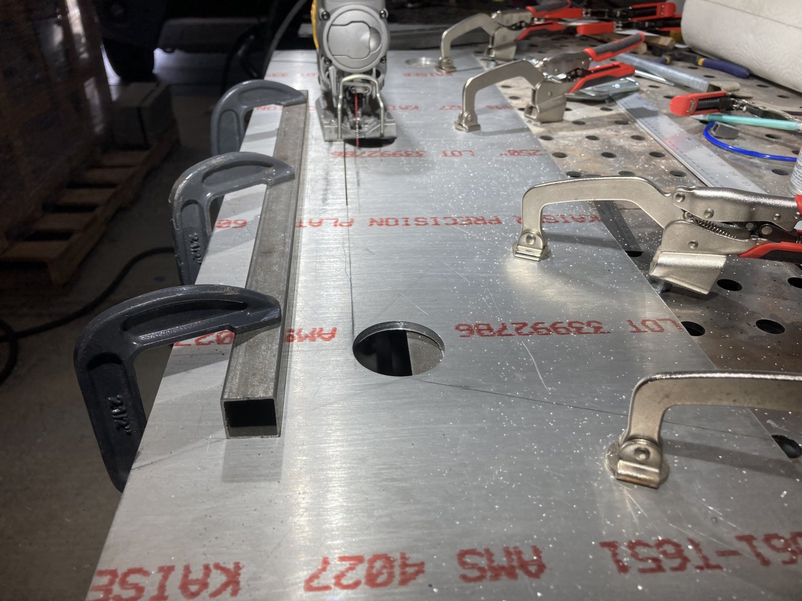

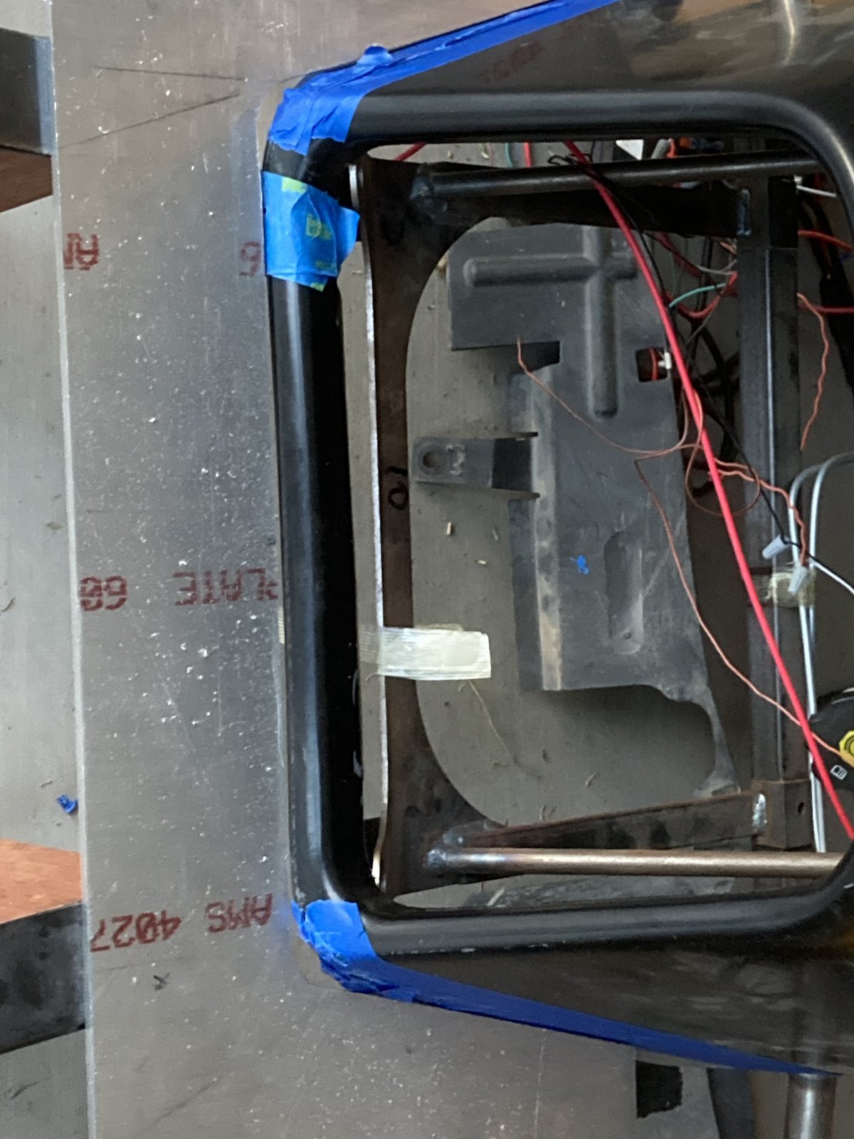

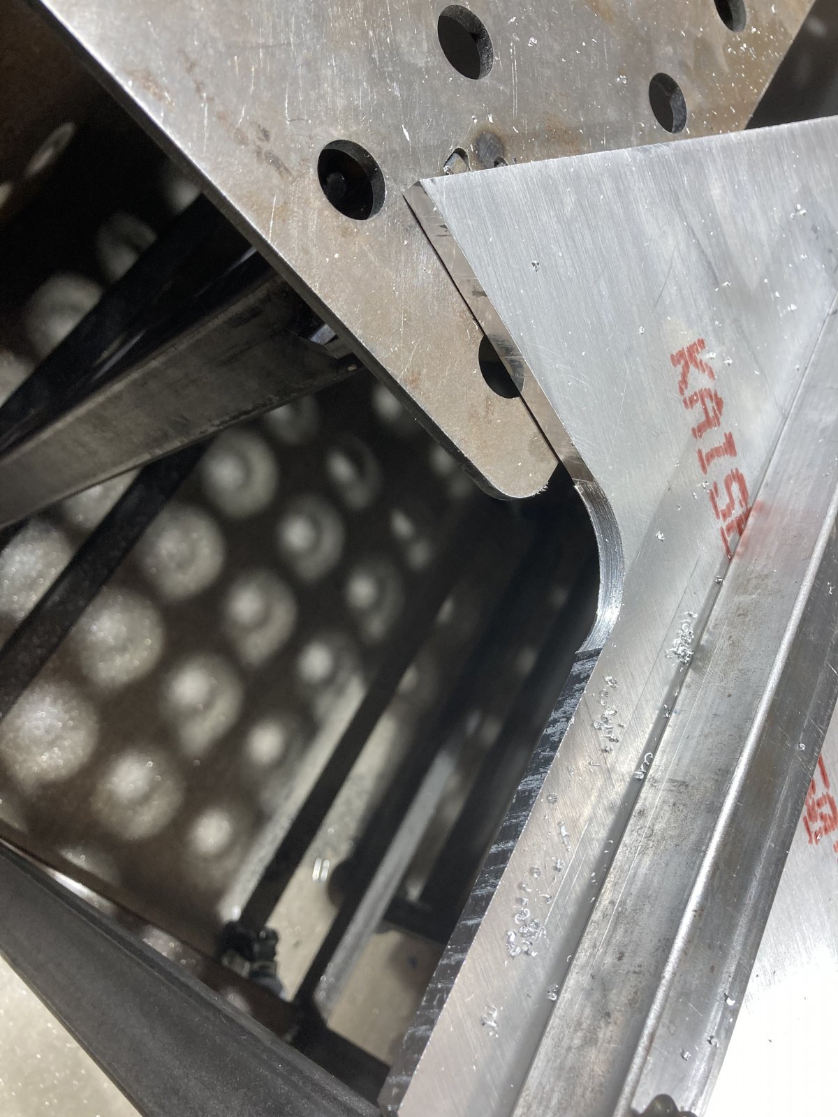

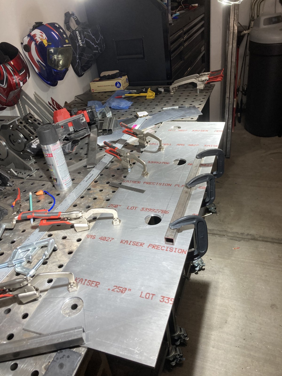

Spoiler is cut out. Ended up weighing 8.8 lbs. I ordered a press brake to do the bends, which wont be here for 2 more weeks. I still need to run a 90 degree orbital drum around the perimeter and round out the sharp edges. I will probably do 1/8” radius cuts on the leading & trailing edges.
I thought about 3D printing some abs lower trailing edge airfoils and side stabilizers; as my big printer could easily handle it… Not sure yet.
I have a feeling you may have trouble bending that material. With a T6 heat treat it will probably crack.
Try bending a scrap piece in a vise with a hammer.
It will also take a very serious press brake to bend it.
You can heat along the bend line with a torch and then allow it to cool to remove some of the heat treatment.
If it doesn't work out you may want to try .125 thickness and bend it over a piece of tubing to give it a radius bend. I think .125 would be stiff enough once you put a bend in it.
I’ve got a fair amount of scrap to practice with. I was planning to preheat it to drop some of the temper. I’m only looking for about 12-15 degrees and more of a radius than sharp bend. The press brake I’m getting is rated at 20 tons. Since I have good dimensions at this point, I’ll have no problem going to thinner material if need be.
20 ton, that should do it.
It would be neat if you could easily adjust the angle of attack to get the best down force.
Brian74
You weren’t kidding Lonny. I just went out to the shop and beat the living **** out of a 4” piece using a 10 lb hammer. I may need build some lower press jigs up spaced out with radius tubing. I’ve gotten so many different opinions from different people so far.

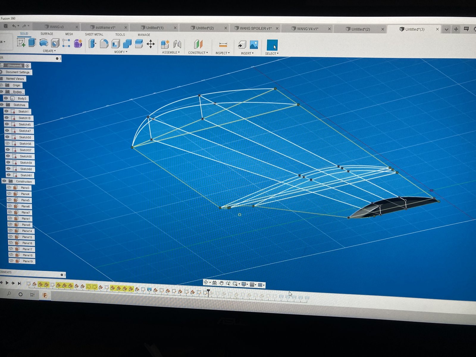

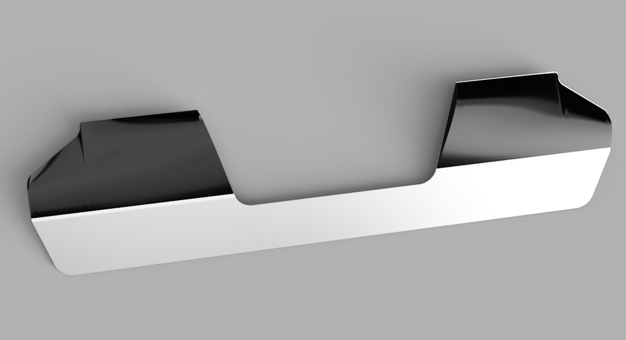

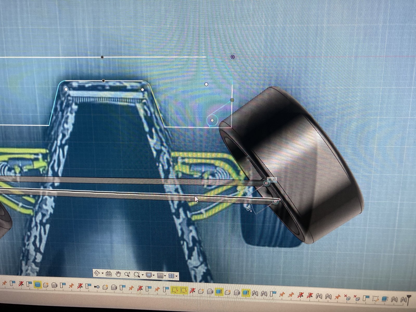

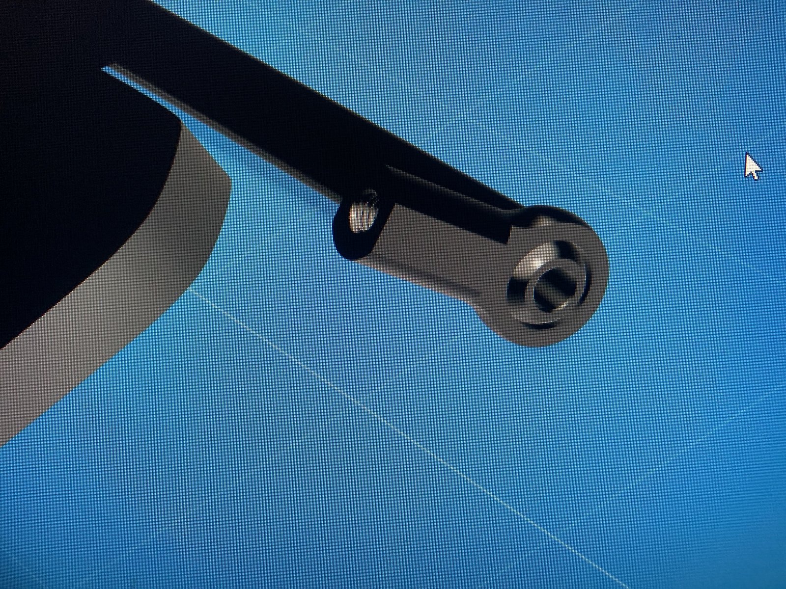

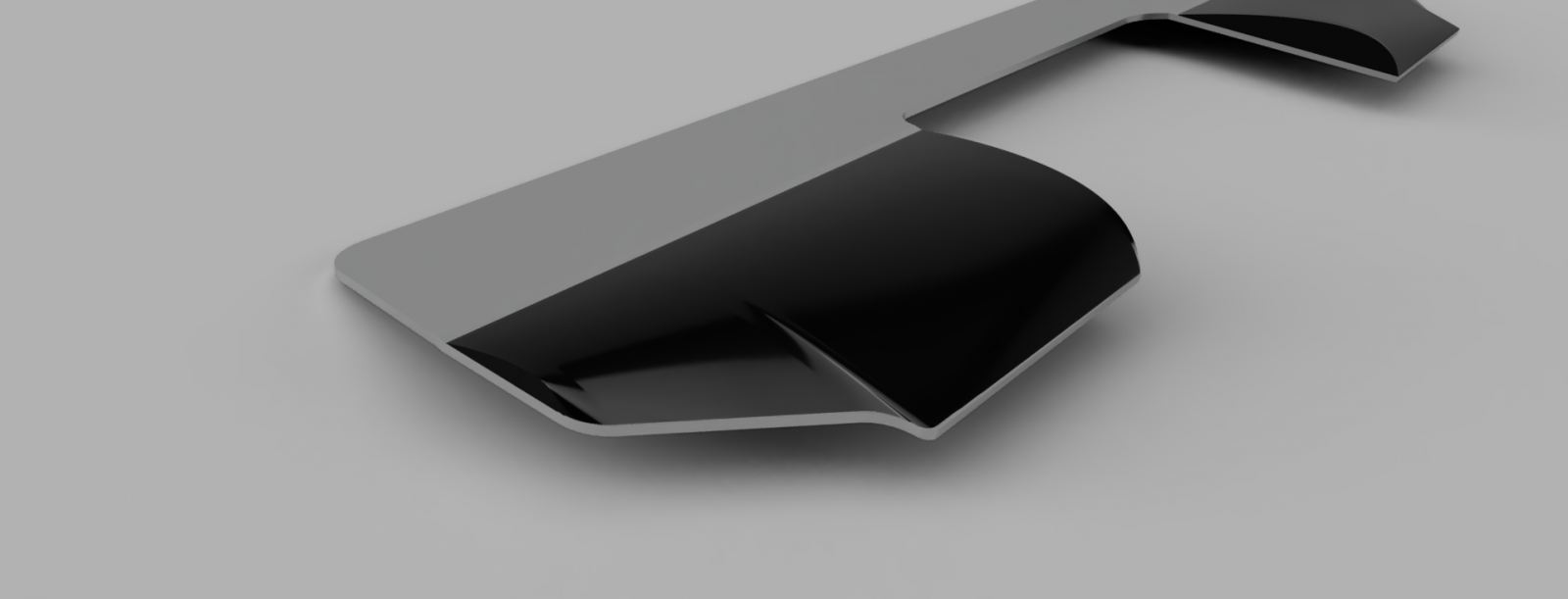

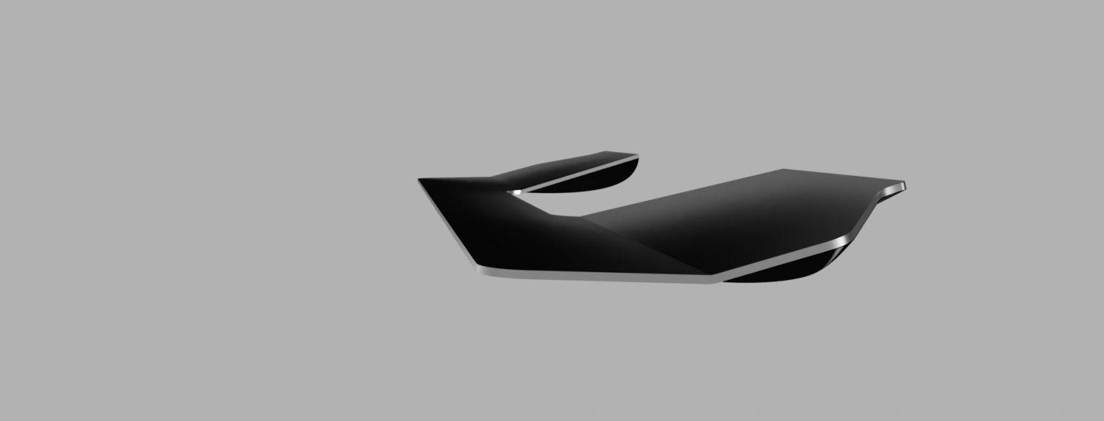

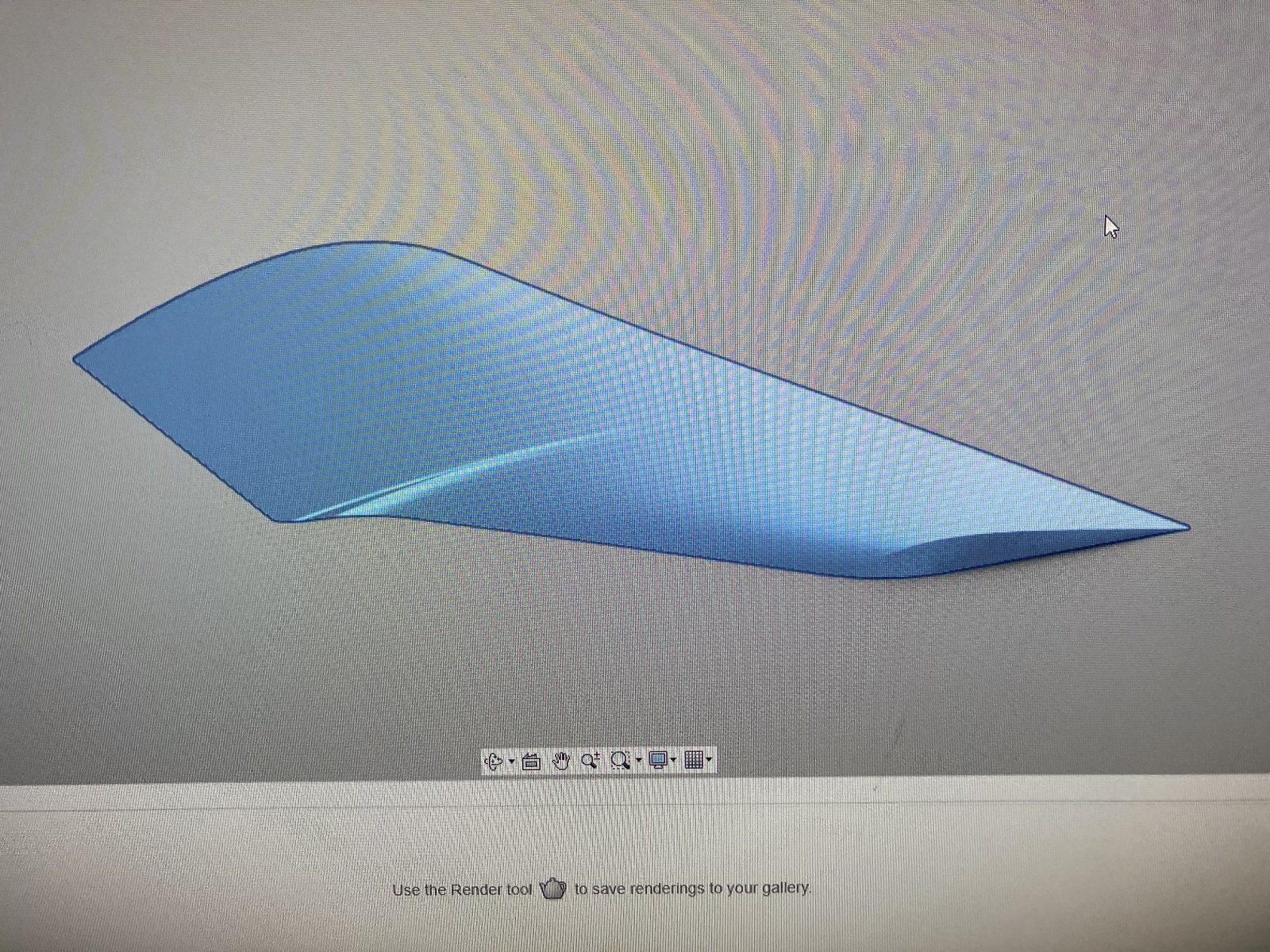

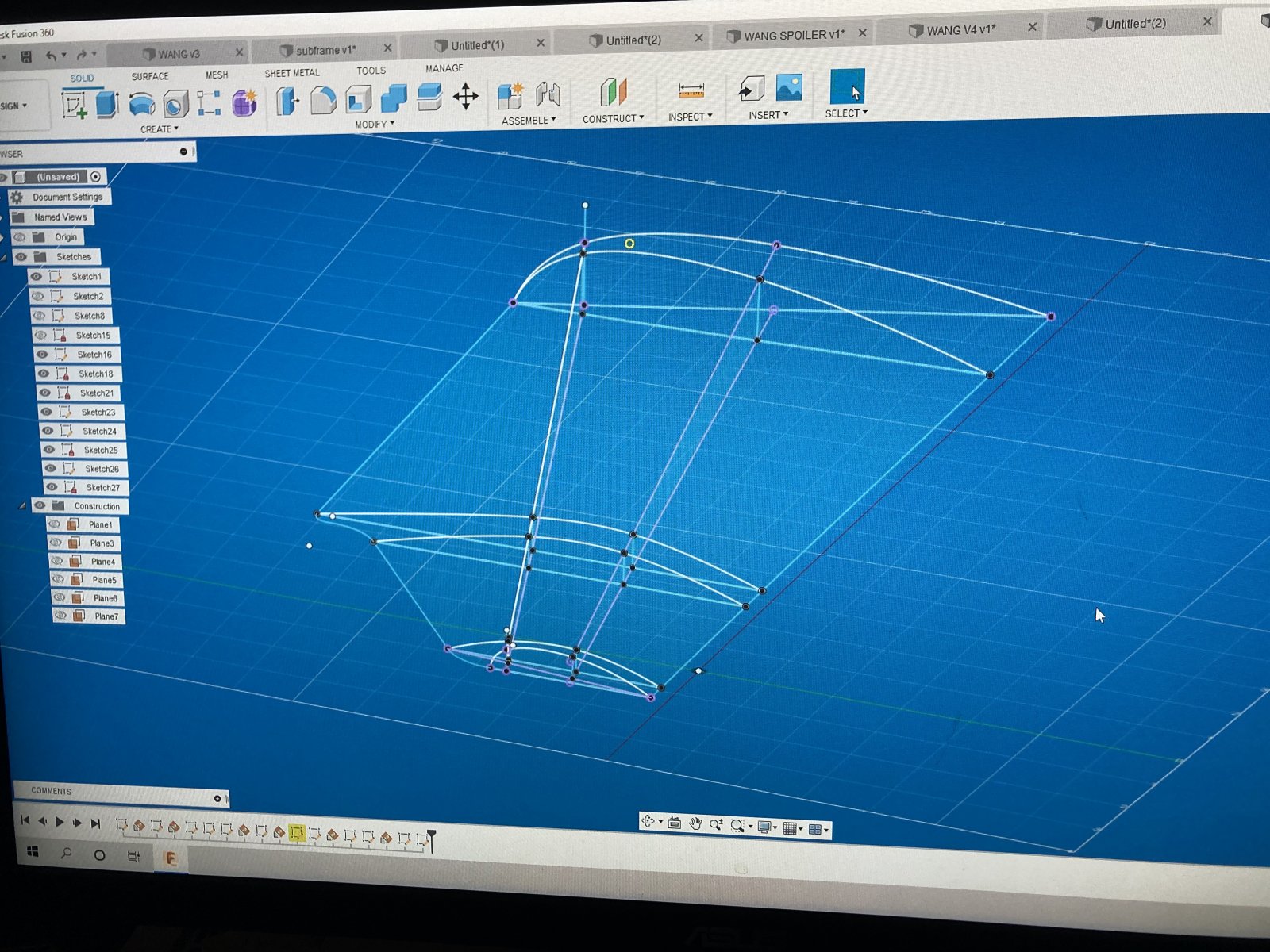

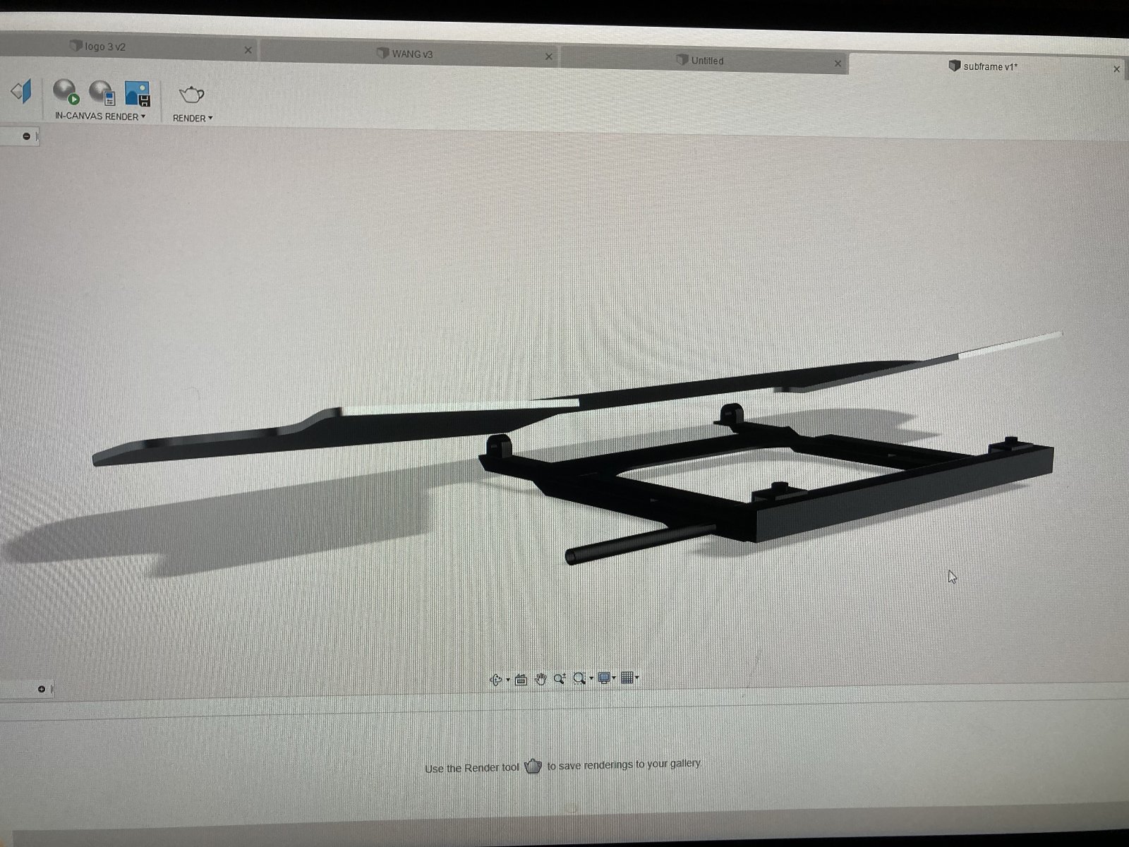

Continuing on with my spoiler design. I have been on Fusion360 for the past few days struggling through it. I played with component assembly modules a bit, and redesigned the front spoiler design clearances slightly using a carefully measured steering axis mockup with 245/50 16 tires.
Today I started messing with airfoil design. At some point it all just clicked and finally made sense. I literally had a coming to God revelation once I realized the fundamental design theory behind CAD.
After that, I quickly designed a lower aft airfoil section for the spoiler to reduce some of the drag coefficient at the trailing edge. I can easily print this piece and bond/mount it to the spoiler.

View attachment 29827View attachment 29828View attachment 29829View attachment 29830View attachment 29831View attachment 29832View attachment 29833View attachment 29834View attachment 29835View attachment 29836View attachment 29837

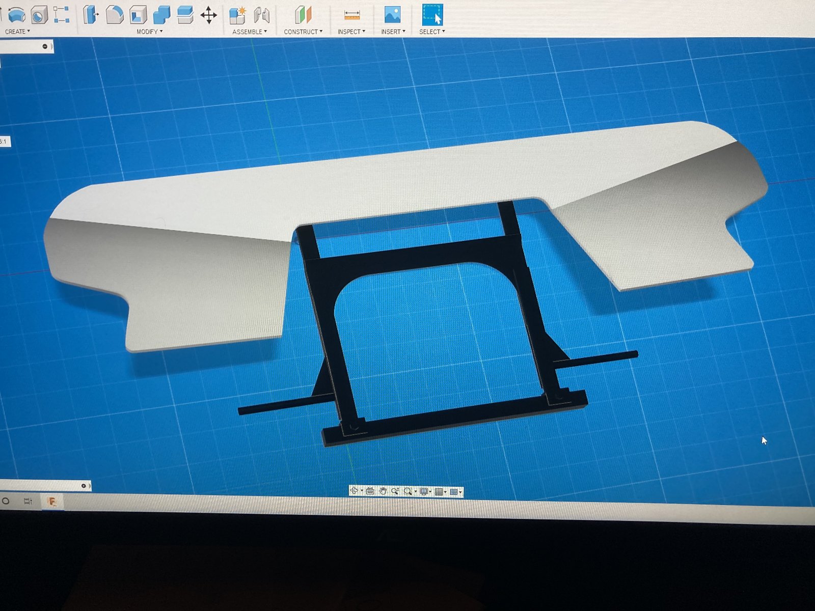

Brian,
From the pics in your post it looks like the airfoil will be on top of the plate? Or is this just for design purposes? The airfoil must be on the bottom of the splitter plate to create 'lift' in the downward direction to create downforce. Putting the airfoil on top will create lift upward, defeating the purpose of the splitter. Didn't want this to get to far and then realize the new splitter wing is oriented the wrong way to create downforce. :)
Brian74
Brian,
The airfoil is indeed on the bottom. The pics are more to show the design shape than anything.

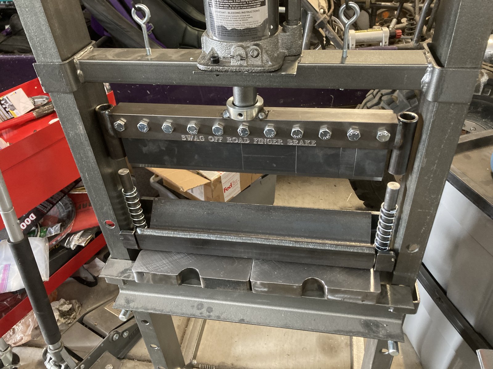

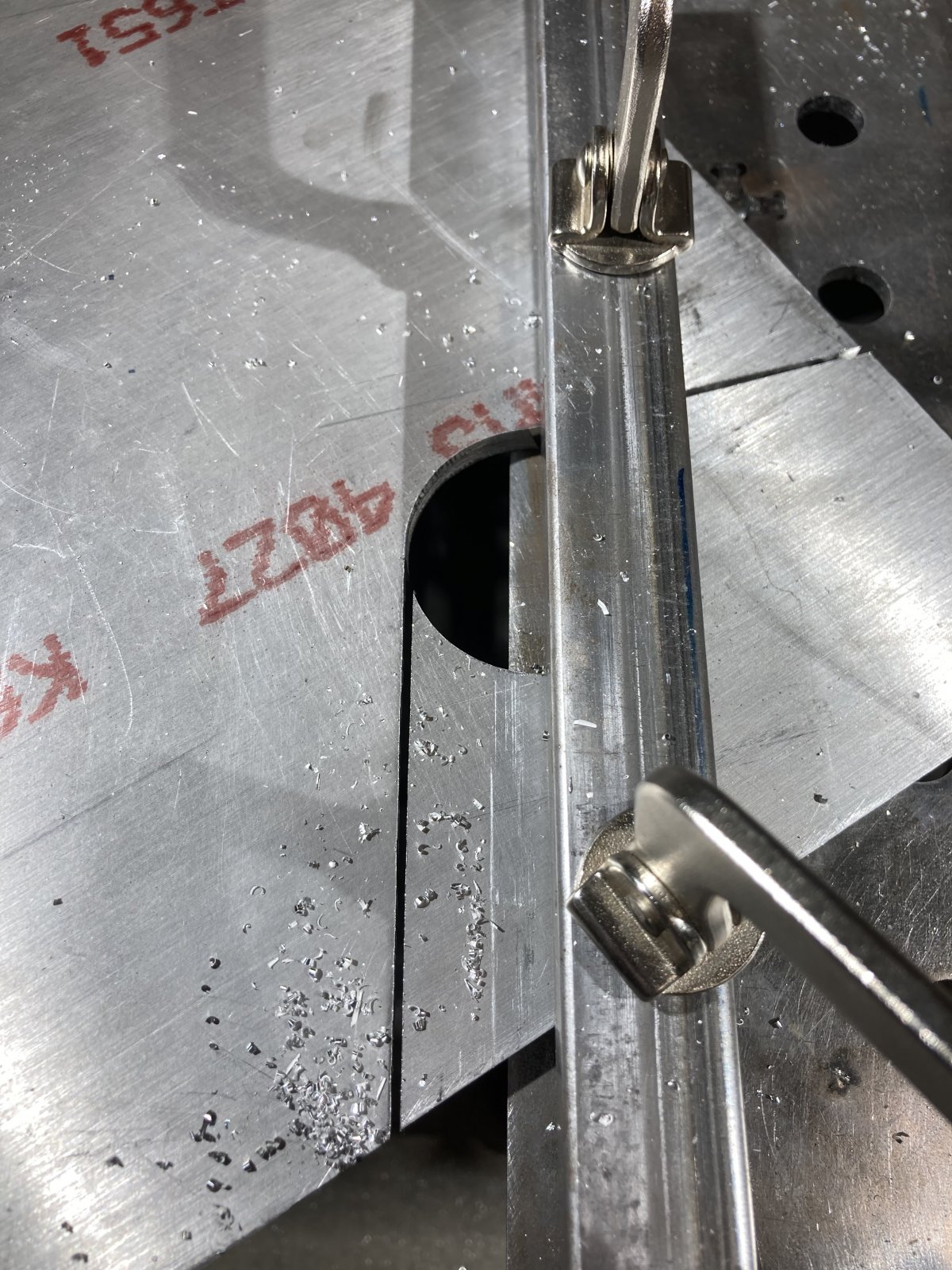

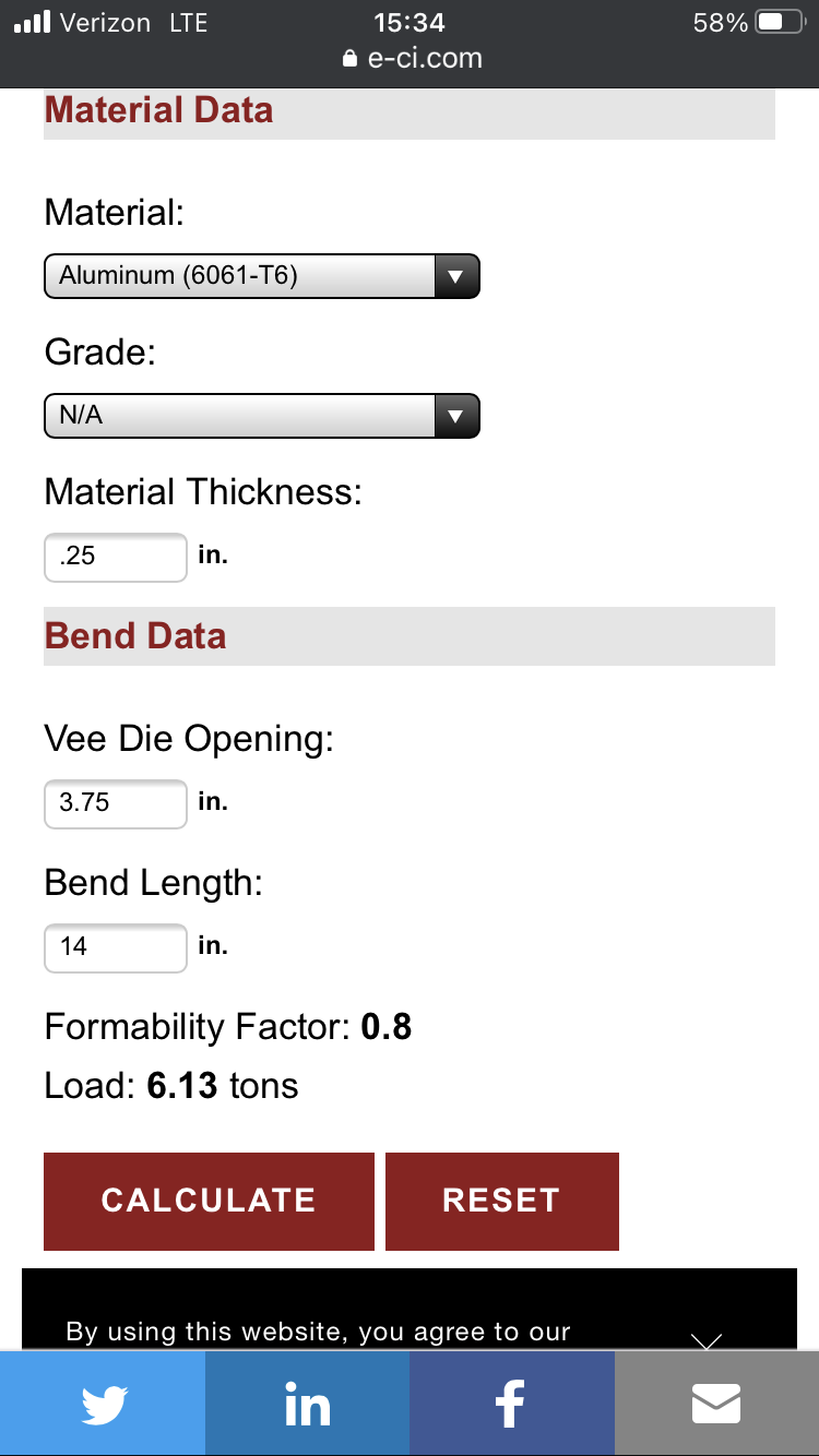

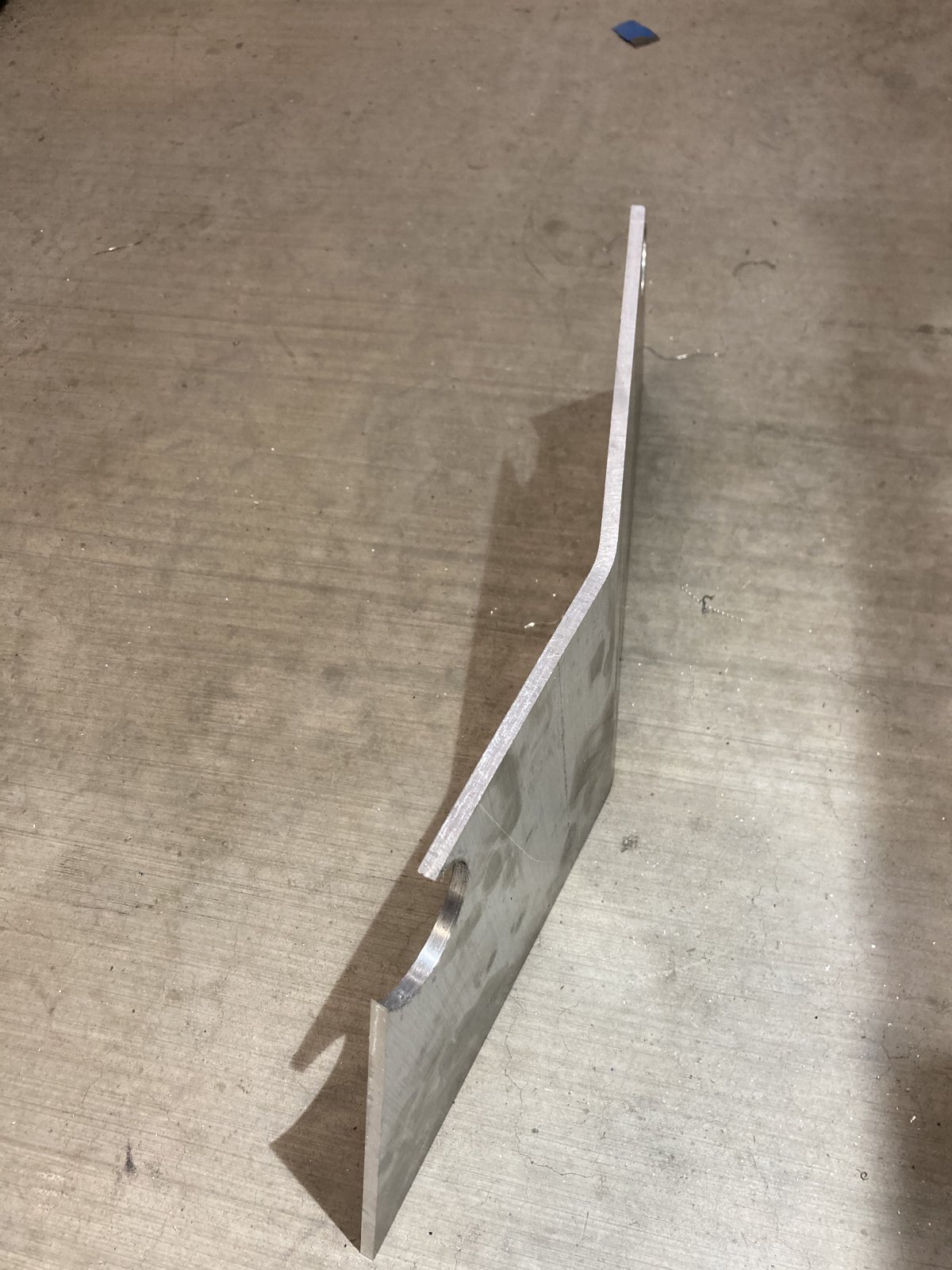

I got my new press brake set up. Threw in a 12” piece of 1/4” thick 6061 T-6 and cranked it down. It bent effortlessly; I’m guessing around 5-6 tons. This is great! I will cut out the prototype now and start working through the mounting bracket design.

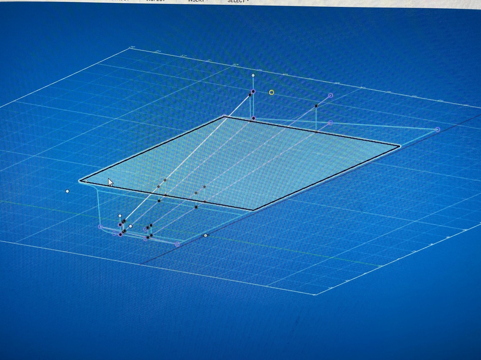

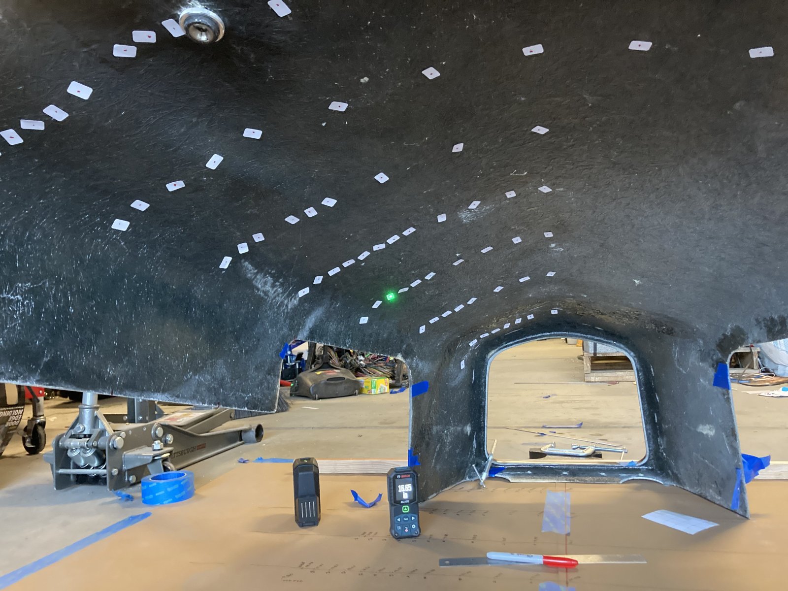

I decided to start a little side project today. I want to try more challenging CAD projects as I want to become proficient. I also love mind-bending projects.

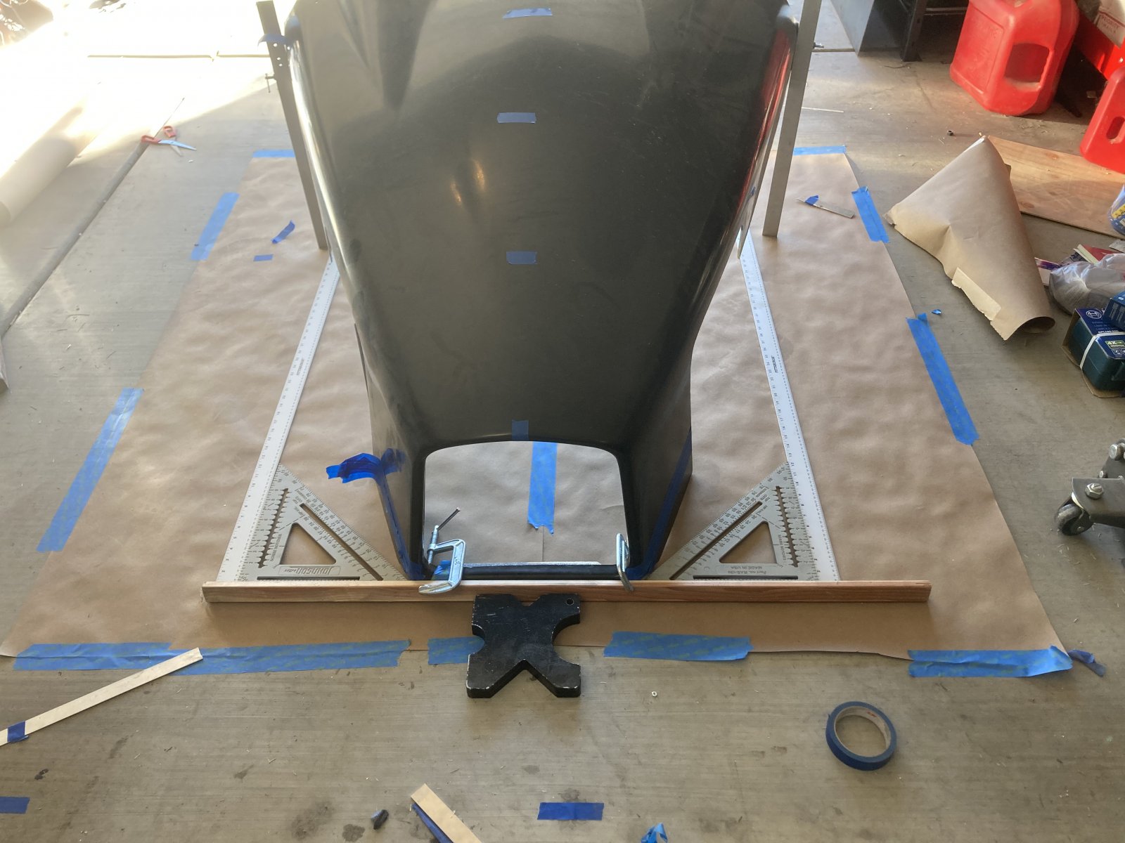

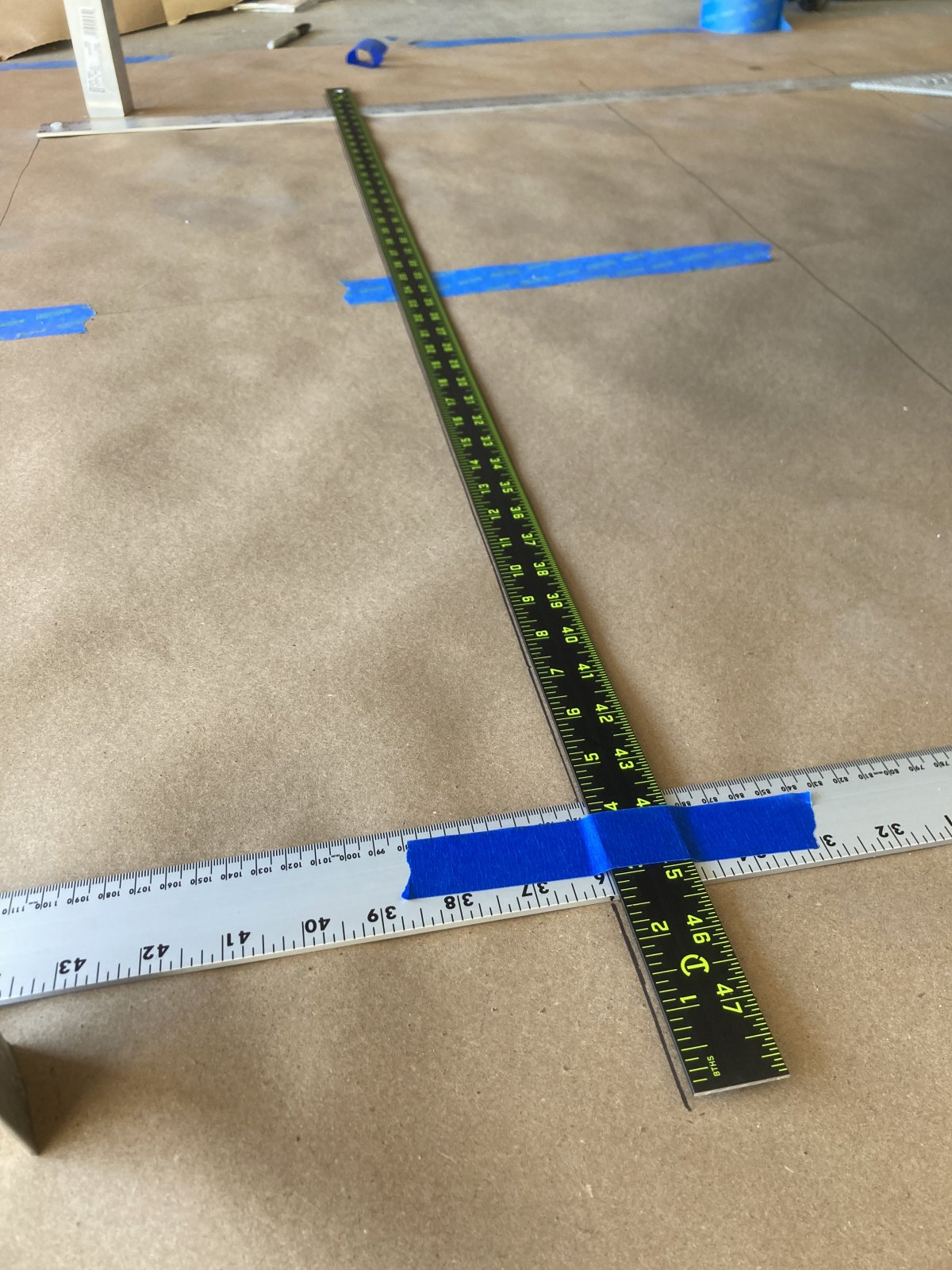

I decided to try and reproduce a CAD model of the front cowling. I think having a good cowling CAD model will help me get my final spoiler angles just right and could be good for future projects. After some brainstorming, I hit the hardware store and picked up some laser measuring tools.
I oriented and jigged up the cowling on an appropriate XY plane and drew out section lines to plot the vertical plane measurements down the Y axis. I then created numerous data points along the 9 vertical planes, and took the measurements.
I still need to flip the cowling 90 degrees and shoot some measurements in the X axis plane.
I will throw this data into the CAD, and then build out the planes using fixed point splines. It wont be perfect, but it will be pretty **** close.
