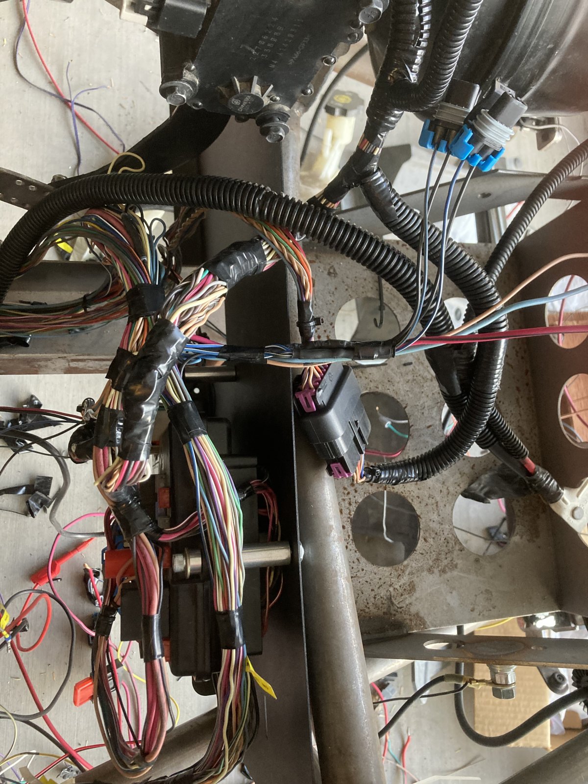

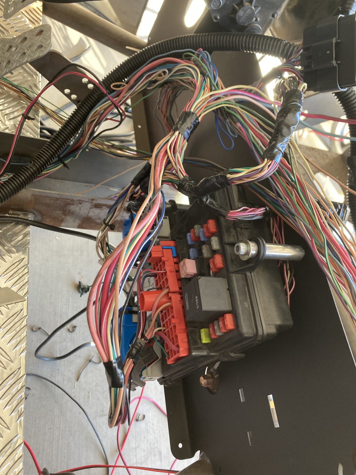

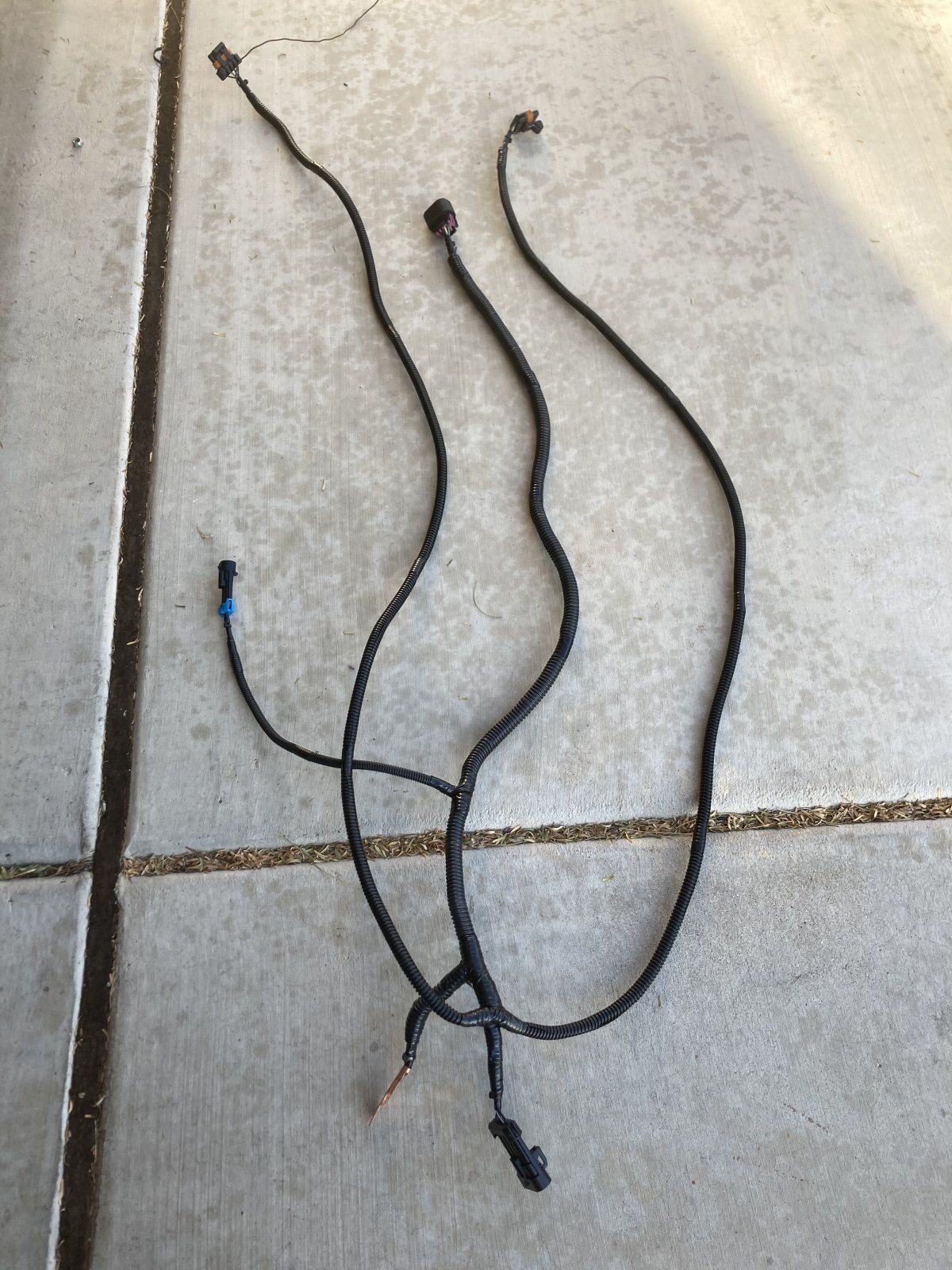

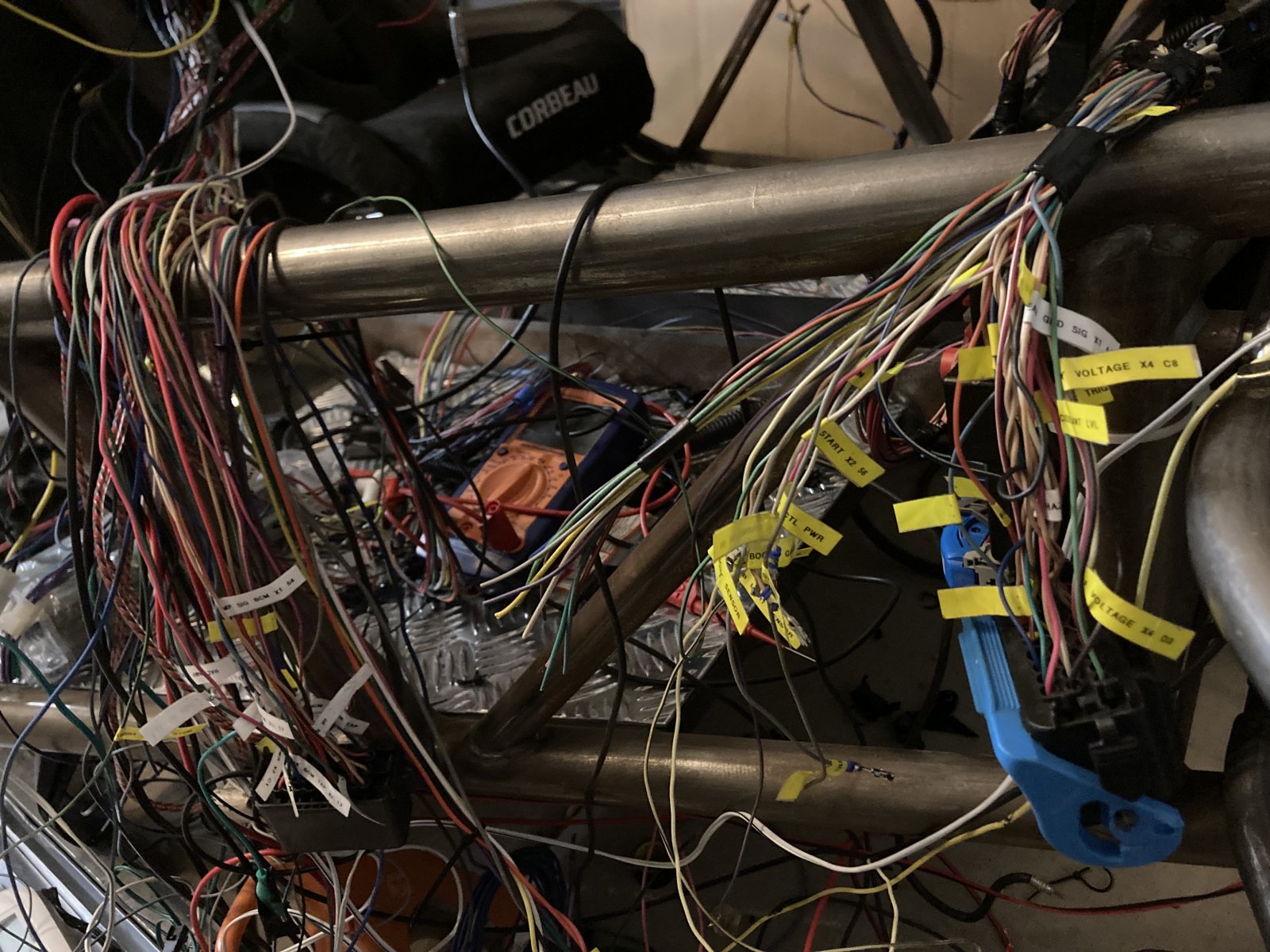

Got back on the build this last weekend. Re-attacked the wiring harness. Firewall fwd portion is wrapped and loomed. Now I’ve got 33 wires to attach to the dash from the body harness, and 7 spare wires that I added into the harness in case I need to add anything later.
I still need to wire in my fog lights and the fog light actuators and relays. I’ve also got 8 LED courtesy lights I still need to build a junction harness for and wire in.

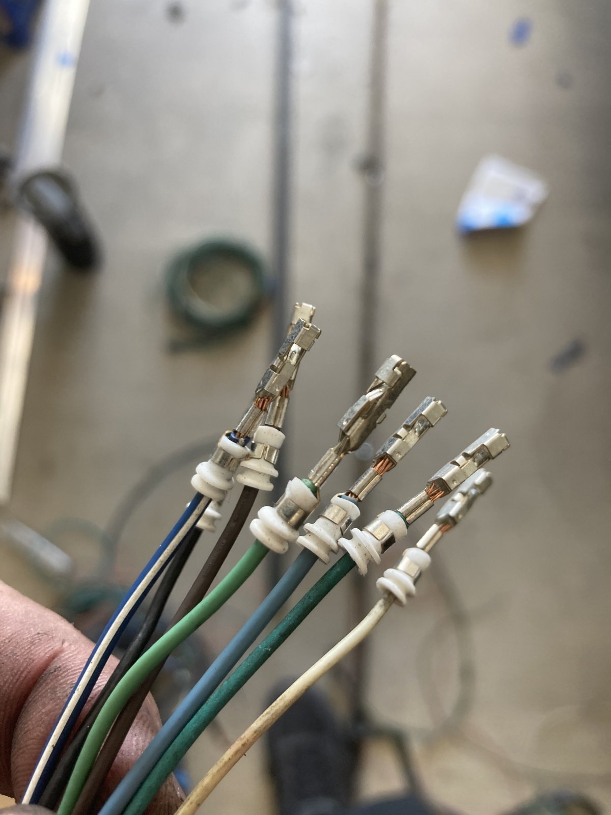

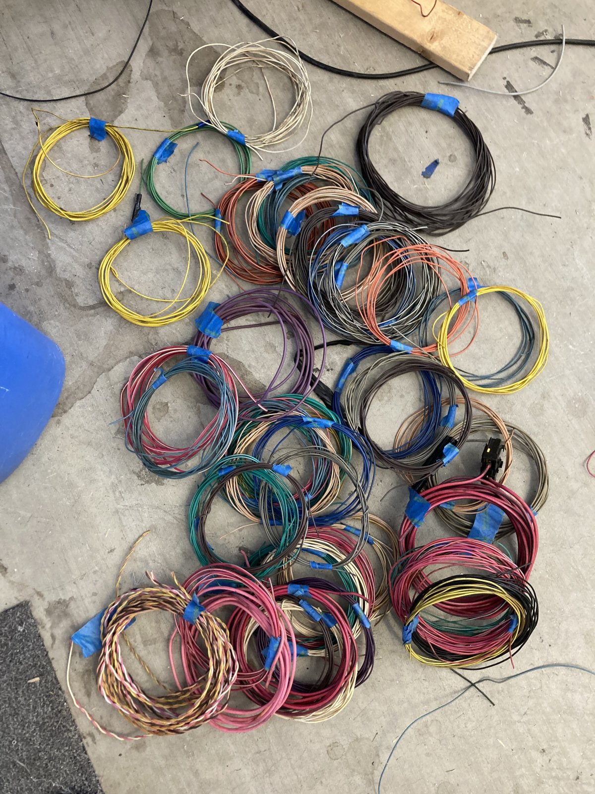

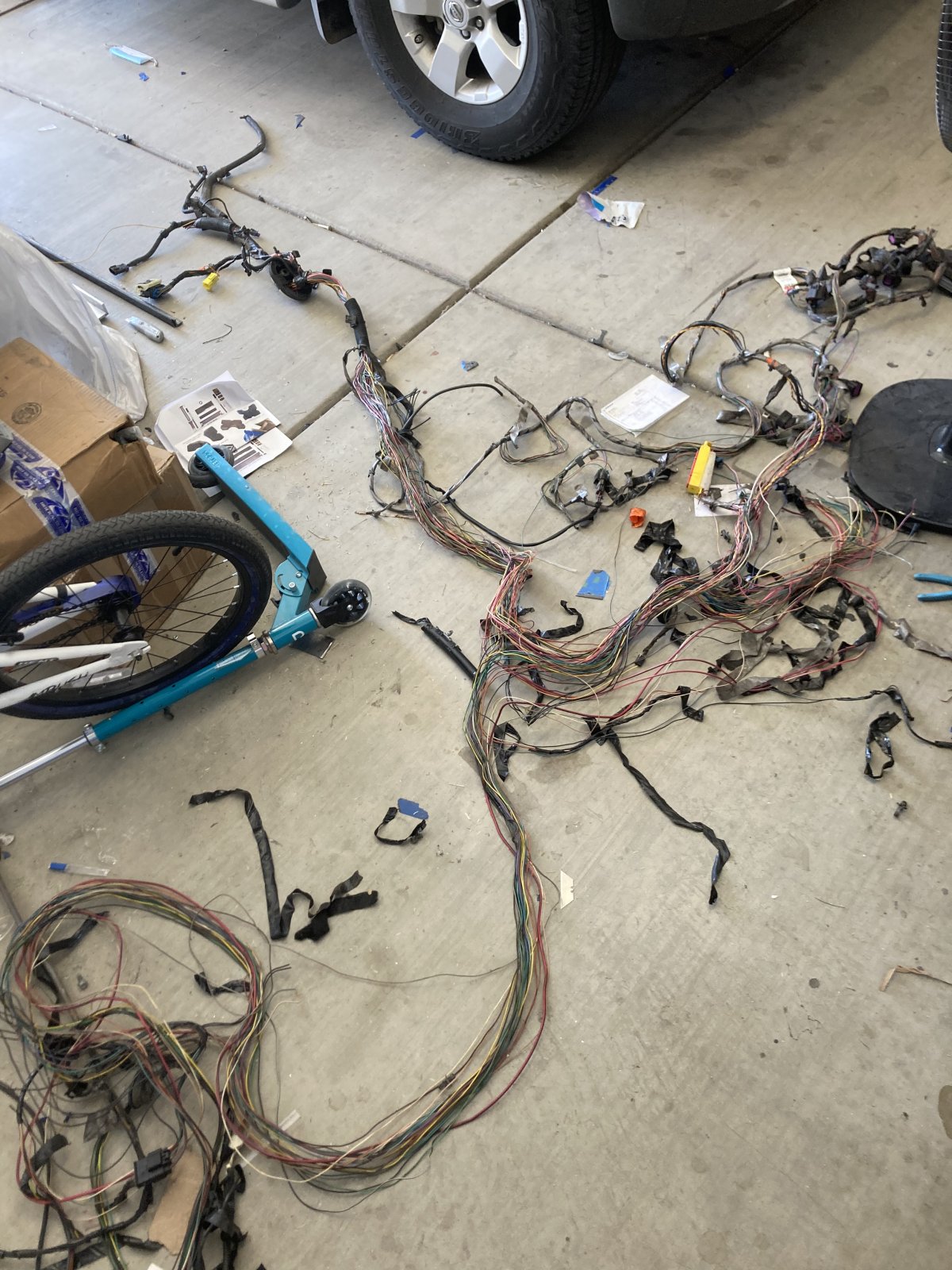

I had an extra Cobalt harness that I had pulled from a jy for around $5. I ran it across the garage floor, stripped the loom, and came out with around 300’ of nice quality wire. For the price of quality wire these days, the hour it took was worth it. I used some of it to add in spare wires for my existing harness.
Wiring the dash was super easy because I already had a plan. Kinda wishing I would have just designed my body harness from scratch to begin with as well. Its challenging and costly making harness run decisions on the fly.

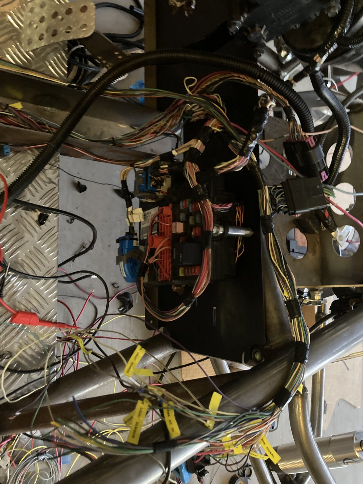

Harness is coming along. I scratch built a complete rear lighting harness today in GM style, and added in left & right side courtesy light connectors. I thought my tape job looked a little sloppy, but after looking at my brand new factory engine harness, I felt a little better.
The remaining harness design I utilized will make any future troubleshooting, removal or maintenance super easy. I still need the weather seals for my dash-main harness lever-lock connectors; which of course Mouser doesn’t have in stock.
Its not so much the bulk of the work as much as it is the stupid little details and the parts/time/labor that those little details require.

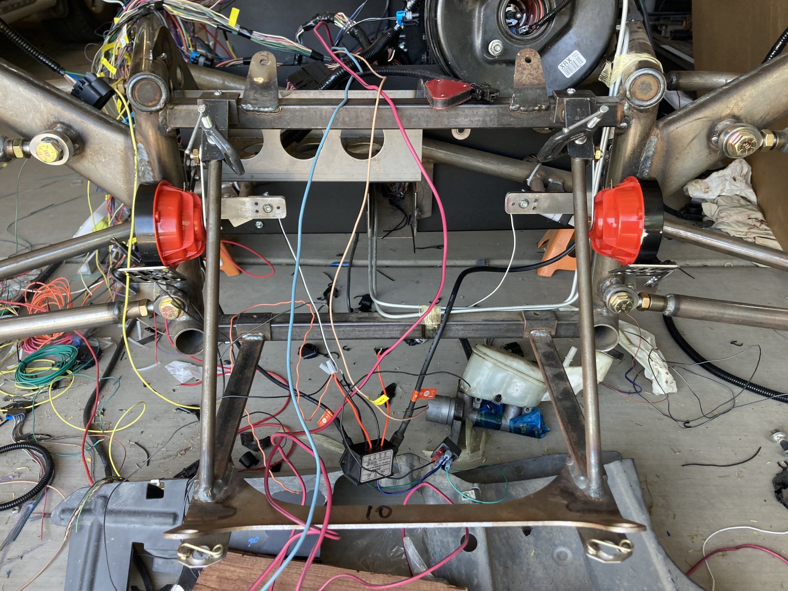

I guess my welding tank was empty. Swapped it out today to do my very last two welds, lol.

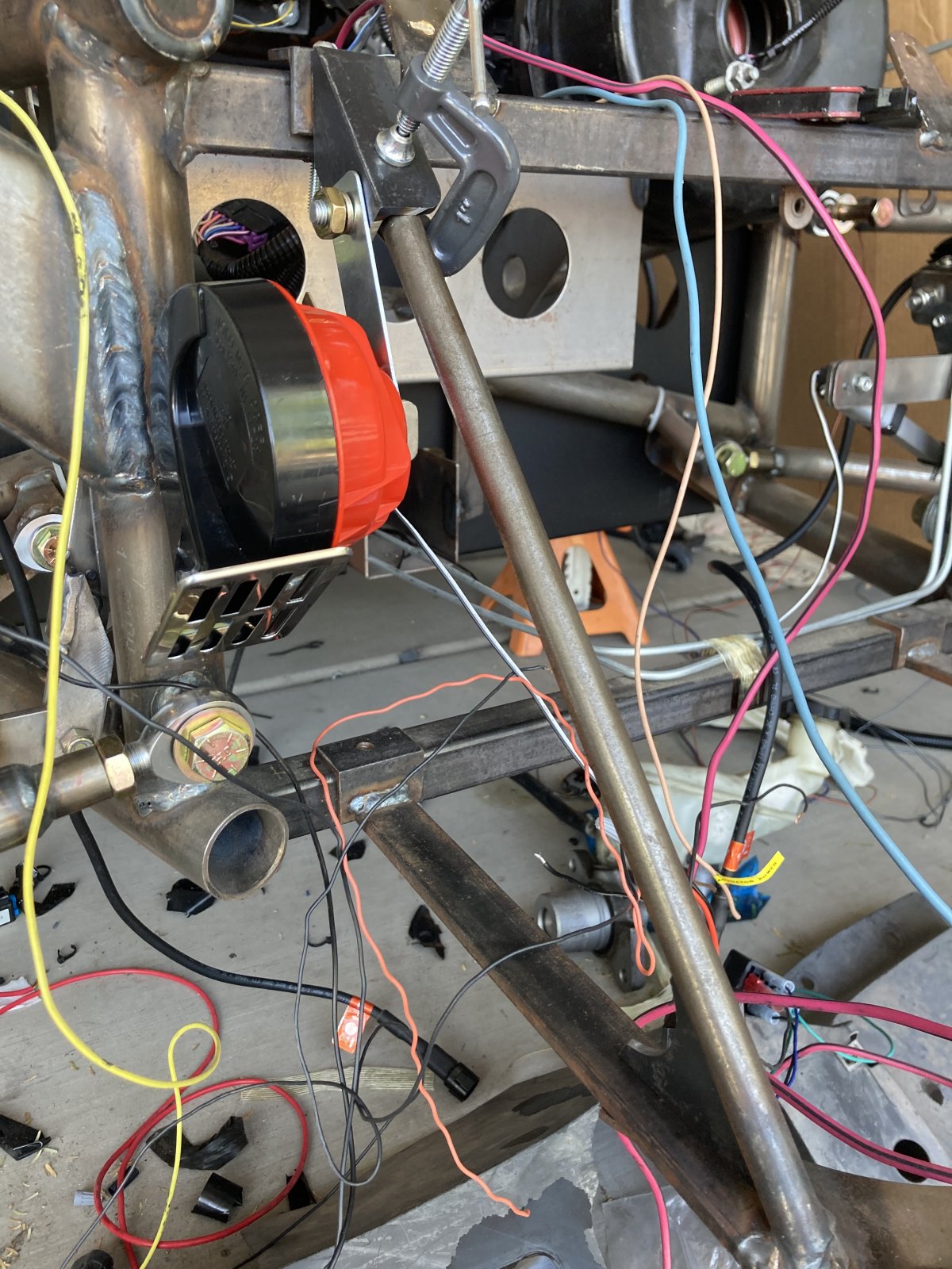

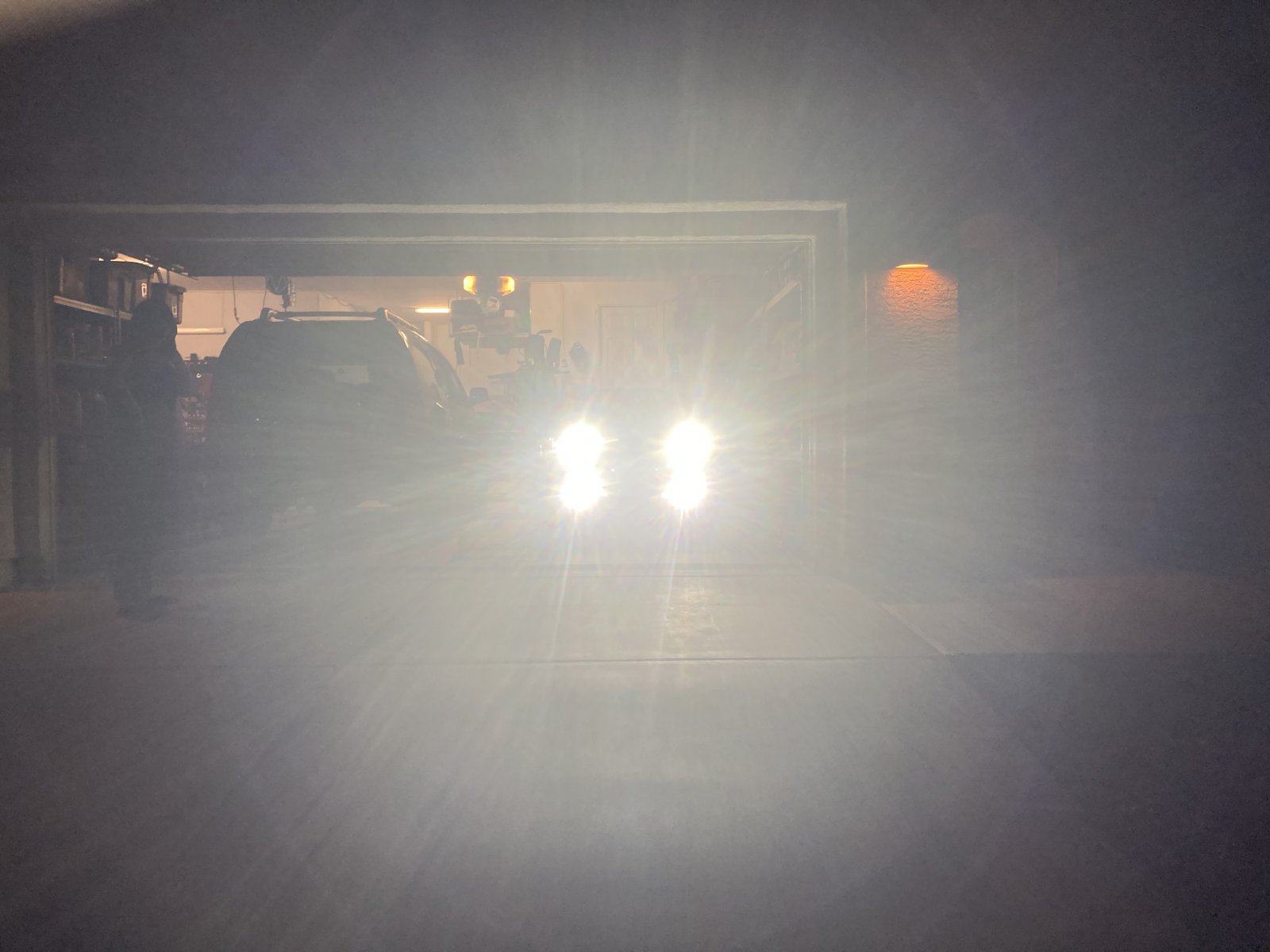

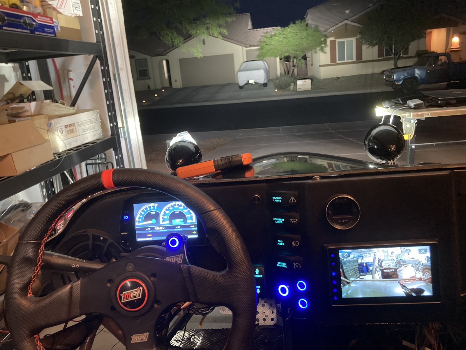

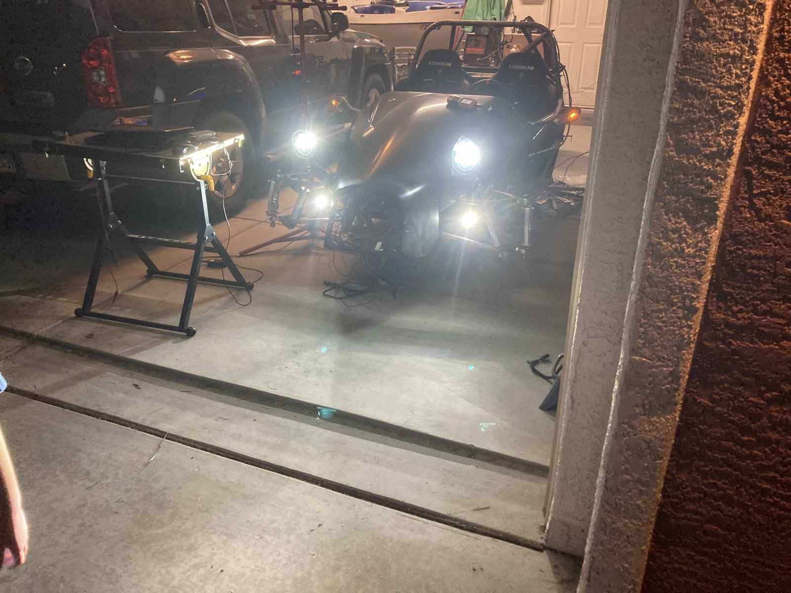

I designed some upper travel stops on the CAD, cut them out, and welded them in. Cleaned up the garage a bit, mocked up the rest of the front end, installed the fog lamp actuators and wired up all of the lighting.
For some reason, my front turn signal wires are not getting signal; will have to recheck the pins on the fuse block. Everything else works. Super happy with how the fog lamps turned out.

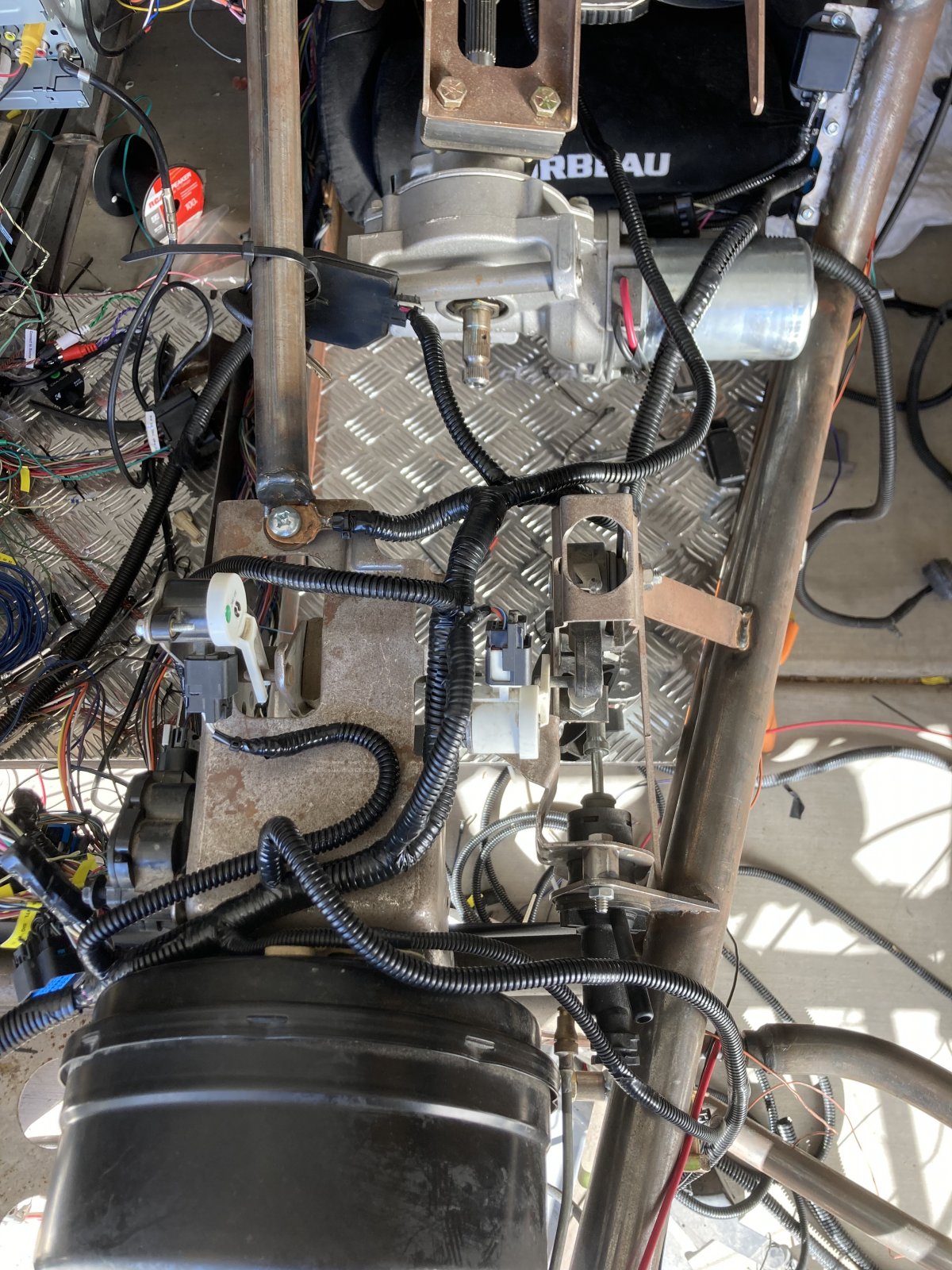

My next project will be getting the floorboards and center console properly mounted, and wrapping all of the wiring forward of the BCM,
as well as the dash harness I built.

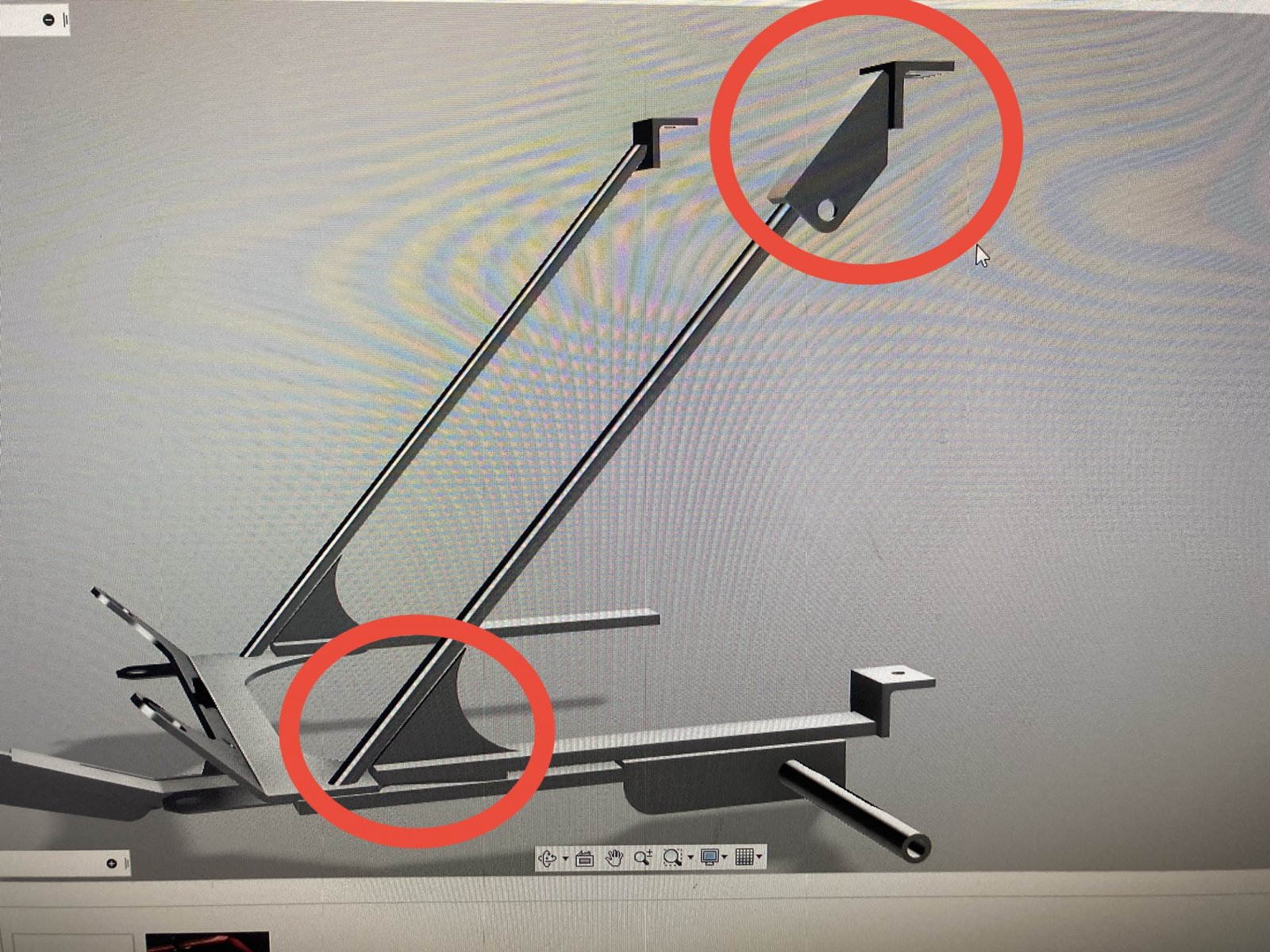

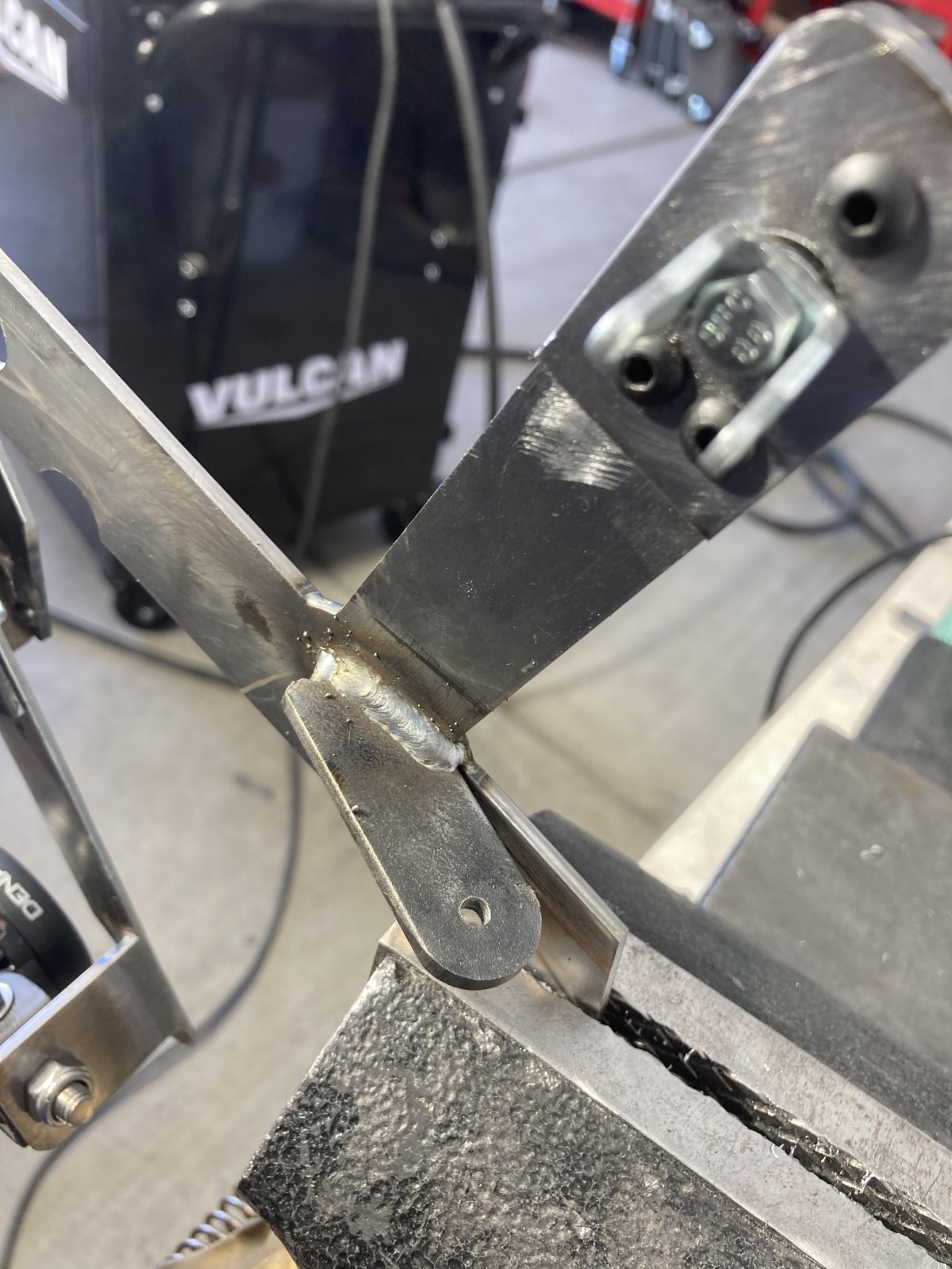

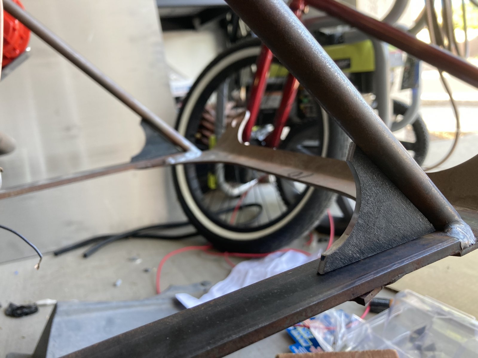

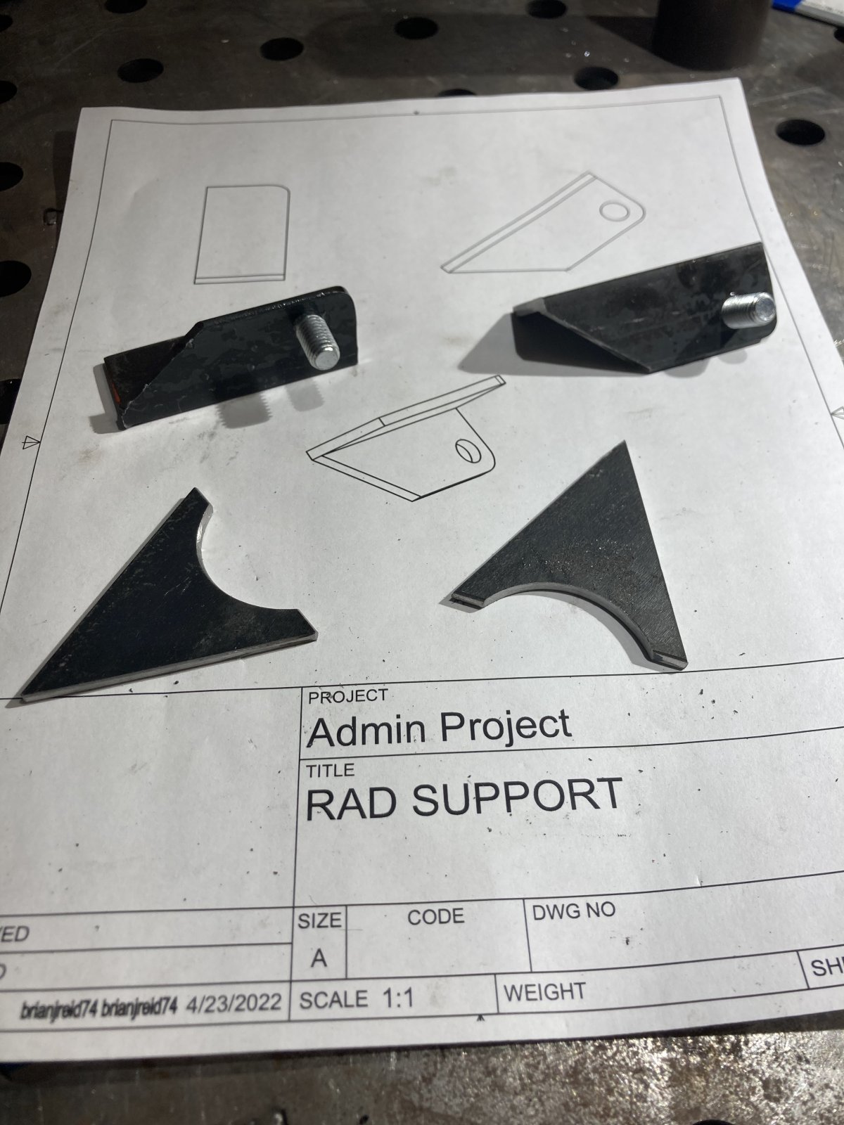

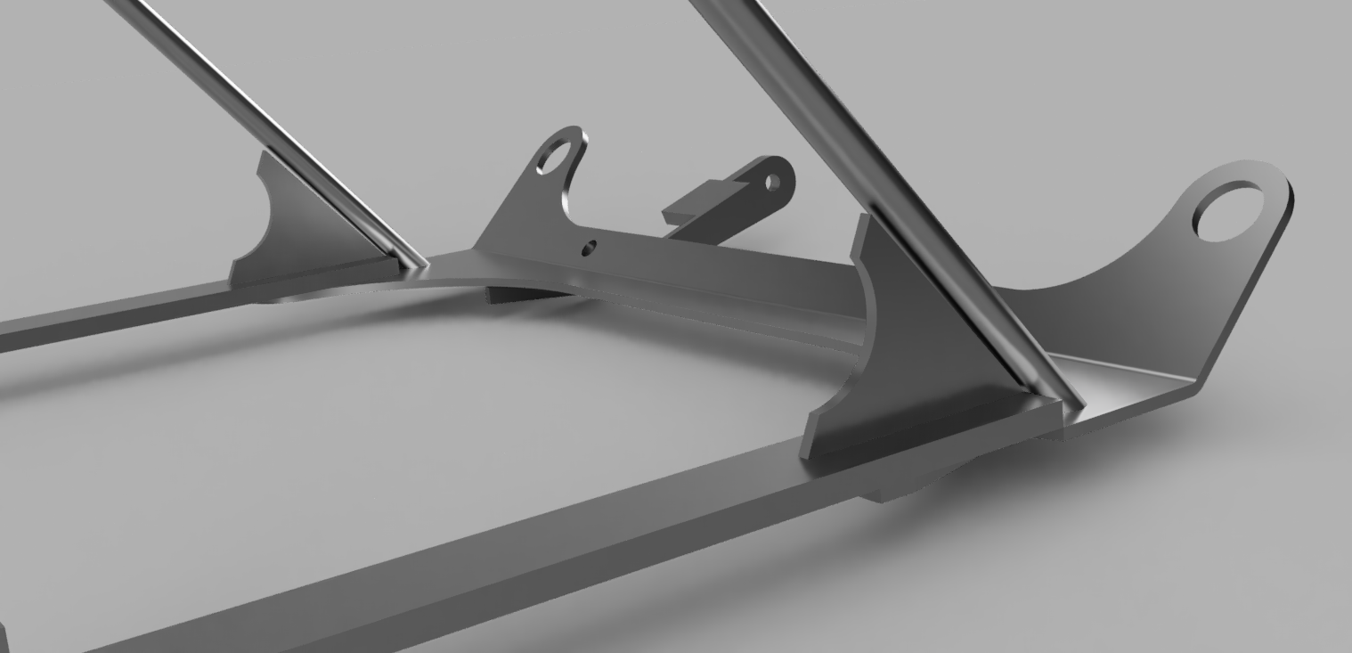

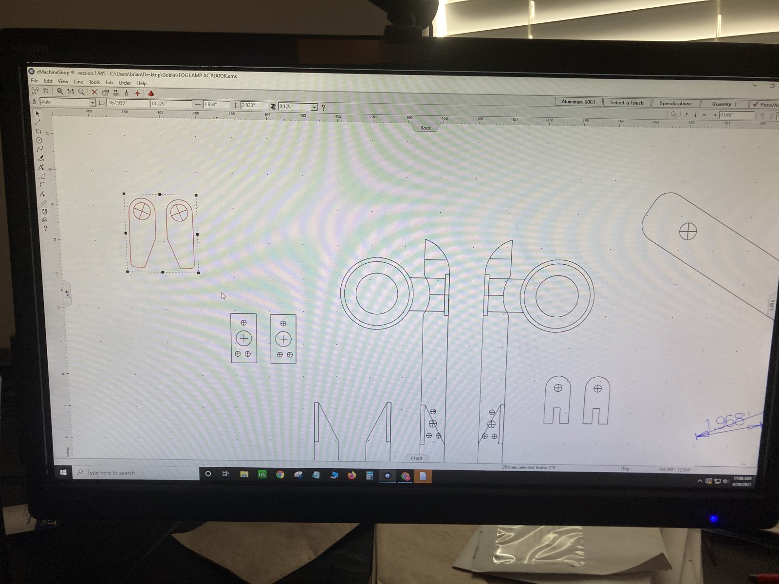

Spent most the day working through the radiator bracket. I really wanted to make the front spoiler completely bolt on, but I feel its just not safely feasible with how the rad support was built. I spent some of the day on the CAD, drawing out gussets. I then printed the drawings to use as cut templates. I made gussets for the bottom and upper supports that will also serve as mounts for my aftermarket horns. I will weld everything up tomorrow.
How thick are the alum sheets for the floor boards? Tying another one of those up front would “help”, but obviously not fix the lack of structure. I plan to do that and also use either alum sheet or composite to make some better baffling in the hood area…. To keep the warm air out of the cabin, but also encourage the air to flow thru the radiator, rather than over the top.

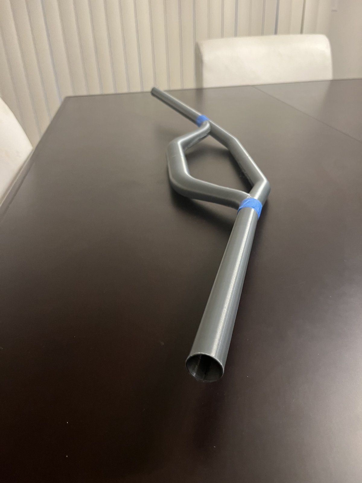

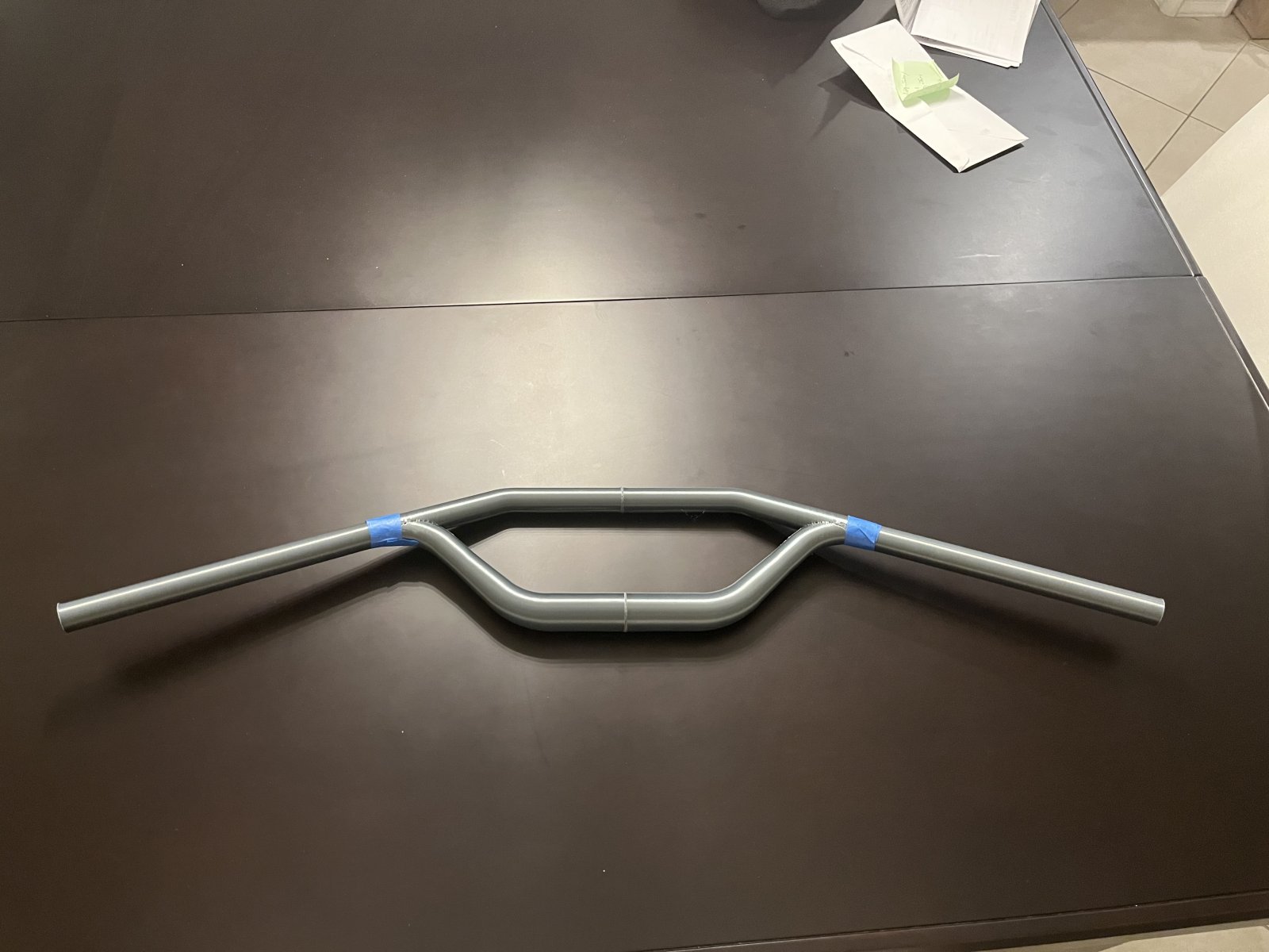

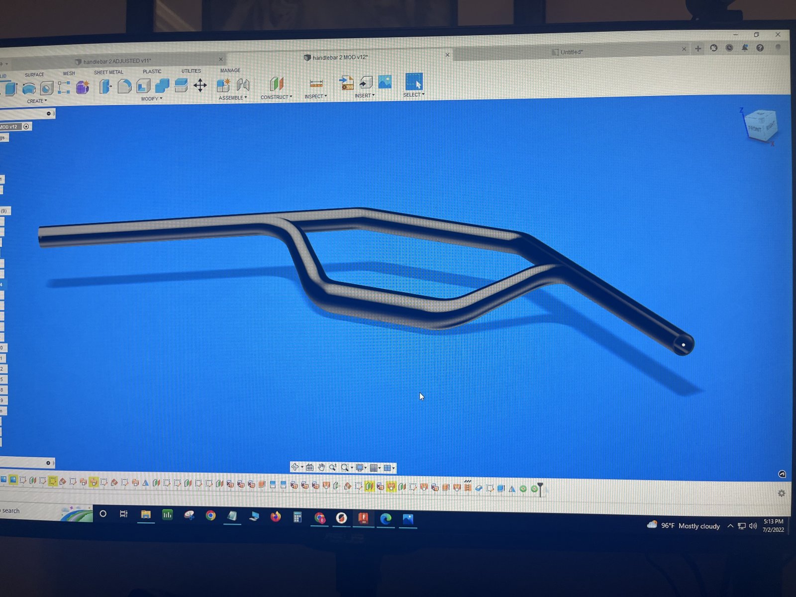

I picked up a CAD job designing some handlebars for a custom mountain bike company. I ran the requested dimension, added my own touches, then I refined the taper continuity tolerance to G2 continuity. For fun, I even played with a few 3D printer slicers to evaluate reproduction capabilities through the different stages based on contour quality; and I even printed a mockup.
Its uttely f— amazing what you can do on CAD these days. The machines aren’t that far behind.

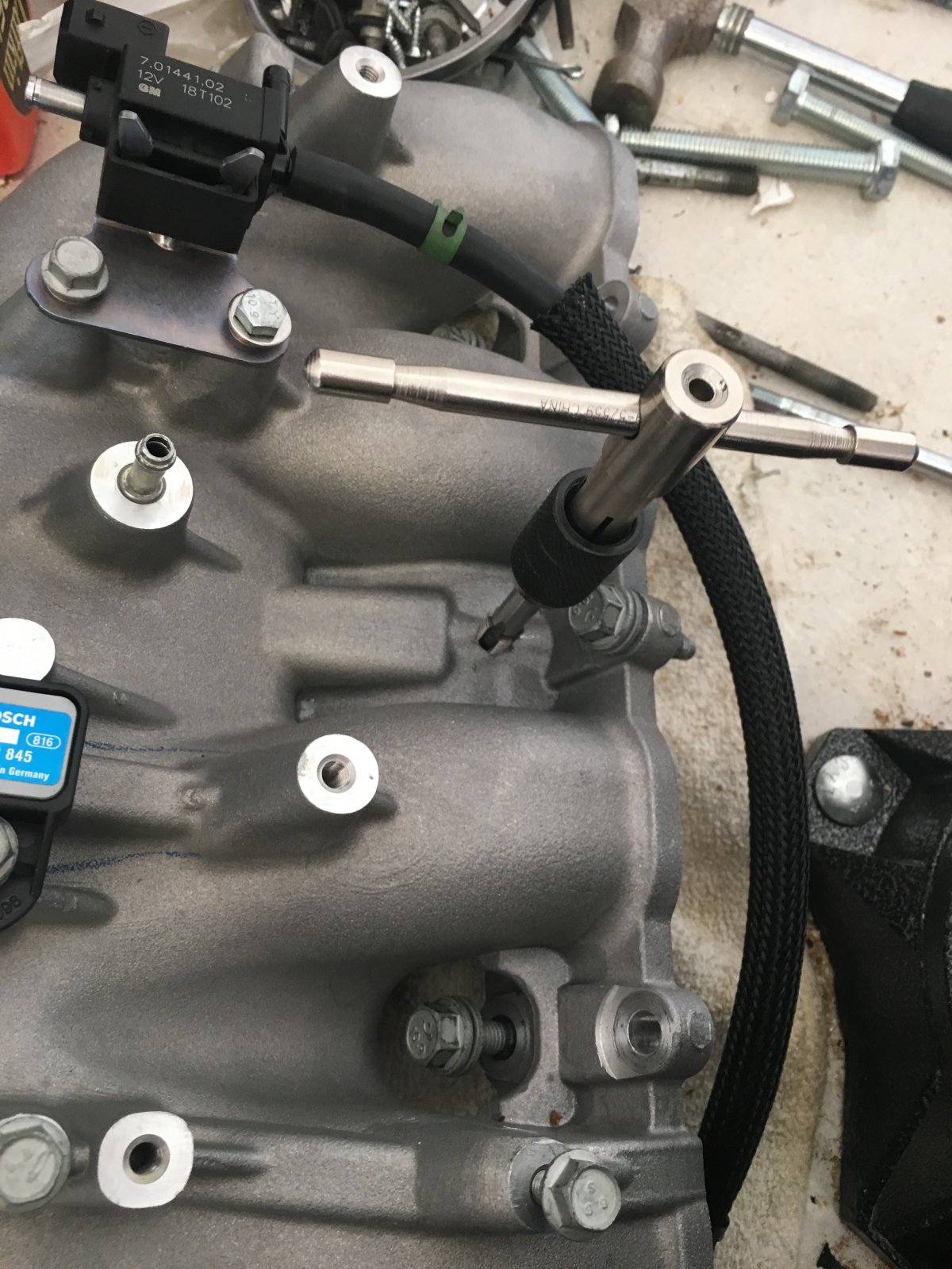

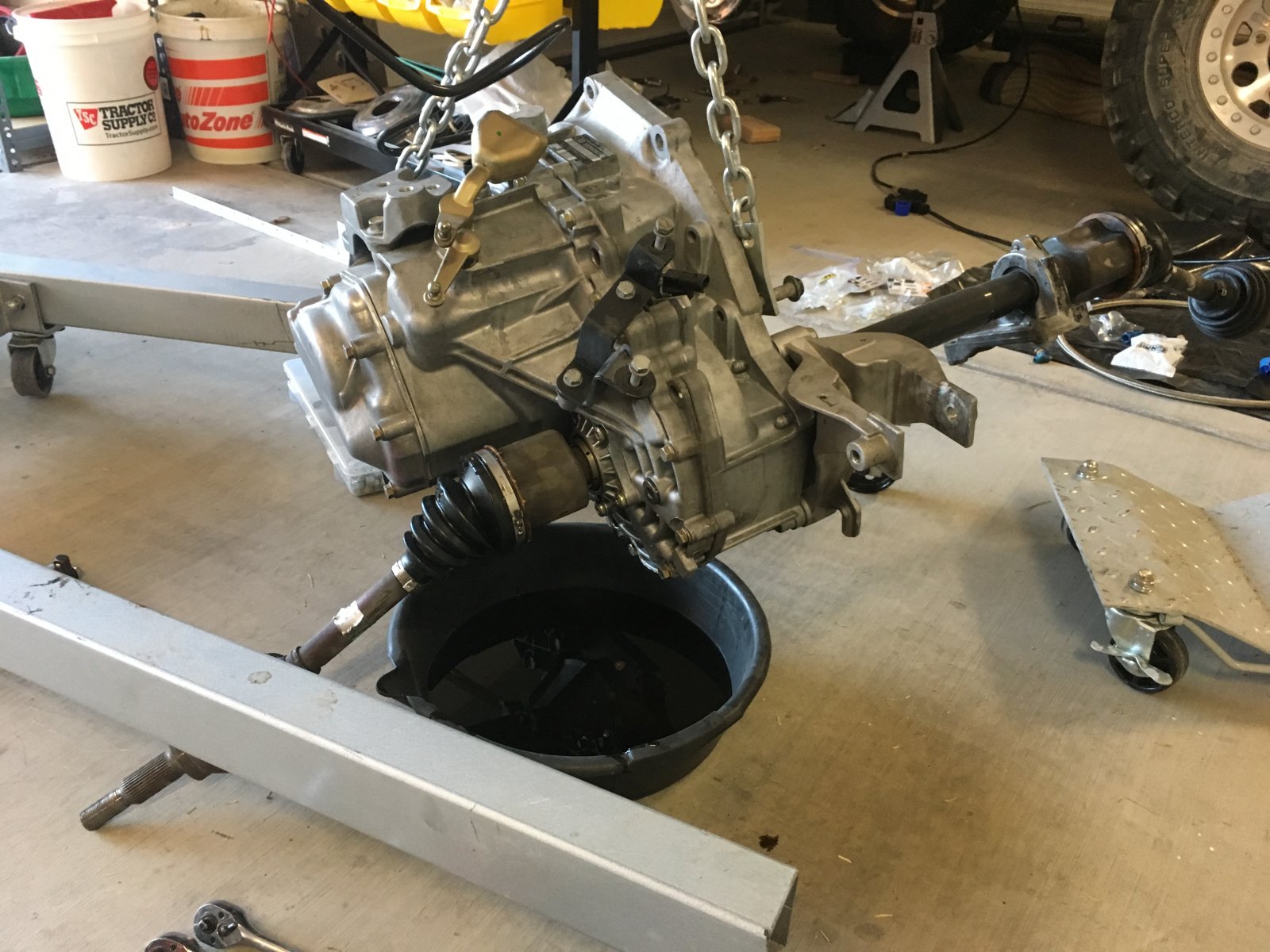

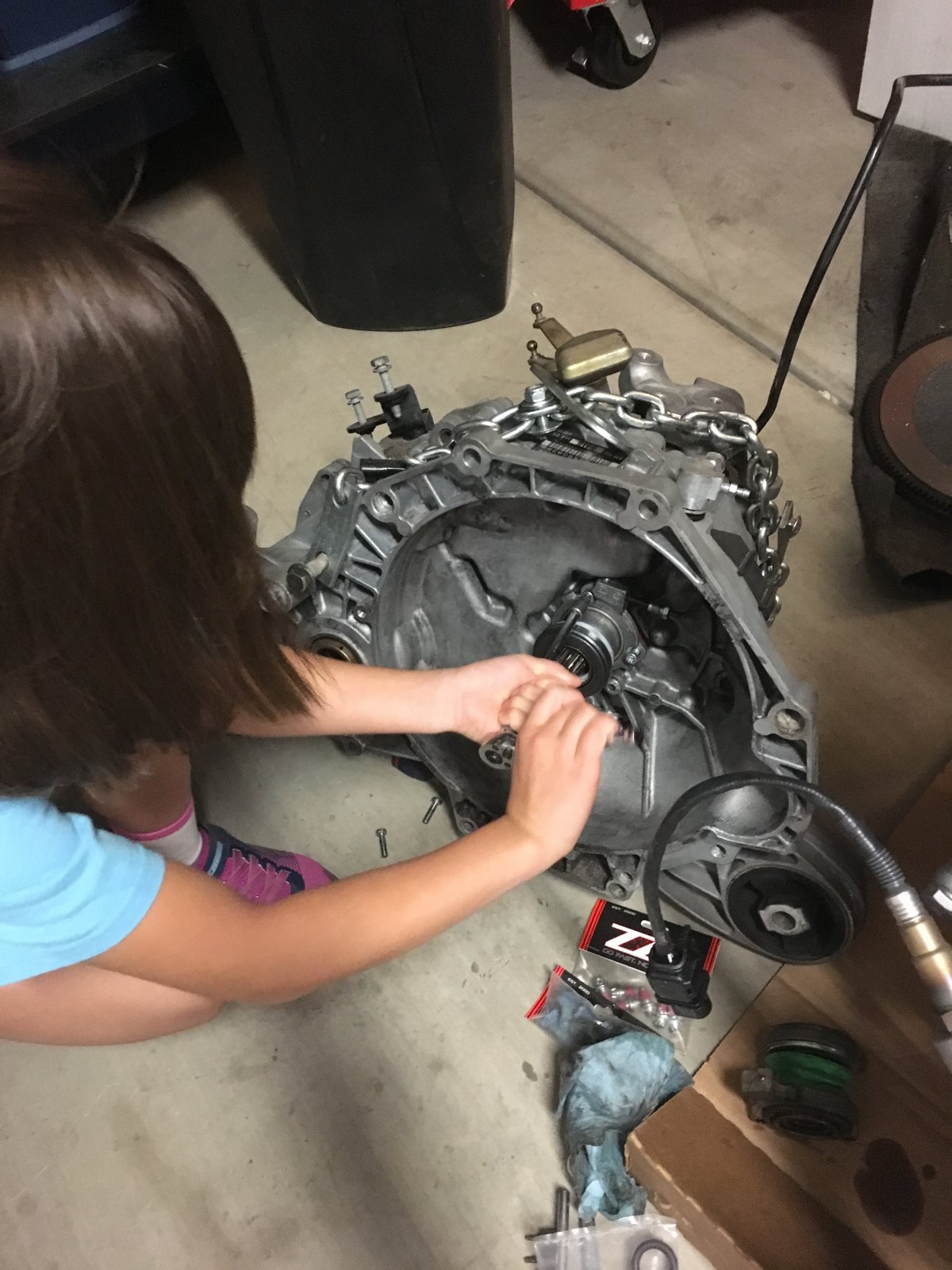

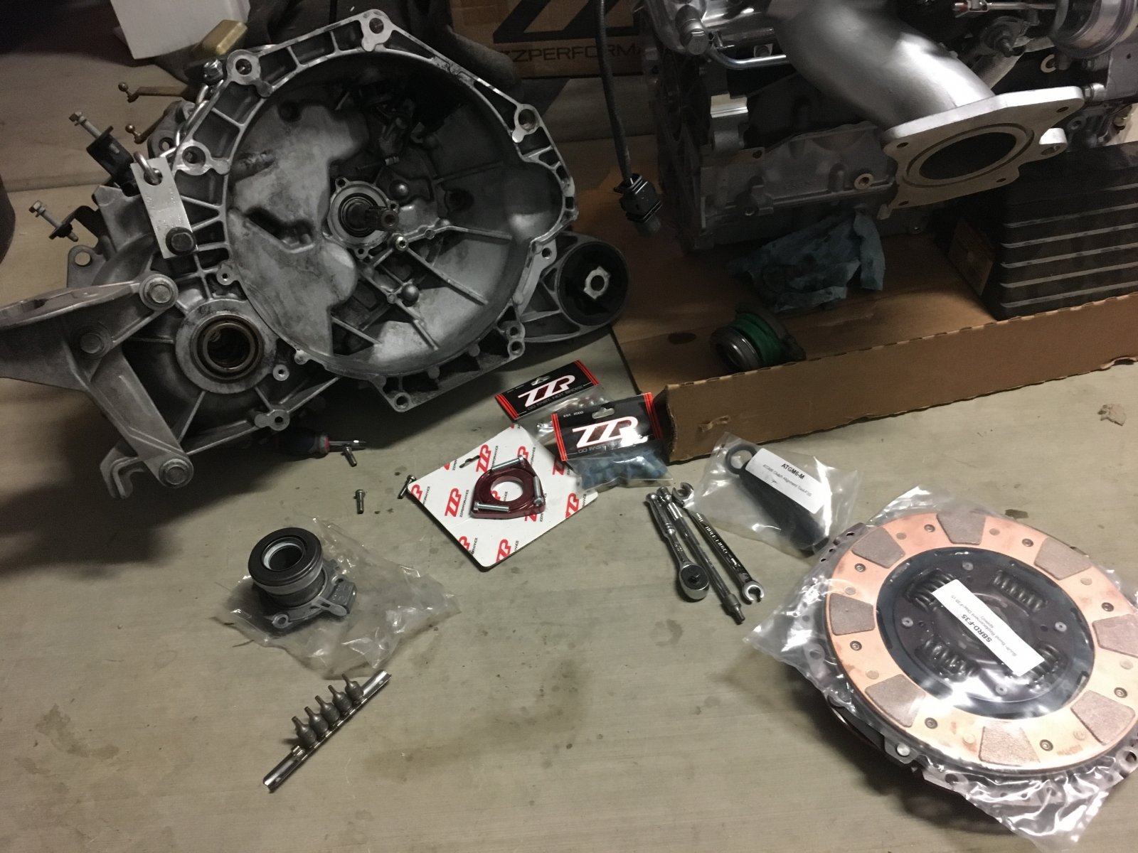

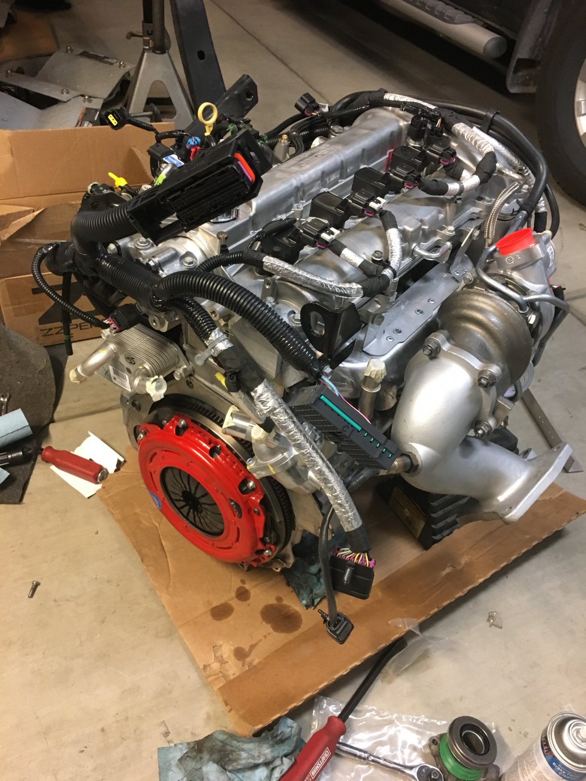

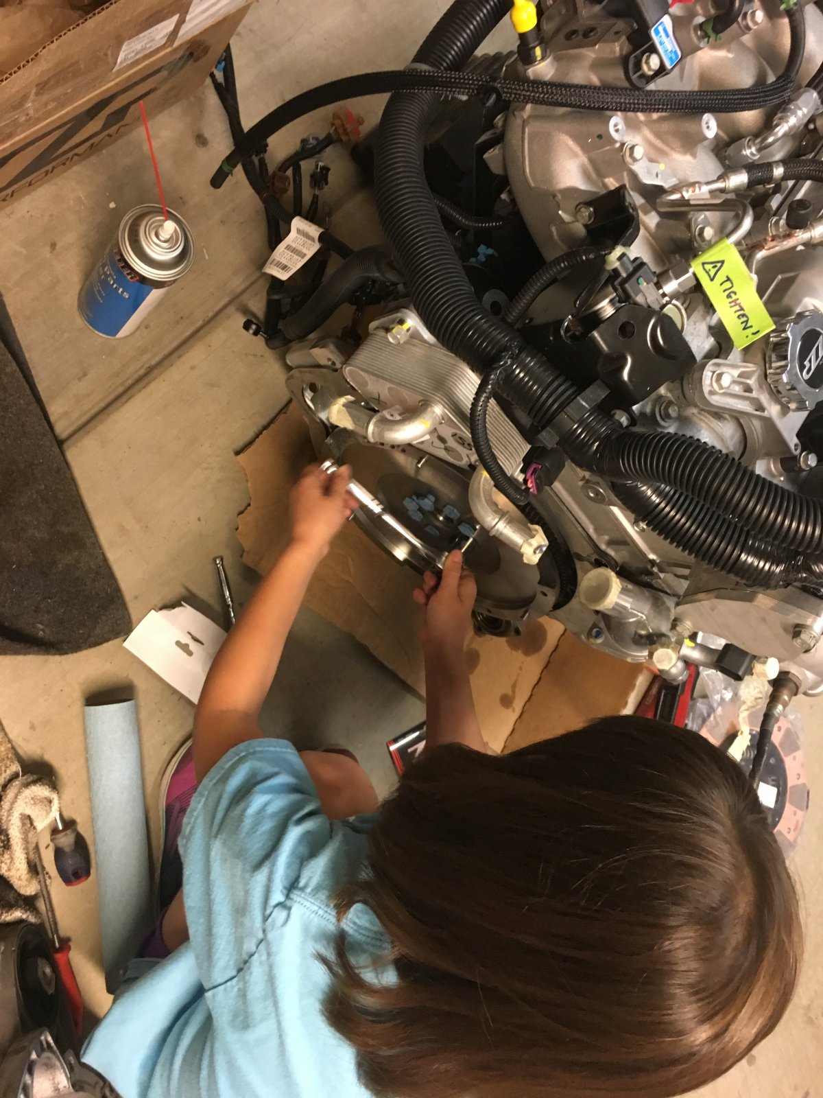

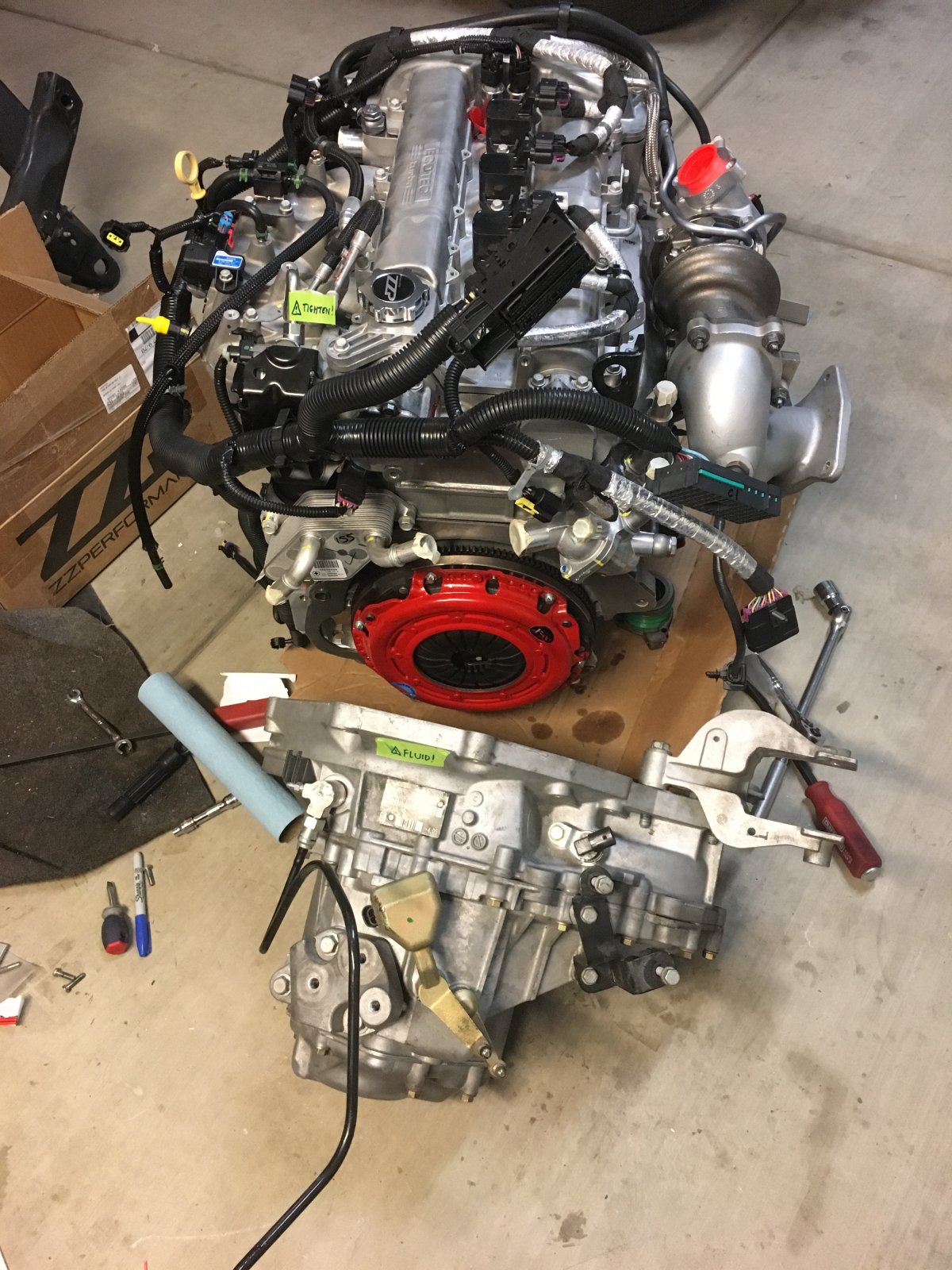

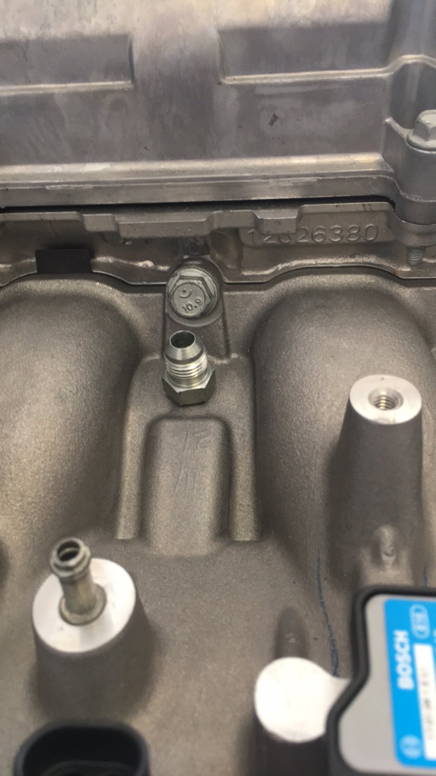

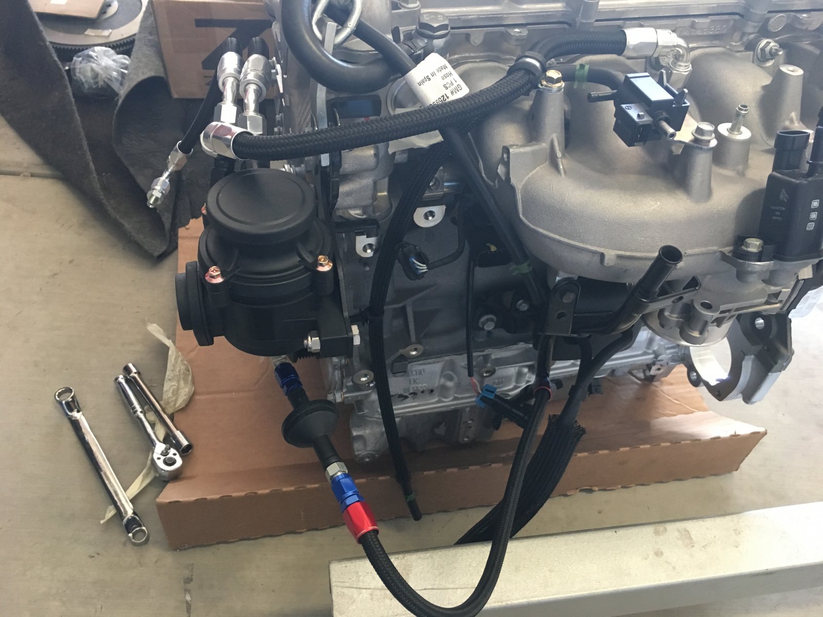

Installed my Powell Racing liquid/air seperator, got engine back together & new wiring harness installed, drained transmission, and installed new clutch.
View attachment 6925View attachment 6926View attachment 6927View attachment 6928View attachment 6929View attachment 6930View attachment 6931View attachment 6932View attachment 6933
Brian, sorry to bring up such an old post. Did you remove the intake manifold to install the plug in the PCV port for the Powell system? Did you have to do any drilling to tap the port for the plug? By chance any photos of this? Thanks!
