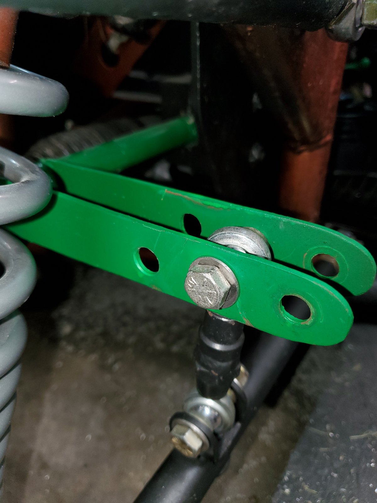

The other reason you had to increase the spring rate is you lowered the instan roll center with the upper control arm. making more load on the spring. Maybe make a 1/2" rear bar and lower the spring rate.
Brad
Also lost some travel in the rear but it feels like travel is more important in the front. Added stiffer setting on FSB for next test and tune at Richmond raceway.

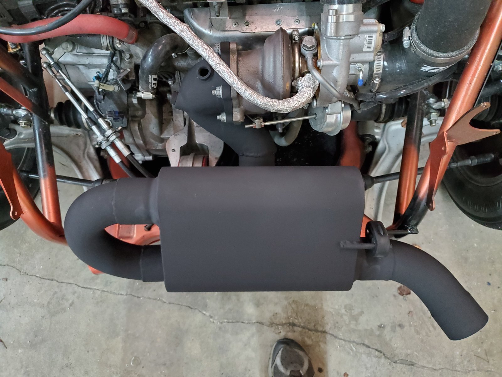

My cheesy exhaust was too loud. Last autocross I could see the starter covering his ears every time I took off. Was hoping the turbo kit would make it more tolerable. Fashioned a new exhaust from speedway stock parts. All 3 inch 1 U 1 90 and a chambered muffler. Added 1 isolator on the rear passengers side for extra support.. Sounds much better.

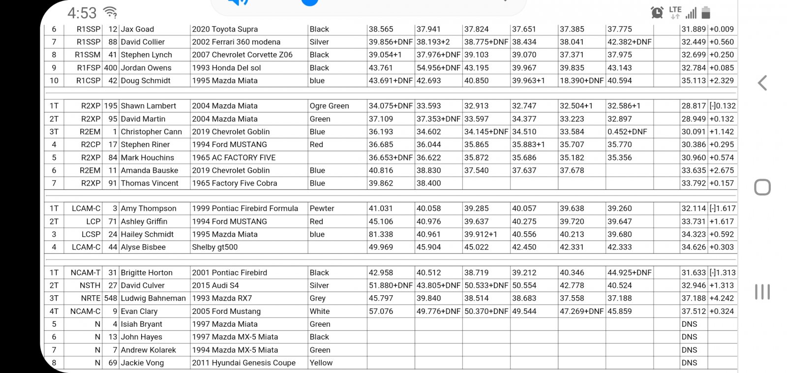

The suspension modifications have worked well but not fast enough for an FTD. There was a pretty zippy turbo miata I was not able to catch either of the drivers. Someone had mentioned it weights 1200lbs which is pretty unbelievable (most likely 2200 as its run in xp)This was unfortunately my first dry event with the turbo working correctly and was not able to get the times down fast enough before the failure.

Hmm, 1200lb Miata is a stretch - even if it had speedholes! Sorry to hear about the mechanical issue, hope it's not too serious. Looks like you were turning in some good time too.

I don't believe it either, but it was pretty darn fast lol.
Its run in XP being turbo and rwd its minimum weight has to be at least 1900lbs.

The suspension is doing very well. The rear is biting better out of the corner. Almost zero bumpsteer. Car is completely controllable even when putting down gobs of power. Taking Ackerman out of front helped with that also.

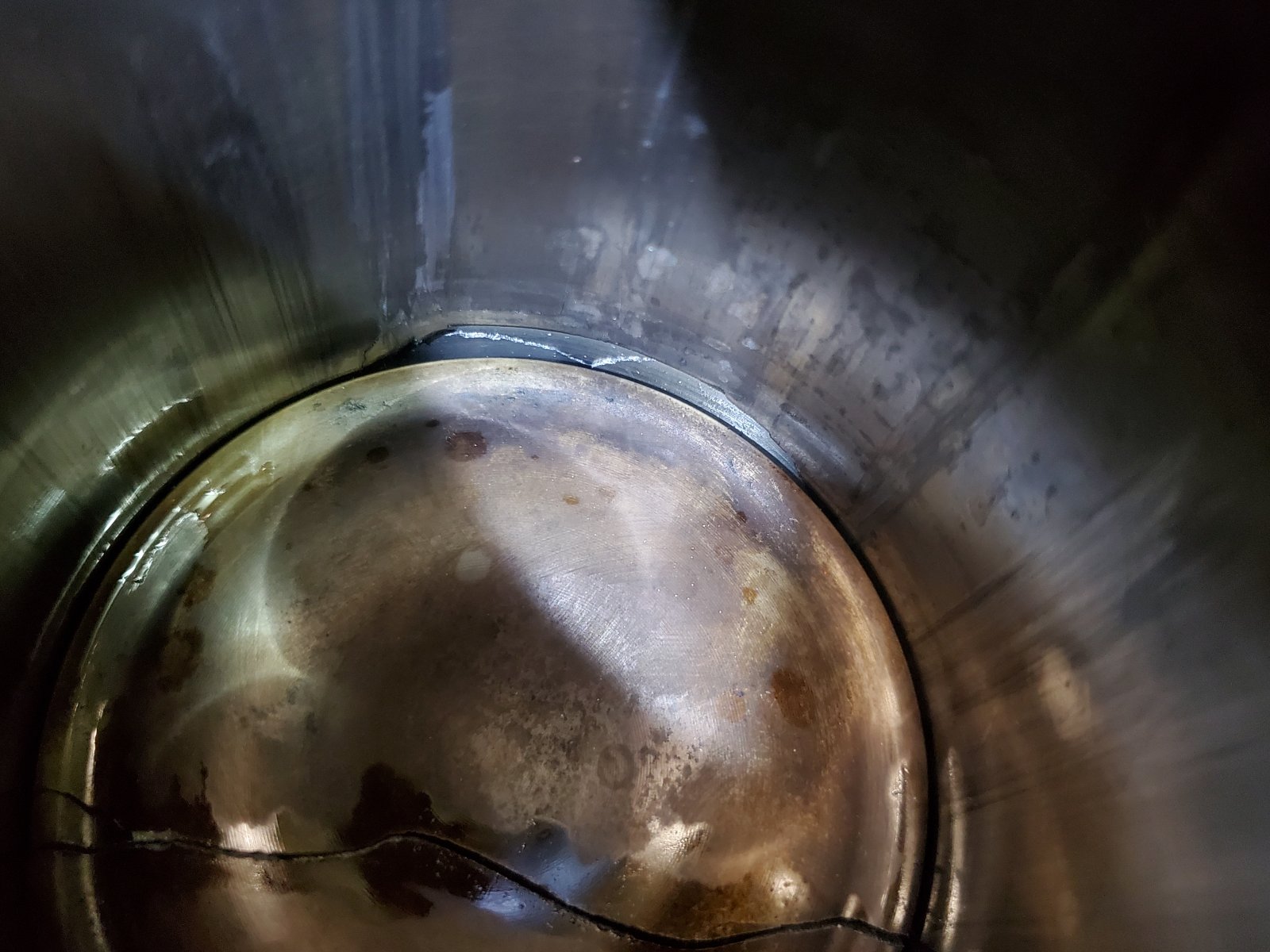

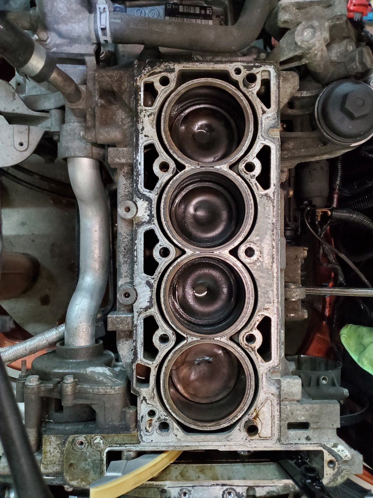

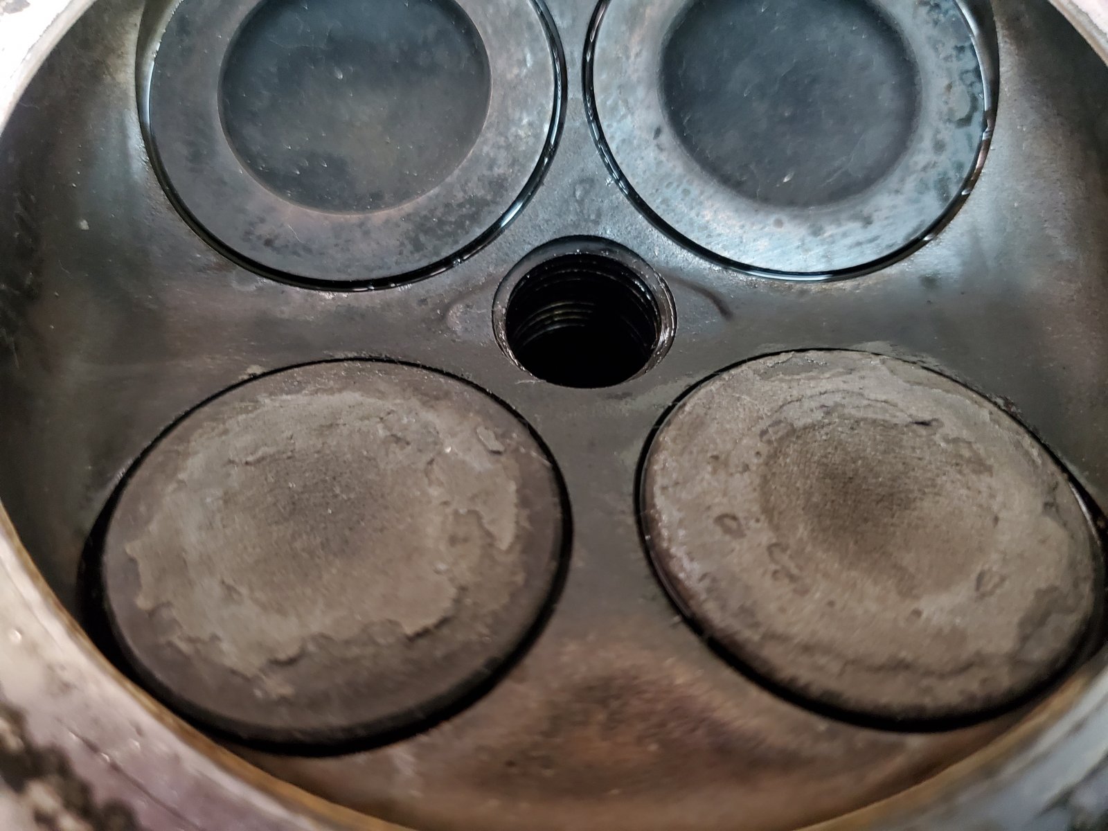

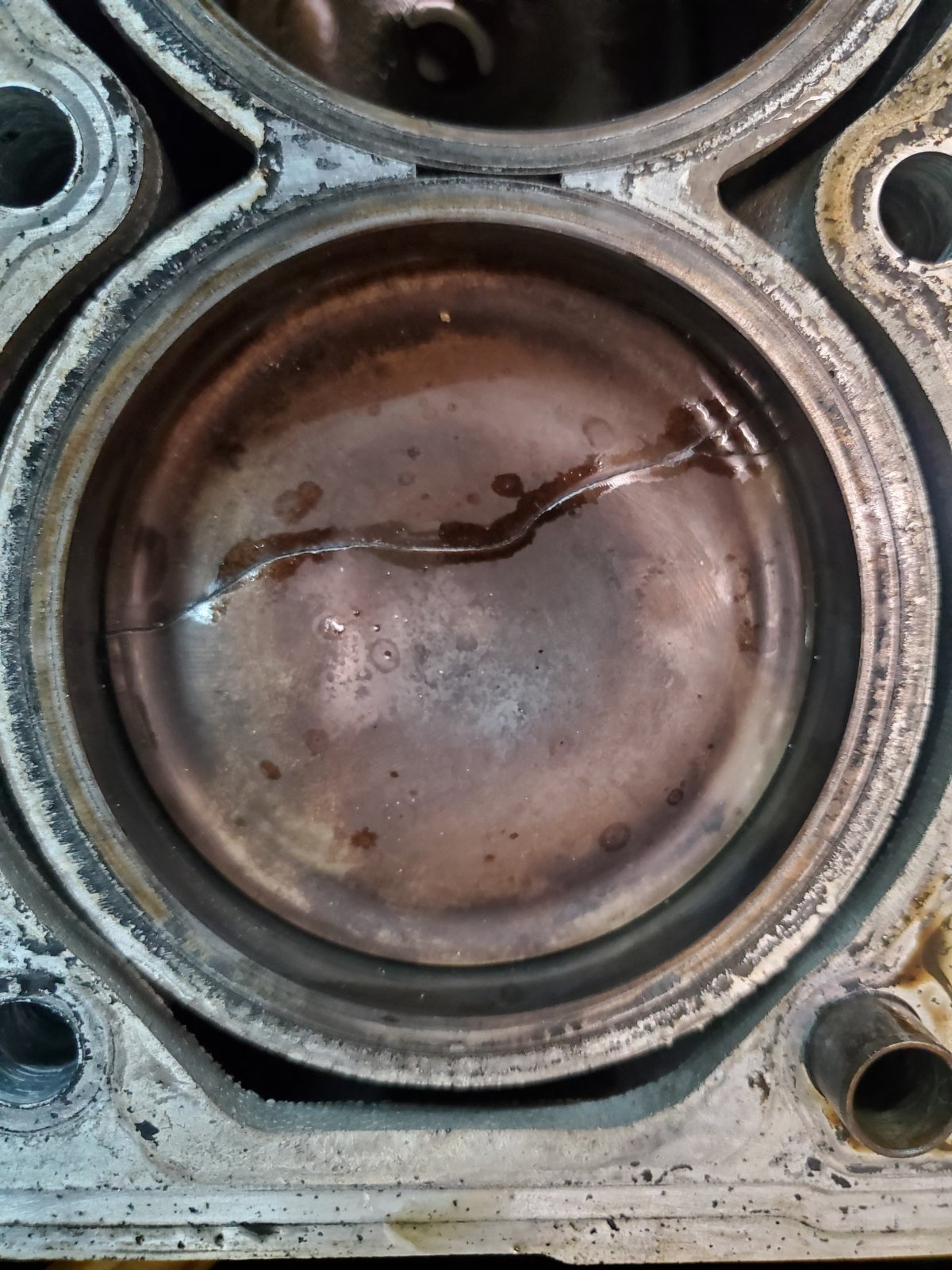

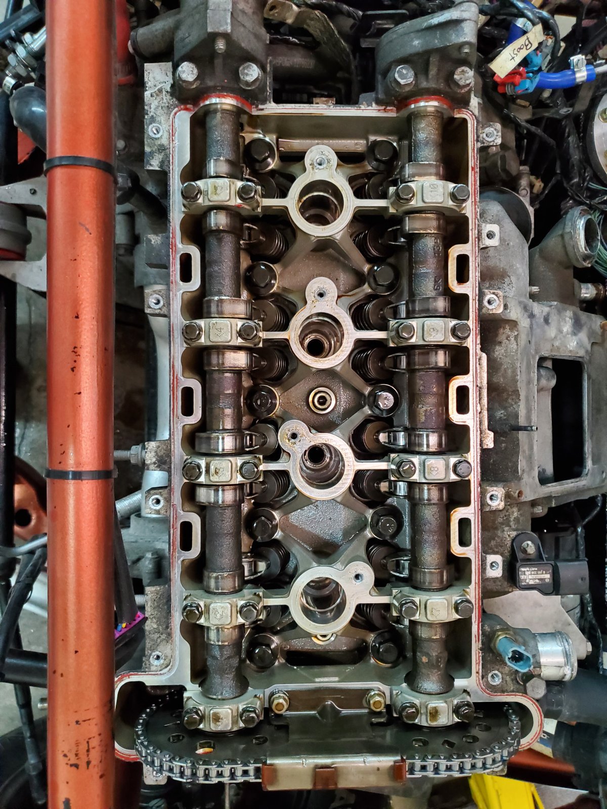

Piston cracked cylinder 1. Valves look like 200k miles have definitely caused some wear.This is rebuildable right?

Should be, as long as the cylinder wall is not scored badly. The piston looks a little cooked to, maybe it went lean for some reason - check the fuel injectors. Lots of new parts and elbow grease will get you freshened up motor to play with again. :)
Did the cracked piston score the bore?
Is the head flat? Or is there enough aluminum left to allow for re-flattening?
If you pass those tests, usually you are good.
Clean up the parts, and do close inspection at a machine shop, or do it yourself, is the best bet.
They sell color dies for inspecting for cracks. I have had good luck with DIY color dies, and successfully found & repaired a crack in my oil pan.
ccannx

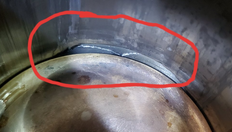

Looks like the sleeve melted towards the bottom and the block behind it looks cracked.

I think the sleeves are removable and replaceable. Not positive though.
I saw in one of the cobalt shop manuals a tool for pulling the sleeves out.
Waterdriver
If the block casting is cracked, its junk.
Not sure if it's just the picture, but it looks like the cylinder isn't round anymore? Is that were you see a crack in the block? Behind this area?

Yeah looks like the sleeve melted there and that is cracking in the aluminum block.

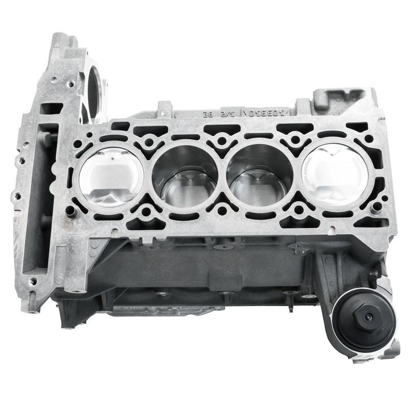

I read somewhere gen2 and 3 made improvements in this area with cooling and strength. The gen 3 LSJ bottom pictures on zzp's site look alot beefier around the sleeves.
