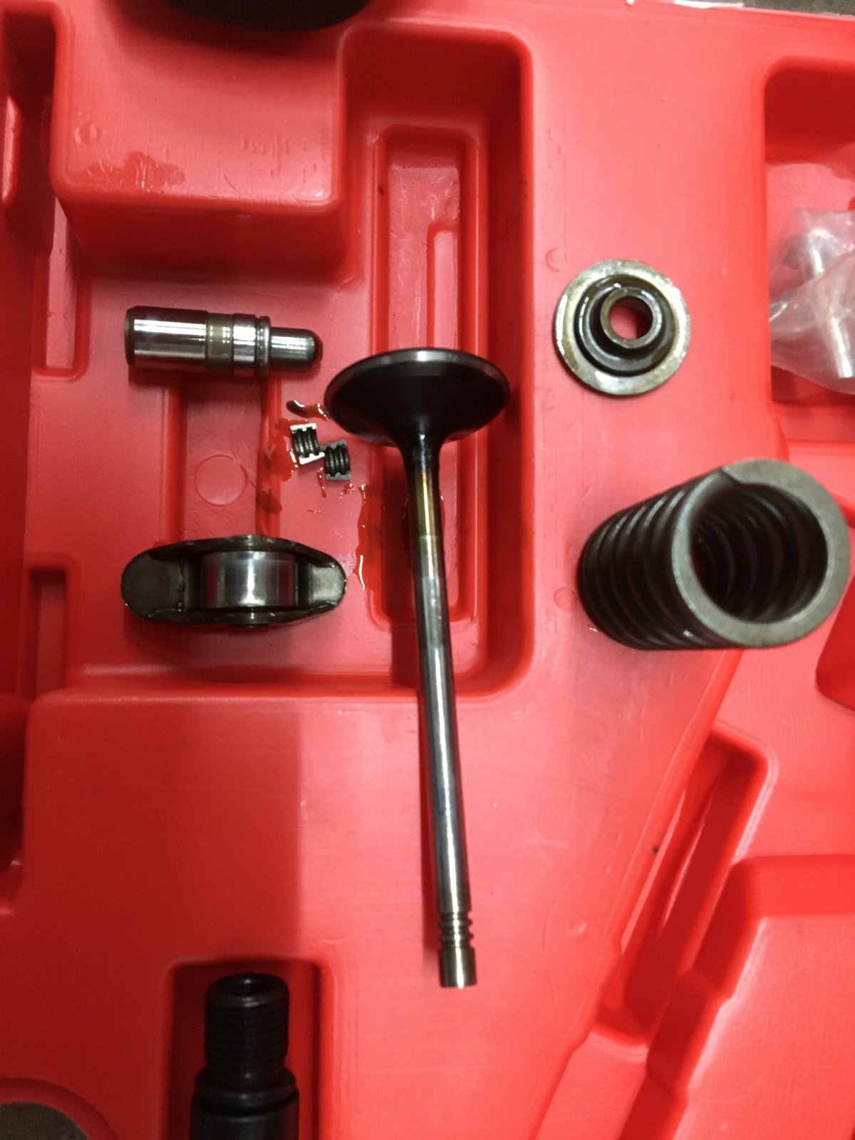

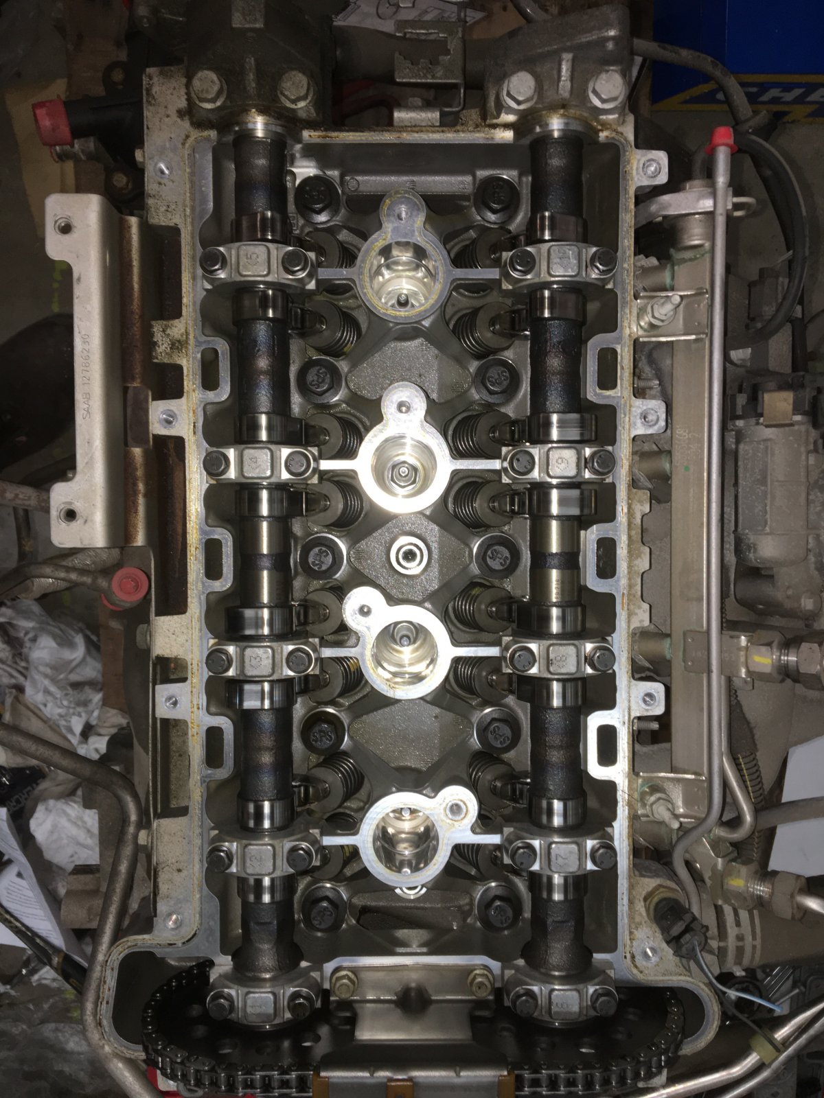

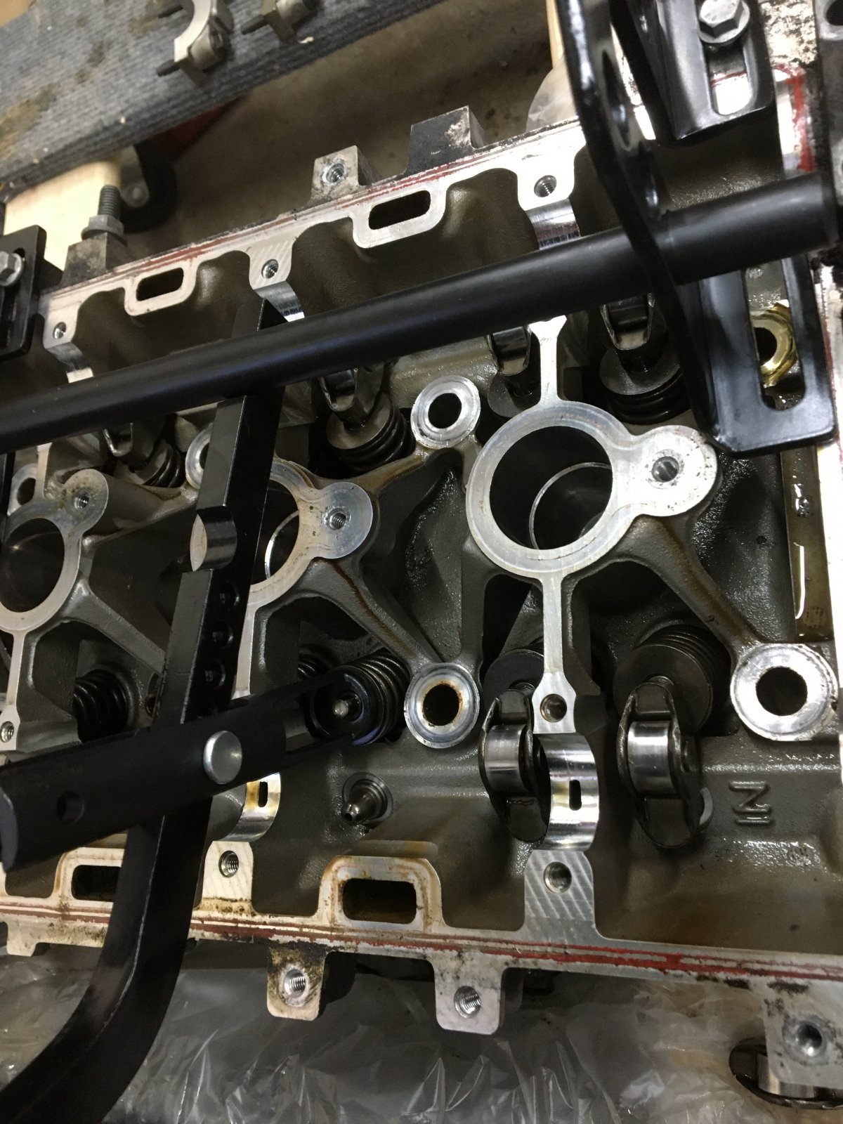

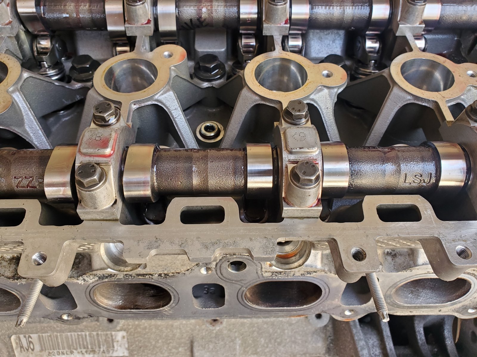

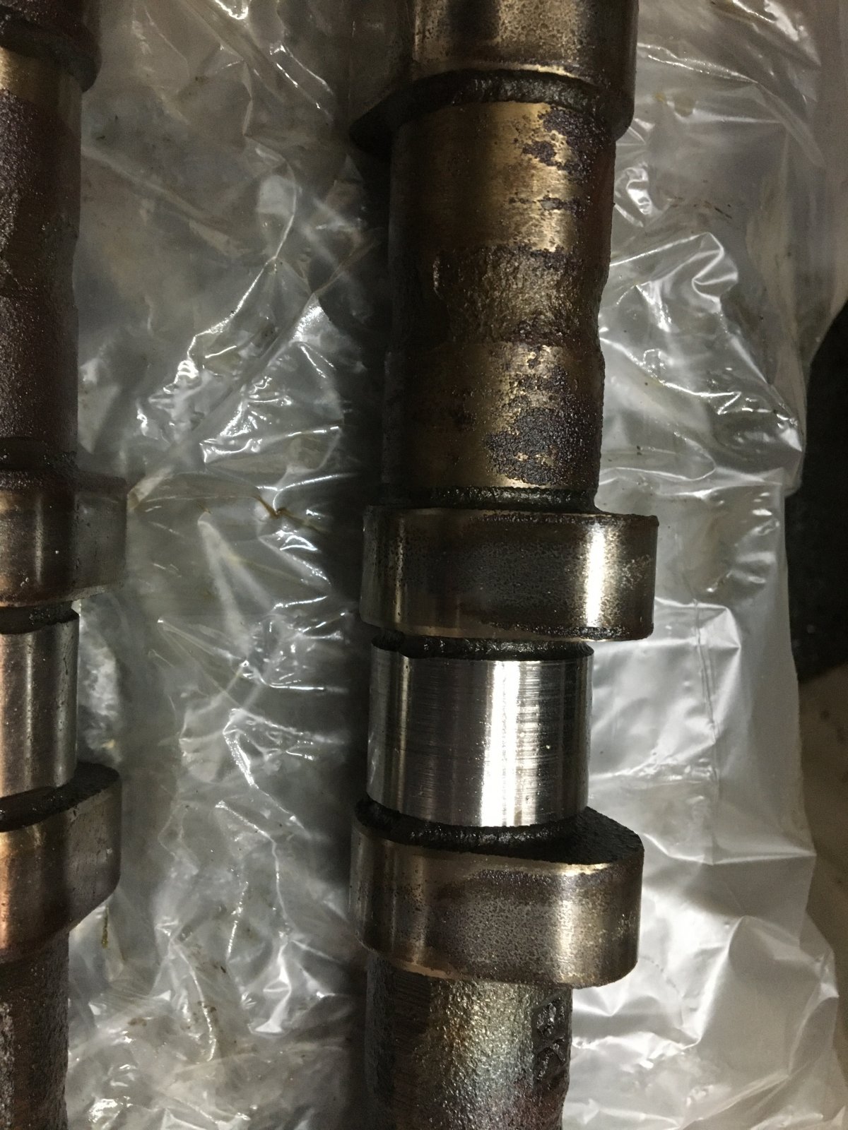

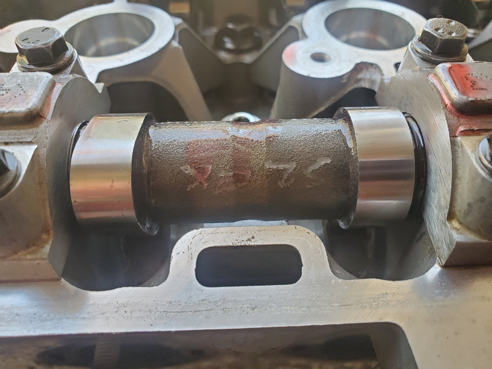

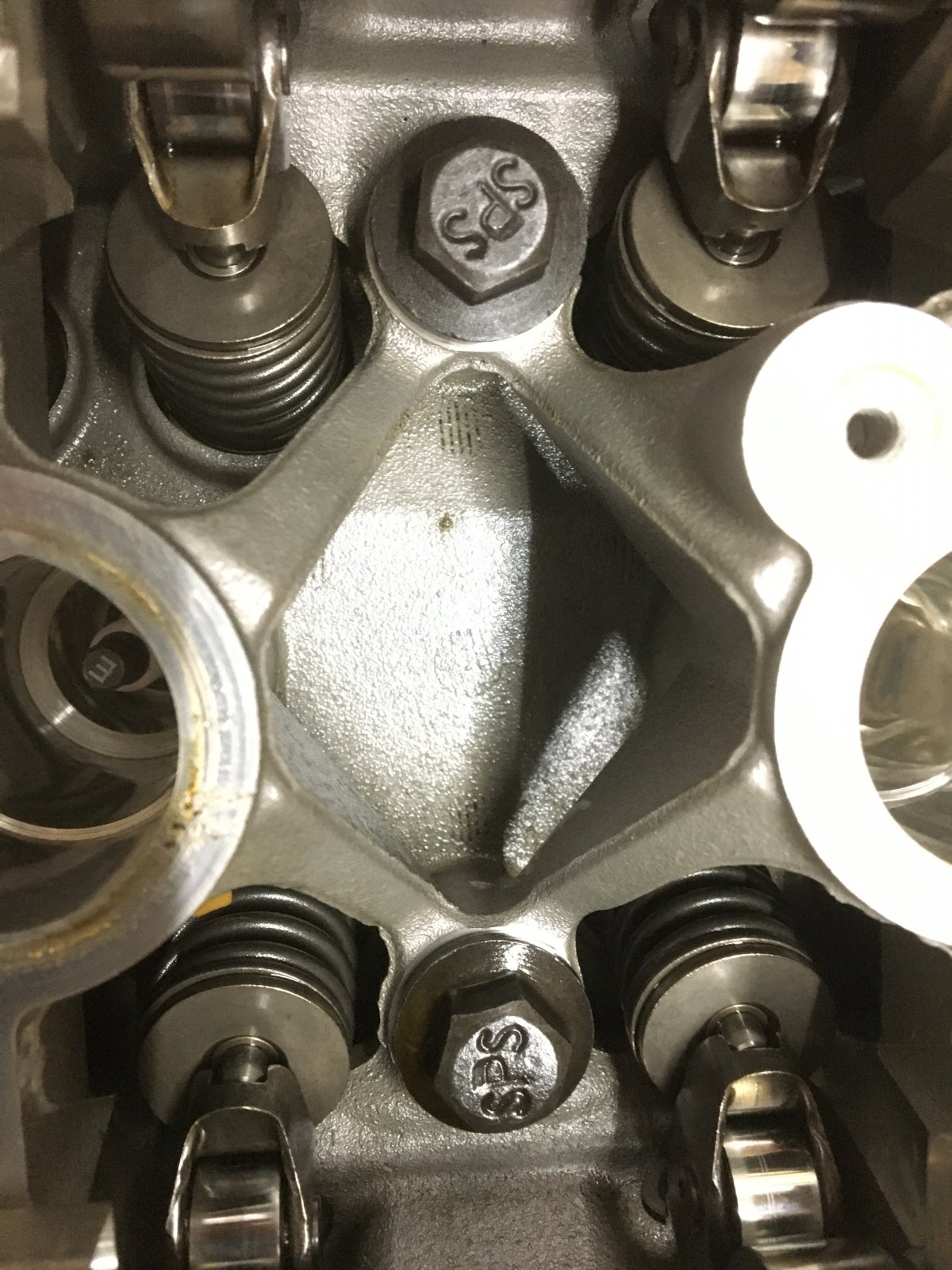

Got a valve spring removal tool and using my old head from the LSJ as the guinea pig. Old LSJ cam lobes are showing wear so ordered stage 2 turbo lsj cams and 82lb springs to swap into the b207r. Need to use minimum pressure to hold the valve stems in place while compressing the springs. Looks like it may be an easy job without removing the head with just compressed air on the cylinder.

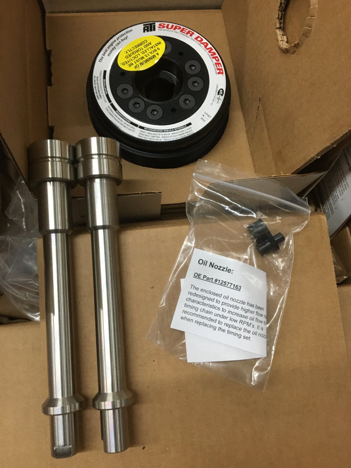

While I’m at it the cam gears will be replaced with the new timing kit, oil nozzle, neutral balance shafts and Ati under drive pulley will get installed.

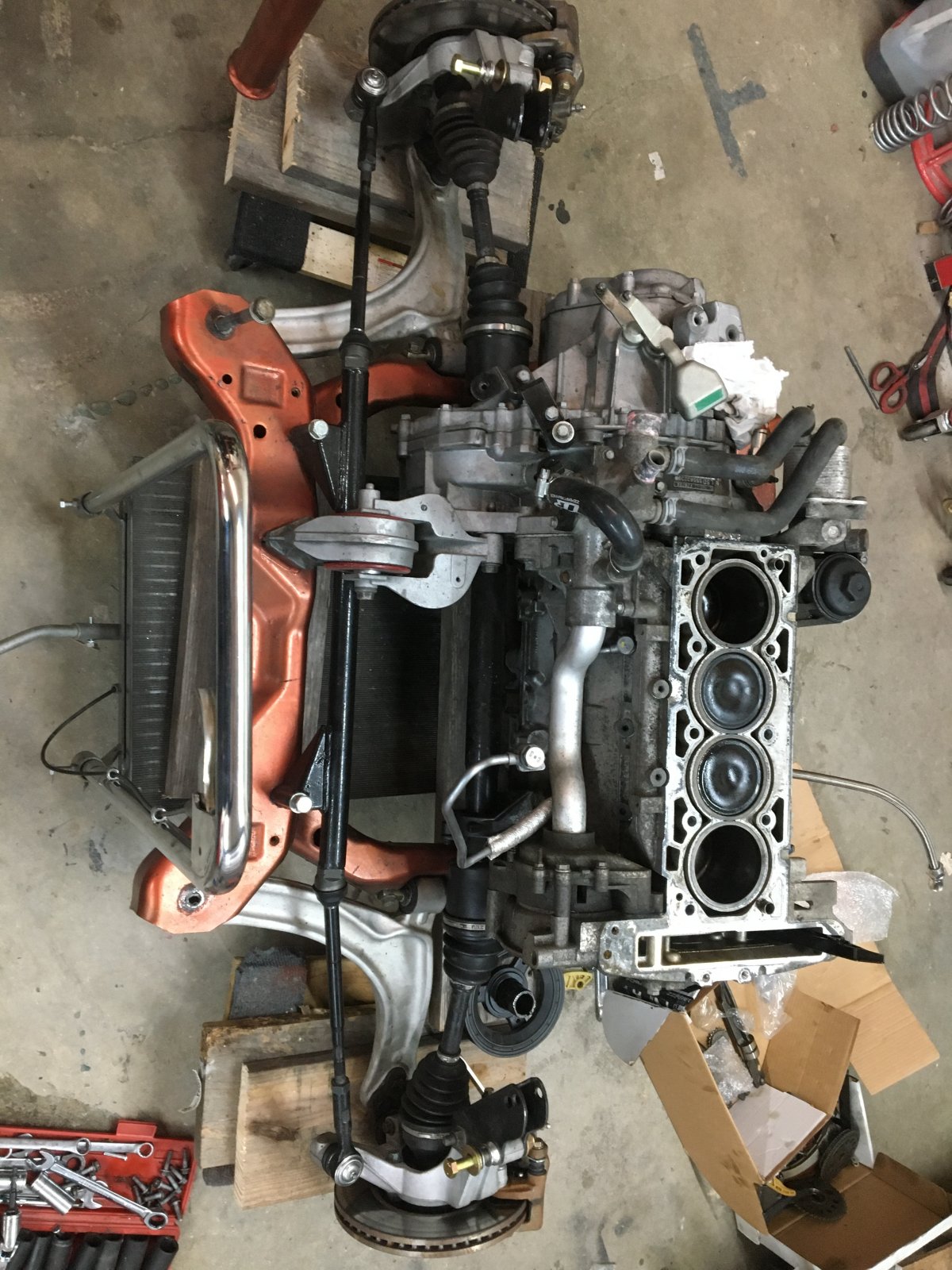

ccannx
I have the neutral balance shafts, cams, springs and head back on the new motor. Plan on dropping the subframe, motor and trans out this sunday since Virginia is on lockdown and all of our autocrosses have been scrapped.

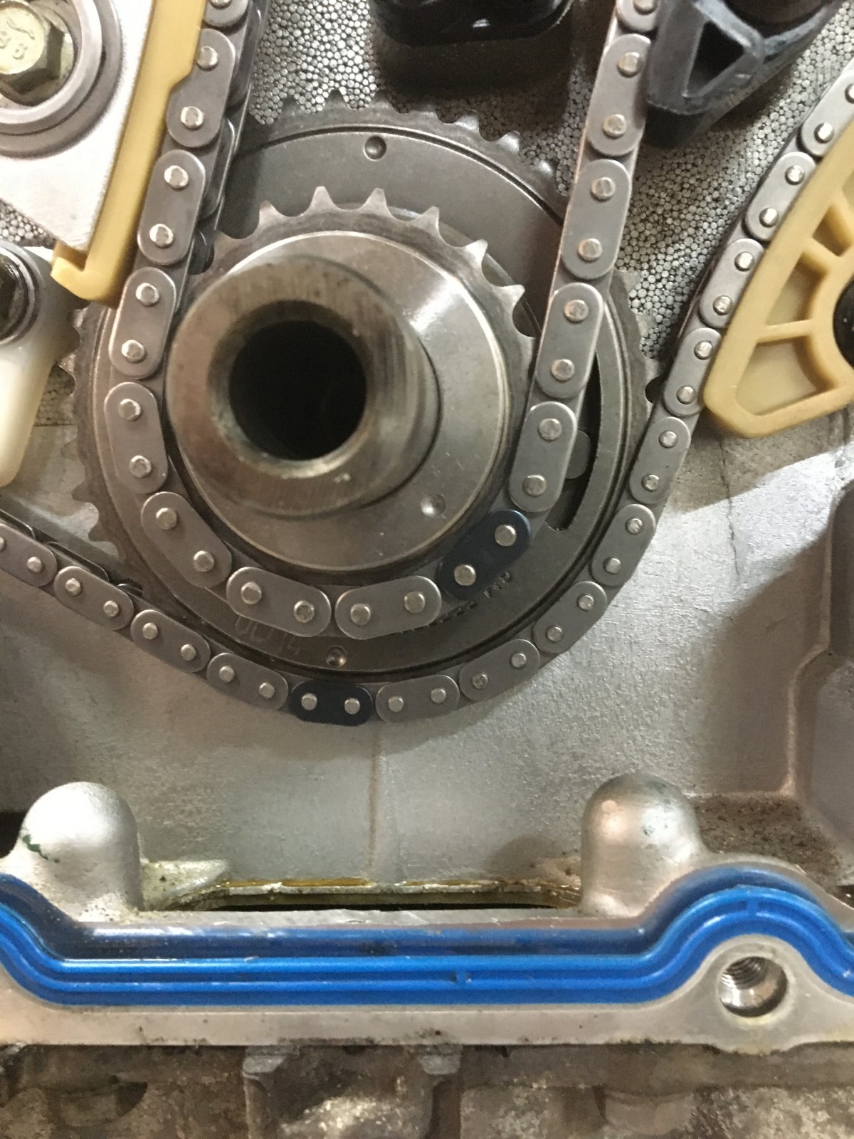

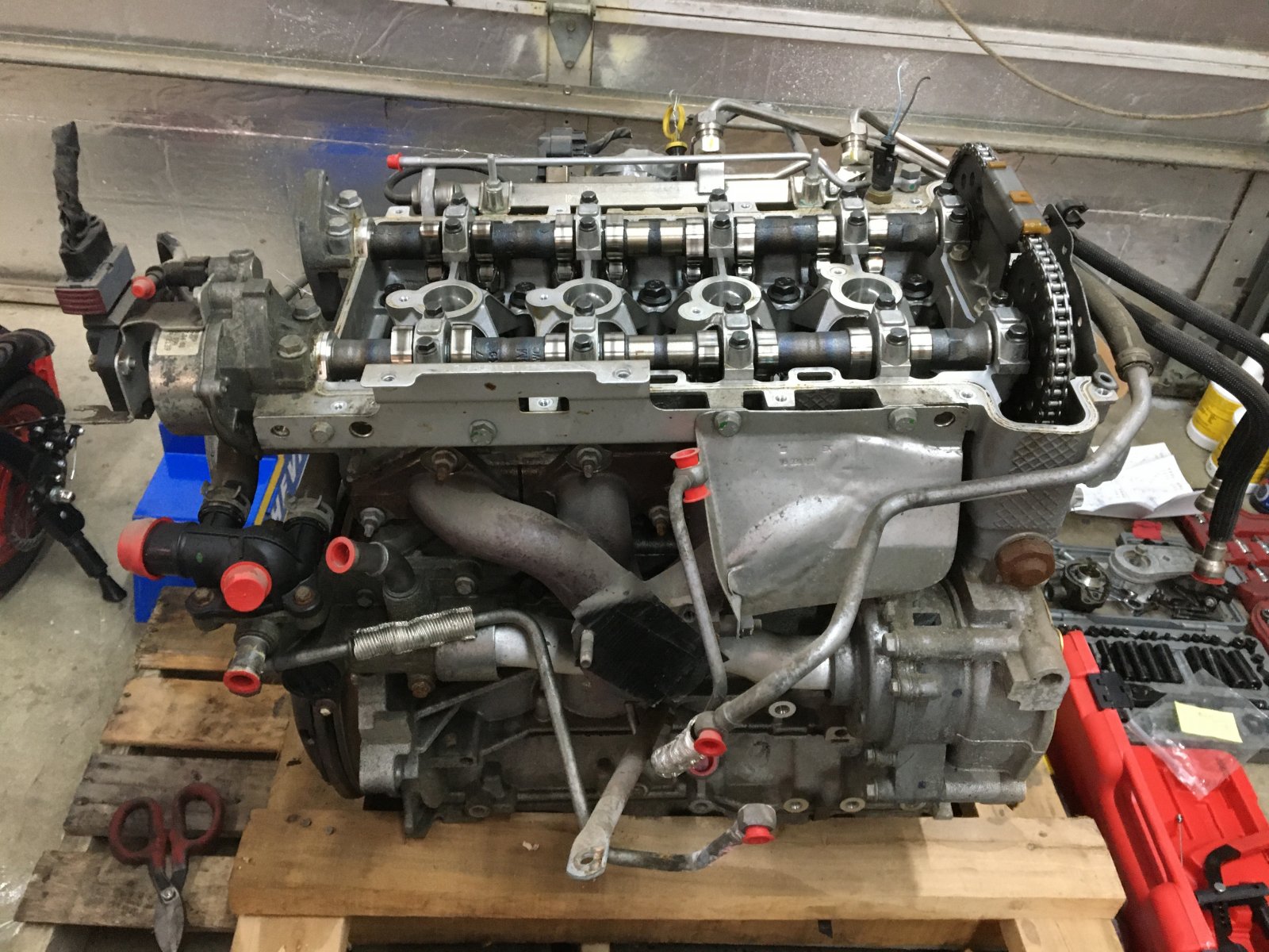

Old smokey is out of the car. New to me motor now has the timing finished. Next up transfer over the clutch and flywheel then bolt up the new motor.

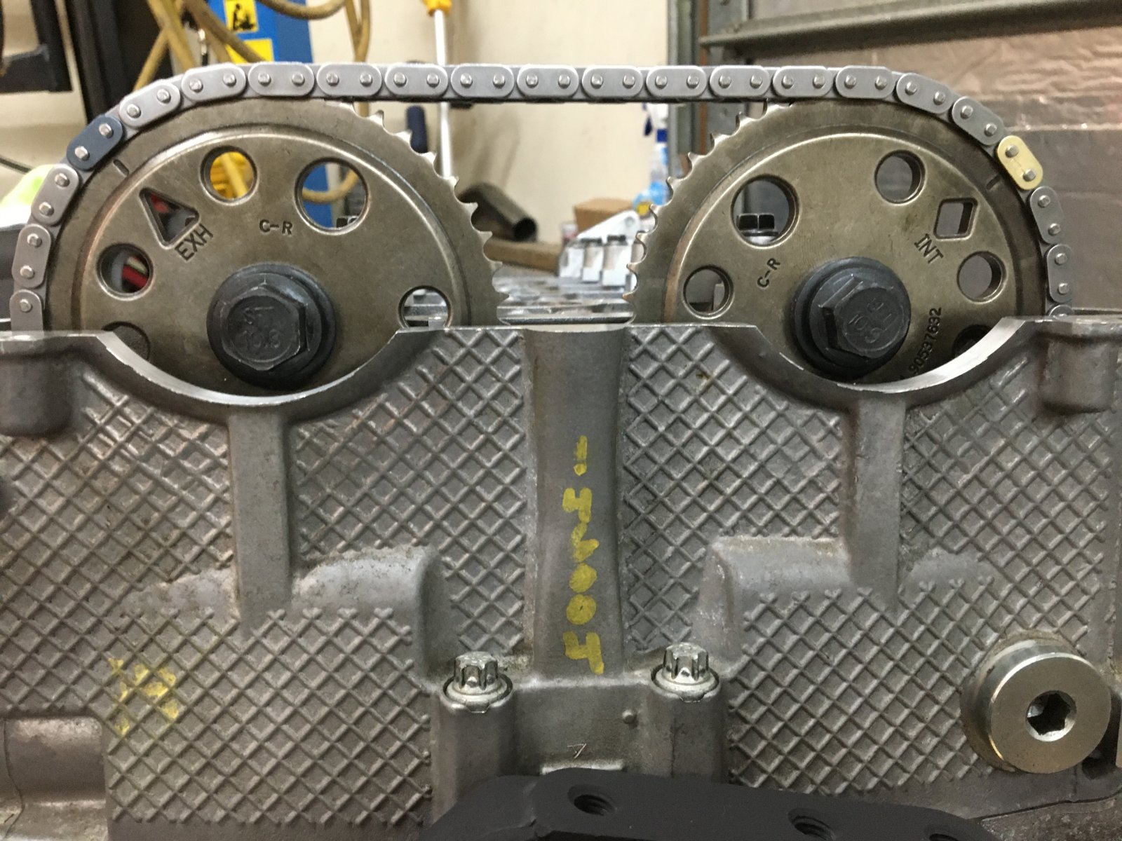

ccannx

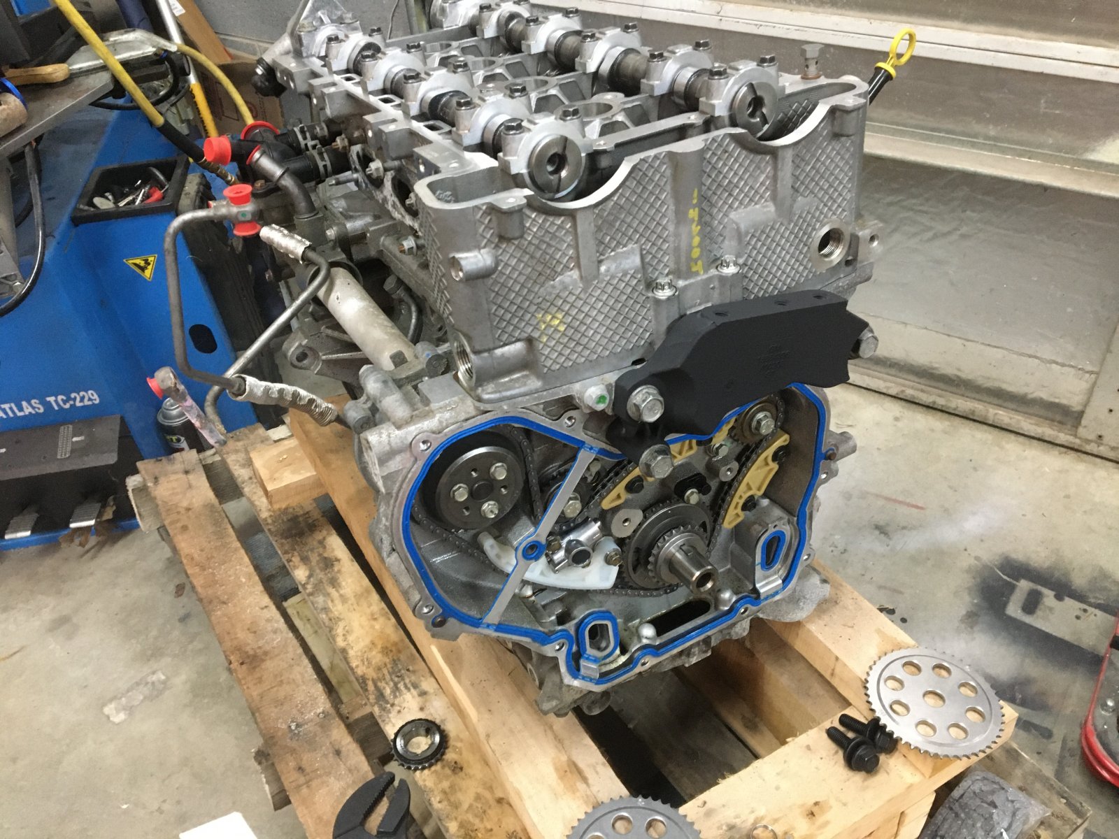

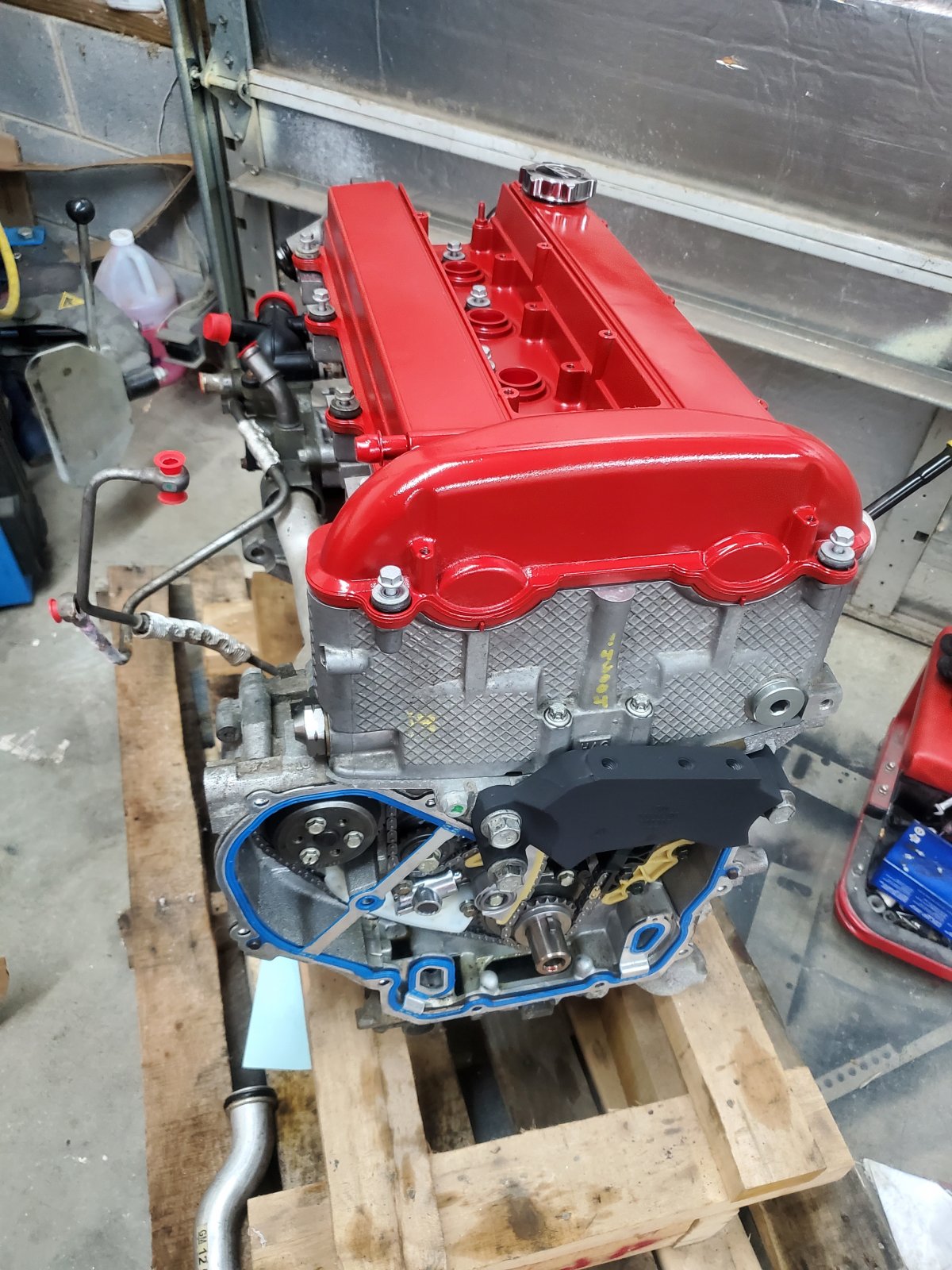

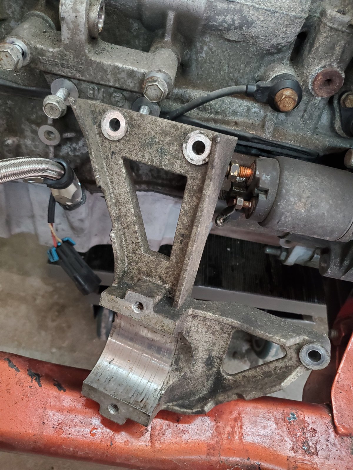

Coolant pump housing and mount pulled off the LSJ cleaned and painted satin black VHT paint. Zzp stage2 cams installed and valve cover cleaned, repainted and installed on b207r Saab motor.

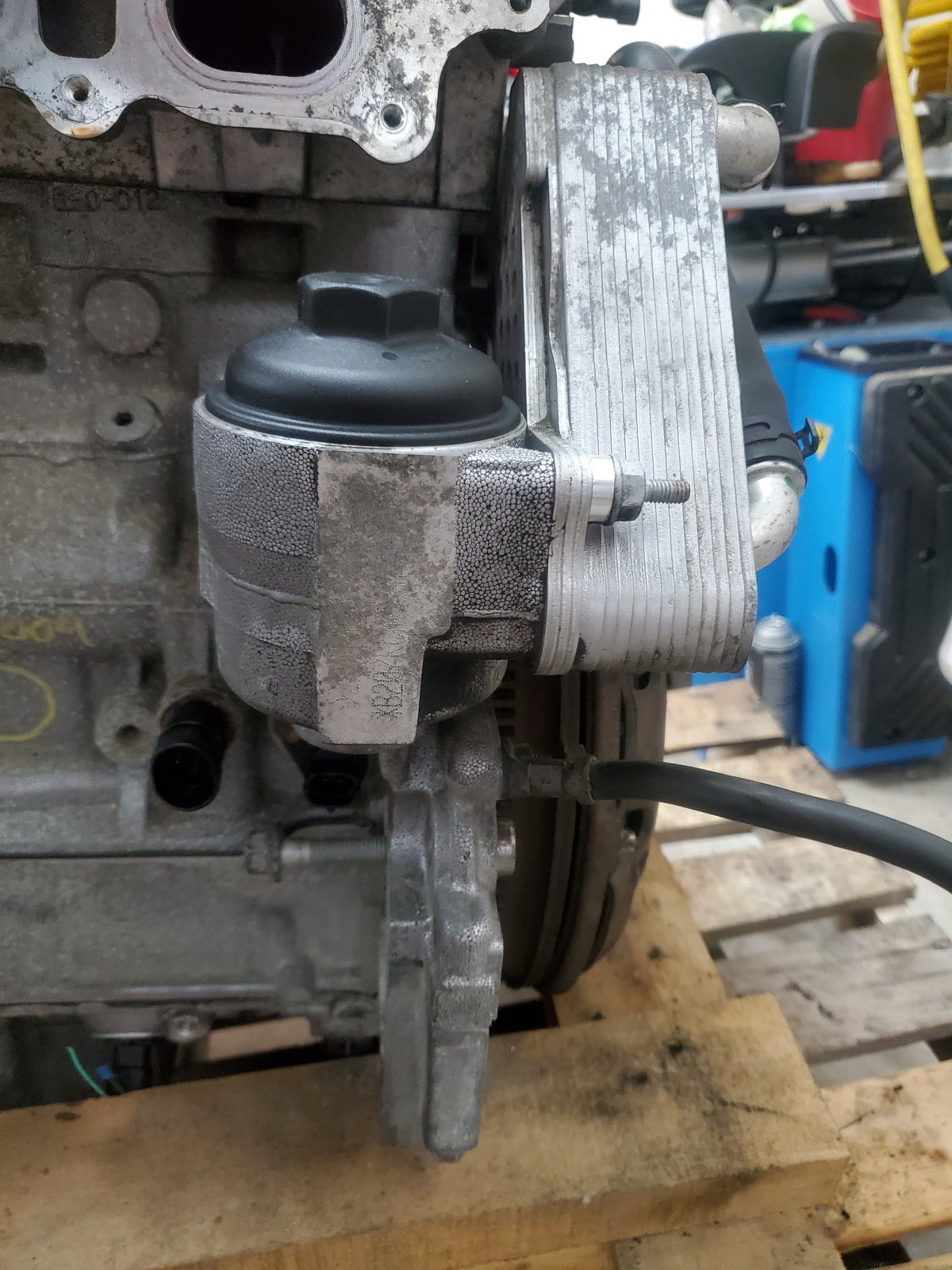

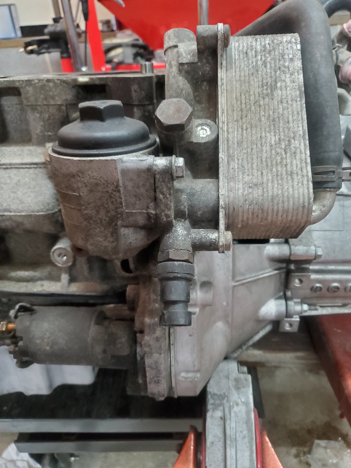

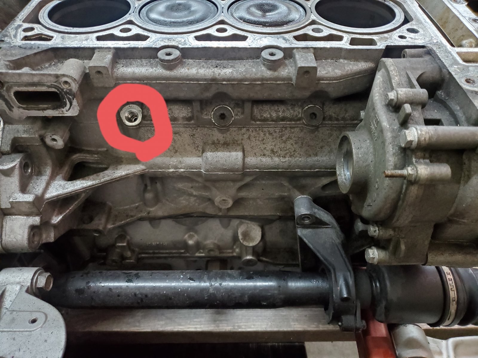

Oil cooler on the b207r and LSJ are slightly different. The lsj has a sensor (oil temp maybe?) on an adapter while the b207r does not have that adapter and the sensor seems to be relocated to the block just below and to the left near the knock sensor.
While the new design looks to save space the old design looks like it can possibly accommodate an external oil cooler.

My LSJ has an oil switch - below ~20psi, the dash oil light turns on.
I wonder if the Saab b207r had an oil pressure sensor & gauge?
I pulled the plug out of my LSJ block so I can put an oil sensor in it.
ccannx
That's it ! post 300 in your build. Right between the crankshaft position sensor and knock sensor. Did you remove your oil cooler and relocate your oil pressure switch.
I left the oil switch and dash idiot light. I didn't see any reason to remove it.
I removed the plug in the block for an oil pressure sensor. When I eventually add a turbo, I can put a Tee in there, and supply oil pressure to the turbo, and the oil pressure sensor.

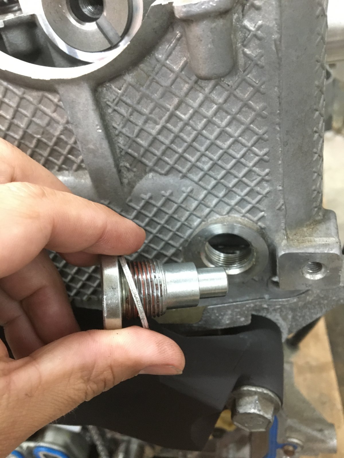

ccannx

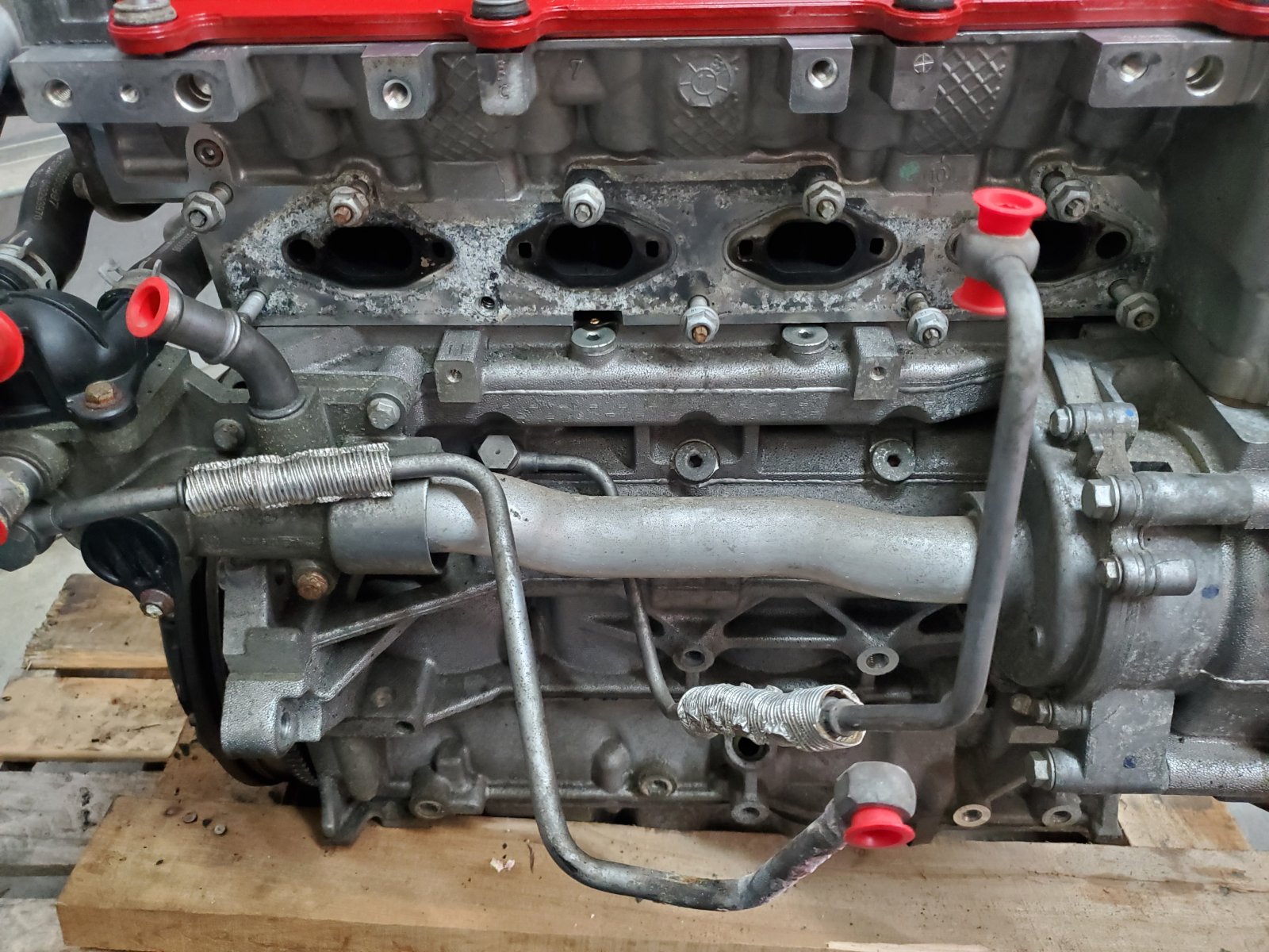

Not sure if its helps but both the ZZP turbo kit and the b207r use the leftmost plug behind the coolant crossover pipe for turbo oil supply.

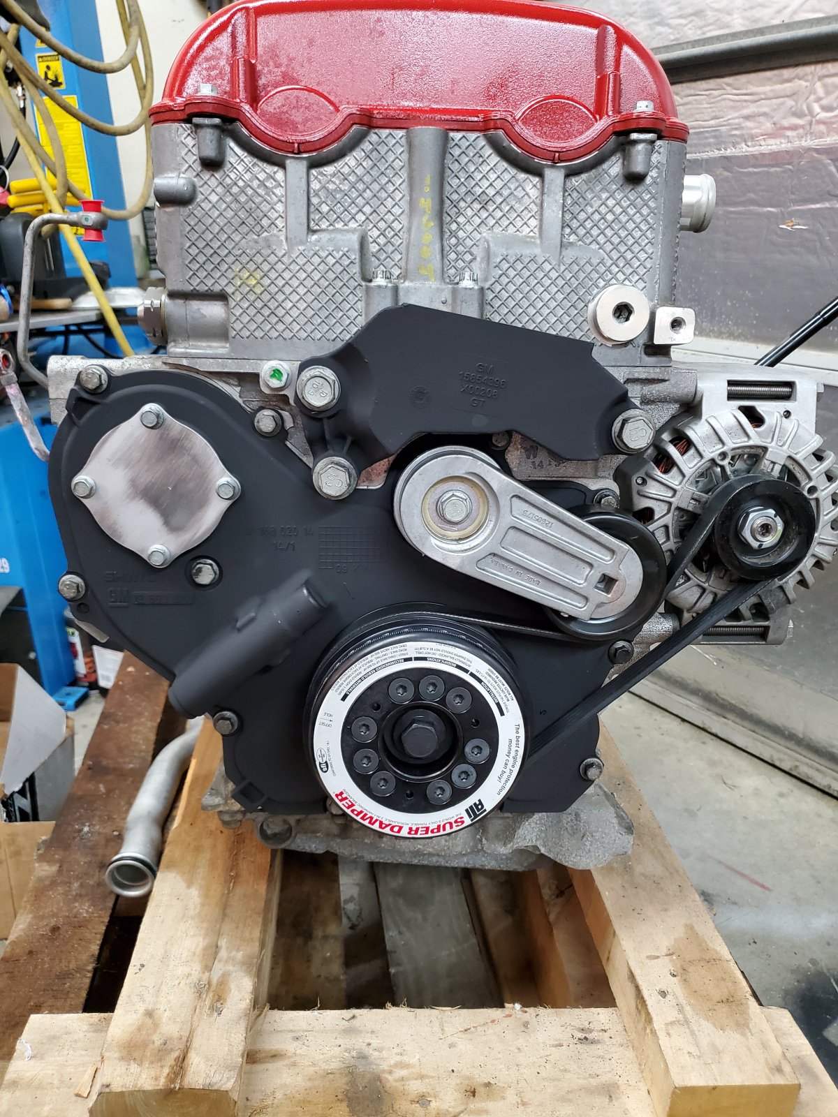

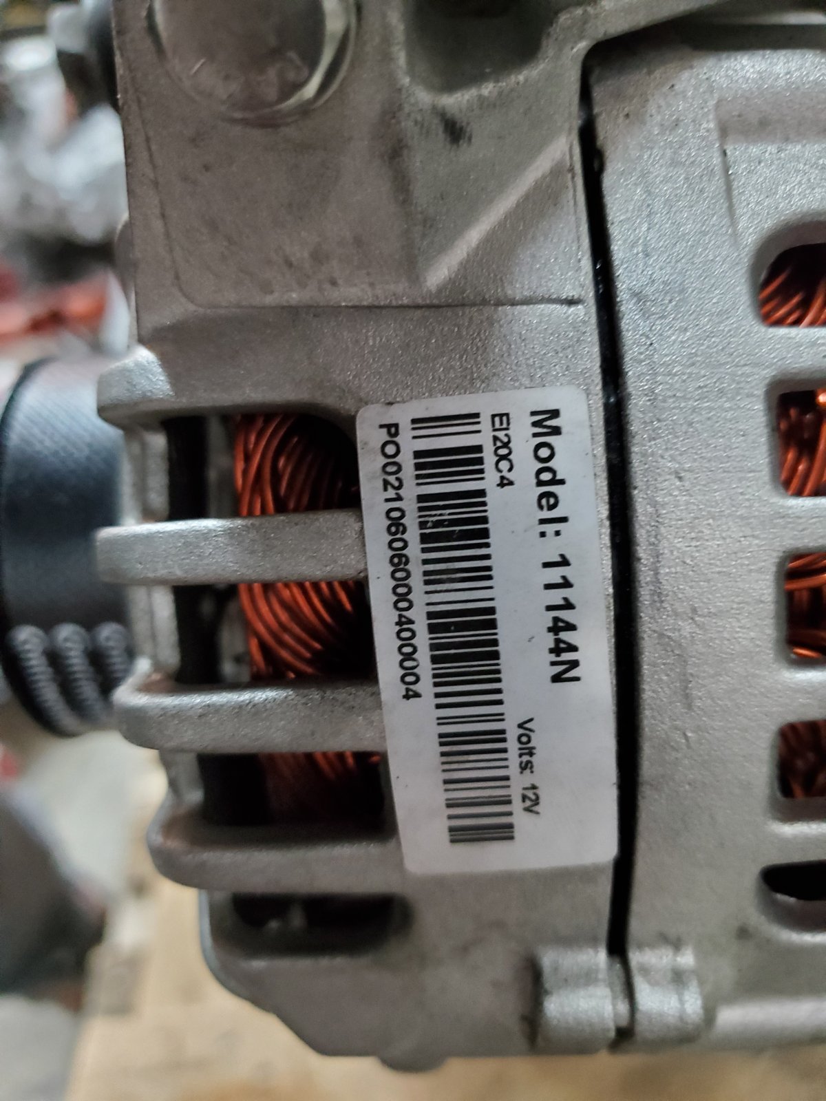

Timing cover back on installed the alternator and tensioner that came with the zzp tubo kit for LSJ. Was able to get rid of the AC compressor so I picked up a shorter belt. Measured the belt path with the Ati underdrive pulley to determine belt length.
That is great information. Thanks. It is closer to the turbo, and is already proven.

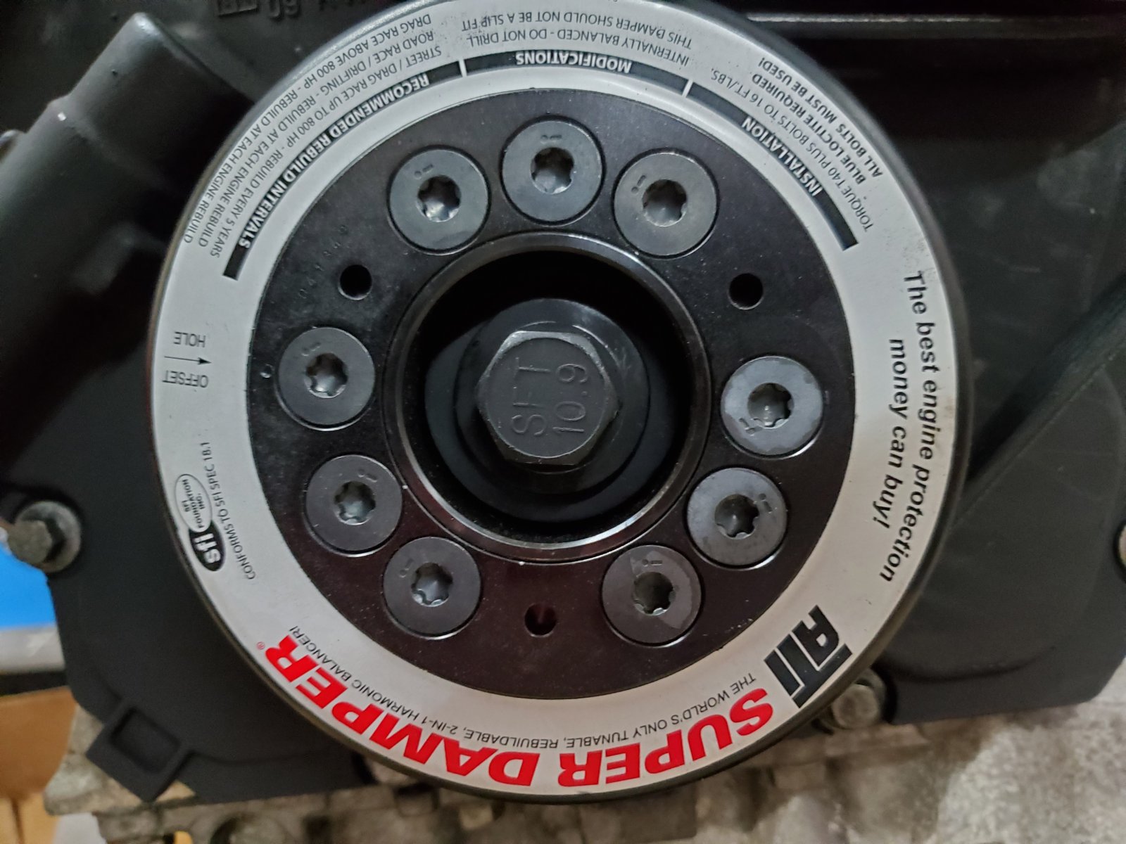

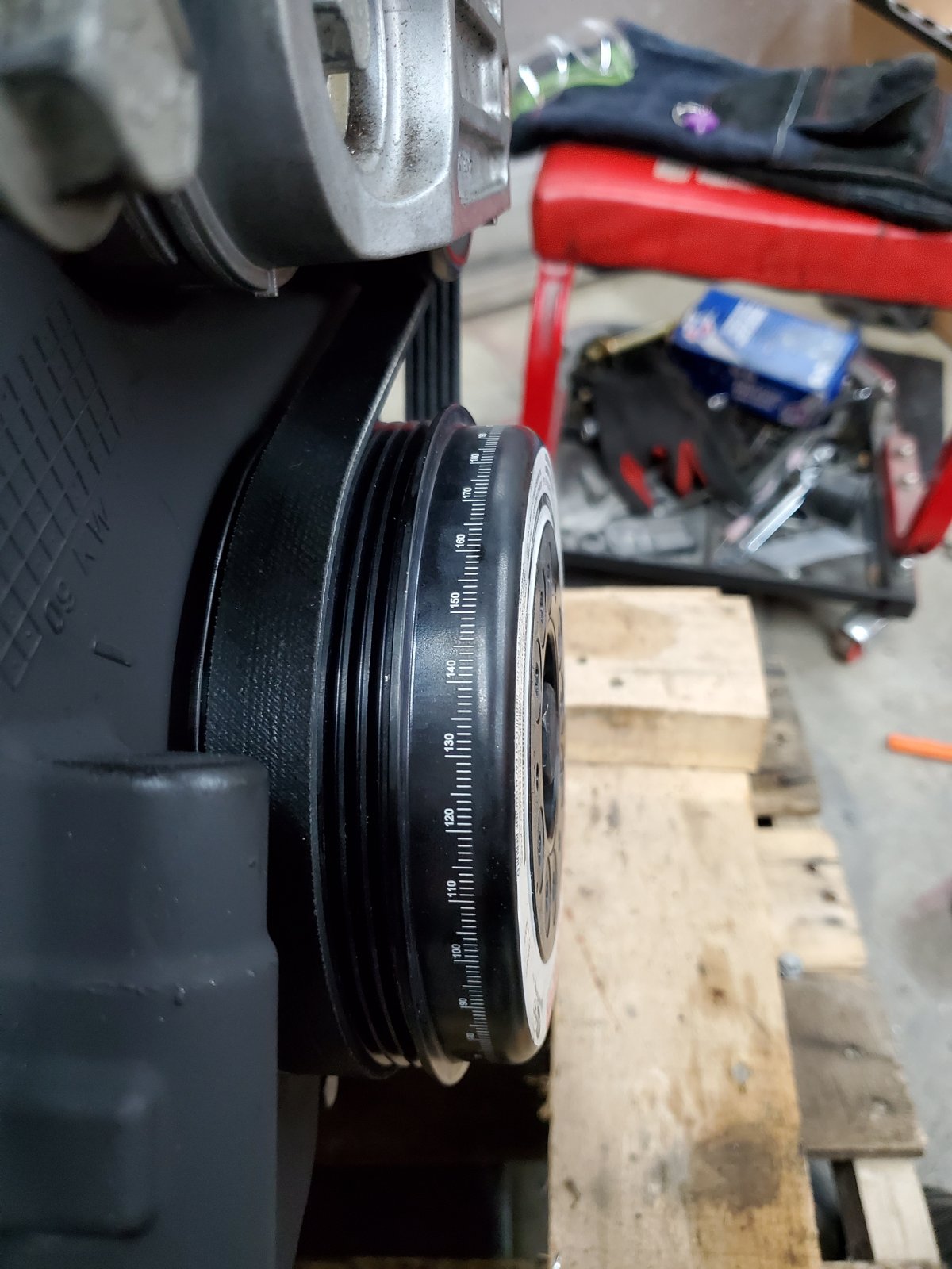

Any issues/tips with the balancer install?
I lined the slotted seal up with the stock balancer and marked the keyway with a carpenters pencil. The ATI balancer was very tight, I was able to wiggle and tap it far enough with my palm to use the stock balancer and draw it in. The easiest way I can think is to get a bolt about an inch longer than stock and use that to draw it in or get a cheap kit like this : Performance Tool Harmonic Balancer Installer Set, Model# W89710 | Northern Tool
