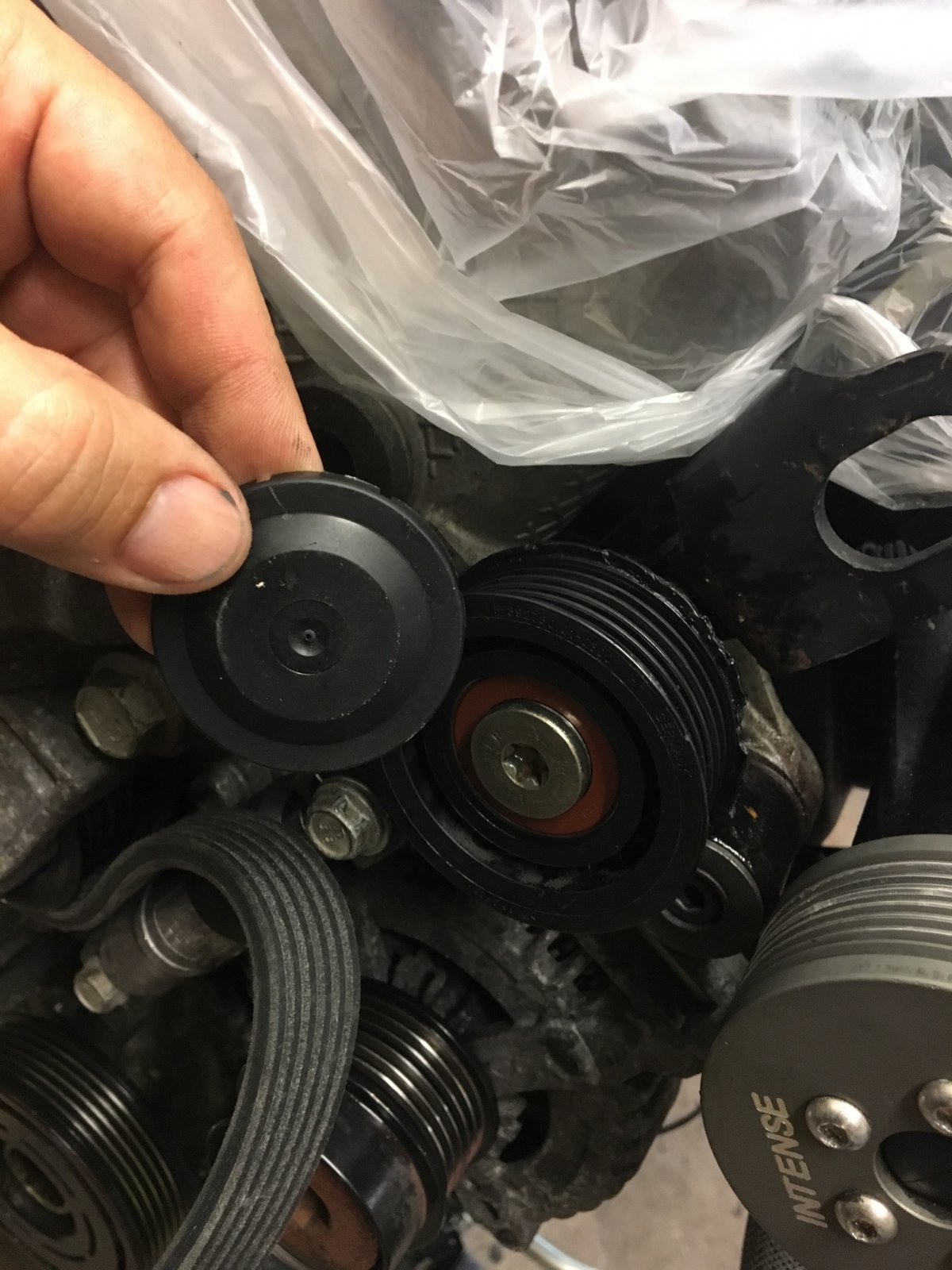

The old belt had some cracking and was making squealing noises. Had a hard time putting on a new belt and remedied that problem with a you-tube video. Looks like the previous owner had the same problem by the looks of how marred up the pulley is. It made it a lot easier knowing where that hidden bolt was under the plastic cover on the pulley wheel itself.

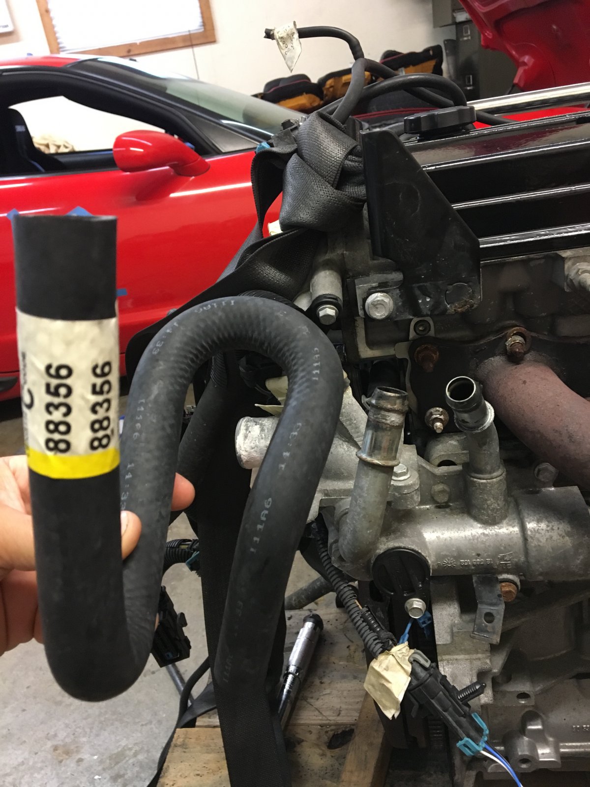

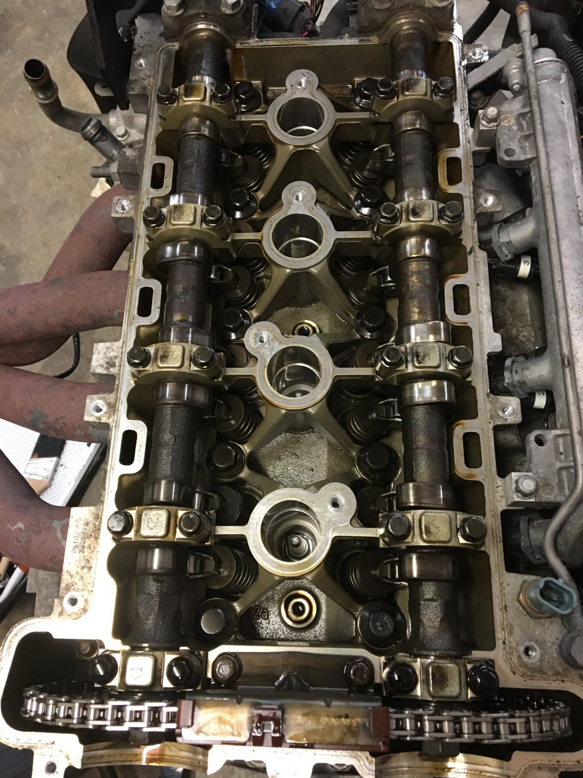

I lost my coolant bypass hose on the donor tear down today the new subject came in the mail.

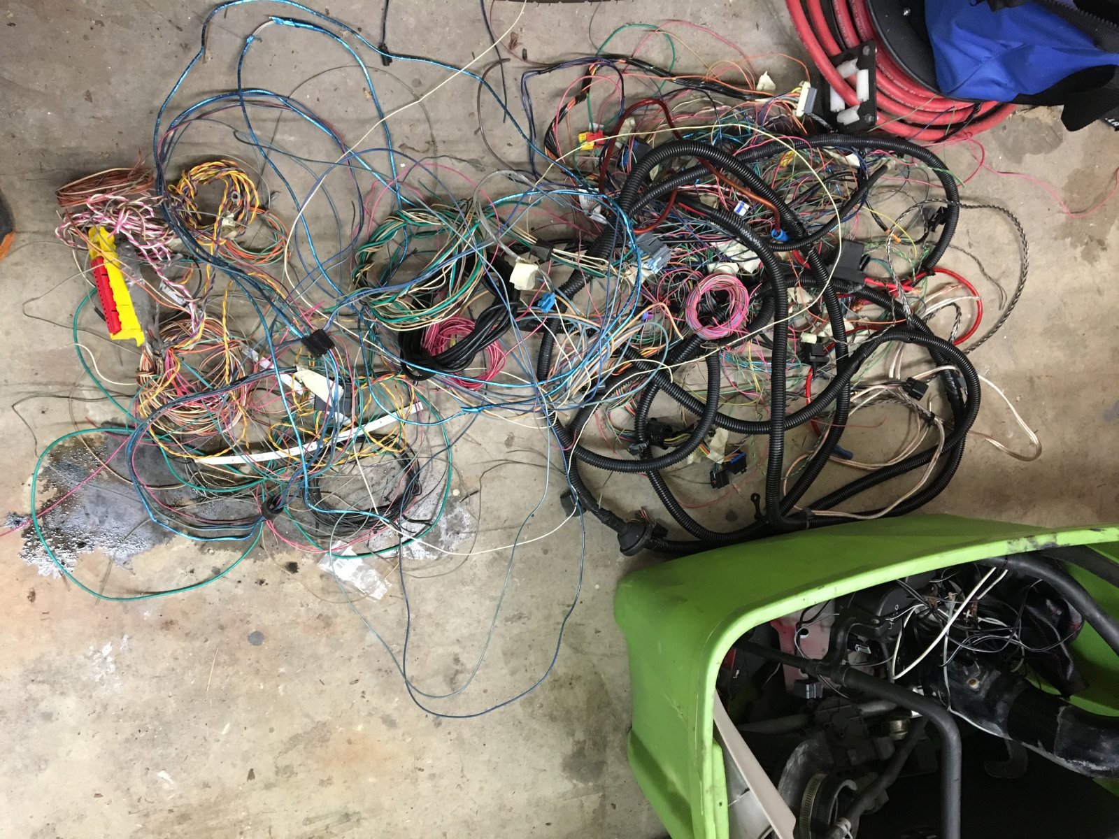

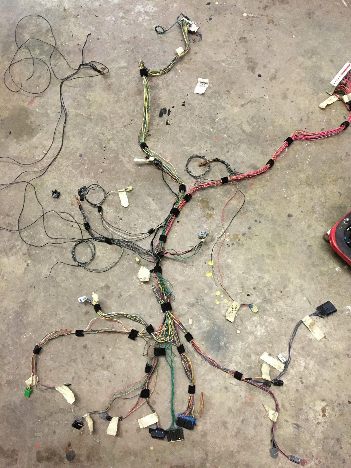

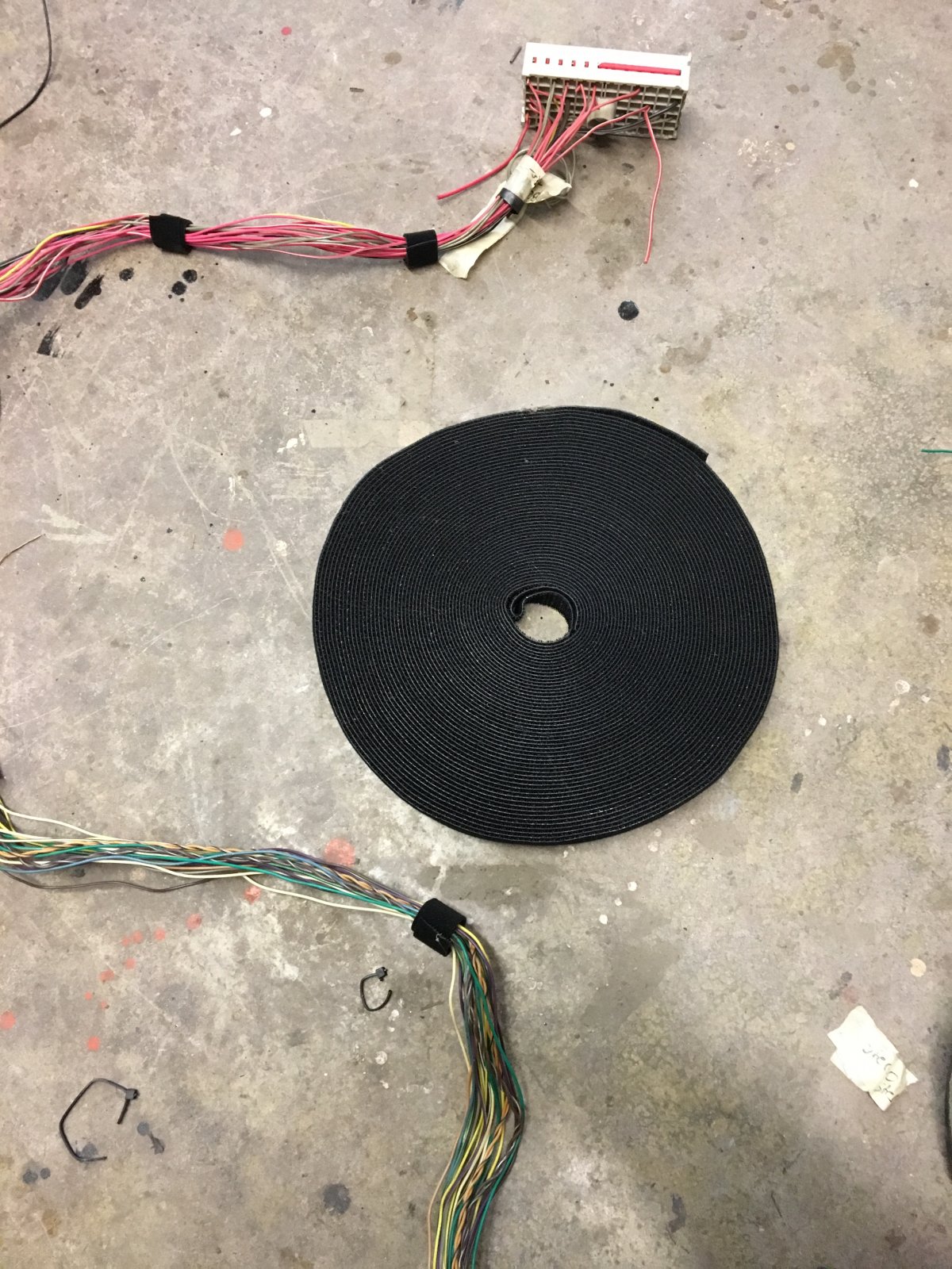

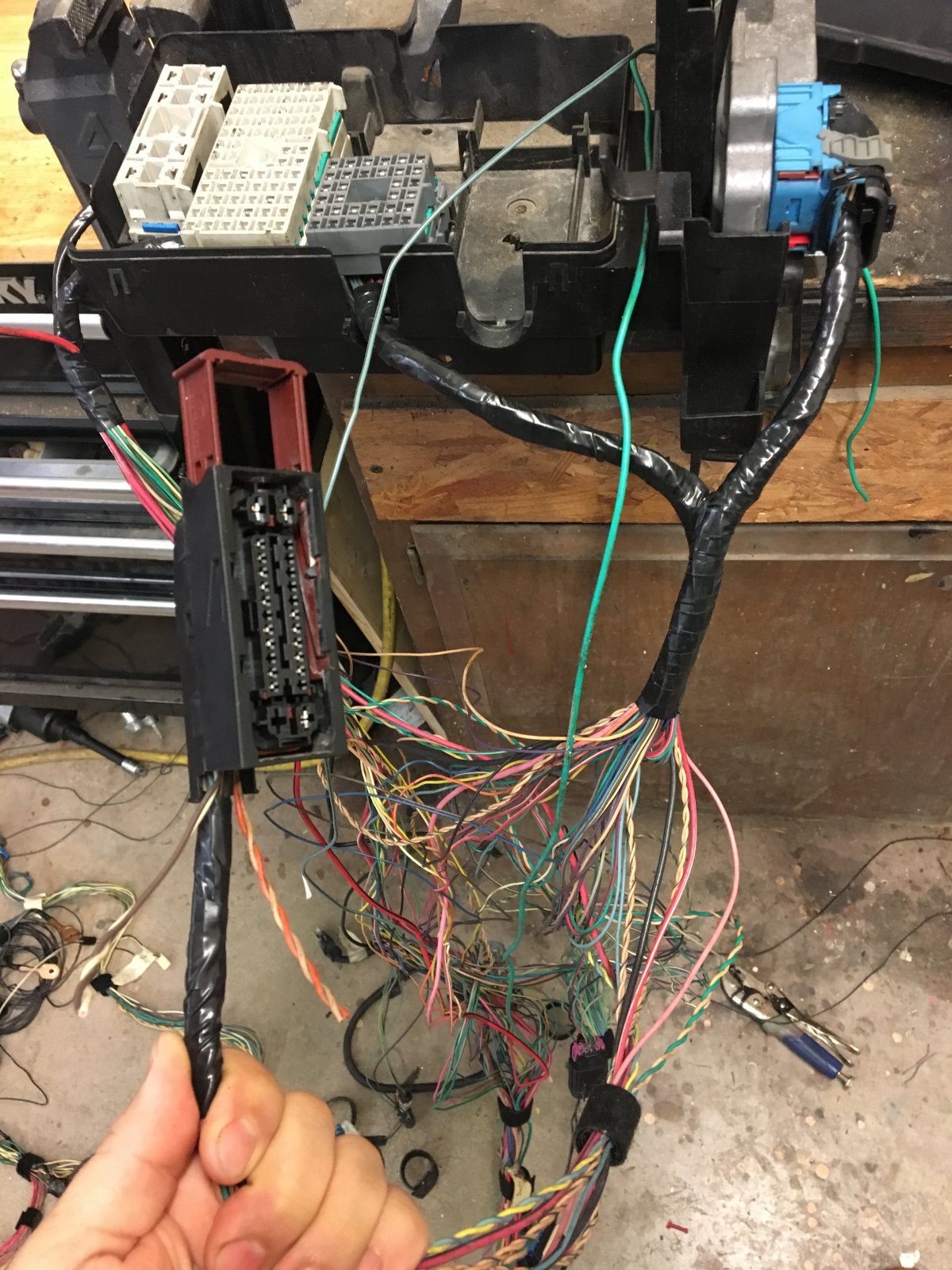

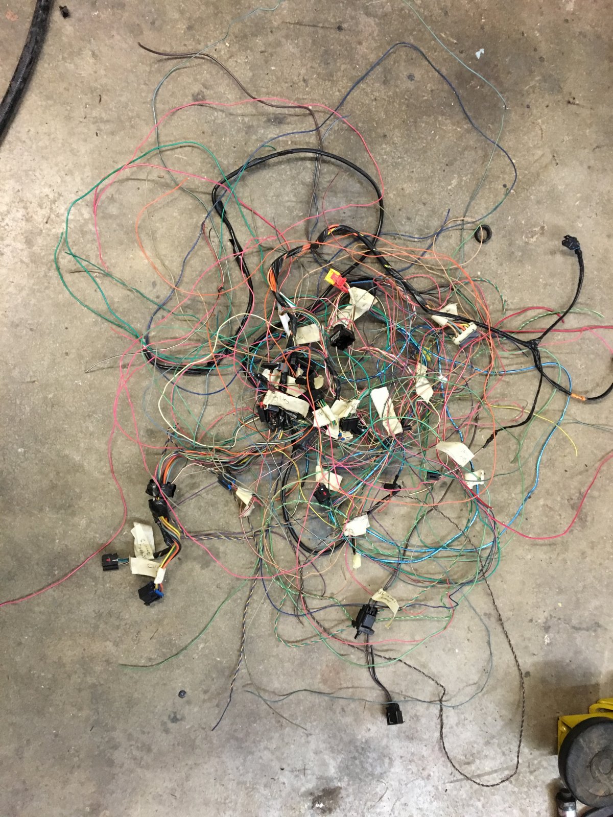

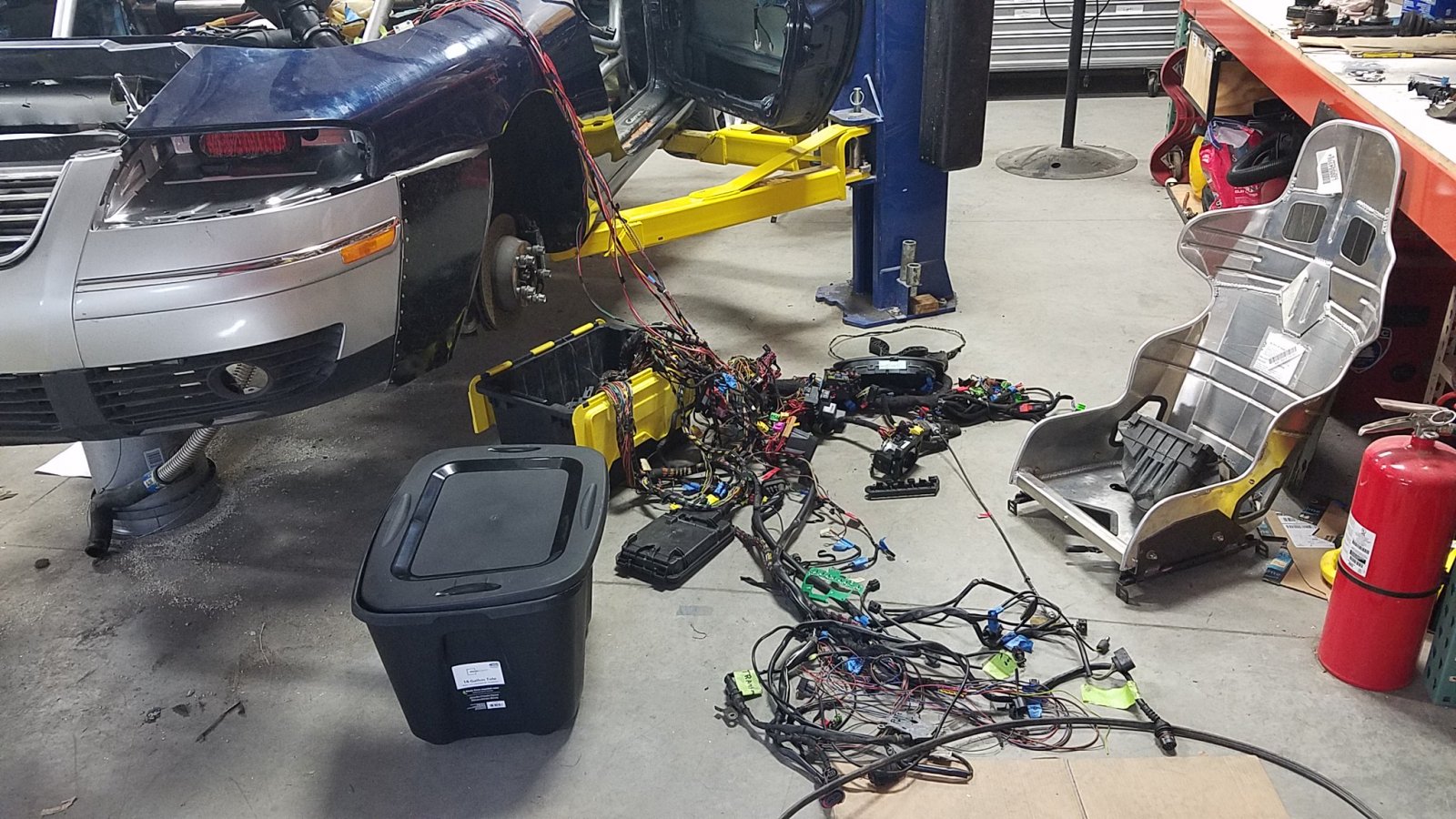

Got a chance to thin out the dash. I have a few extra things I’m not sure what to do with like the seat heater wires and the tire pressure monitor cables. I also recall reading something about leaving a few wires to do a push button start but I will need to find the thread.
I used self sticking Velcro instead of zip ties. I mess around with cable a bit at work and like being able to re-enter without snipping ties.
A nice pile of spare wires came out !
Now onto the body harness.

I was thinking of adding seat heaters, as the cab heater doesn't work with the open-air cabin.
Guess it depends if you plan on driving this kit in colder weather.
You won't need the wires to the seat heaters unless you want to add heaters to the new seat. Not something I can image needing. The wind is far colder than your bum. I originally thought about keeping the seat heaters since we had them but Kaleb quickly brought me to my senses.
There is no special wire you will need for the push to start system if you add it. If anything, put a wire from the switched side of the brake switch and extend it up to the key area. All the rest of the wires are there. At one point I mentioned that you needed a constant hot wire, but there is one already at the key.

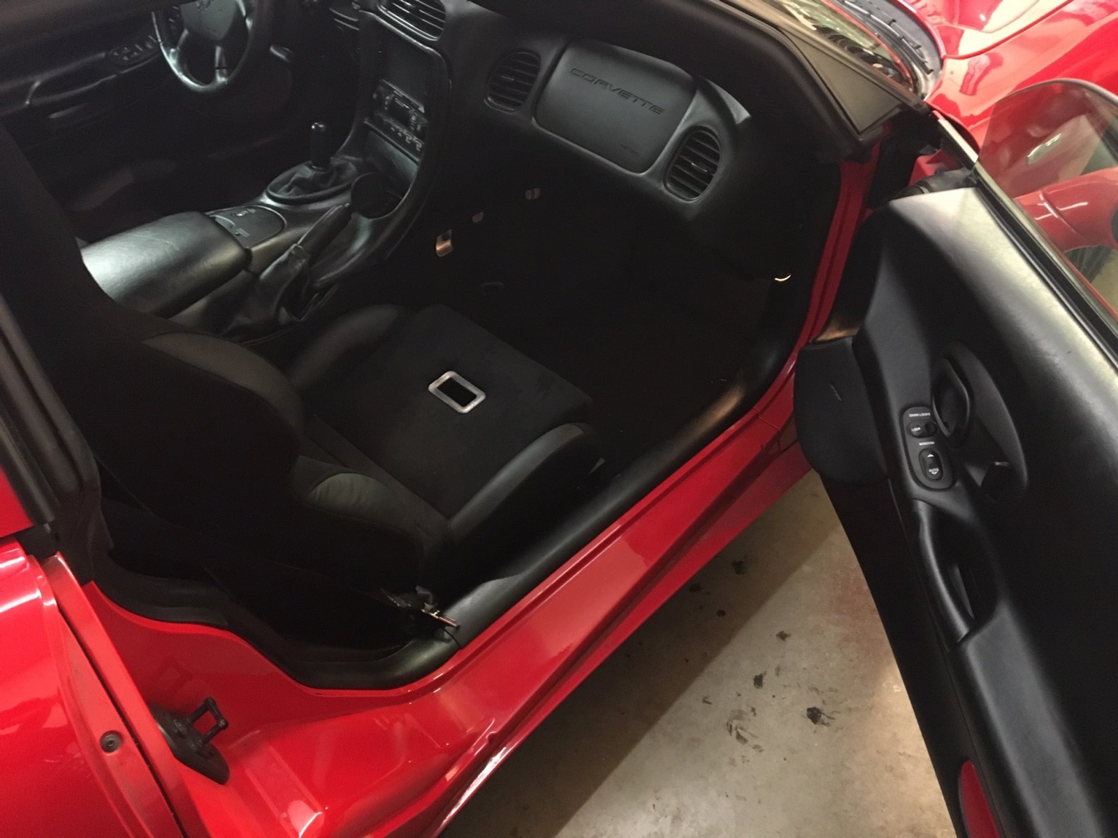

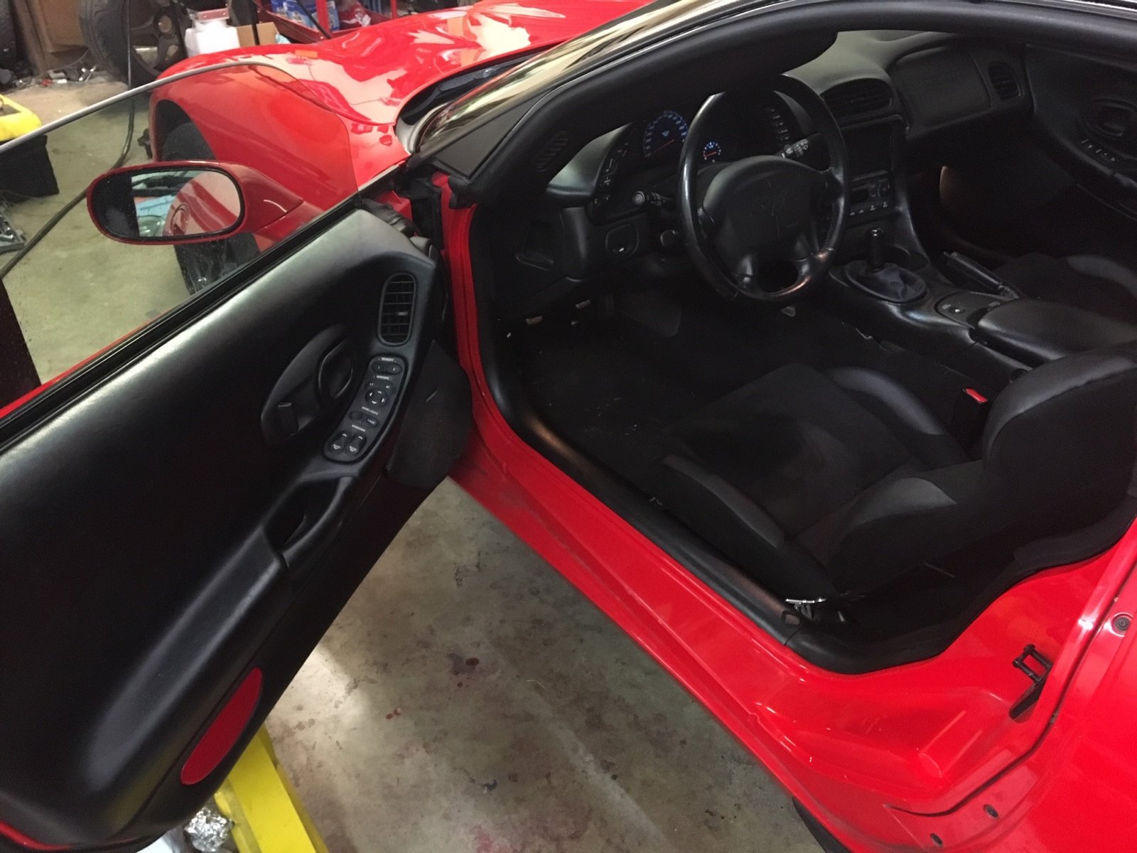

I originally wanted to use the stock seats and attach the heaters but decided against it. I have a set of corbeau a4's alcantera in the c5. I would like to move over to the goblin but will have to wait until I get the frame to see if they will fit. What no-one mentions is you need to swap the drivers for the passengers or the pivot mechanism hits the seat re-tractor. Now I have the drivers seat with sub belt holes in the passenger side and the drivers side with none.... It will be a relief to move them over.

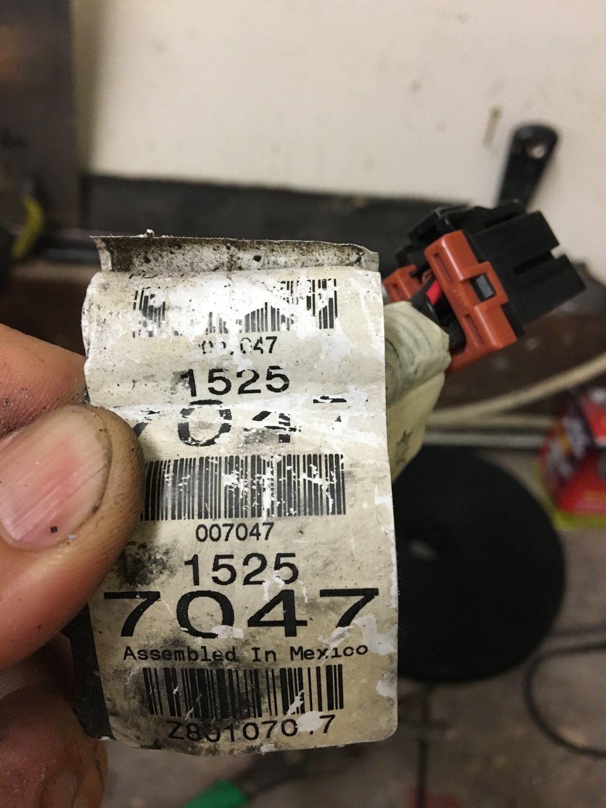

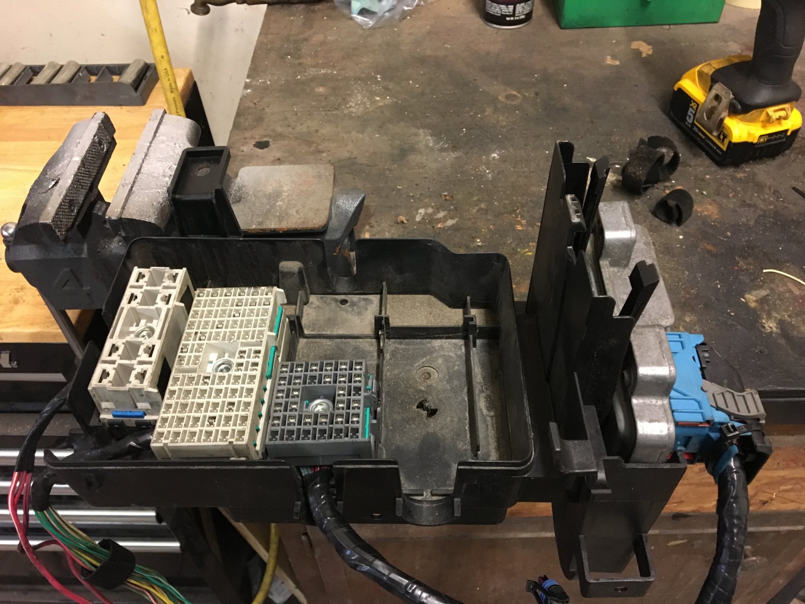

I got a little nervous today when I couldn't find the power steering pump wire then remembered it was separated. It would be awesome to have a picture thread with all the parts with the factory part numbers associated with them.
