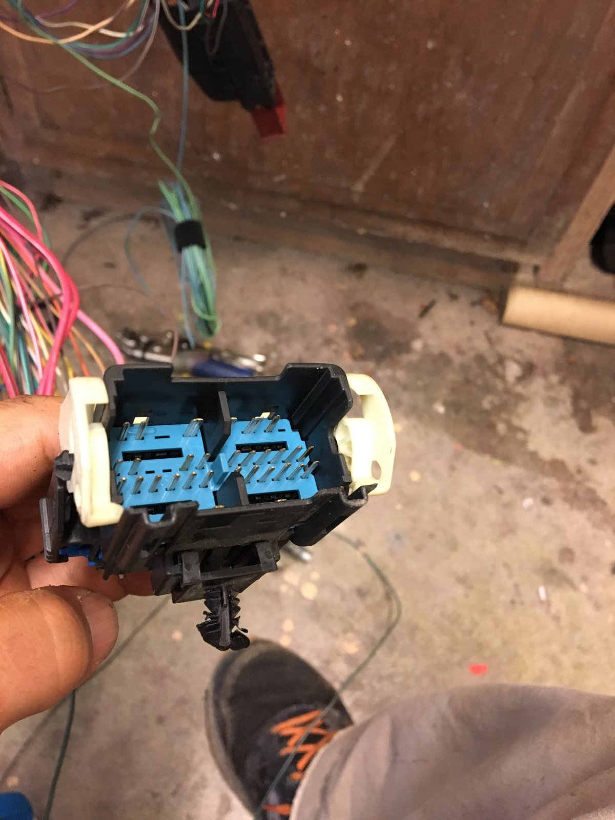

If you don't have that exact connector don't worry.
Yours probably looks like this.
It does connect to the engine harness (not actual location was just checking that it did mate up).

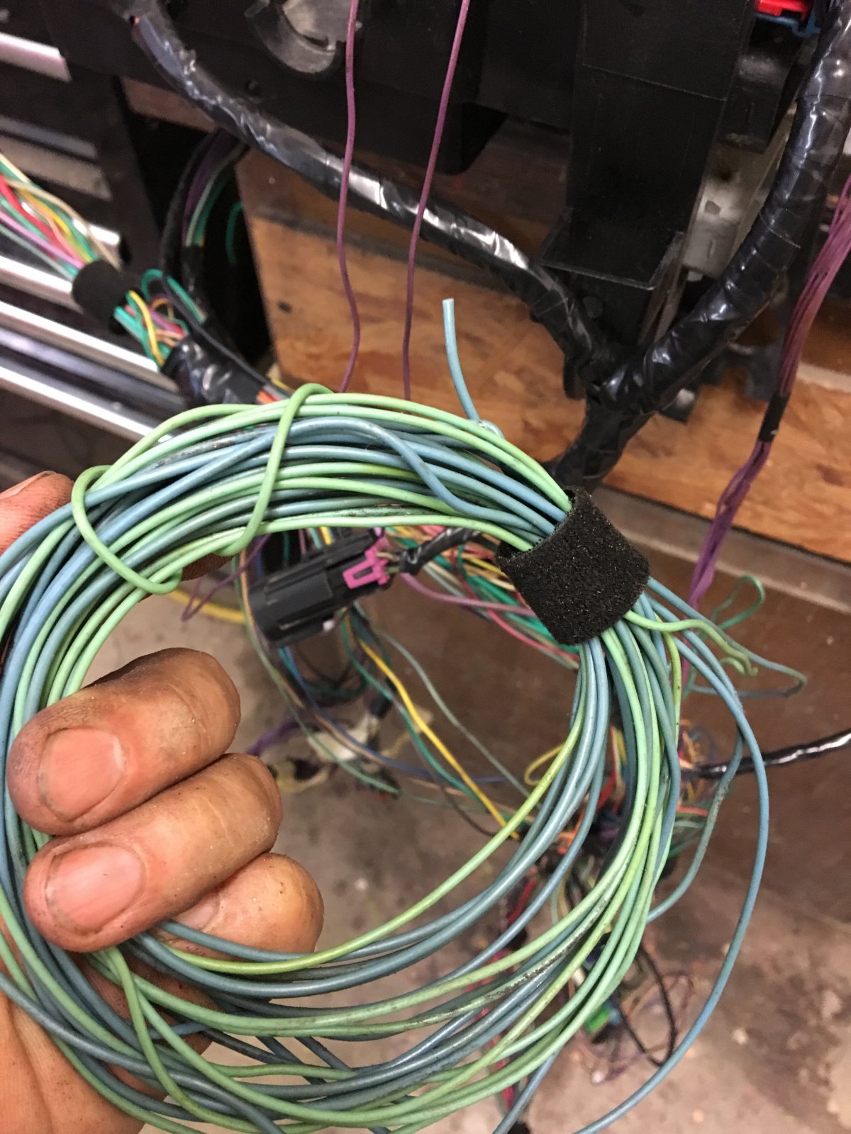

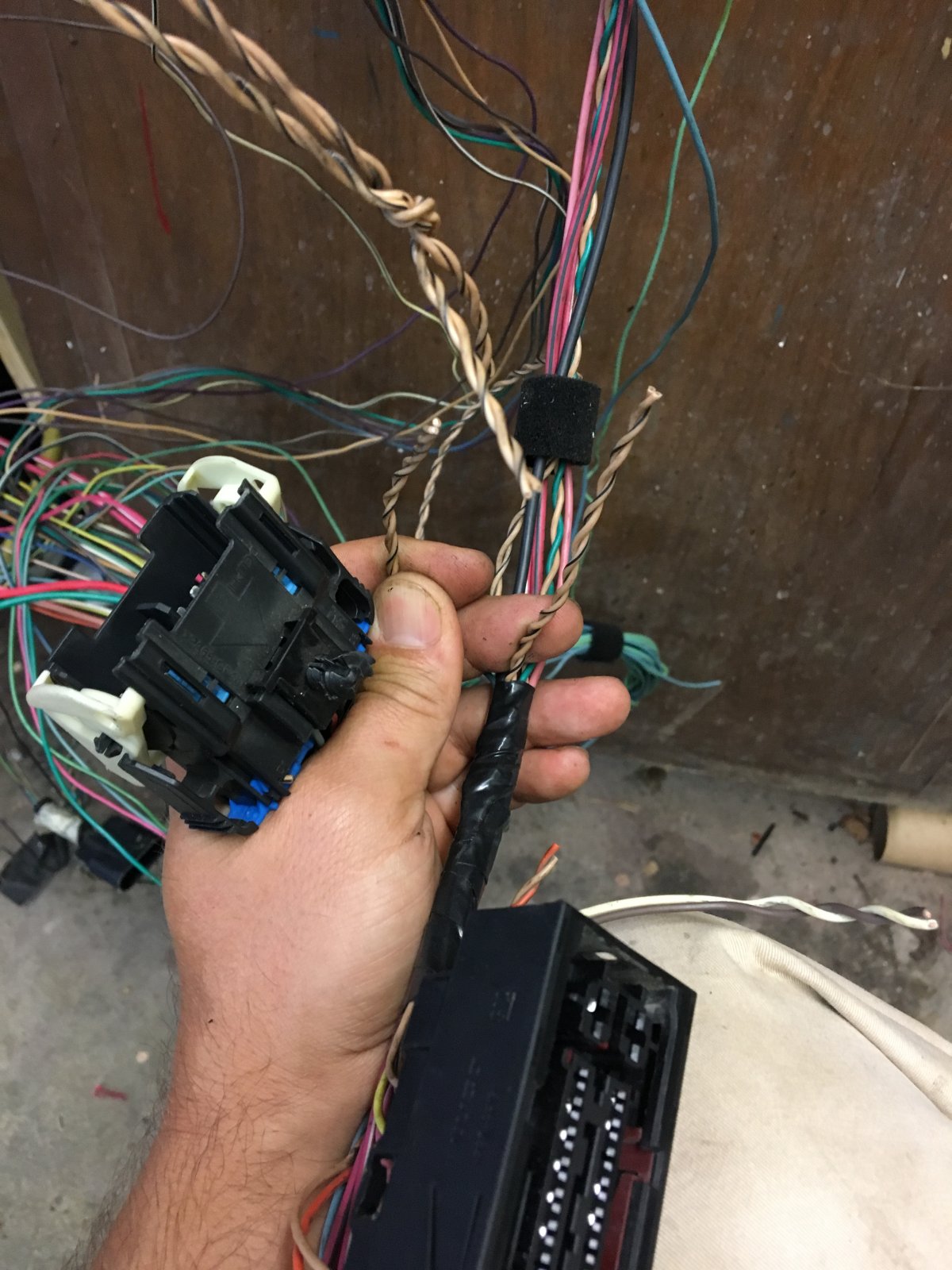

I do have that one ! The black,green,grey,redw/black tracer and lite blue got to the top plug on the ecu. I have the light green and blue coiled up and a tan one going to this giant connector.

Looks like that data wire loops through the big plug maybe abs plug from the ecu and then on to the dash harness that was on the drivers side.

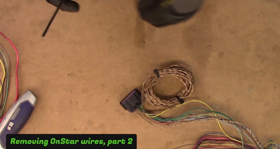

I followed what Chad did from this thread on those wires.
ccannx
Thought I saw that one before and was looking for it. I cut them from the abs plug and connected them straight to the dash connector from the ecu looks like what chad did in that thread.

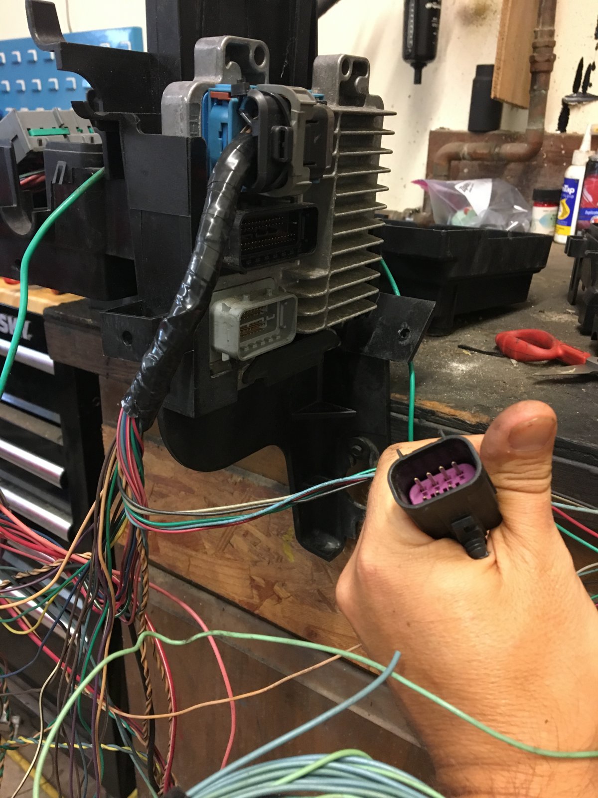

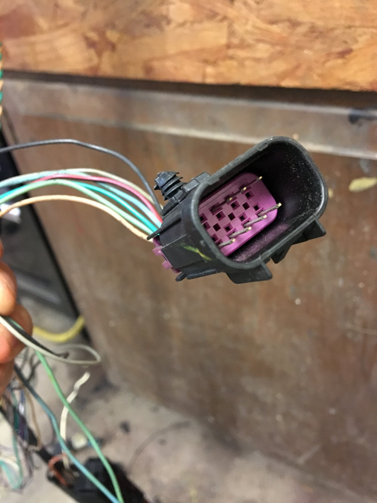

ccannx
I have the memory of a goldfish and can’t remember what good I though I was doing here.

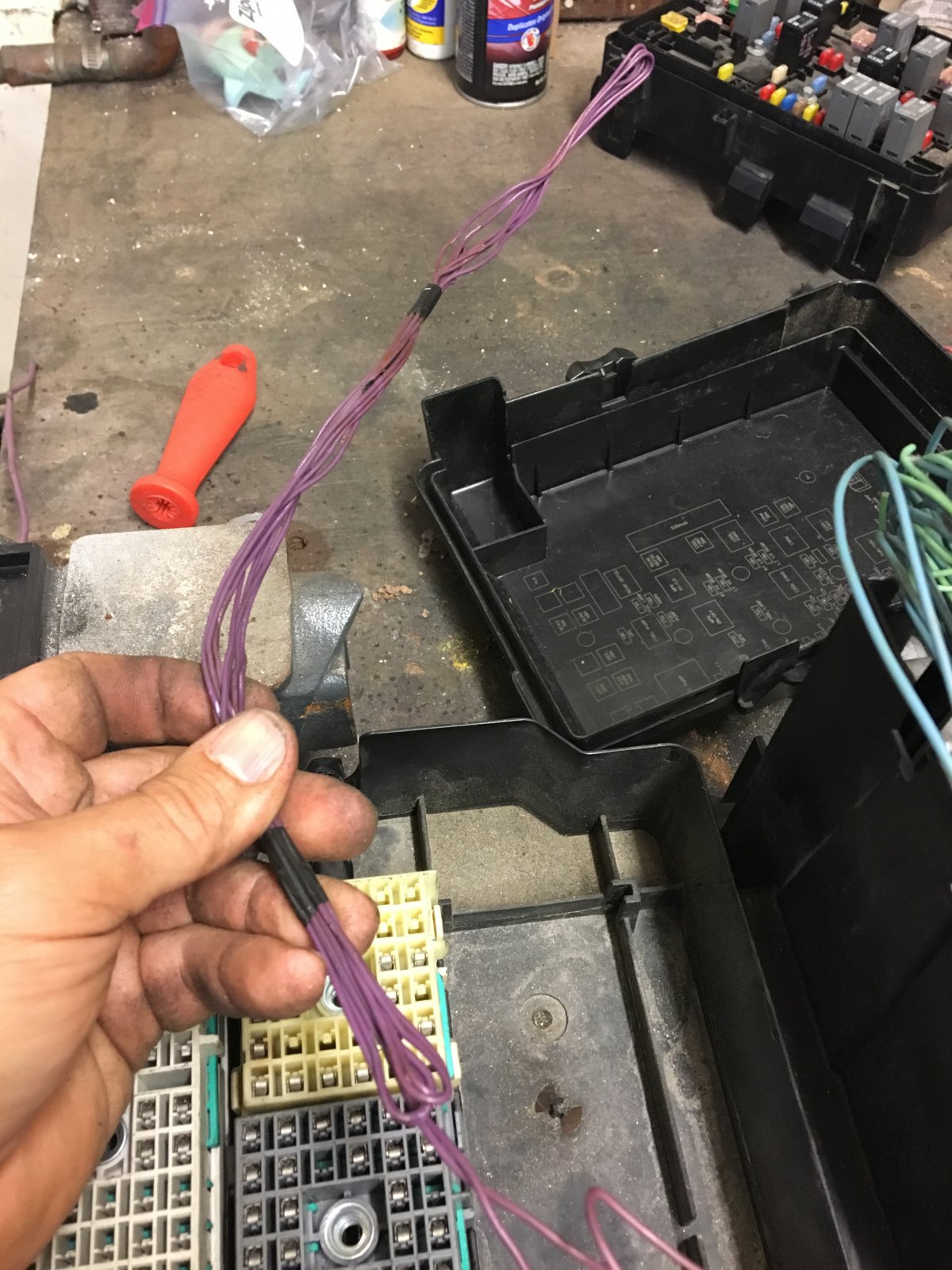

This purple bundle of wire seems to be part of the head-lite wizardry. Its sorta melted together can it be eliminated ?
Those are for the daytime running lamps. And yes, they're typically melted because GM designed them to basically be a resistor to drop the voltage so the day running lights aren't as bright. They can be eliminated no issues.
