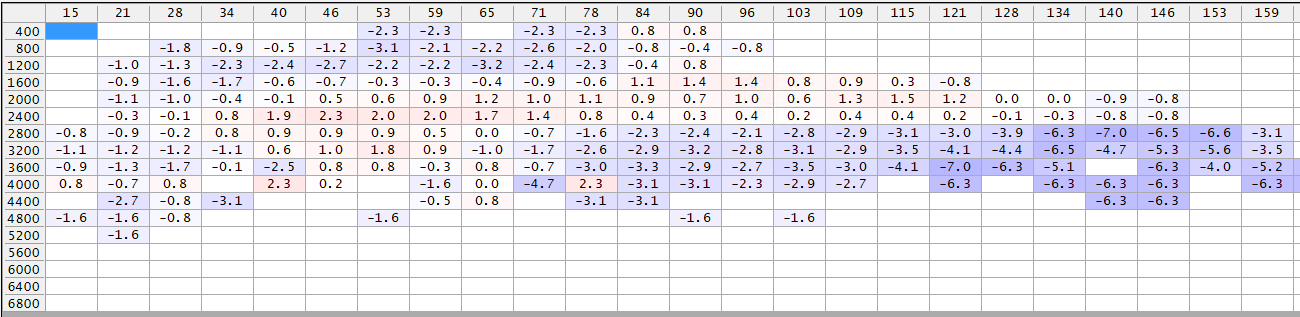

This is a poor example (it's the only saved log file that kind of shows it). Notice the really lean at 15 MAP? He would get that by letting off the throttle and letting the engine braking slow the car down (hence the 15 MAP= high vacuum). This is not my final log, just one that I had saved. At least it isn't that lean under load and higher RPMs.

Wierd. DFCO is still active on your log file.
To de-mystify tuning:
I looked up the Volumetric Efficiency (VE) table, (Which is what Chad was tuning)
and the top X axis is intake Manifold Absolute Pressure (MAP) in kilopascals (KPA). 100 KPA = 1 atmosphere (14.7 PSI), 15 KPA is 15% of atmospheric.
and the side Y axis is engine RPM.

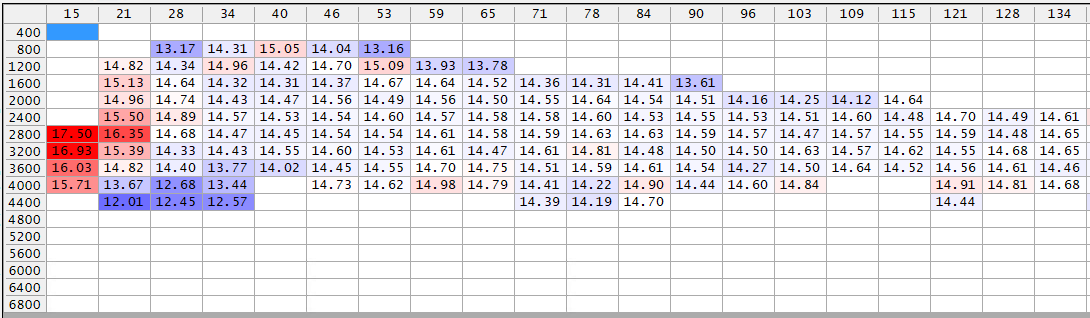

The numbers in each cell are normally the airmass, but in this chart, it looks like Chad has the air:fuel ratio, where 17:1 is lean, and ~14.5:1 is stoichiometric, and 12:1 is rich?

This graph is the LTFT (Long Term Fuel Trims) and is the ECM fine tuning the AFR (Air Fuel Ratio). The closer to zero the better, however you will never get zero especially since weather, altitude , and many other factors will cause this to be adjusted. It's just a bit rich on the high end but I would rather it be rich there and let the ECM take out fuel than be the other way around.
As Ross mentioned, the columns are the MAP (Manifold Absolute Pressure). Low numbers are vacuum (idle) and atmosphere is 101kPa, so anything about 101 is boost. The rows are the RPM. You cannot hit every cell and those that are blank is because he never hit that cell.

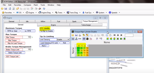

Check this table. 0-2 columns set to 0 all the way down, keep 3 at 15. That should do it
15841
This is for an LNF but I would imagine the same would apply for the LSJ. This topic starts at 6:05 but the whole video could help with additional details.

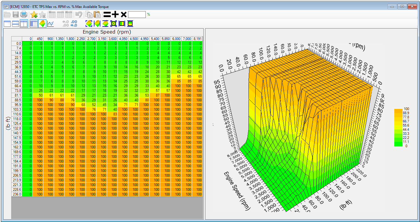

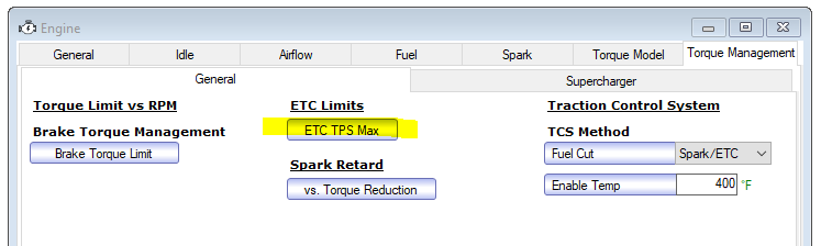

The Torque Management isn't the same between the two. ZZP set this table to all 100 giving max torque at all RPM and desired torque ranges. Made the car horrible to drive. The throttle was way to touchy. This is not stock but a happy medium. I may have to play with this to see if it makes any changes and I can find a setting that works but is still driveable.

Changing the torque management didn't seem to have any effect. This short video shows the relationship between the pedal position and the throttle. Notice that from idle, I cannot slowly rev up to anything less than 1500RPM. It's at a slightly high idle because the engine was cold. But I cannot hit say 1200RPM.
It seems the magic mark is around 7-8% pedal and then all of a sudden the RPMs jump up from there to 1500.
