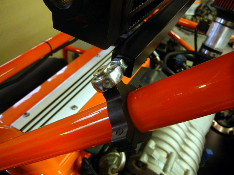

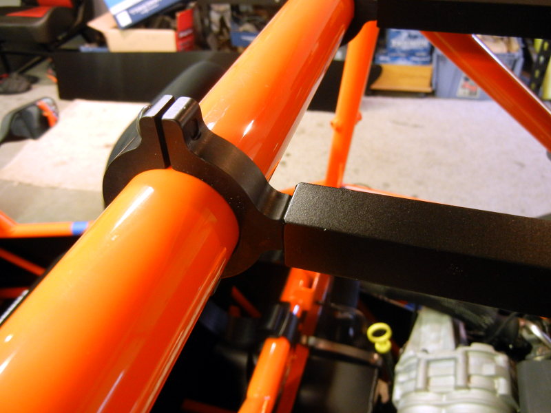

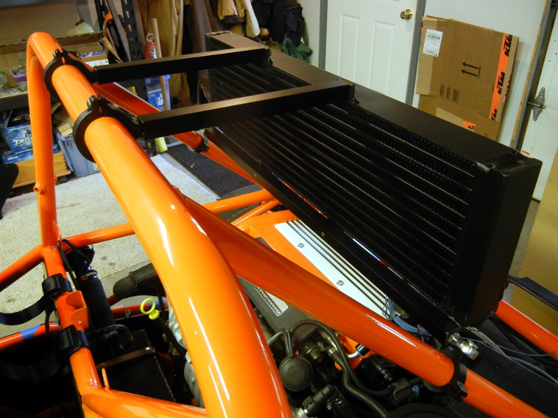

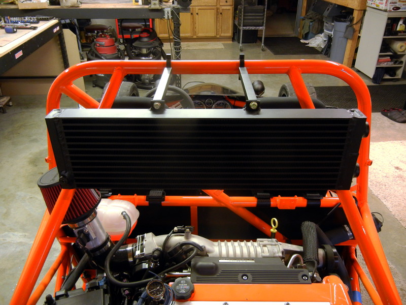

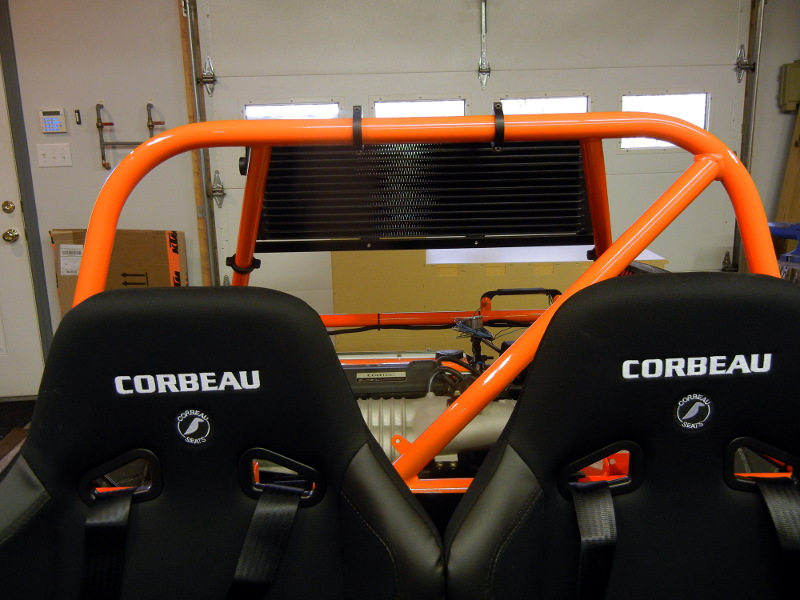

Worked on the supercharger intercooler this weekend. I elected to go with a different setup. I ordered this cooler from Frozenboost.com, it's the 2.5" x 24" x 7". This is the same one that Brad used. I followed his lead with the cooler and the clamp setup, used 1 1/4" clamps on the vertical bars and 1 1/2" on the top cross bar. Kaleb and I cut 3/4" aluminum square stock, then drilled and taped the ends of it for the fittings. It's high enough that it's out of the way when you look behind you. It should get some good air up there. Some may not like the obtrusive look of it, but it reminds me a lot of the DAKAR trophy trucks (minus the fan). Speaking of the fan, I decided not to go with a fan on this just yet. I think it will get plenty of air and there is no boost to be made at idle so I don't see the IATs getting that high at idle. I can always add one later if needed. I haven't plumbed it just yet, I have all the pieces other than on more short piece of silicone hose.
I really liked the tapered screw head to allow movement of the heim joint. Because of the compound angles here, this is about the only way to mount it.

This looks great! Will you be using the dual fans electrical hookups from donor radiator on the engine harness? If so, does anyone know if you can permanently turn those on or better yet put them on a switch? I know we can always rewire as needed, but I'm trying to be efficient.
Also, were you thinking about adding an Option B tank and plumbing?
The dual fans on the Cobalt harness is wired to run the fans in stages and in series or parallel, depending the amount of cooling needed. The way it's wired won't work well for something like this. The only good way to wire the fans to this cooler is to find another circuit with a relay/wire capable of the current draw and either switch it or run it constantly.

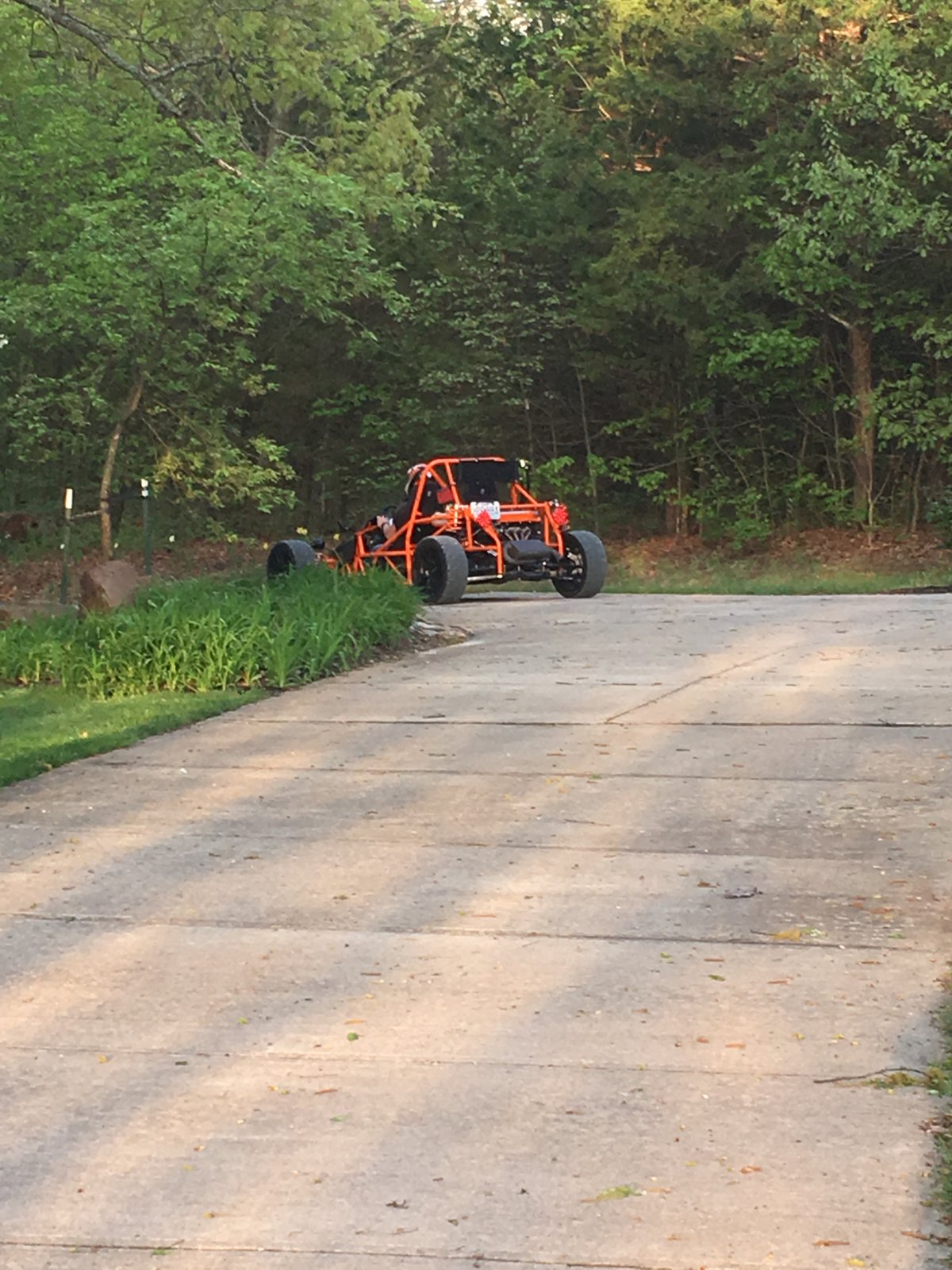

I drive to the DMV early to arrive at 7:30 (opening). Not a single car in the lot! They must not be open. Either way, I decided to just wait at the door but they were actually open and I was the only one there! I had my pick of who I wanted to help me.
I sat down with this very nice lady and proceeded with my boat renewal first and then moved on to the car. I explained everything to her and the only question was if I had a safety inspection done (MVI) which I had not. I knew others hadn't so I politely stated that others hadn't and this is a 2018 model and that it's a new build. She quietly replied that she would enter it and see if the system required it - IT DIDN'T! Although I had already made backup plans to get it done this afternoon. At this point she had plates, registration and everything ready to go. And then it happened - their credit card system crashed along with another system!!!! I was so close! I asked it they would take cash after just realizing I had the rarity of a $100 bill in my wallet. She took the cash and made change and I was out of there in 15 minutes! So happy!
