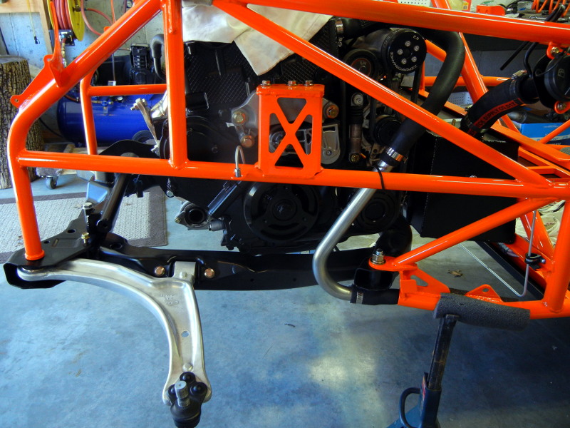

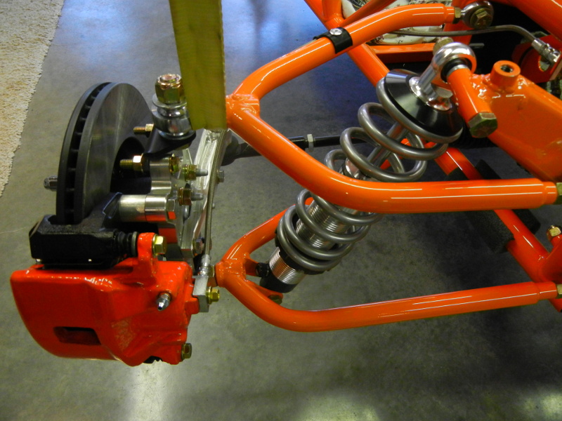

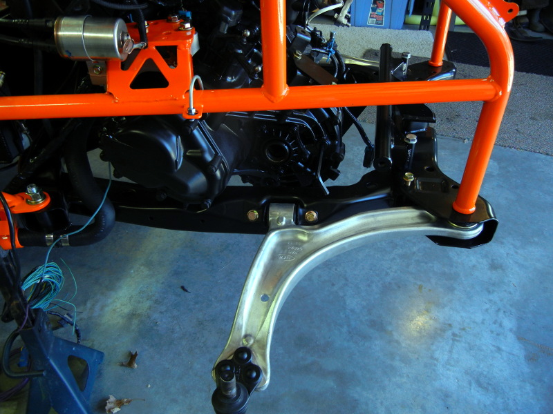

I see it looks like you had it hanging in a few pictures, did this make it easier during certain steps?
You are cooking right along
I'm short two jack stands, my dad needed them. And it was just easy to strap them to the beam so I don't have to worry about it falling. Does make it easier to get under it.

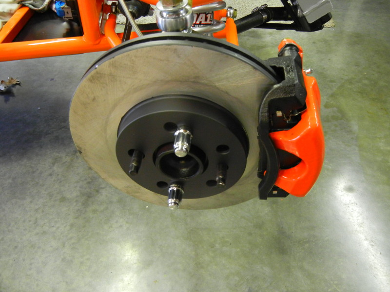

Brake Bleeding
I've bled the brakes on many different vehicles over the years and have always been very successful. However this was by far the most difficult to do for whatever reason. To start out, I bench bled the MC. But I just could not get it to push fluid through the lines. I finally used a Mighty Vac and suck the $h!t out of them while Kaleb pumped. Finally was able to get fluid through the fronts. I still need to work on the rear more but ran out of refill fluid. One quart just isn't enough after bleeding and flushing the lines.
***UPDATE TO THIS POST***
I now know the reason why I was having such a hard time bleeding the brakes. It turns out that the brake light switch was adjusted in too far and holding the brake pedal down a bit. This would not allow the pedal to release completely and expose the holes for fluid to flow. When I finally got it on the road, every great once in a while the brakes would not completely release causing them to get hot. Luckily Kaleb noticed it before doing any damage. I adjusted the switch in almost all the way and now have over 3000 miles on it without it ever doing it again. Resume reading...
I wish I had a good way to pressure the system like I did on the Vette. Maybe if I had another cap I could drill a hole in it and press the pressure hose in the cap.
The fronts are finally working some but will need a couple more sessions of bleeding to get the last of it out.

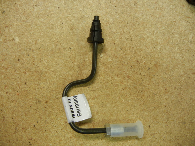

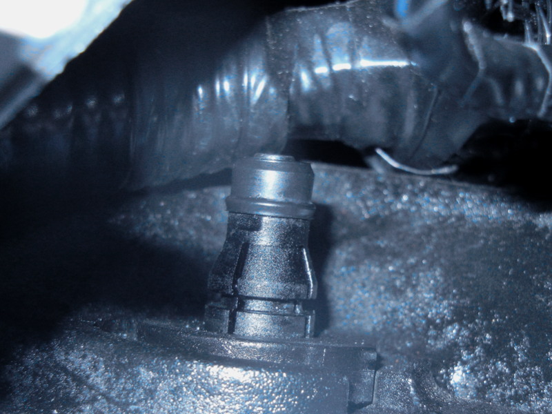

I noticed that I had brake fluid leaking from the bellhousing. The only thing it could be is the clutch assembly. The fear struck me that the new throwout bearing or something is leaking clutch fluid on the inside and now I am going to have to tear out the engine and take off the transmission! I thought about it a lot and remember when putting the clutch hydraulic assembly together it was missing an 0-ring which I found one and installed it. Apparently it wasn't an o-ring at all but a round seal that was missing.
I went to the local dealer and ordered the clutch pipe assembly. I didn't replace the entire assembly but used the seal off of the top. Everything went back together nicely and I feel much better about it's ability to seal. I haven't bled the system yet (tomorrow's chore) and I sure hope that I'm not jinxing myself. The seal must have come off with the aluminum fitting a long time ago.
This is the new clutch pipe after removing the seal from the tip.
And installed on the one on the car.

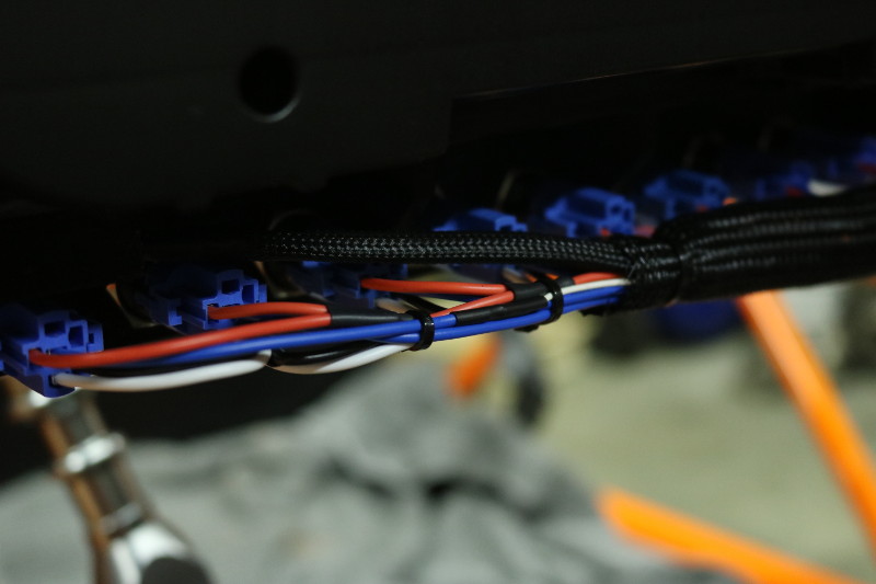

Finishing up on the wiring the lights, etc. I HIGHLY recommend this stuff. It's a split loom but it's thinner than the standard loom and easier to work with. In my opinion it looks a heck of a lot better too! It's also very cost effective. It may not be the best choice in areas that will see a lot of rubbing, vibration, and heat such as around the engine, however it's hard to beat inside the vehicle. You will need a very good pair of diagonal cutters or other type of very sharp cutter otherwise you are left with strands that didn't cut.

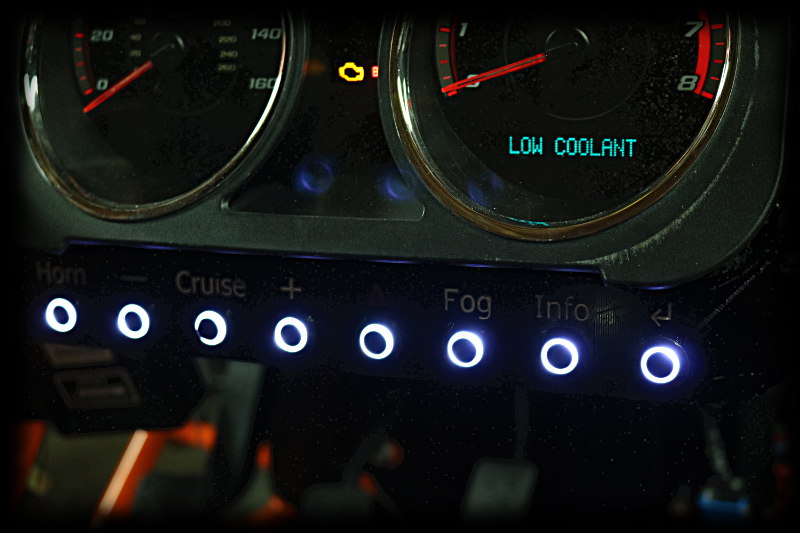

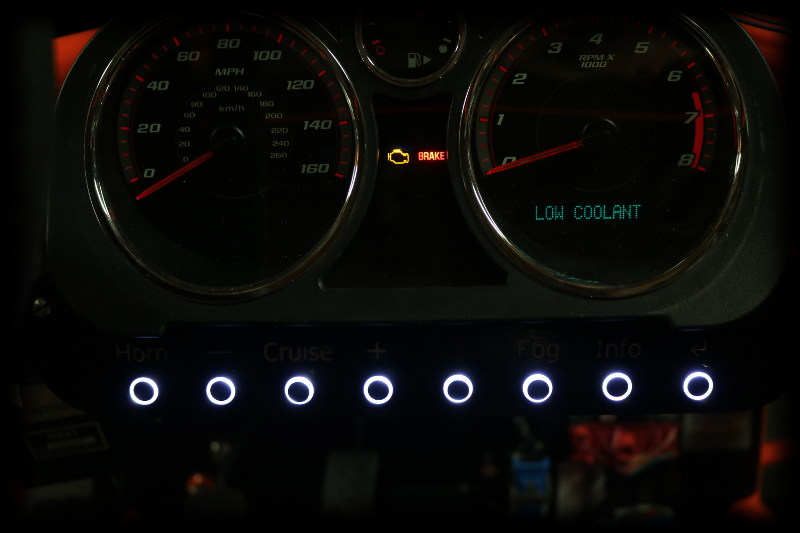

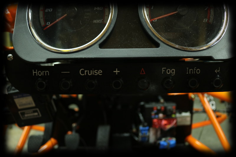

Kaleb has designed and printed a button dash for the car. This print has recessed text in it that I attempted to paint with a hair.
We used latching and non-latching buttons found here:
Latching:
https://www.amazon.com/gp/product/B01MQRM42P/ref=oh_aui_detailpage_o03_s00?ie=UTF8&psc=1
Non-latching:
https://www.amazon.com/gp/product/B01I9KDTZK/ref=oh_aui_detailpage_o03_s01?ie=UTF8&psc=1
These are the connectors we used so they could easily be removed:
https://www.amazon.com/gp/product/B01H5BMXKG/ref=oh_aui_detailpage_o03_s00?ie=UTF8&psc=1
It was very difficult to get a good picture of the dash as it's lit up, the lights mess with the exposure. In person it looks fantastic with the white light (other colors are available). They are wired to the original small PWB found inside the steering wheel controls I posted earlier. The PWB is mounted in a sealed box that Kaleb made and mounted to the back of the dash. The lettering looks much better in person, it's just so hard to get a good picture of it.

Wow!! That’s really awesome.
Karter2026
