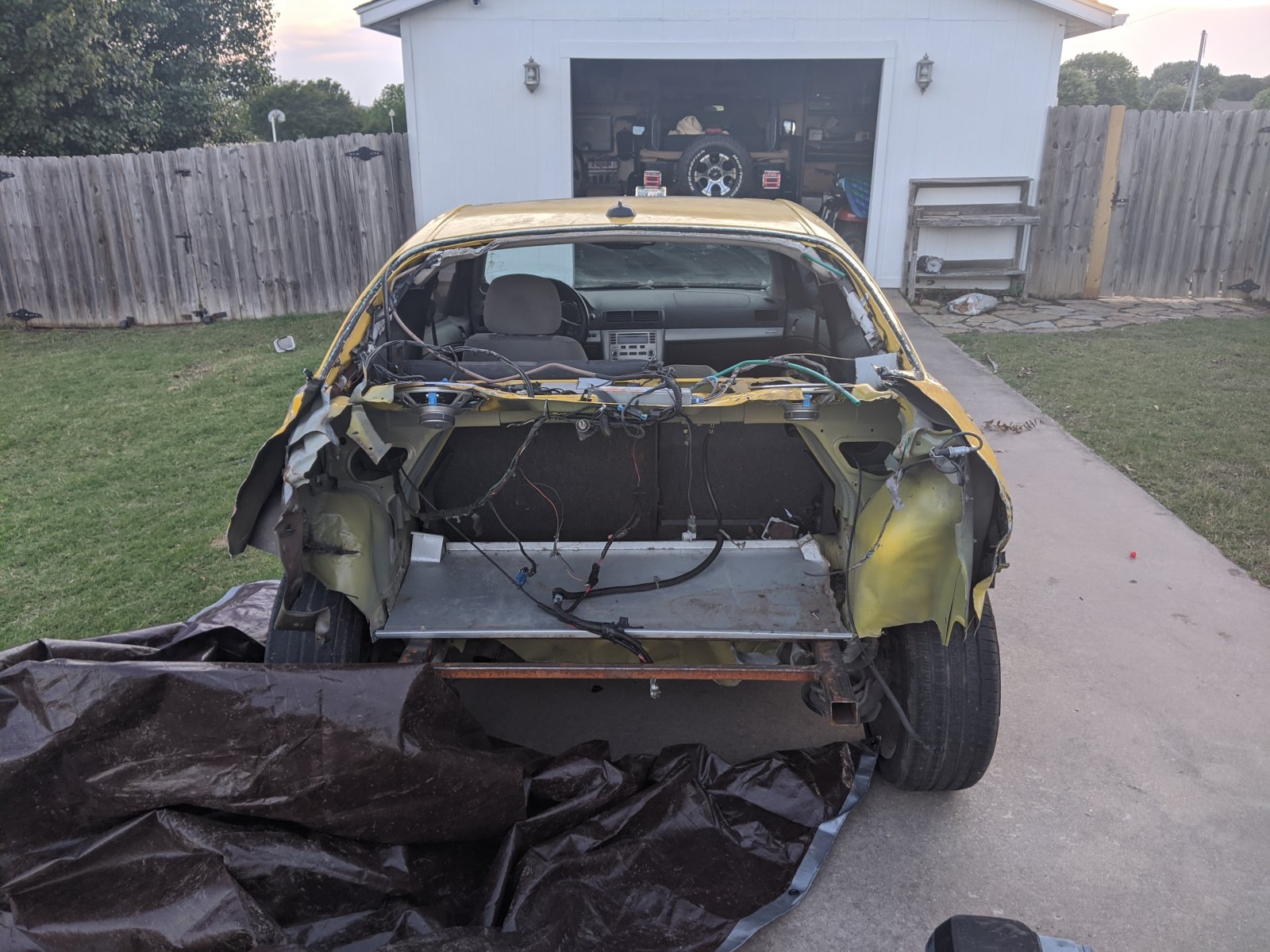

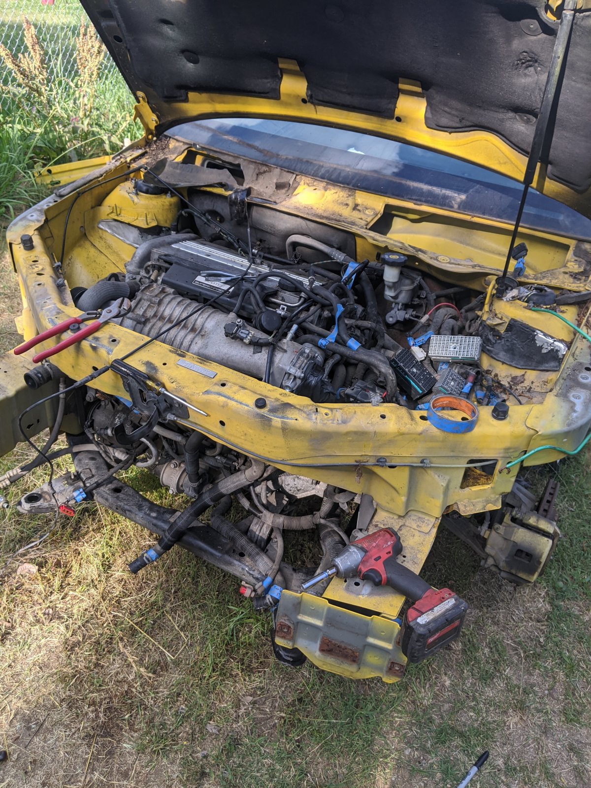

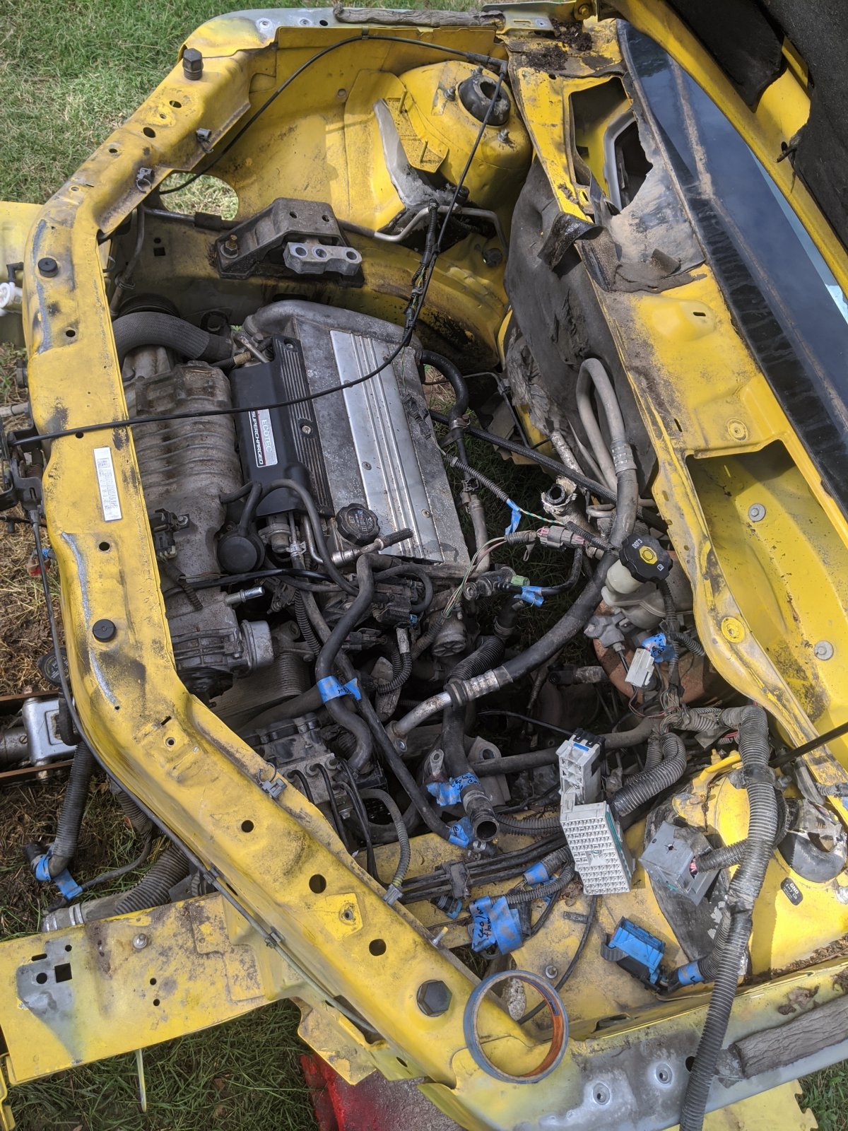

I started stripping my goblin a couple days ago. Slow and steady progress in nature's garage!
I will be working on my kit in my friend's dad's garage on the condition that I strip the car outside! He is also letting me use his tools! He has a sheet metal brake, so I am already toying with the idea of a custom dash!

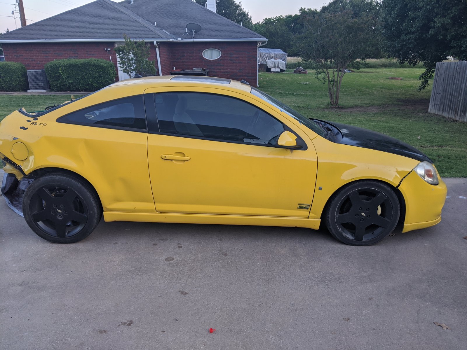

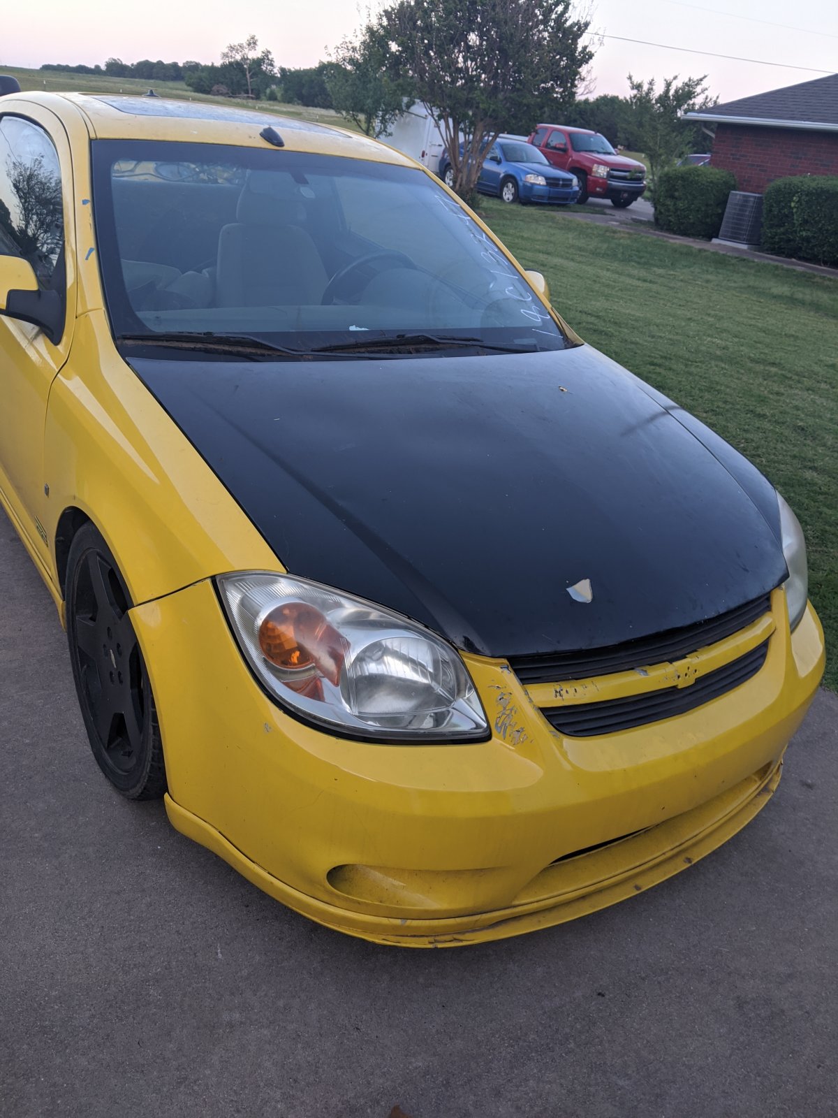

Picked up my Cobalt for $700 from a guy in Fort Worth. Runs, drives, and shifts, but has an idle surge and needs a crank position sensor relearn. (More on this soon!)

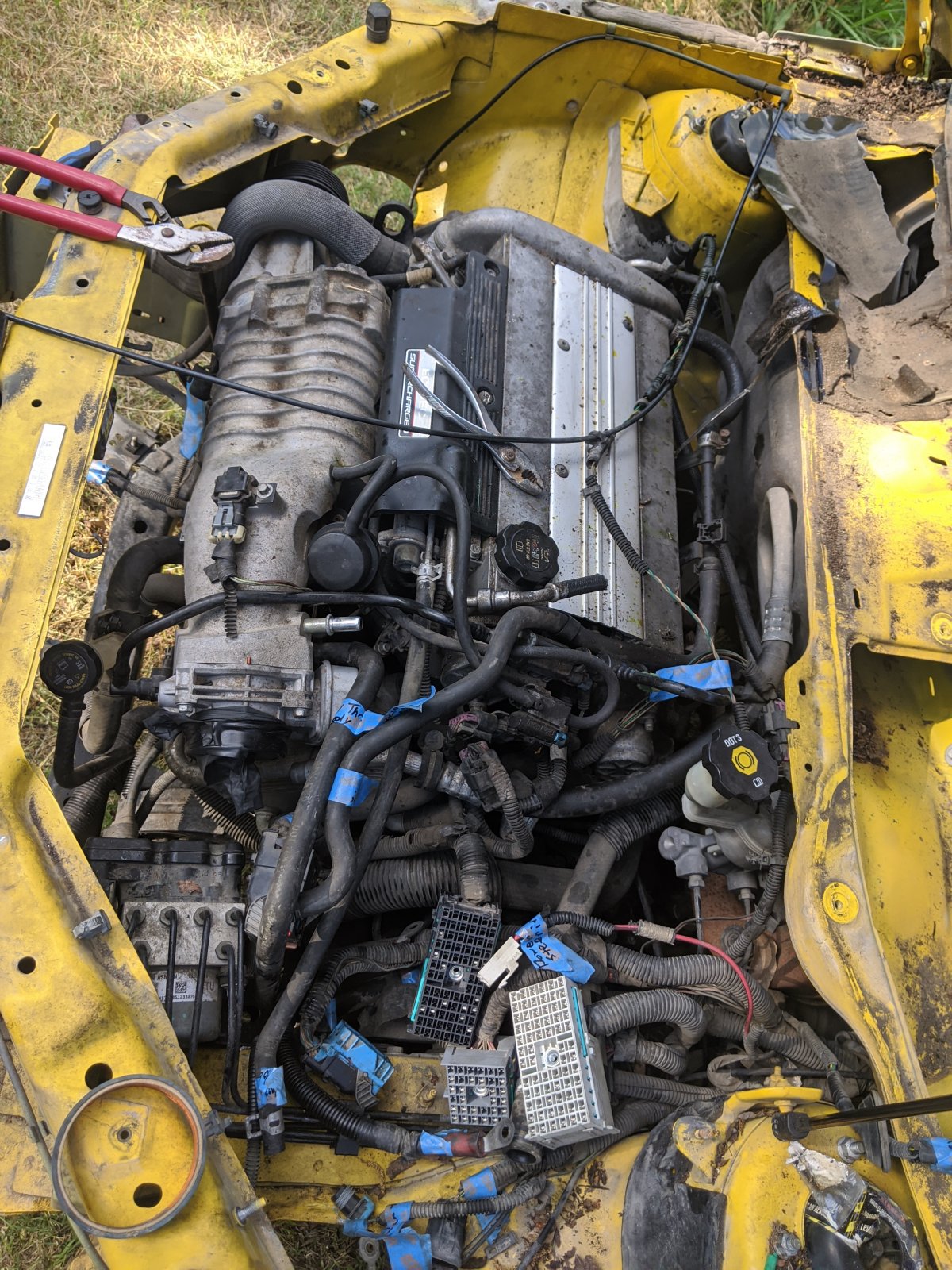

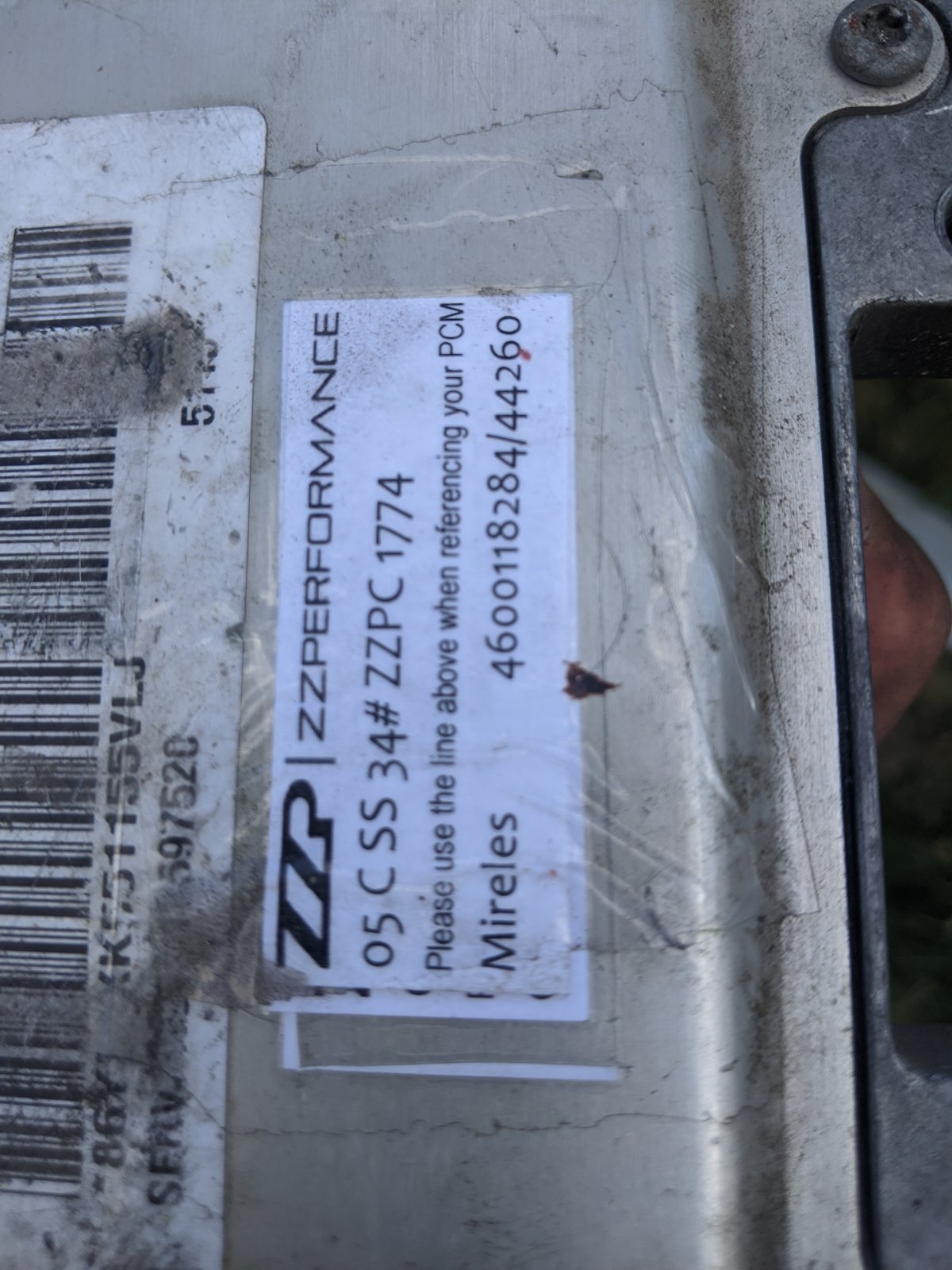

I found that it has a little secret! I think this is the 1.0 PCM from ZZP. I believe this is all that has been done to it besides an injen intake. It looks like stock injectors and pulley. I am also theorizing that the 1.0 pcm is the cause of the Crank position sensor relearn code.

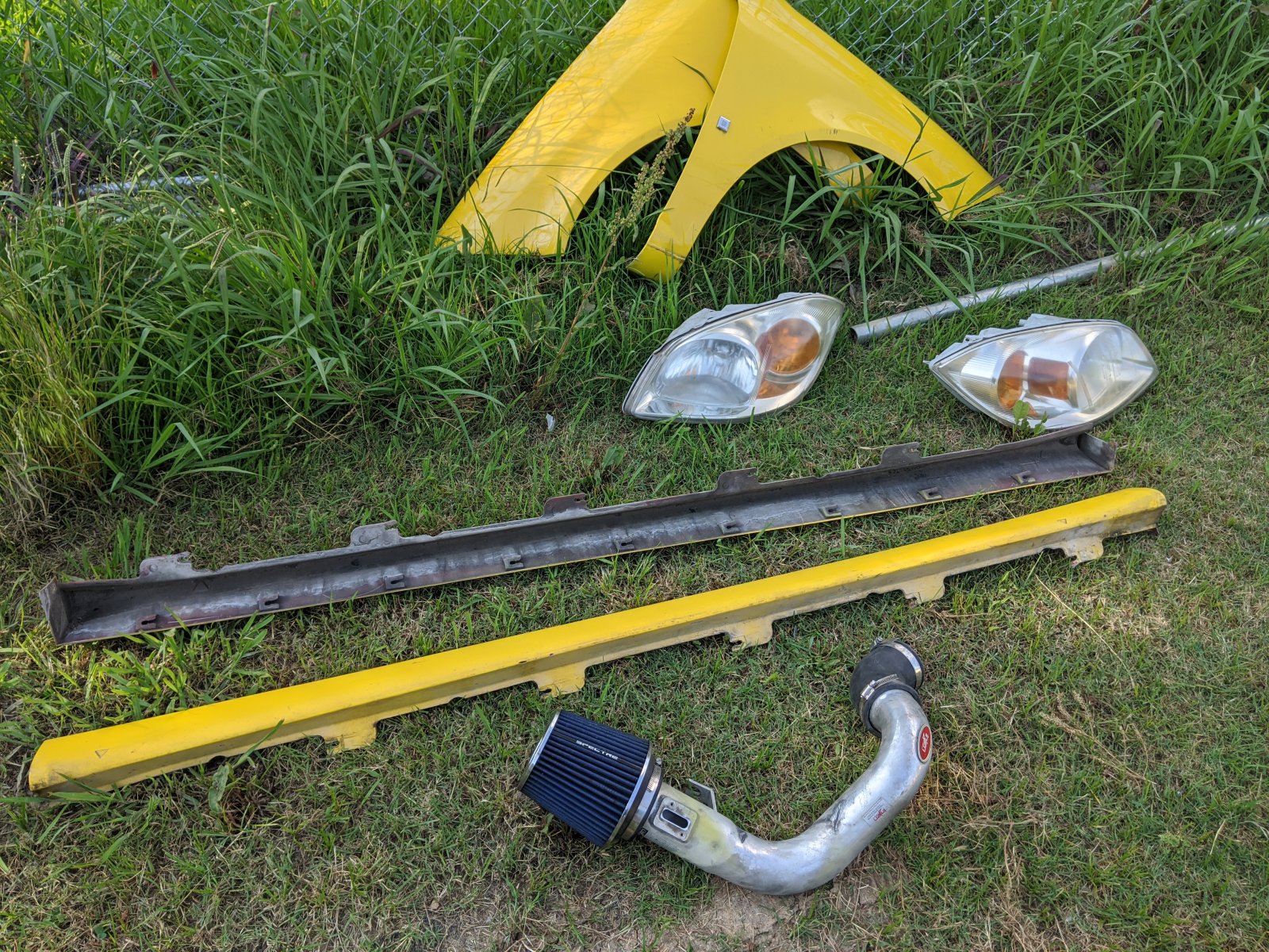

The sell pile. Now indoors.

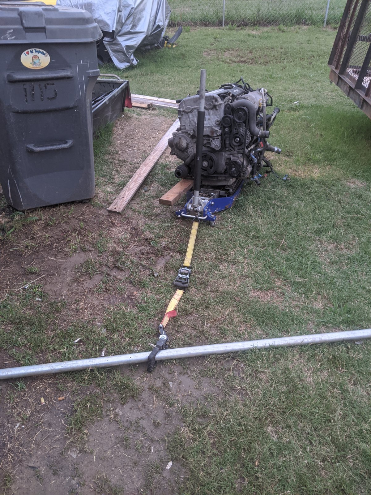

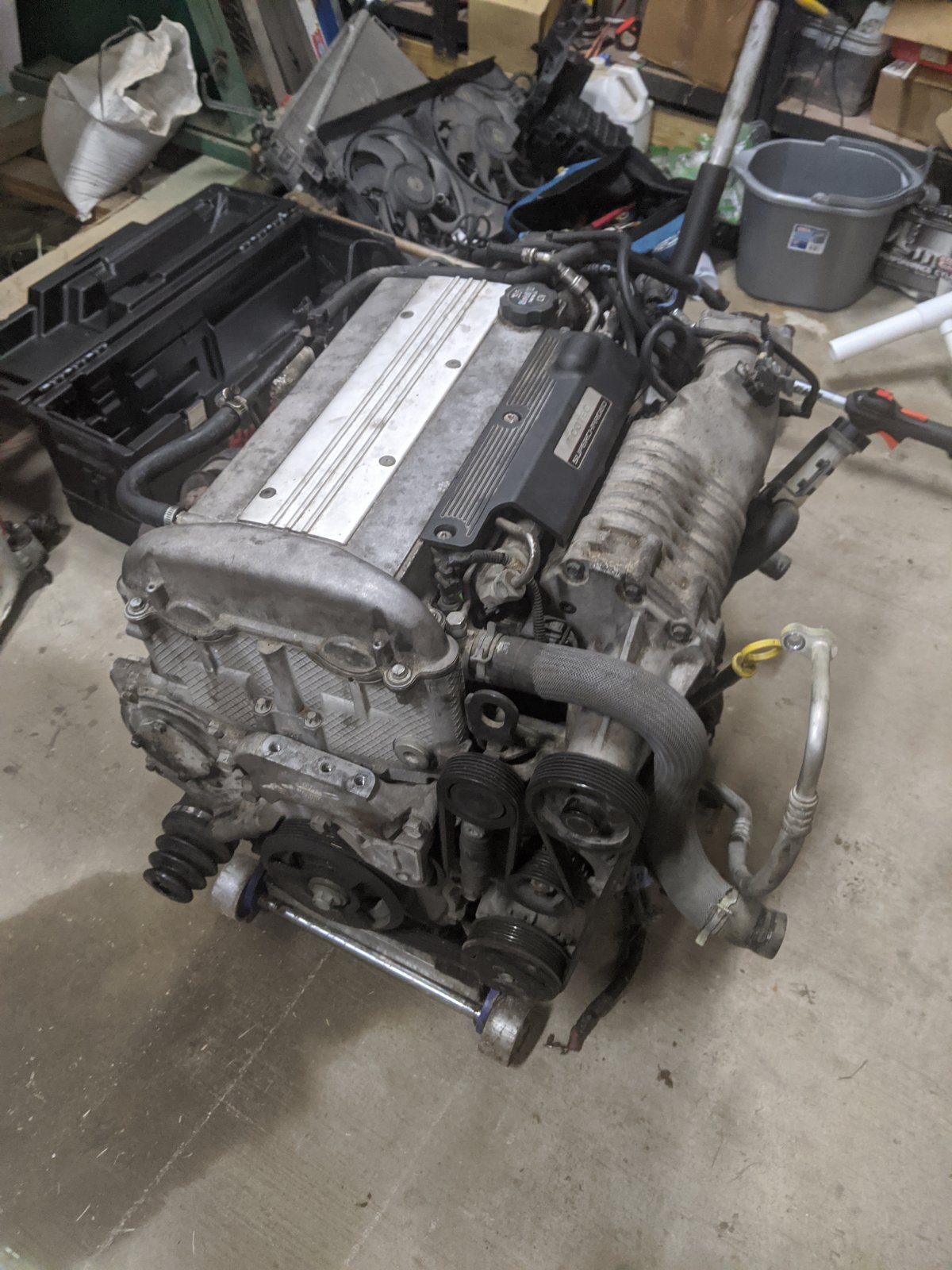

Got the engine dropped onto a wide atv jack relatively easy, but moving this beast was a challenge on wet grass!
I used a little side to side motion to get it out from the chassis, but then the real fun began!
I recruited two of my friends to help me move it. The first idea was to pick it up and move it from tire to tire while taking breaks in-between. We quickly realized that it is too heavy. The engine had all the dressings and transmission.
The next idea was to make 'tracks' for the jack out of 2x6s. This worked alright for a little, until we had to make a 90 degree turn.
The third idea was quite comical. See if you can piece it together yourself. The ground was wet, so it got tilled a little.
Finally, we made it to the garage and lifted it back on the jack to it's current resting place.
I've got most of the interior stripped since then!
Also, I found that the engine survived over 200k on a stock timing chain tensioner.
Interesting, not even a rattle when it started.
Updated tensioner on the way!
