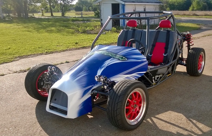

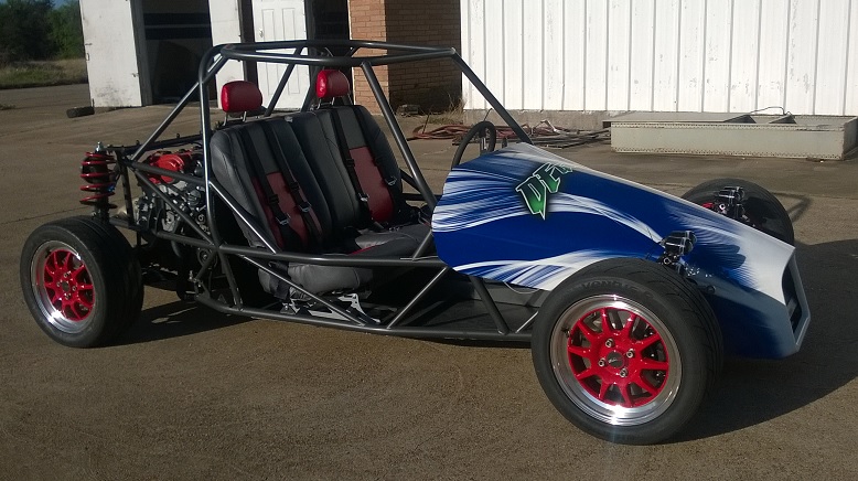

I borrowed a hood from Lonny to get pictures to get mine registered. Not quite ready yet, I need to get turn signals on it and a horn, but I need the pictures for the registration.

Here are a couple of the pictures. I did not put the side skirts on. Mine will need longer skirts (extended)

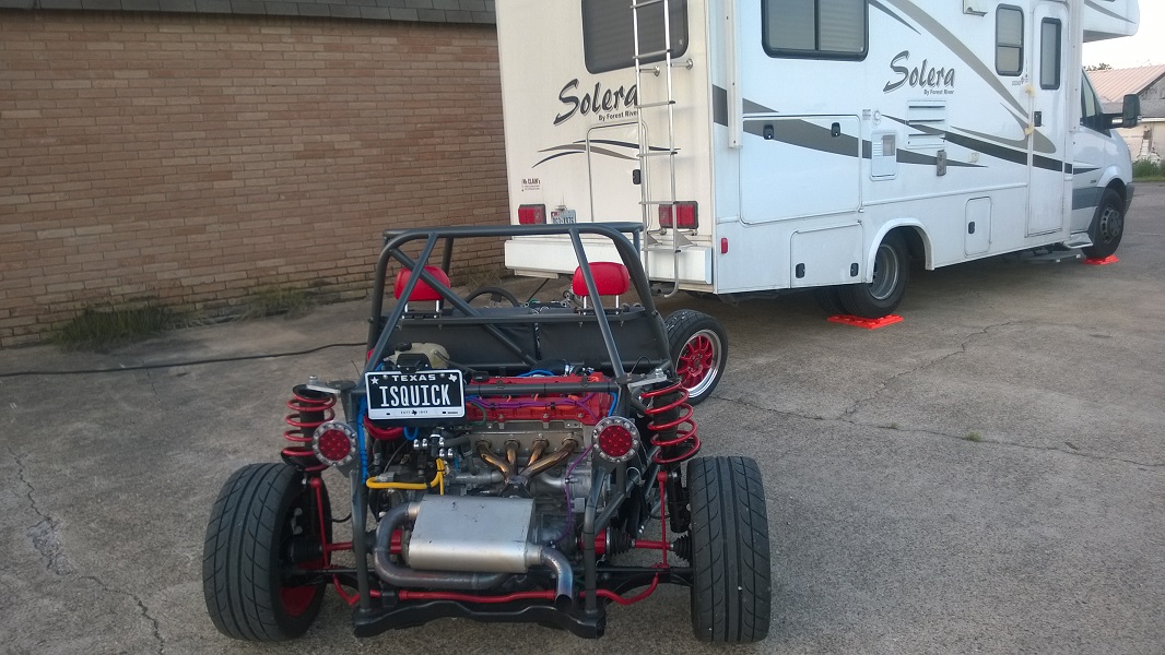

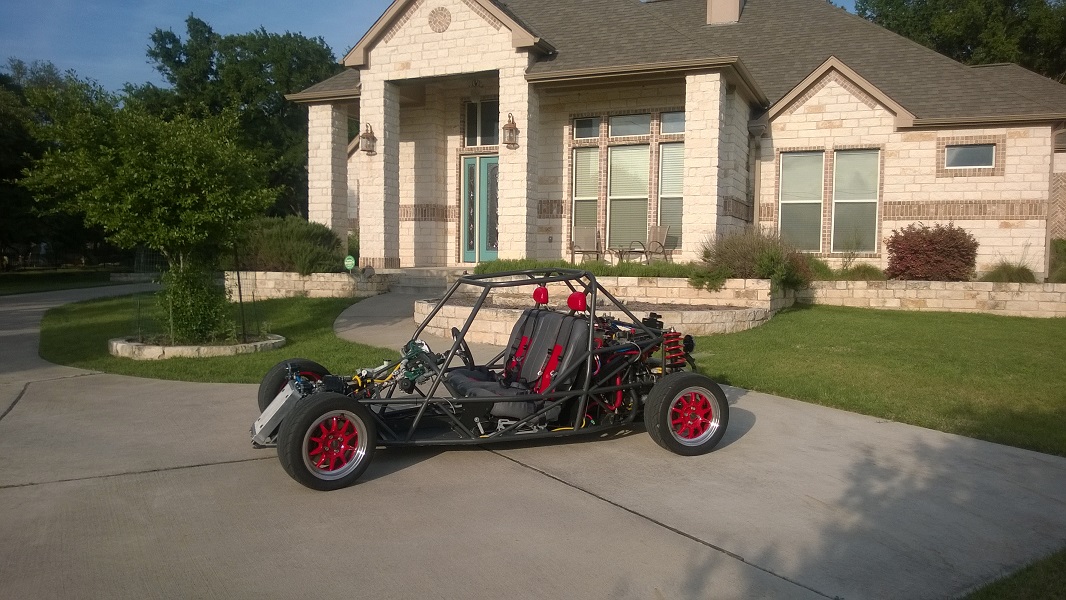

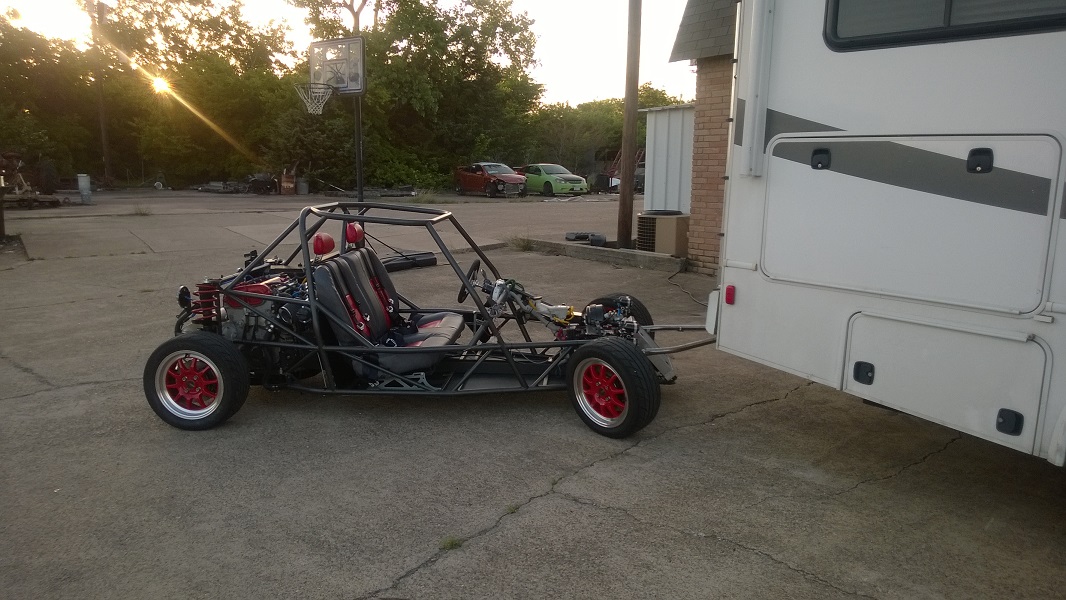

Car is now in Austin. My wife and I drove up to Read Oak yesterday, got the car hooked up to the motorhome, checked out the lights, all worked, also the transmission oil pump worked - I hooked it up the the battery power on the motor home that is on when the motorhome is running.
I had to spend time this morning - until noon cleaning up the mess I made at Lonny's shop and loading my parts into the motorhome. The trip back was uneventful. The car tows awesome. The transmission oil does get hot. I think the little pump I have could be a bit larger to circulate more through the oil cooler. I started the car a couple of times during refueling the MH on the trip and the transmission oil pump put a lot more oil in the cooler and cooled the transmission right down in a hurry.

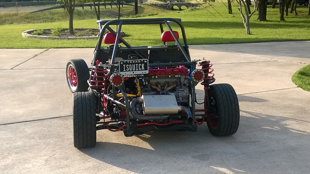

Now it is home and I can finish it up more leisurely. I weighed it at a truck scales for licensing - 1500 pounds, no body panels, hood, windscreen or fenders.
I put my license plate on it (I ordered a customized plate) but the car is not registered (yet). I need to put the front turn signals (on the side view mirrors) and the horn button on it so I can get the safety check need to license it.

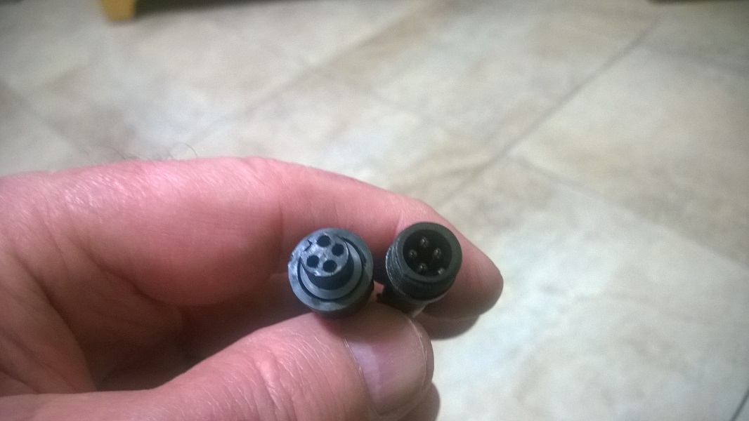

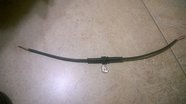

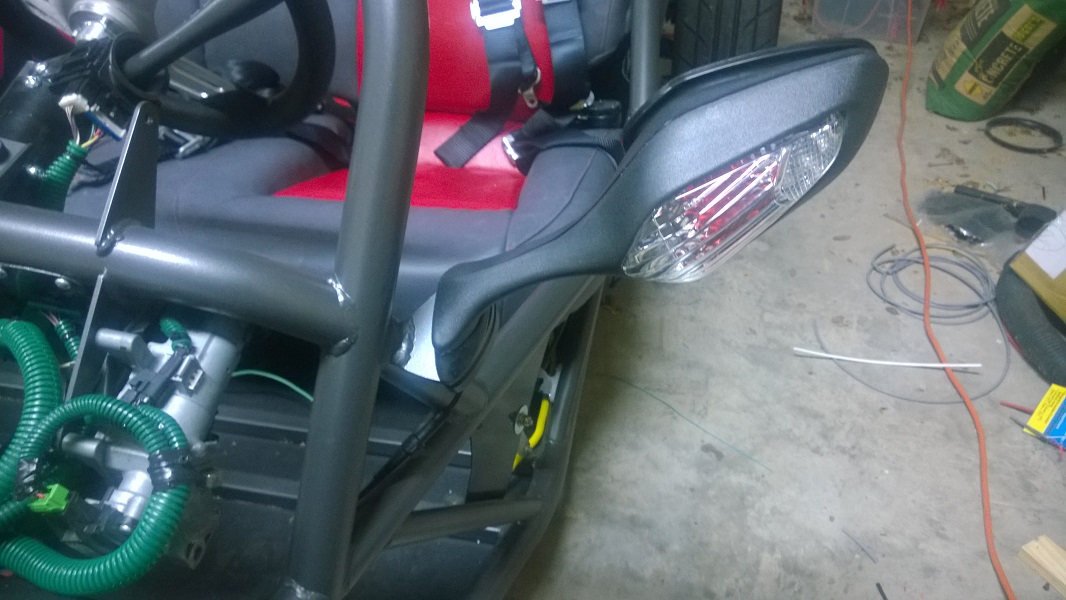

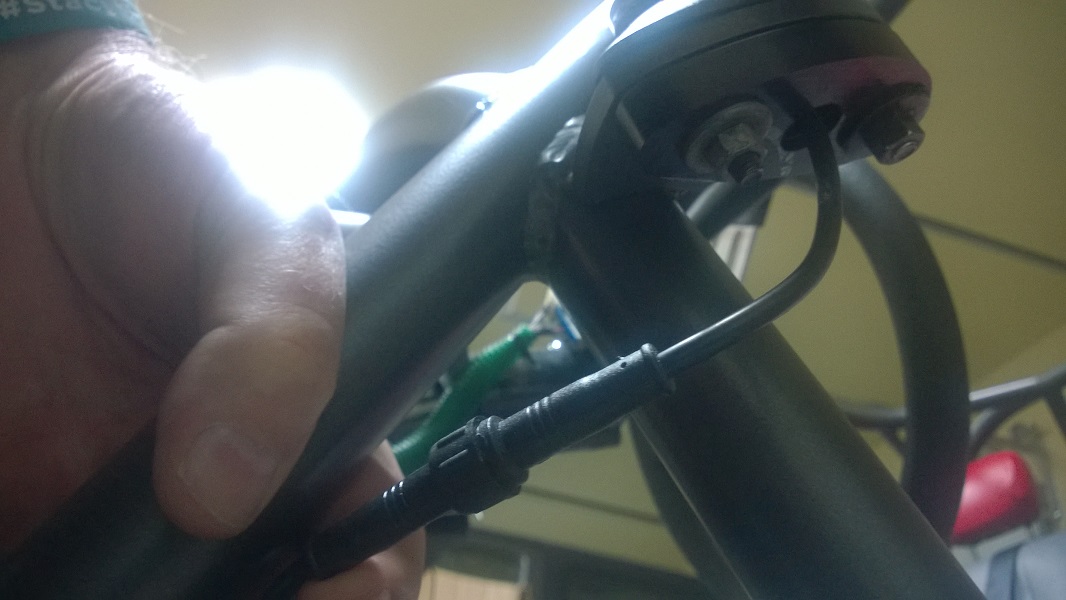

Worked at HOME a couple of hours today!!! I had to hook up the license plate light, and the mirrors - turn signals and running lights. I found these nice little 4 pin waterproof connectors on banggood.com. I use them on the mirrors (opened the mirror up and spliced them inside the mirror body with a tie wrap cinched on the cable in the mirror so it would not bet pulled out if something caught on the wire.
I used the same connector on the license plate light. I can now take the mirrors (or license plate bracket) off by just unplugging the connector.
These connectors are about $1.00 each (both ends) - $10.19 for a 10 pairs

Here is a picture from under the mirror. I drilled out the DF provided mirror spacer so the connector end would go through.

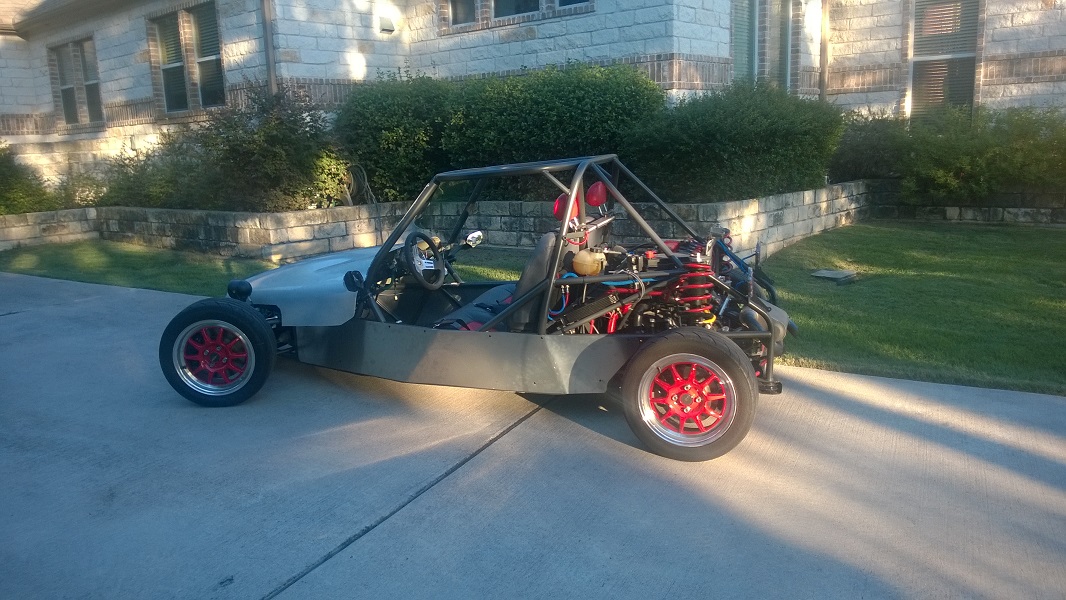

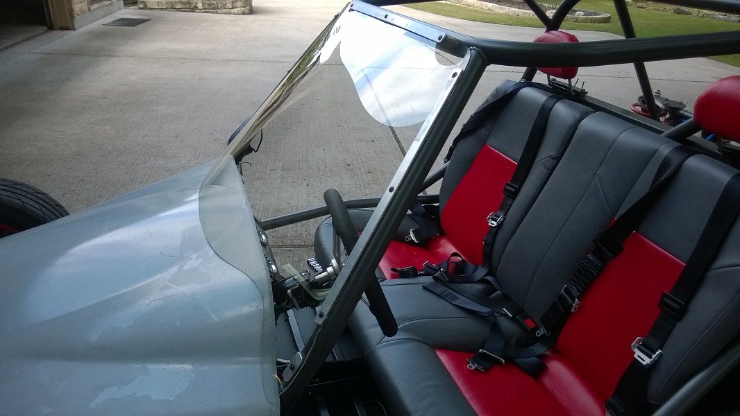

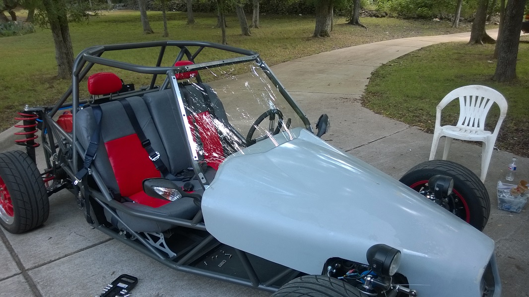

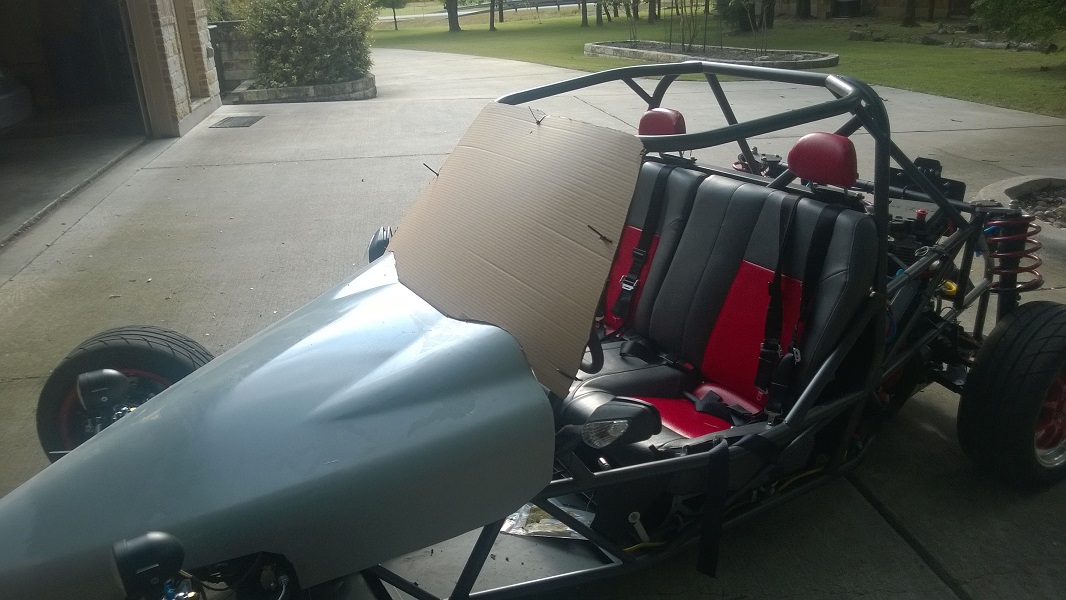

Started on windshield for my extended track easy entry frame. I thought I would like to use the front frame members to attach the windscreen. I bought a lexan (polycarbonate) sheet. I know it will scratch easily but it is also able to be formed to the car. Here is the beginning.

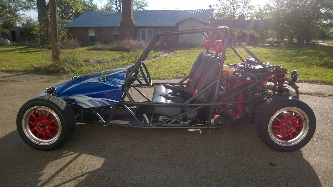

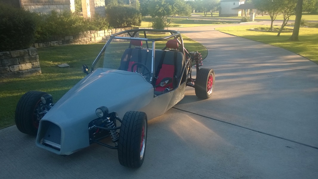

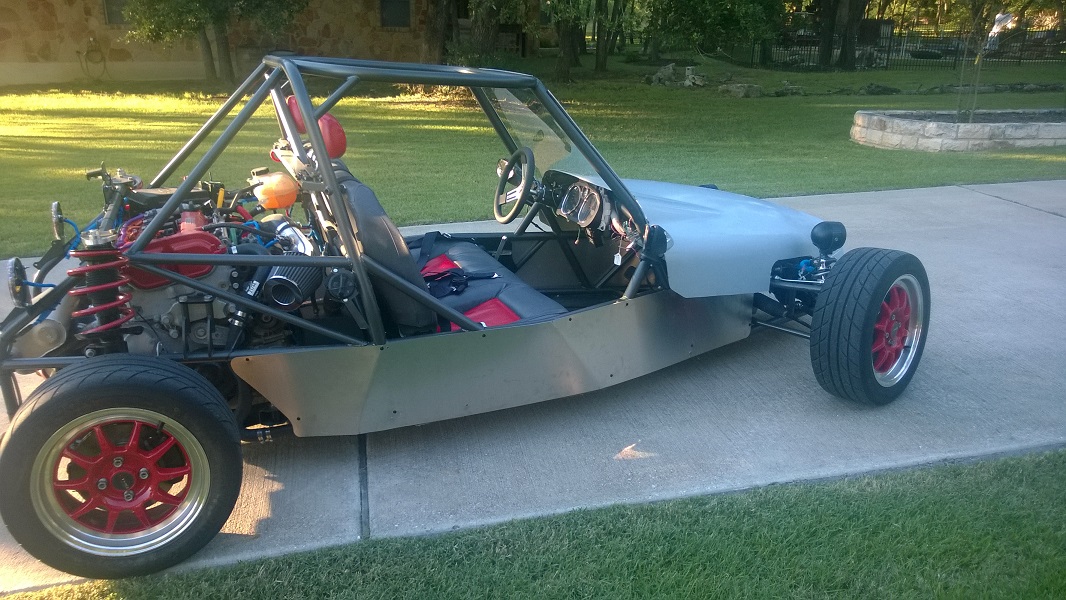

I'm working to get the car ready for registration. I took it to our county for registration, but the supervisor had to call the state DMV. The state first gave me a hard time, but then lightened up. My mistake was I used my own car pictures (just the hood) rather than a completed car. They thought it looked like a dune buggy. That was the biggest issue. Now I need to get the side panels on and possibly fenders and an engine cover. I think that will do it. There was a mention of a windshield wiper, we will see. I showed the guy a picture of Dennis's car and he said that would pass and Dennis has no fenders, no engine cover and no windshield wiper.

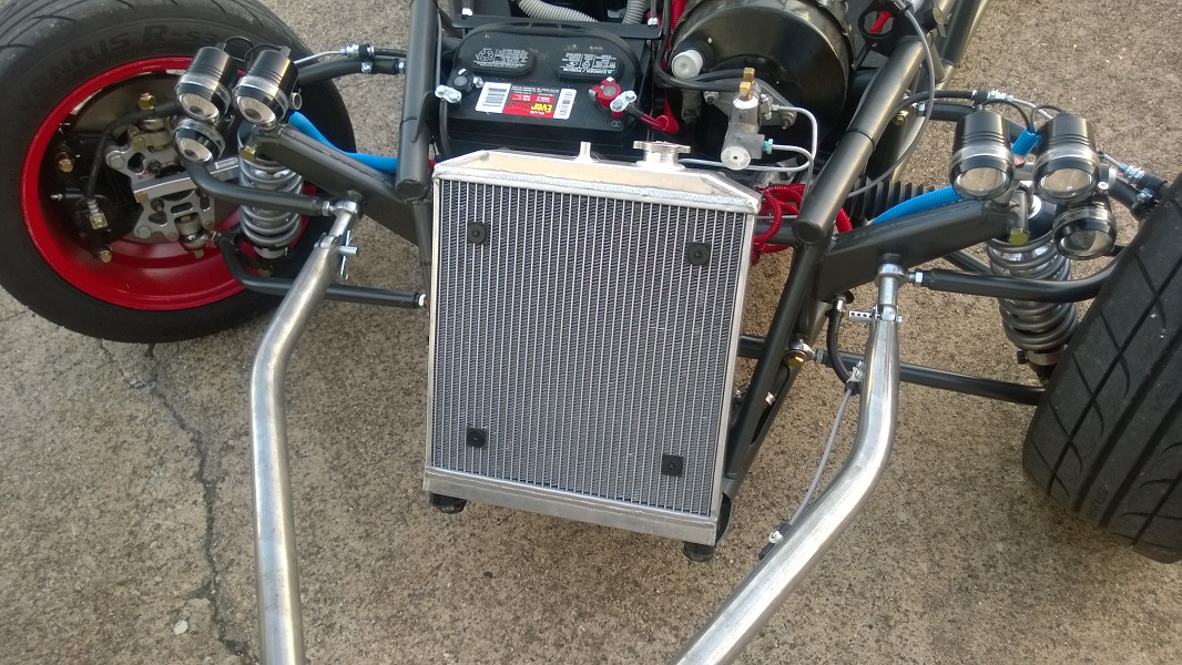

2) When I drive the car, the heat from the radiator comes into the cabin. I am extending the little firewall up to the hood. It is a bit of a pain now because there are so many penetrations of the fire wall. If I were starting over I would bundle the stuff that had to go through the fire wall better. I would also extend the little firewall that come with the kit when I was doing stage 1 (for a street car) to come to the top of the top frame rail, maybe 1/2 " higher so I could attach the top firewall piece. I made my firewall pieces from roof flashing from home depot. It is easy to cut and form.

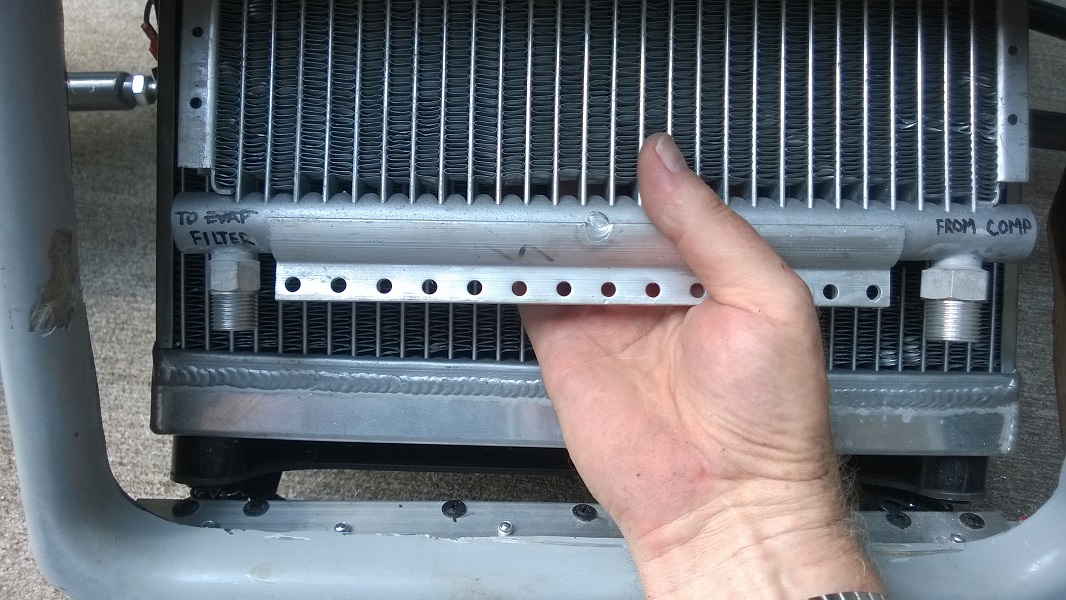

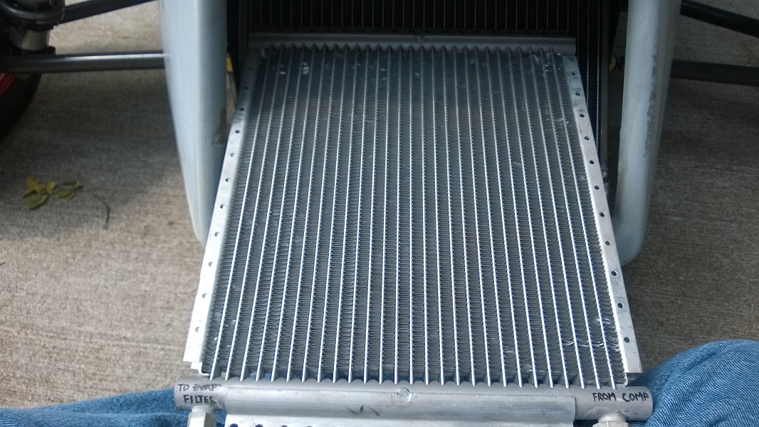

3. I raised the front of my hood by 3/4". I put a little channel between the hood and the hood bracket that comes with the kit. The primary reason I did this was to give a little more clearance for my AC condensing coil. If now fits easily and has plenty of room for fittings.
My Condenser Coil
