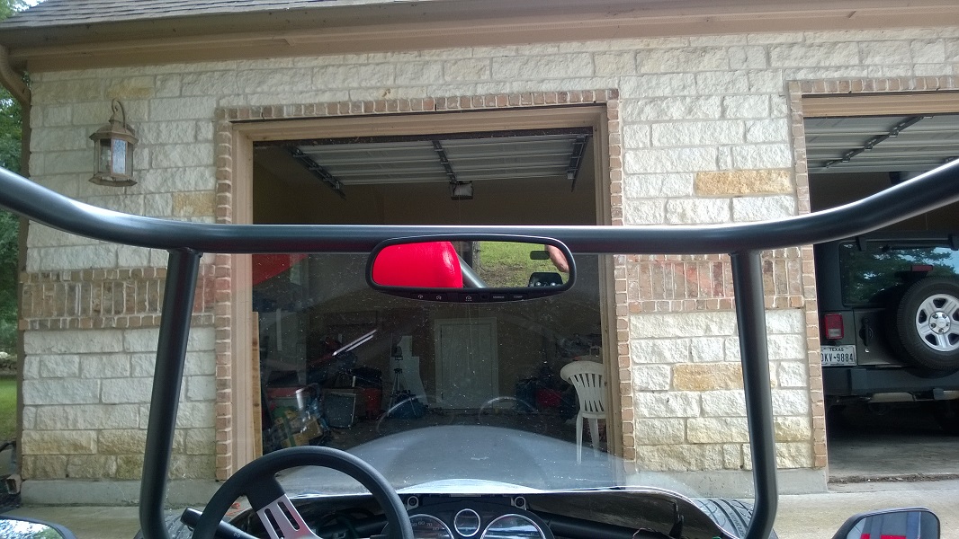

Today - rear view mirror with homelink garage door openers, compass. Ran wire in frame hoop

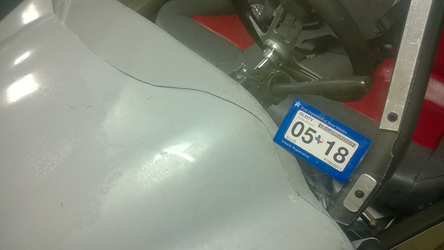

I have yet to paint my body panels. My windshield is attached to the front roll cage hoop and not to the hood. As of now, I plan to cut off a small portion of the hood at the passenger compartment for a cowl. I will attach the cowl piece more permanently to the frame and windshield. Then the balance of the hood will attach to the cowl and the front clips so I can remove it easily. A design in progress.
This entire effort would have not been necessary if I did not have the full roll cage. What I did not like about attaching the windshield to the hood with the roll cage was the angles of the windshield do no match those of the roll cage. Without a roll cage, it is not a problem.

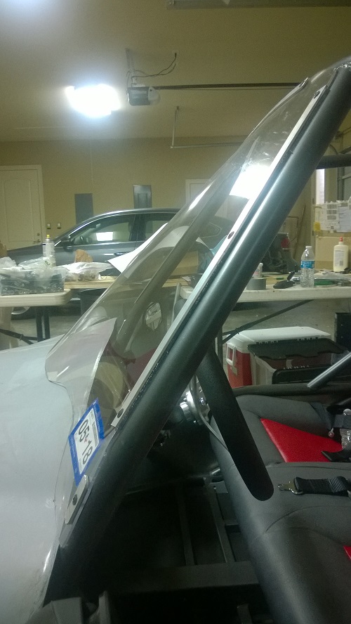

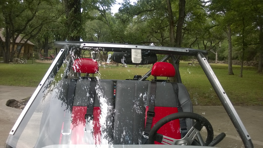

I was asked to post some pictures of my windshield. I did not want a flat windshield - the only car I ever seen with a flat windshield that looked good was an Lotus Esprit. I also di not like the multiple angles of the a-pillars and the DF windshield.
Mine windshield is Lexan. the hardest part was getting it to match the hood. I made a cardboard template and then cut the windshield out with a jigsaw. It is not perfect. I mounted it to the A-Pillars and the top of the cage. The hood goes under it - but .... it really scratches the hood in removing it and I plan on cutting 6" off the backside of the hood to make a cowl and (more) permanently attach the windshield to the cowl and to the car. Put clips on the balance of the hood to connect it to the cowl. I then can get the hood off and on easily. If I ever need to get under the cowl, I'll take it off together with the windshield. The windshield does come on and off pretty easily. I am planning on raising the back side of the hood just a bit and makeing a more perfect junction between the windshiled and the hood. If not, I'll get a new piece of Lexan and then I can get it much closer using the existing one as a template.

Haven't worked on the car for a while. Busy summer. Worked on the windshield today, fits a lot better. Getting ready for the hood modification.

It turns out my hood did not need to cut to work with my windshield. I will post a picture later. Still working on it.

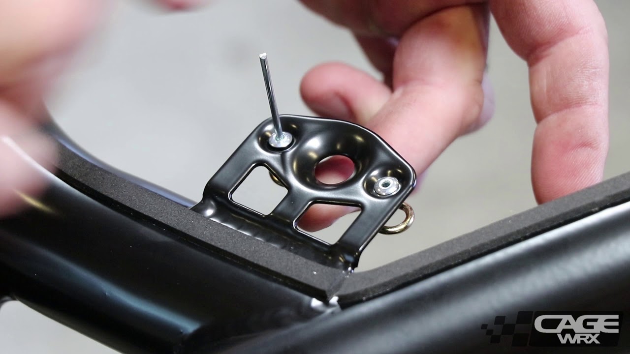

There doesn't need to be a hanging D-ring. The dzus fasteners that we used for the panels on our Baja SAE cars just had a coin slot in the heads. This isn't the best picture, but you can kind of get the idea.
