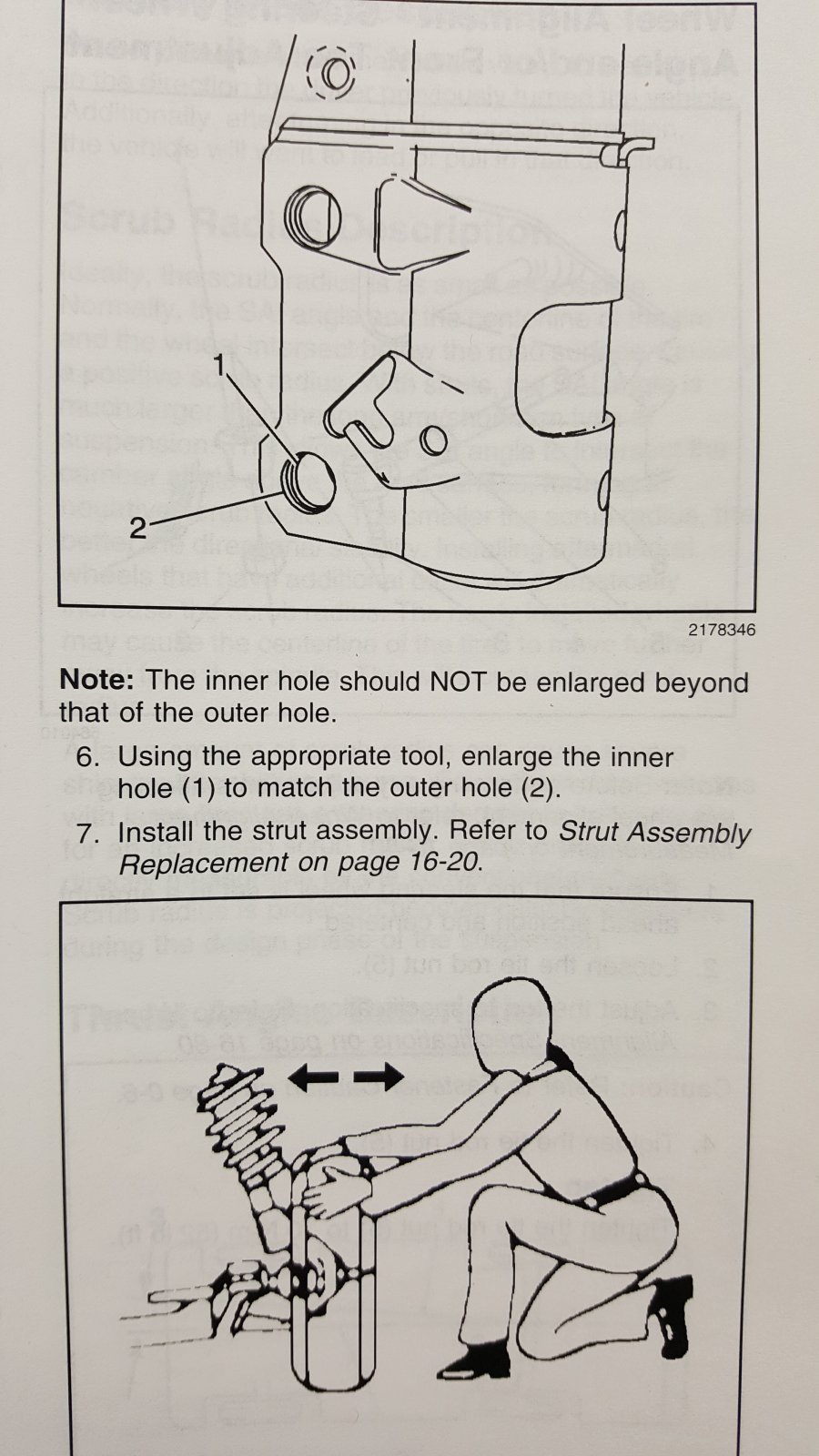

Ideally the brackets should set the camber. But if you've ever removed the rear struts from the rear knuckles it'll be off. Mine was -2.75° on one side and -1.3° on the other.
The holes through the knuckles are the same size as the holes through the struts and the bolts are a very tight fit.
The GM manual says that the only way to gain adjustment is to drill out the strut holes. Your struts may have been drilled out by an alignment shop to adjust for worn suspension bushings. Otherwise it should go back the same way everything.

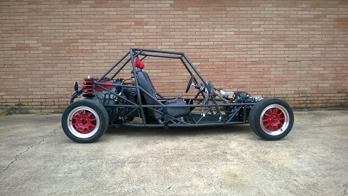

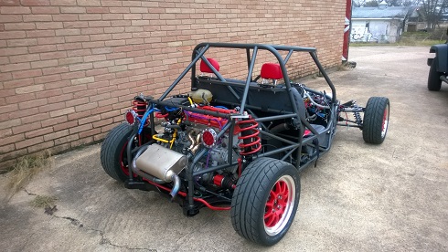

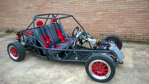

Getting closer!!! I think I'm finished on the rear-end of the car!!! License plate bracket and light!
