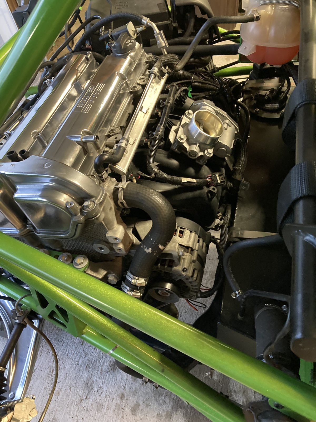

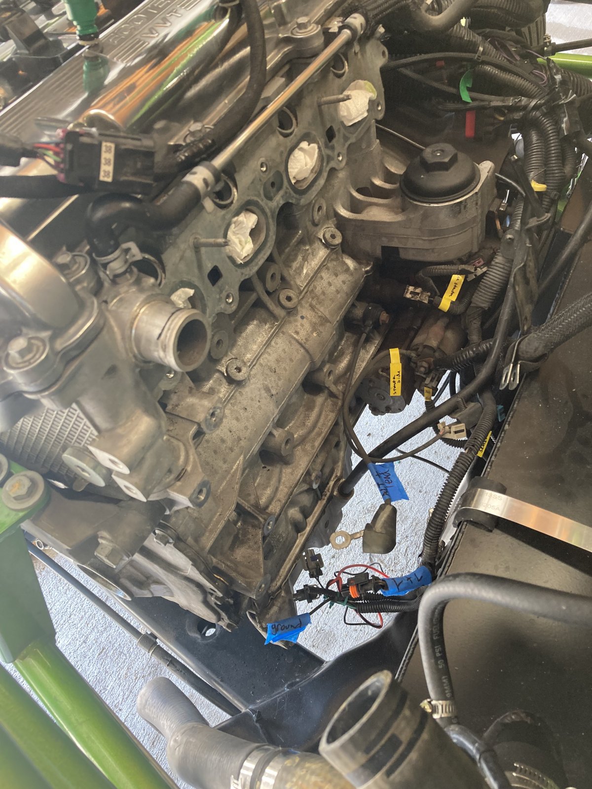

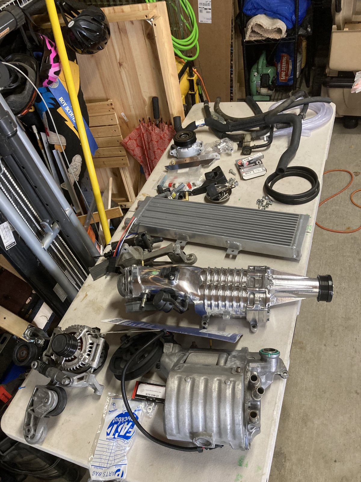

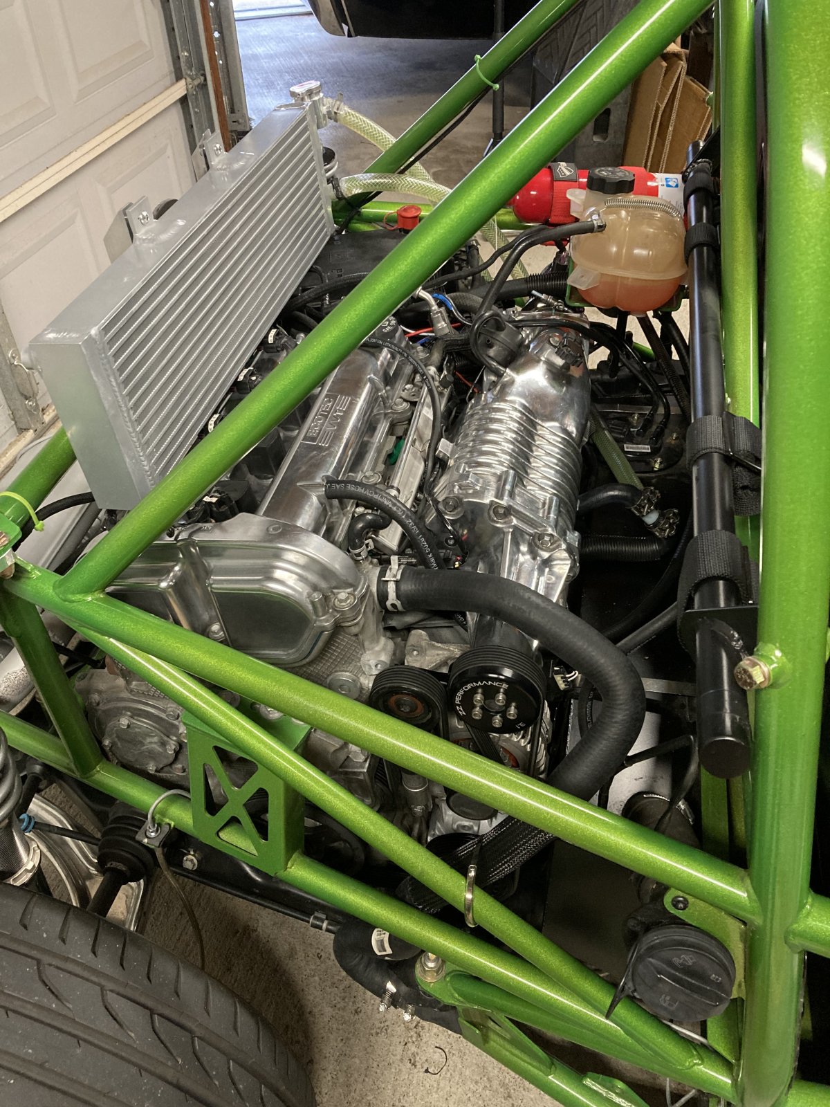

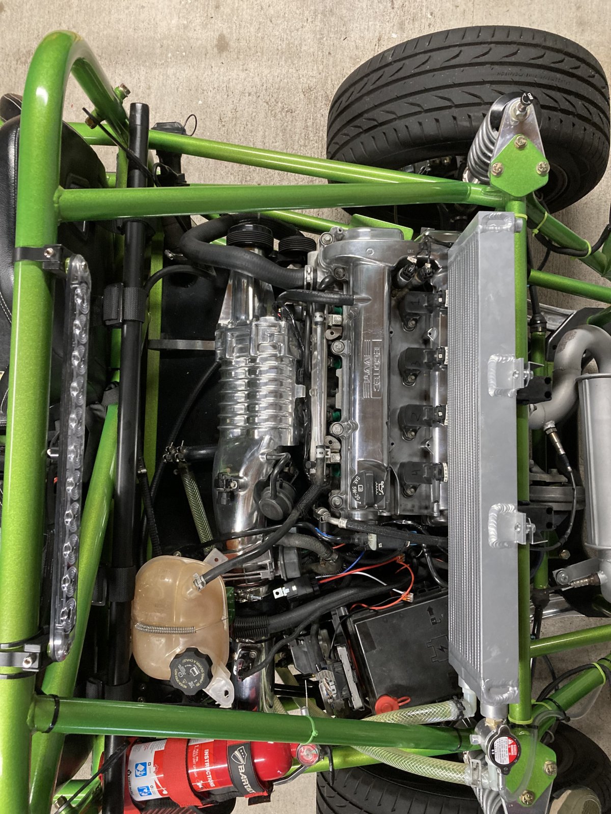

I would guess the LNF will go for 1-$3K, but I'm not up to date on your area. Both should work well with a goblin. The LNF is more power off the start, but the LSJ has equal potential if modding the engine. The LNF will make carbon deposits on the back of the valves, until you add a 5th injector... the LSJ has that supercharger sound. I like them both! Good luck
