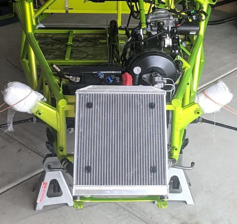

I got the new clutch cylinder in and installed. Bleeded the system with my buddy... I did accidentally puncture a hole in my radiator. I got a new one in (double core instead of a tripple). This one has a radiator cap. Does anyone know if this will interfere with the hood?
IDRVSLO
I spent the weekend going through old build threads. Looks like they did use the ones with caps prior to the current version. Should be good to go. So it ended up being the clutch cylinder?

They made it idiot proof for the idiots who want to check their coolant level at the radiator.
You're guaranteed a need to add coolant if you ever do remove the radiator cap.

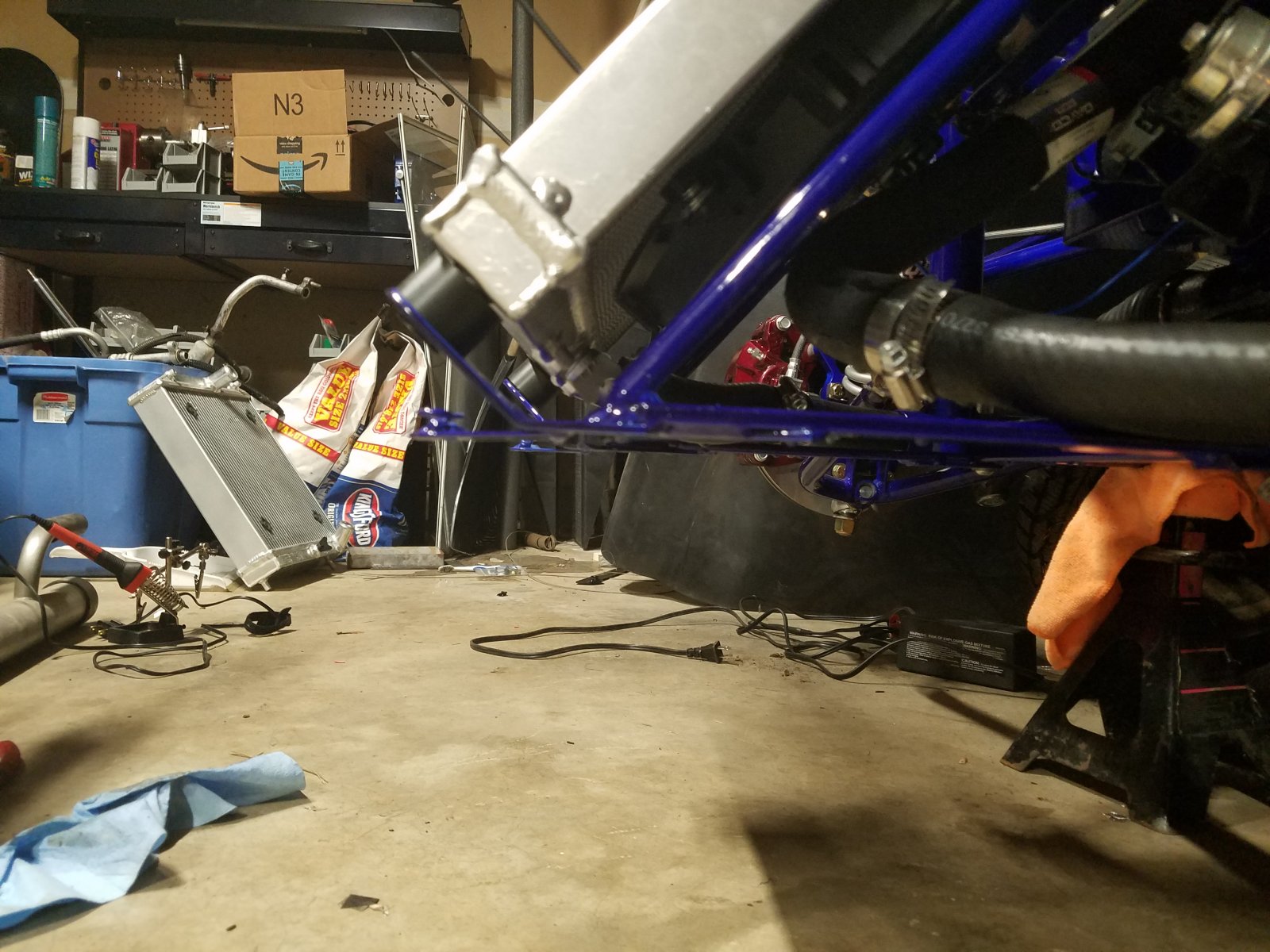

Check the angle of the lower tube. We use to cut the lower tube off and weld it back on at a greater angle to keep the lower radiator hose from sticking out of the bottom of the frame. The new radiators are special order.

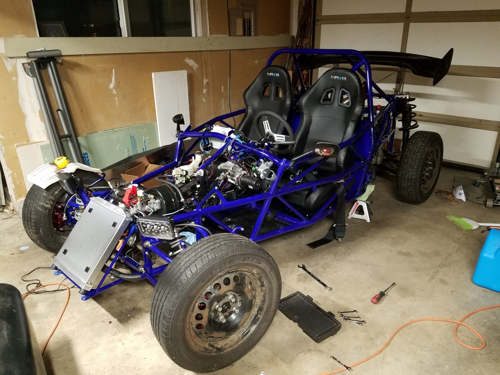

Got mine mostly done. Just need to do ebrake and wire up the button panel... As for cosmetics, i need to have it painted and get new rims and tires. But im trying todo enough to get it registered soon.
D
Ha ha... i want to hurry. I plan to do the hazard lights and horn this weekend. Once i get the ebrake installed, i will schedule.

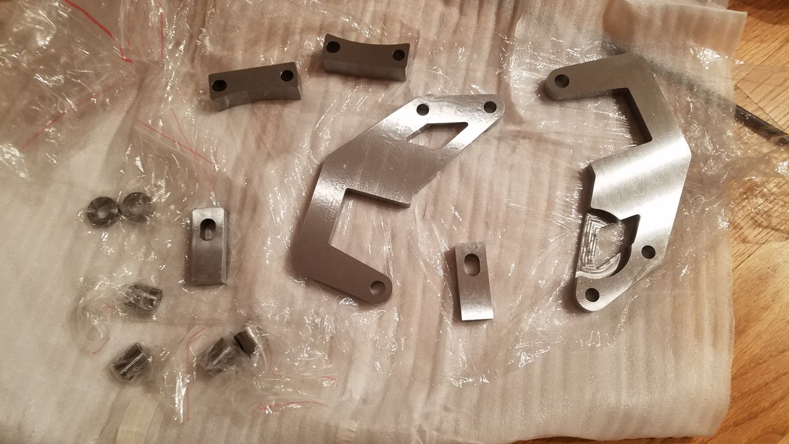

The bracket I designed to mount the ebrake calipers should be getting back to me this week and I will hopefully have the ebrake all done by the end of the week.
D
Registered! Yea boy!!!... Now to test my ebrake brackets sometime this week.
