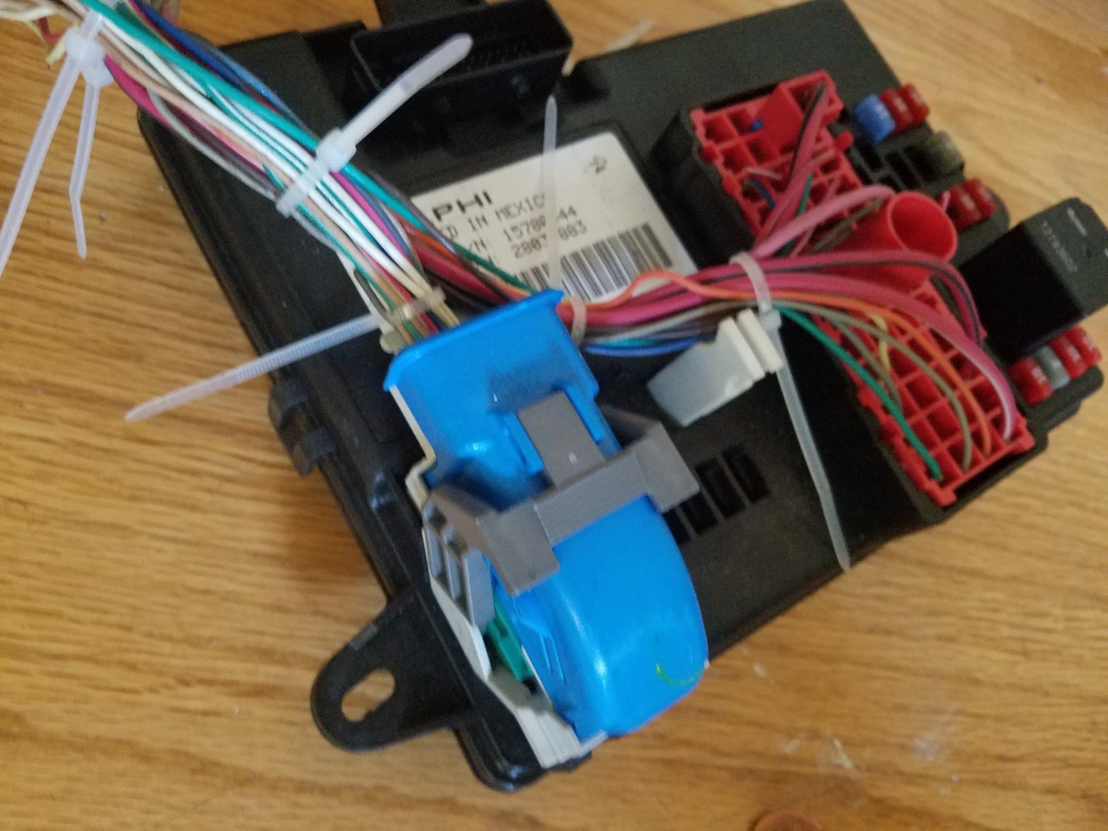

In part 12 of the video at the very beginning, is that ground lug connected to the blue plug? If so, my lug has 4 wires total going to it. One goes into the blue plug, one goes to the cigarette lighter (which I plan to keep), one is free and i think the last one goes to the sub.
I don't recall exactly. My recommendation is to not remove any ground wires unless it's dedicated to a circuit you know you won't use e.g. the accessory plugs--bad example. Any ground wires that go directly from a ground point to the plugs should NOT be removed.

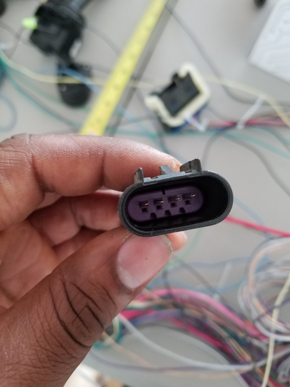

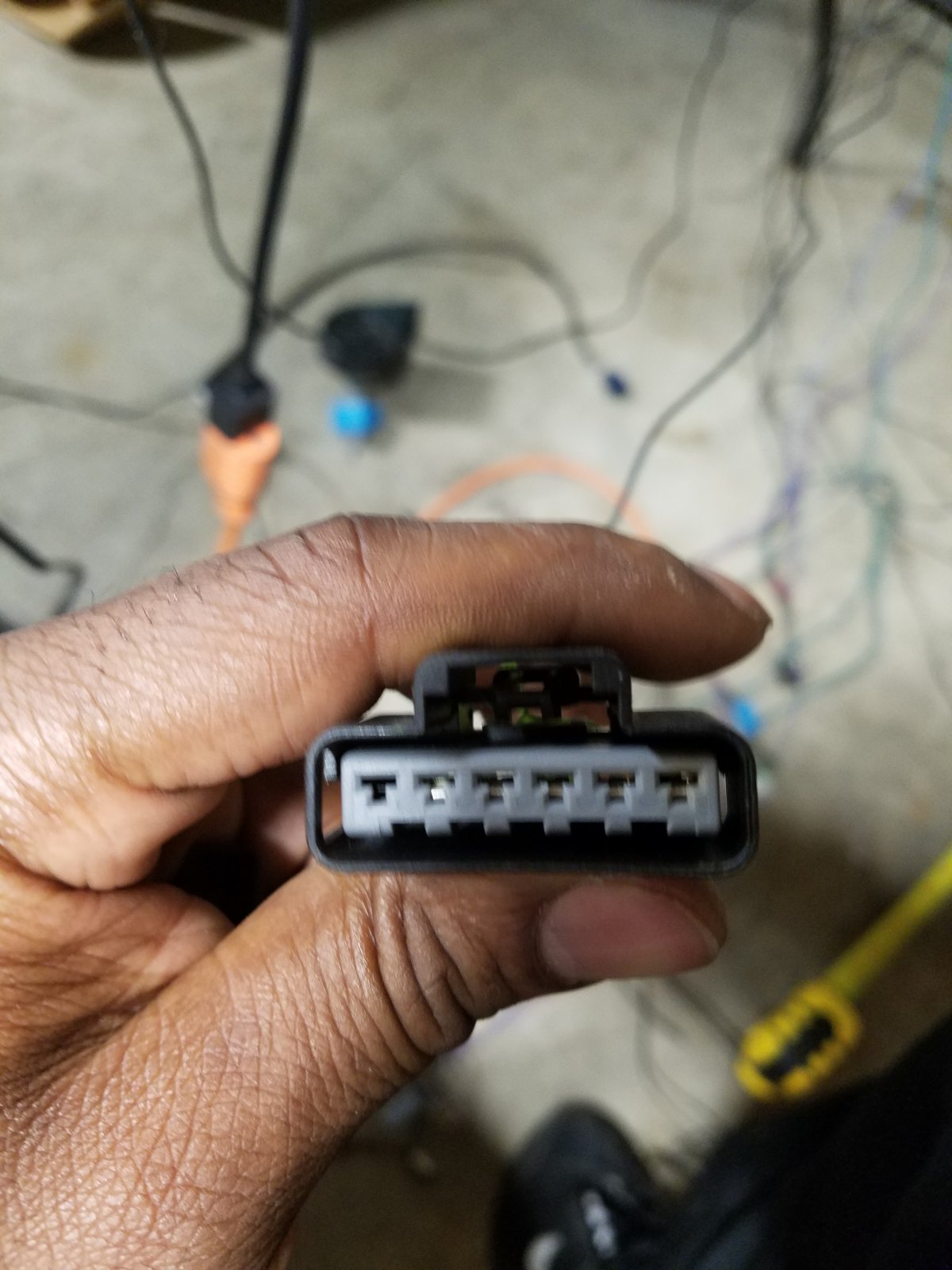

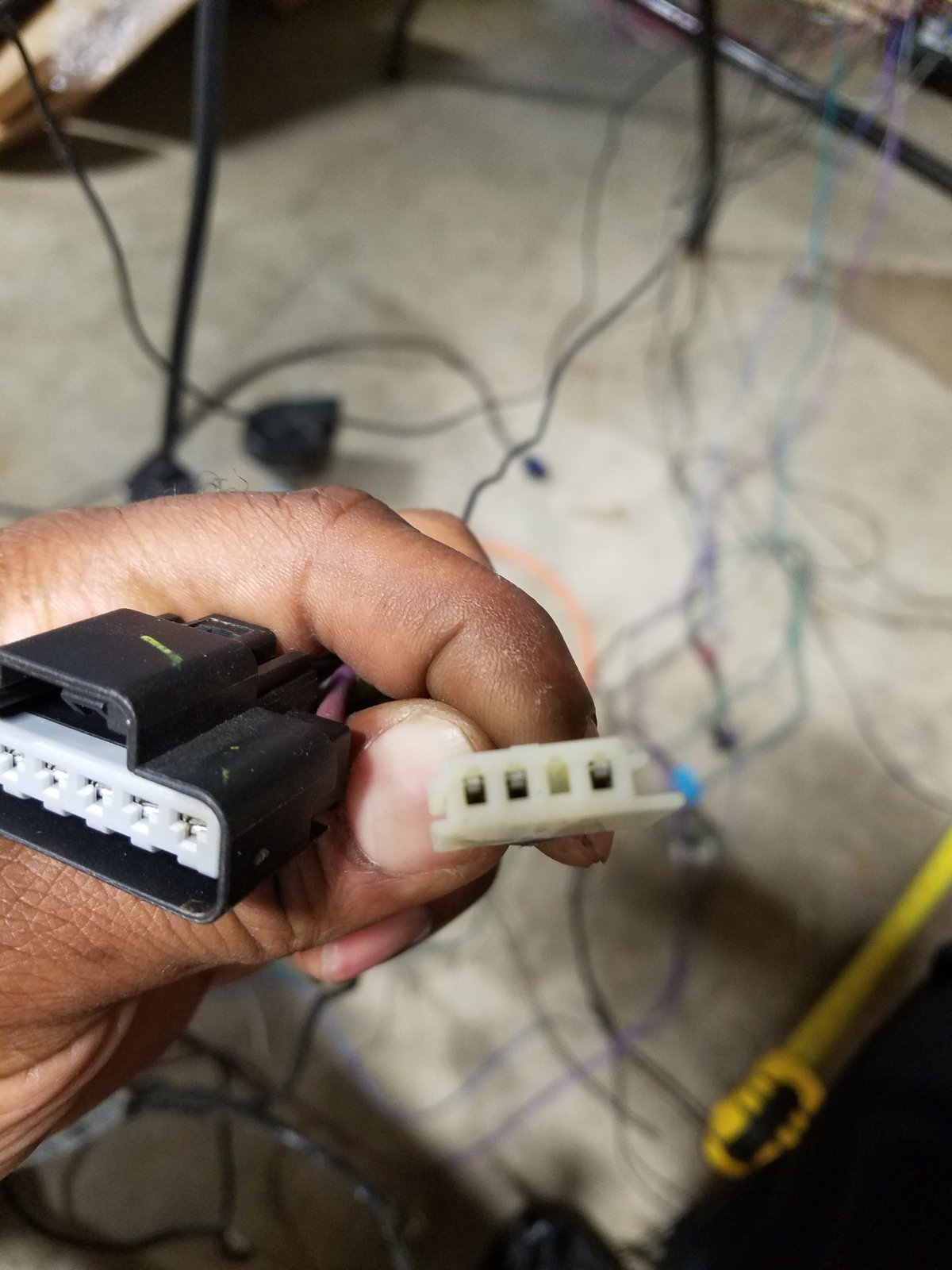

I don't have the engine connector like the one in video 12 @ 5:08 time marker. I think mine is the one posted. Can anyone confirm?
SliderR1
That doesn't look like the engine connector. I think the one you are looking for should have 8 pins. That looks like the MAF plug.

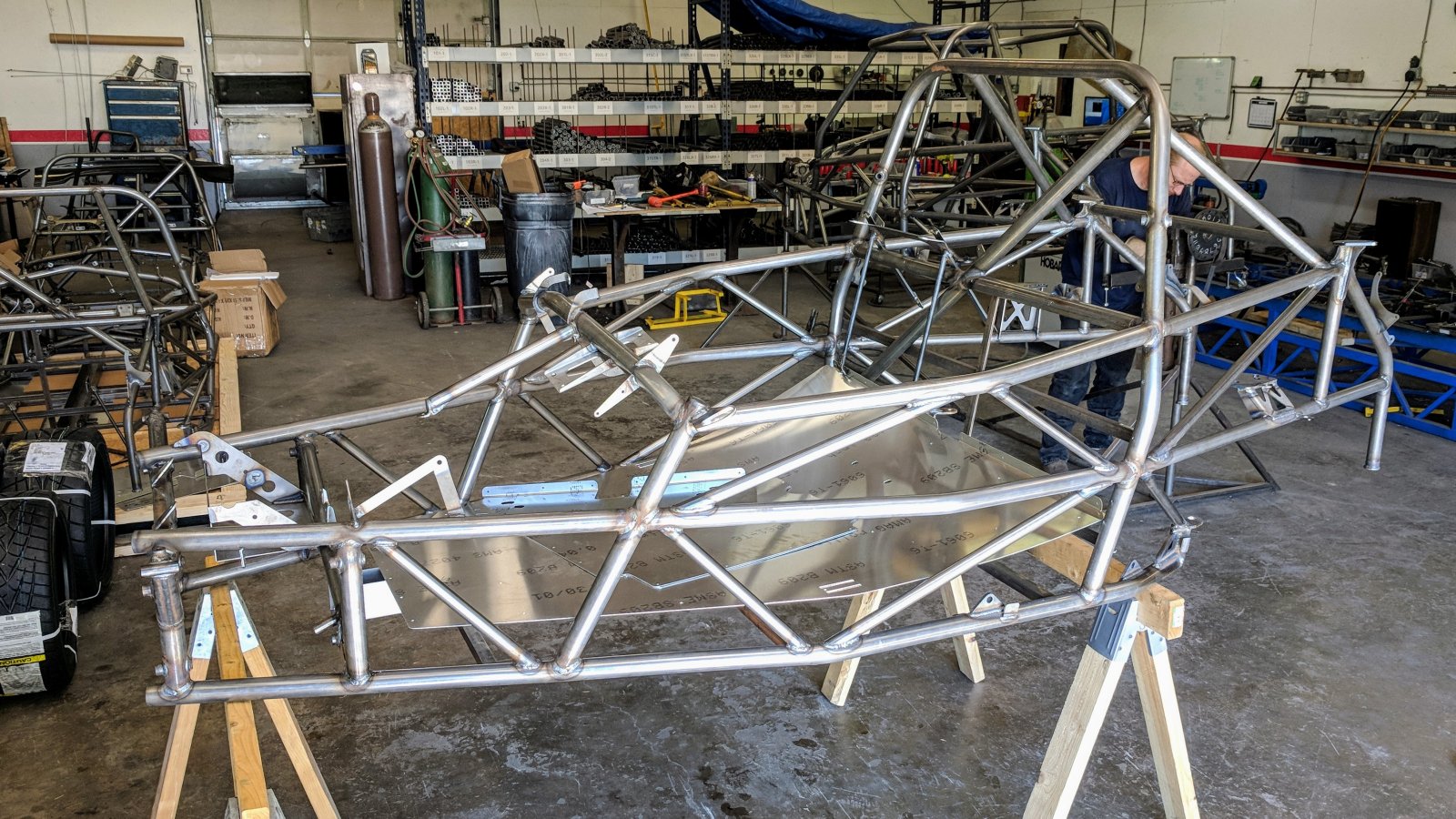

On a side note... My frame finished on 06/22/2018 and is scheduled for pickup from the freight company on 06/29/2018. I decided to go ahead and pay for everything out right in order to save on shipping and just have everything. I still need to finish the wiring harness and cleaning/painting of my donor parts.

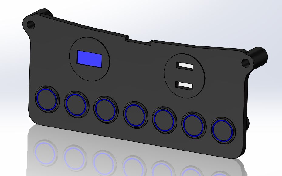

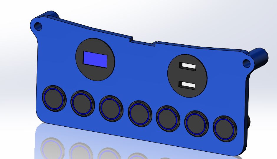

I'm painting my frame blue. I'm debating whether to make my switch panel black or blue. I will have 7 switches, one usb, and one volt meter. Pictures of almost finished product.

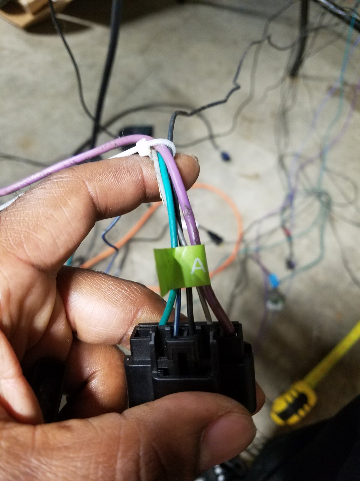

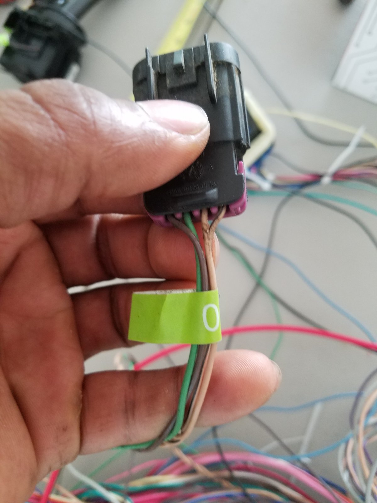

Am i safe to assume this is the headliner plug? If so, do i remove all the wires including the ground and big purple one?
