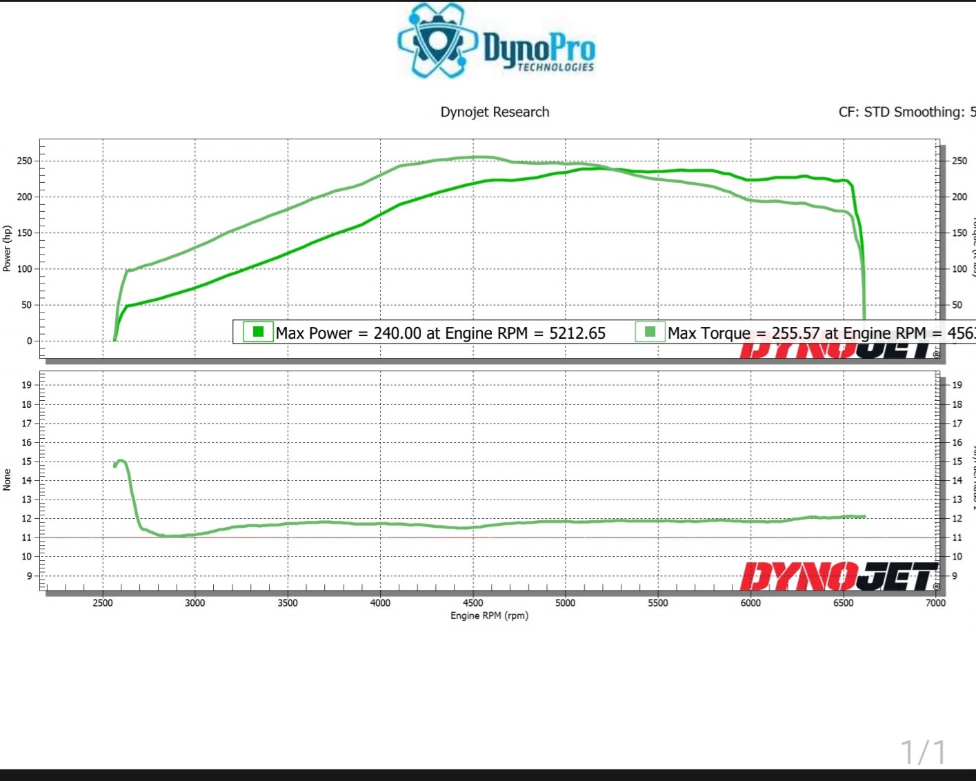

The day has finally come and gone for the tune. I wanted to get your opinions on the numbers. Seems low. I'm guessing it's around 300hp at the crank.
LDK 2.0 (stock)
Z54 turbo
Opel injectors
93 octane
240hp
255 torque

comegetjoe
That does seem low. Graphs look smooth though!
Is your car tuned?
For comparison, my 09 SS/TC cobalt on a stock K04 with an intake, exhaust and a tune made 280hp and over 300tq

Those were after tune numbers. The guy that tuned it said it rips and was impressed. I guess that should mean something from someone who drives every type of car. I haven't gotten to drive it yet.
Unless you have done major “breathing “ work to the engine, 19 psi boost is way low. It’s easy to get 24+ on the k04, although it’s not good for the turbo.
ZZP did a remote tune on my LNF with Z54 turbo. 24-25PSI is considered "reliable" with that turbo and engine combo.
