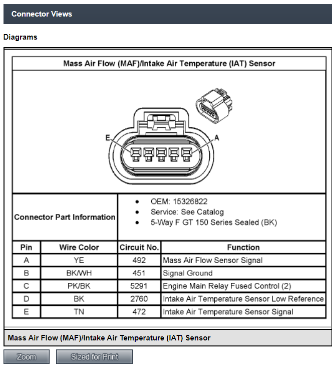

Fixed: The fix was that the MAF plug and Fuel Injector plug were swapped. Apparently this is possible on the LSJ engines.

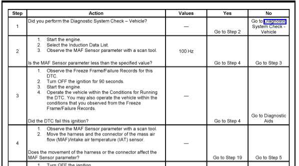

So after taking out the fuse box and cleaning everything of trans fluid and putting it all back together, now the engine won't start. The symptoms it's exhibiting:
-Will fire but run really rough and dies, runs for maybe 3-5 seconds
-Lots of gasoline coming out of tail pipe
-No fault codes
-Plugs seem to all be in place and connected.
-Ran before bringing in for cleaning
-No water used to clean, only rags/towels and acetone on the parts
-Sprayed connectors with electrical parts cleaner. Not on the MAF though!
I'm open to ideas. I'm stumped for the night.....
