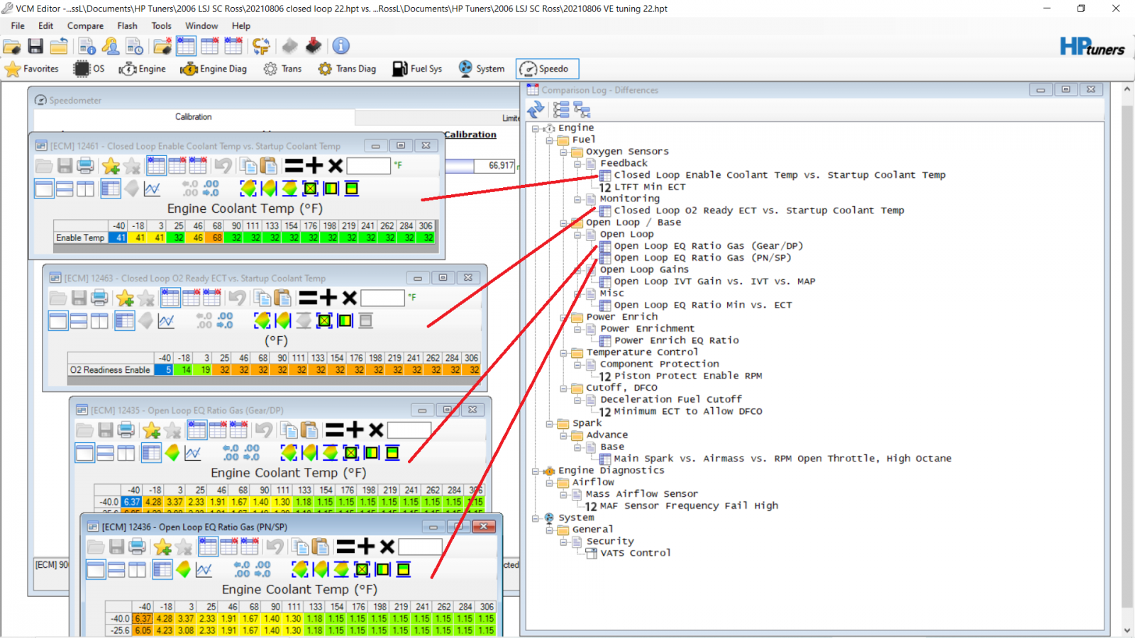

I had this issue too. Poor cold starts when in open loop.
Then I noticed that when putting the car in open loop, I had modified all the choke circuit tables.
So I went back into my open loop tune, and every table that has ECT (Engine Coolant Temp) I put back to stock all the cells colder than 111F.
Then it started great. I wait until the engine is above 130F before I gather tuning data.
Much better.

Check all the tables, as I only show the first 4.
I'll look again, but I don't think I have those tables for my LNF ECM. Hopefully I just missed them. I may try changing some of the low rpm air load tables if I don't find other problems.
Much better.
I don't have access to those tables for the LNF. All I have is spark adjust during cranking which is set to stock.
