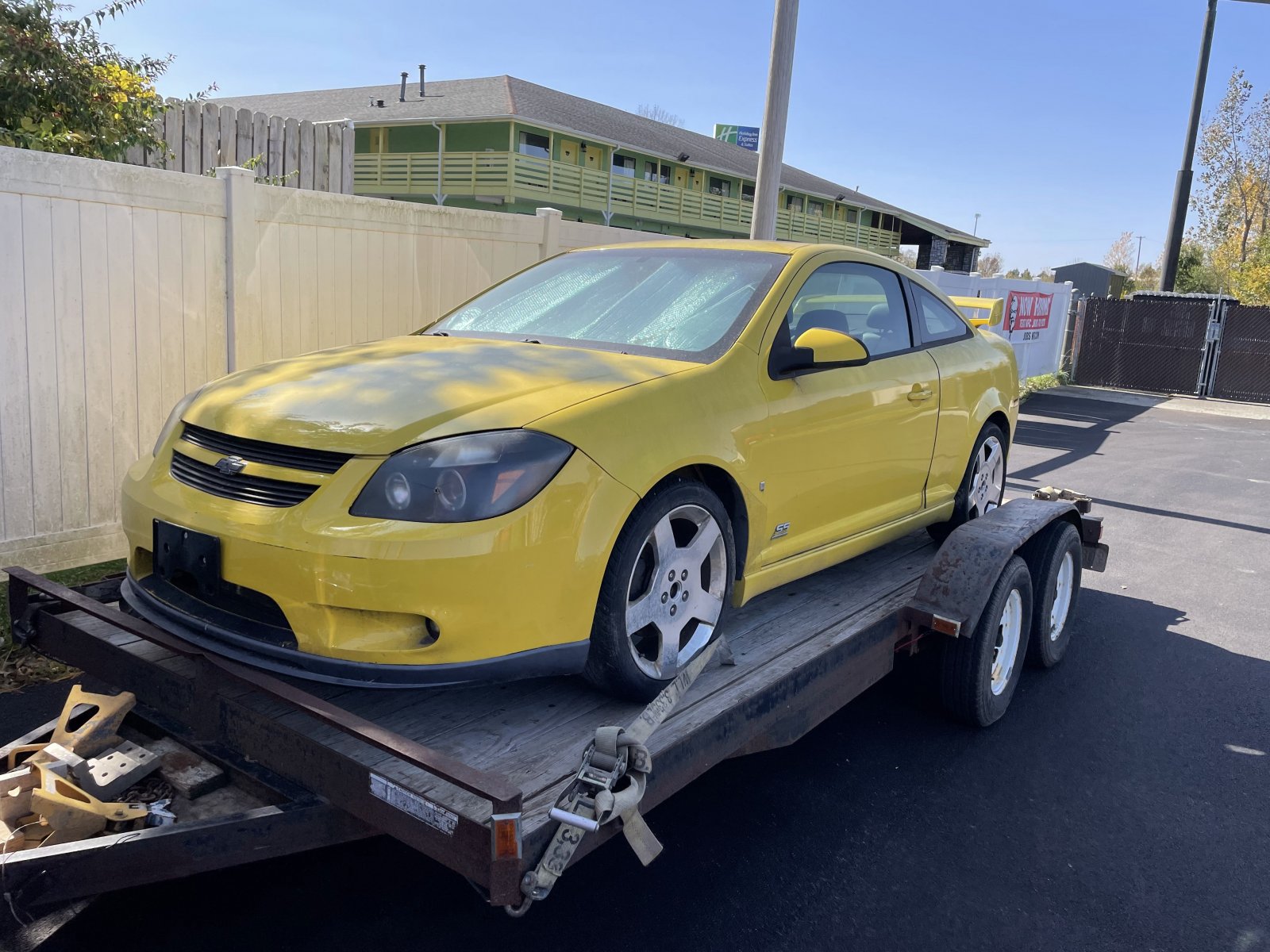

My journey so far. I found an 06 SS/SC on FB Marketplace. That was fun because I refuse to have a FB account so I did all the searching using my wife's account. The car I found had been sitting for a while (license plate was 2019). I was told it did not run and they provided some engine codes. I was also told it needed a clutch. I spent the first weekend chasing wiring and pulling wiring diagrams. Something just did not line up. Finally came across a post on a Cobalt forum about swapping plugs. I have since found similar folks on DF Forum talking about it. I swapped the plugs and it fired right up. I then started researching clutch issues and found good info on the leak that commonly occurs on the nipple that comes through the transmission housing on the clutch pipe. I ordered a new clutch pipe from ZZP and replaced the O-ring. Clutch is now working fine. I had bought a new battery for it and put new wipers on it. I had plans on driving my donor for a bit so I was working on getting it ready for WV state inspection. I actually sourced a headlight from 95Blitz (thanks). The only thing I was lacking was some decent tires. I wasn't ready to invest $500-600 in tires and it was becoming obvious that I wasn’t going to find any pre-owned tires the size I needed. So I drove it some anyway and ended up on the side of the interstate with destroyed front right. Put the donut on and got it home. It's been setting and waiting ever since. I put my order in on Christmas Eve (12/24/22). So I guess it's time to get started. I've watched a few of the videos. I think I'm going to try to get it to a local shop first and get the refrigerant out of it, then pull it in the garage for teardown.
Donor photo day of purchase.

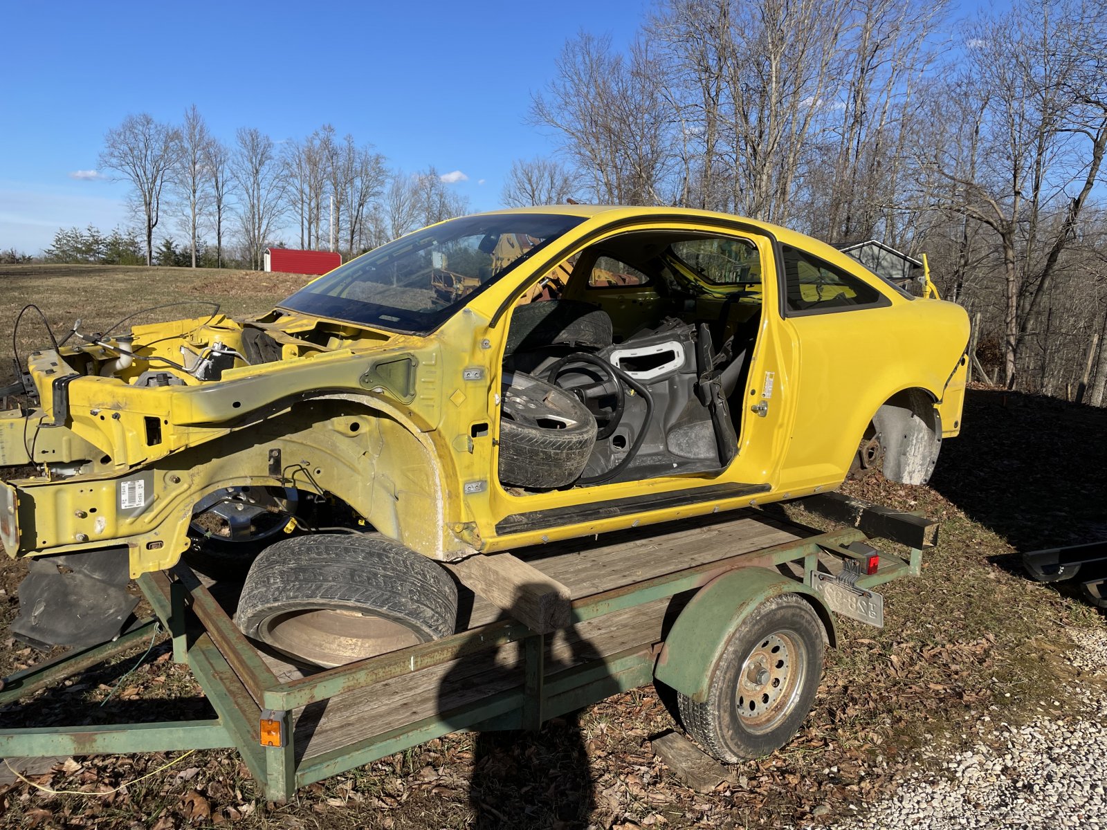

Donor is completely stripped
Had some fun with the fuel lines which may result in having to buy a new fuel pump. Is there a way to replace the connectors?
I also pulled the transmission off yesterday. Plan to mount the engine on a stand a do some cleaning.
Next is to get the donor out of the way so i can do some organizing to free up my table so i can begin on the wiring.

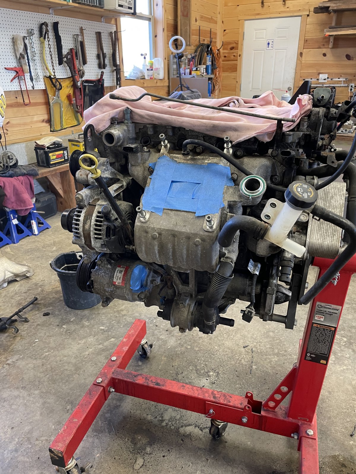

Little update…(need some input below)

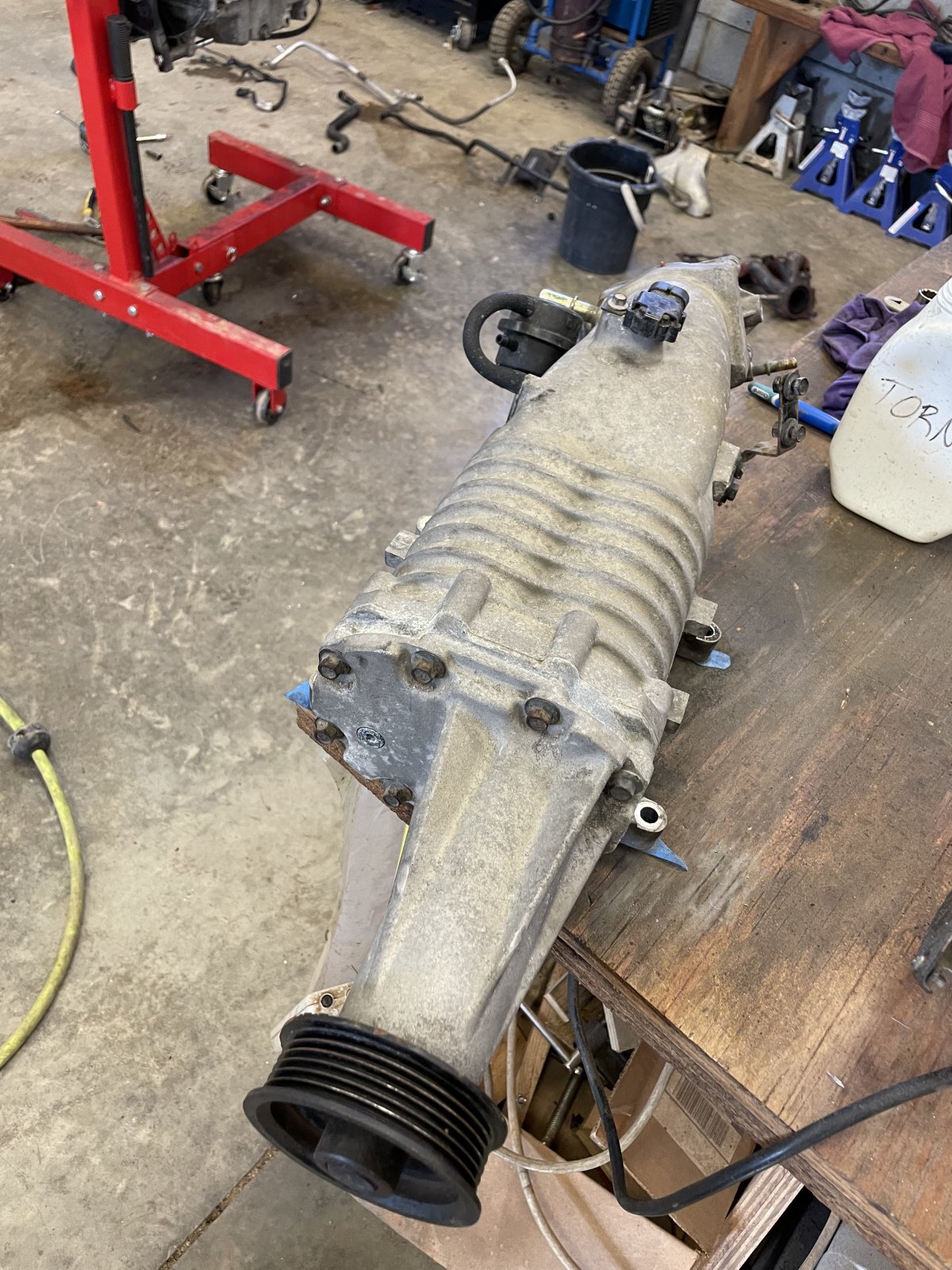

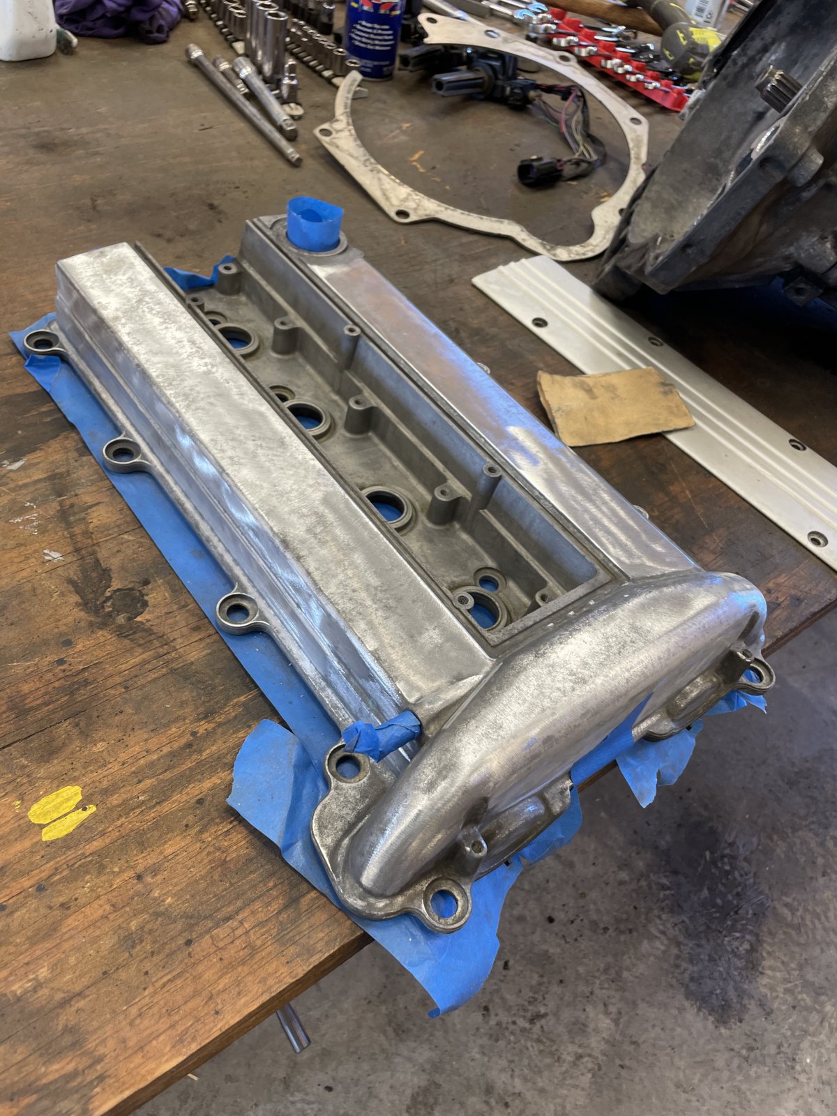

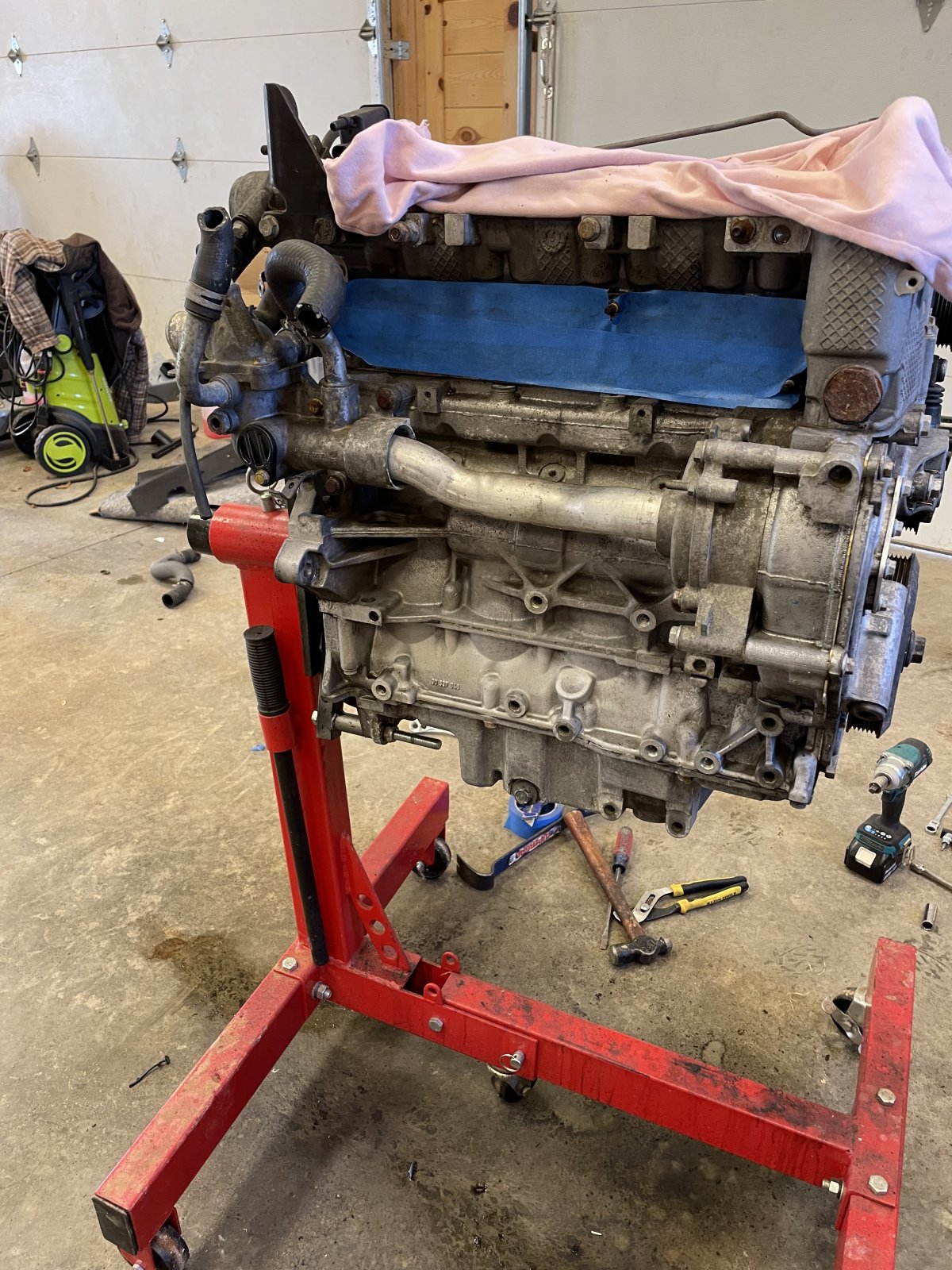

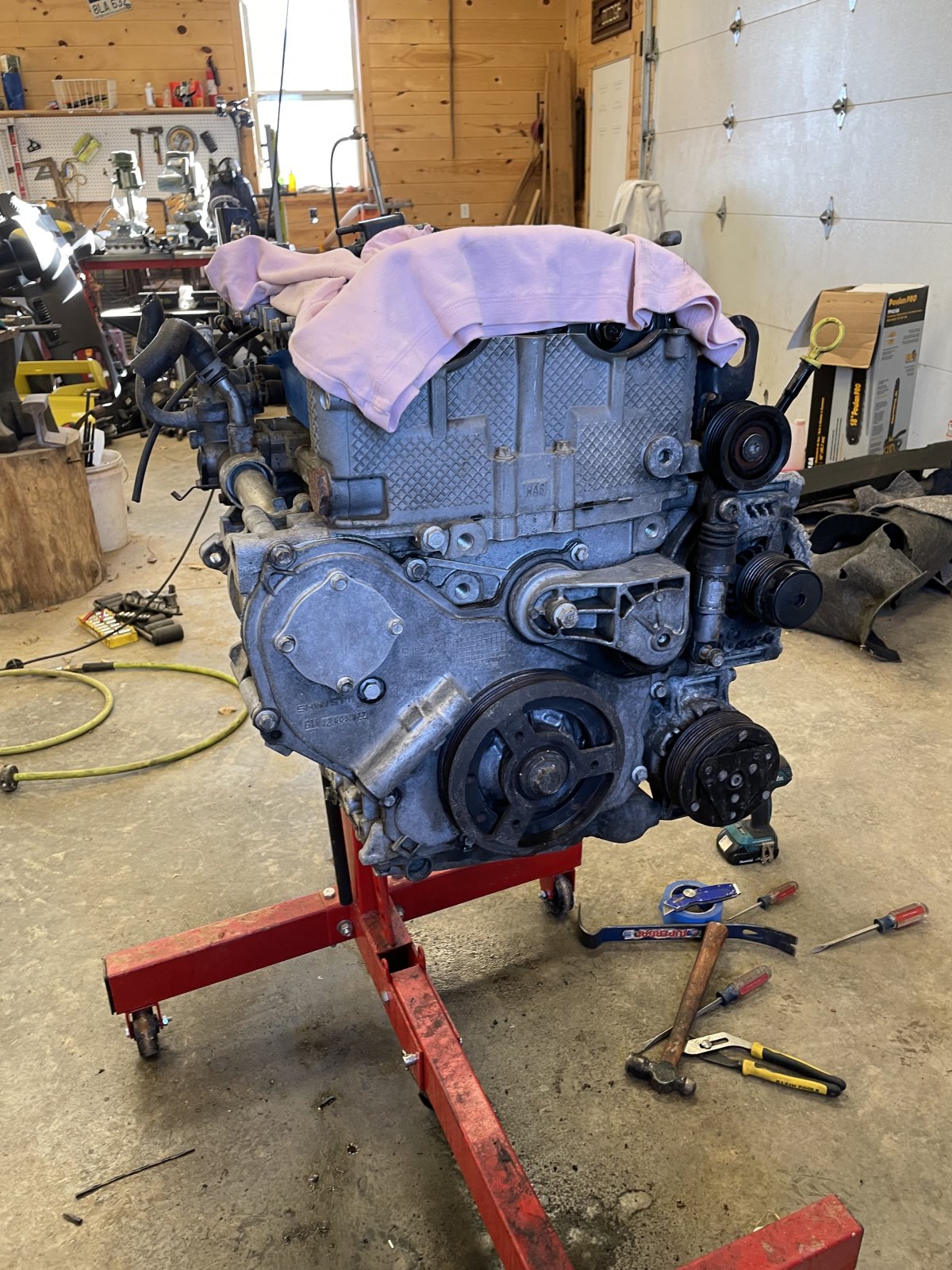

starting to disassemble engine and transmission for some cleaning. Struggling with how far to go. I pulled the valve cover and worked it over, think I’ll probably powder coat it. Pulled the supercharger today too. Don’t think I’m going to powder coat it but might throw some duplicolor engine primer. I ended up having to pull the fuel rail and injectors to get to the Allen head bolt holding the supercharger on. So now I’m debating on changing the injectors. Original plans was to just start with everything stock but I’m this far apart and I wonder if I should upgrade them while I’m here. I know nothing about this but I recall something about 60# injectors if you reduce the pulley size. If I change the injectors now does that hurt me? Will I need to adjust my tune??
other than that I’m trying to decide if I’m going to paint the engine and transmission or just leave it. I’ve seen some rattle can jobs that look good on here, not sure how long that holds up. I’m also not sure I want to go through the effort. The engine seems to be cleaning up pretty good (photos below). I would like to get the dip stick pulled to sand and paint but I’m struggling. Any advice?
Other than that the donor has been moved out of the way. Cleaning parts this weekend but I guess the wiring harness is my next challenge.

I wouldn't change the injectors until you get your project on the road, running and fully debugged. Yes, bigger injectors will require a new engine tune. It is easy to get to the injectors with the engine in the goblin, so it is easy to upgrade later. My 2006 LSJ came with the bright green injectors, which are 32 lb/hour injectors, and using HP Tuners, I was able to see that these injectors are running at 100% capacity in my stock engine. So you have to upgrade the injectors before you can do any performance upgrades.
I would leave any engine upgrades until after you have completed basic maintenance items, and checked the engine for any vacuum leaks, even and good compression ratios, maybe a leak down test.
As far a cleaning the engine, a rattle can paint job did a nice job. You can give it a quick coat of paint now, and worry about all the nooks and crannies later, as you do maintenance in the future. I left my engine unpainted for the first year... got around to painting it later... basic maintenance is more important.
It ran when you pulled it. like ross said, put it in the goblin as is and modify later. It doesn’t take much to do the pulley and injectors in the car.
