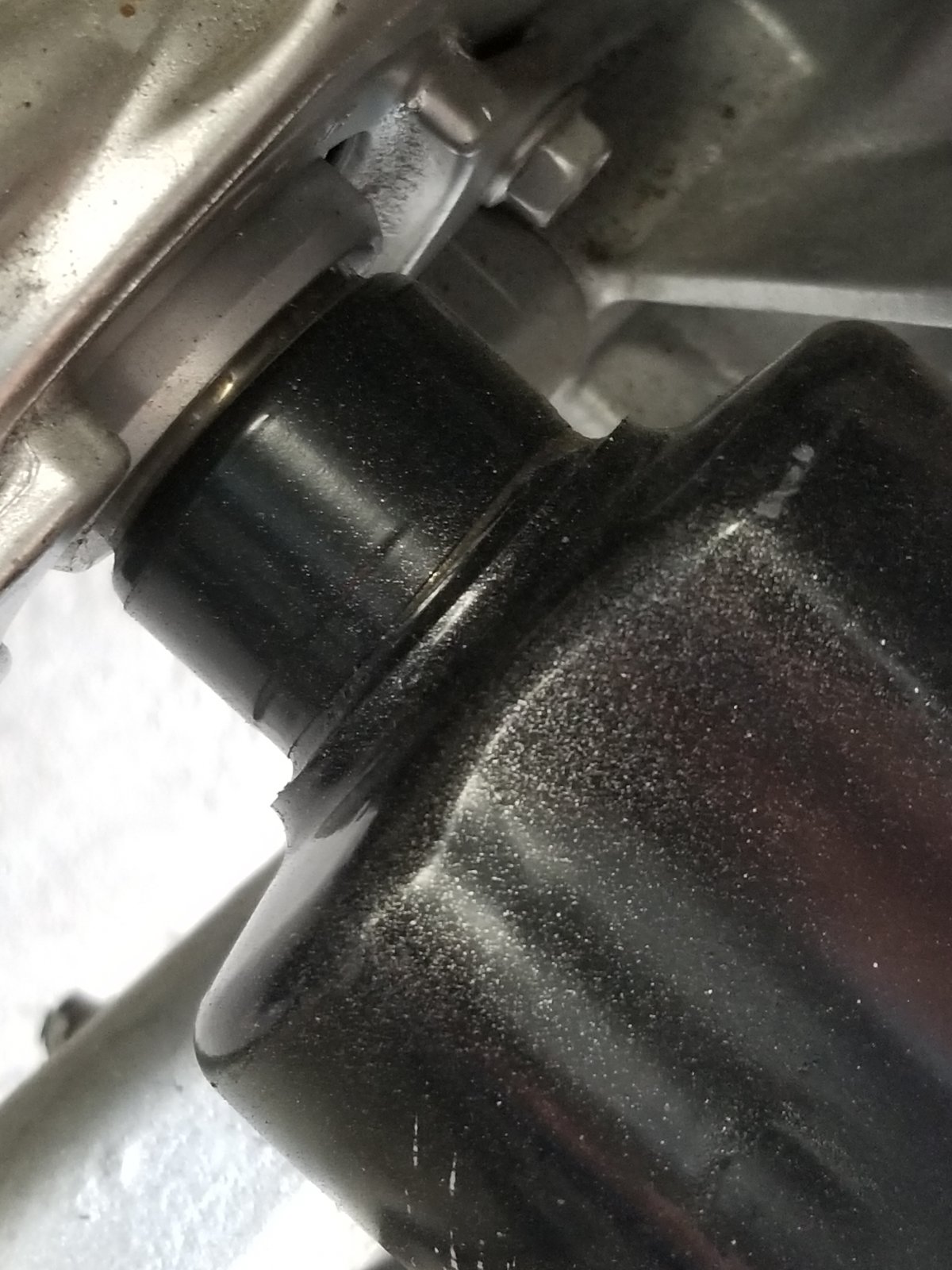

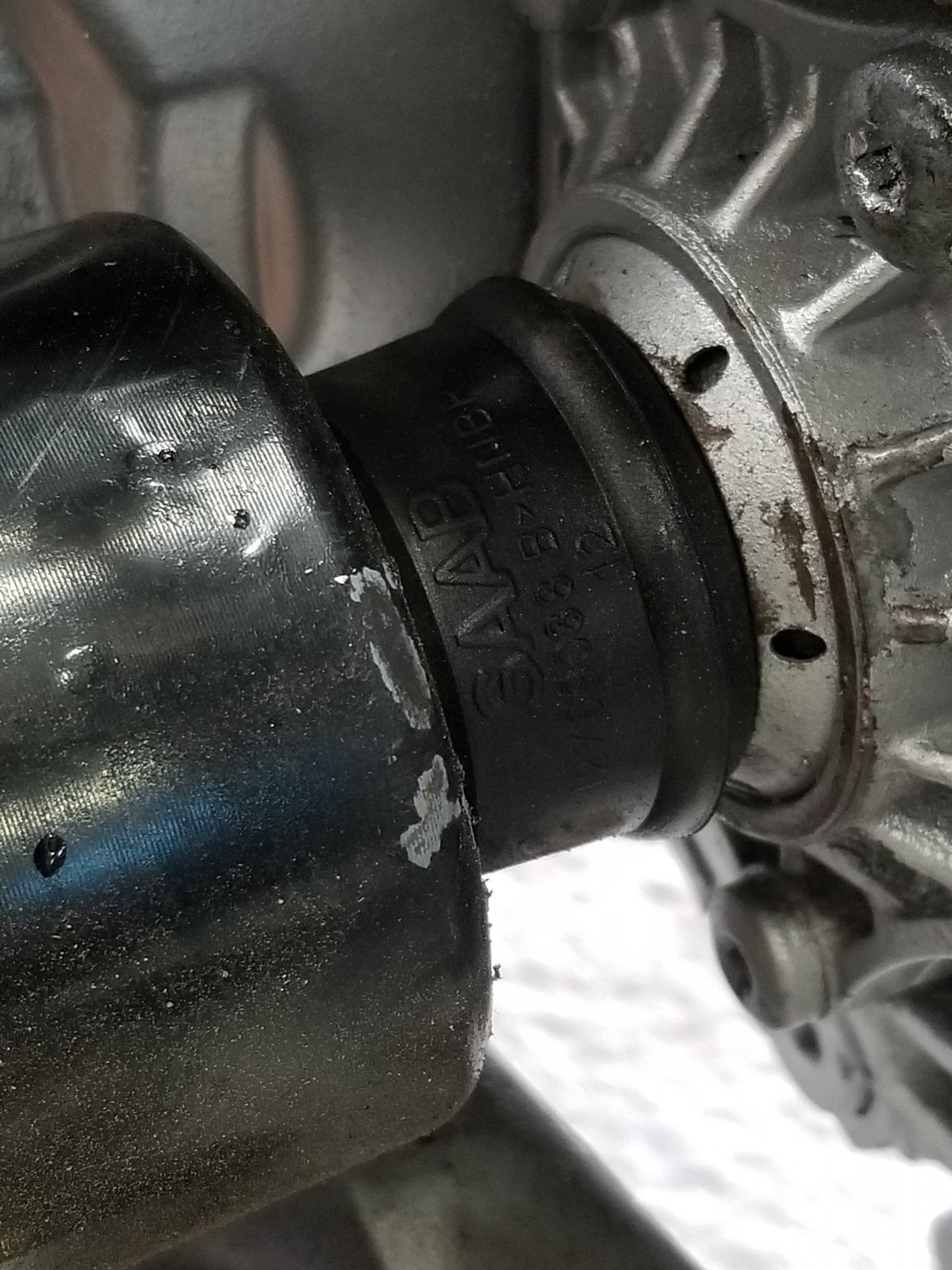

Take a picture of your axles where they go into the transmission.
Oldchevyguy
The rubber seal on the driver side axle is keeping it from going in all of the way. That seal goes on the passenger side.
