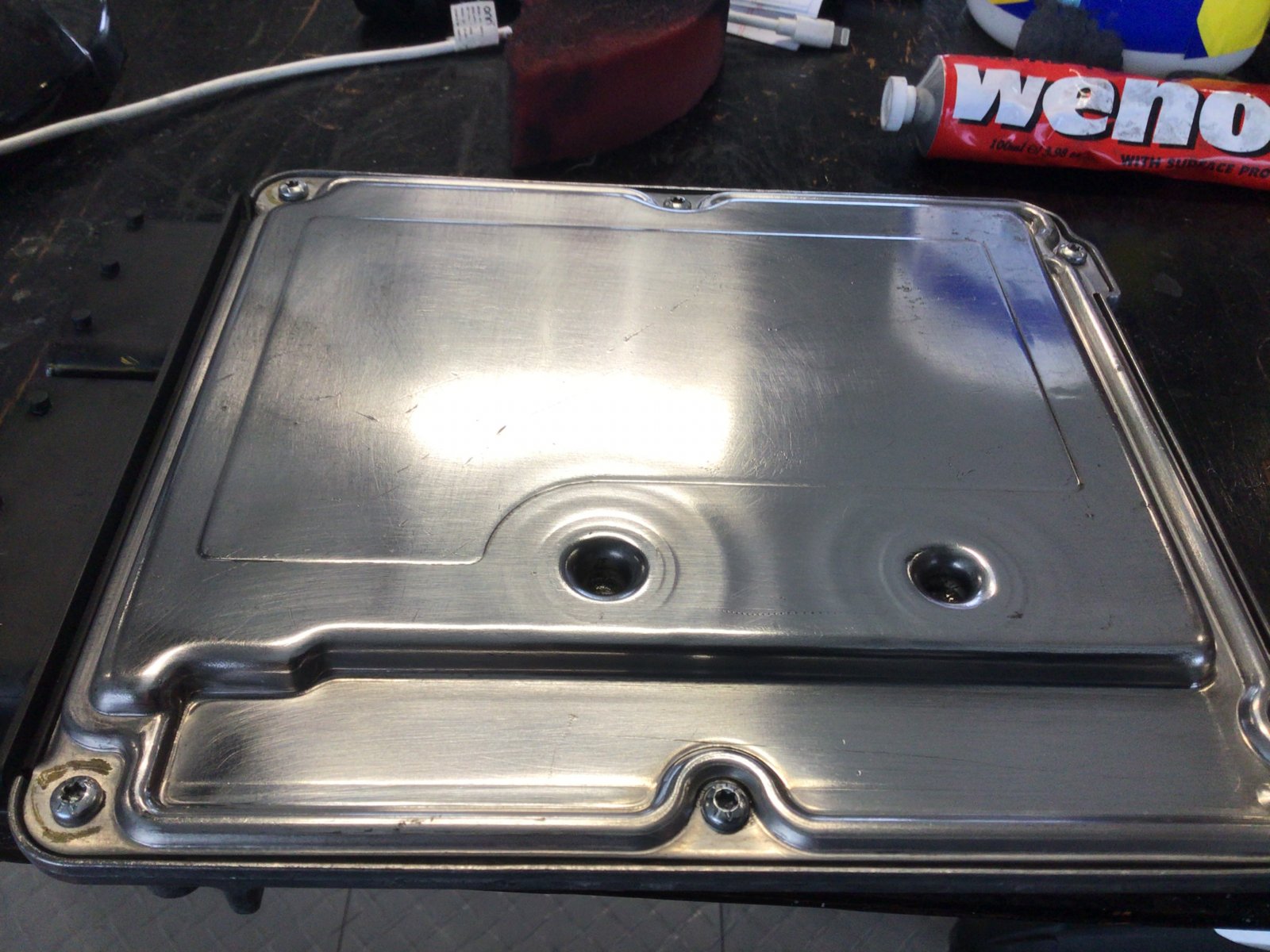

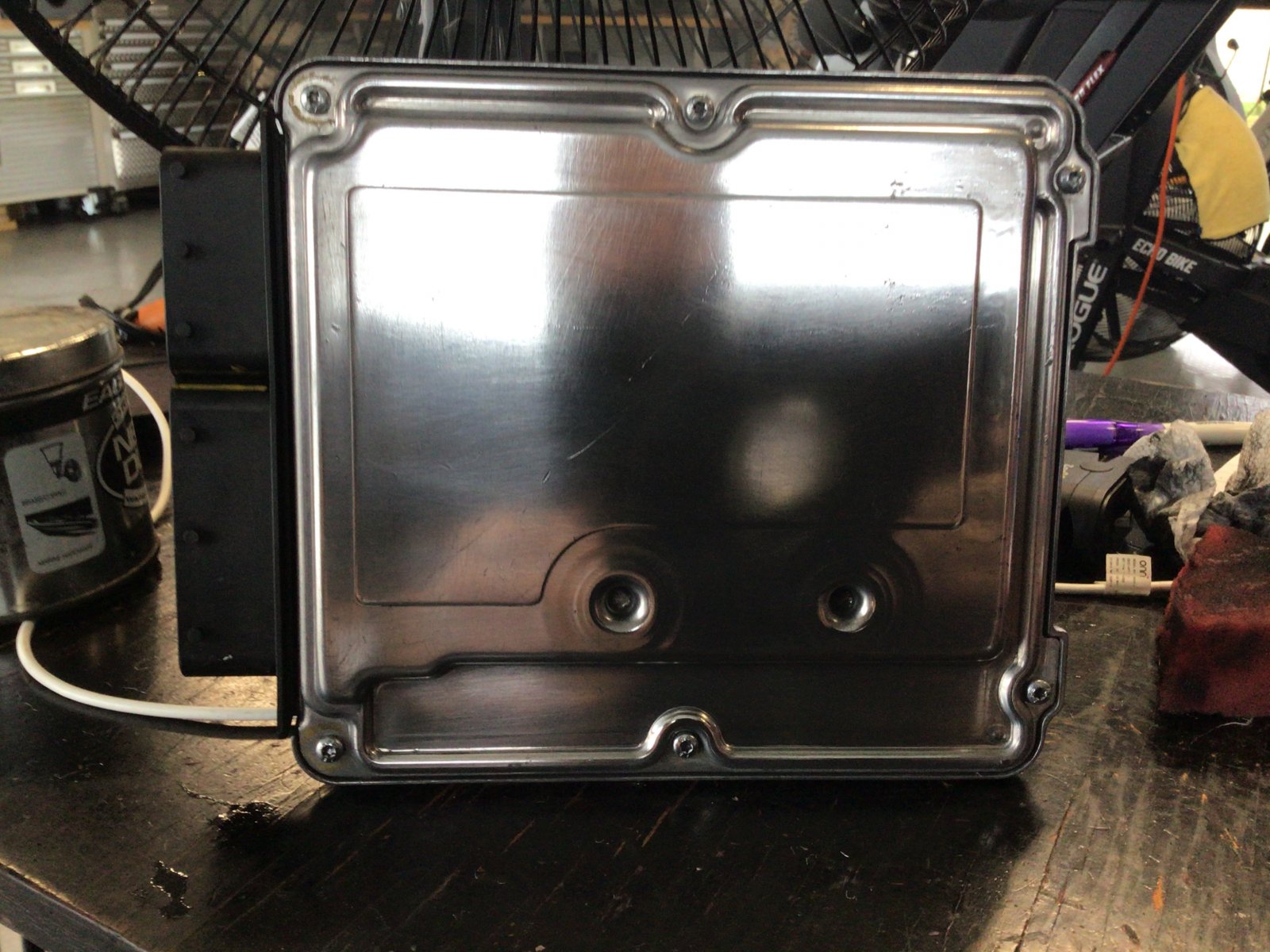

Received my used PCM today , but of course I had to polish it up before I could install.
Now the speedometer cluster shows locked ,
So now I am doing the key relearn LONNY describes.
Now the speedometer cluster shows locked , So my next question is how do I get key to work do I have to do a relearn setup.
Most likely, yes. Do you know how to do it? It's all over the place if you search for it.
