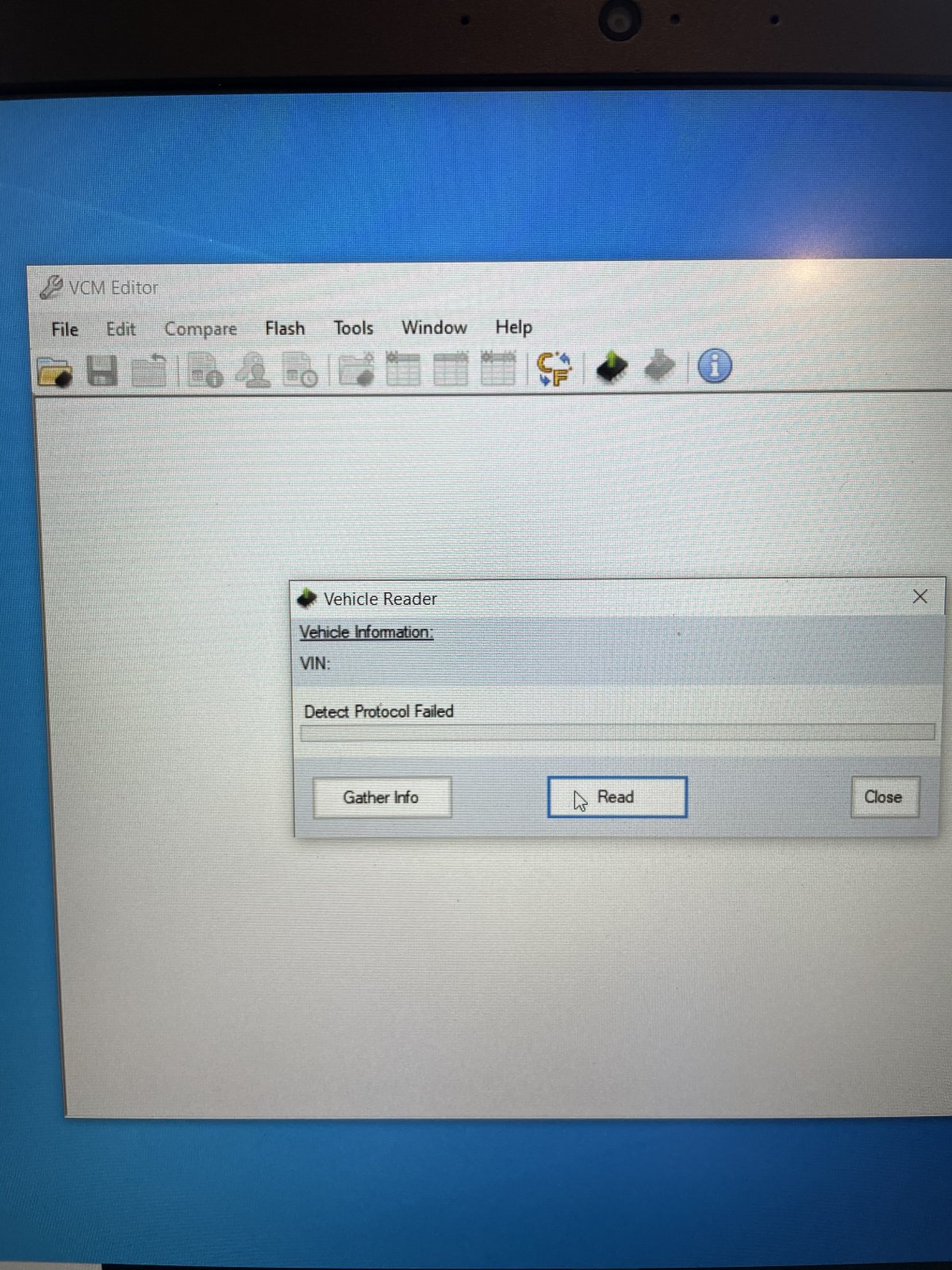

Hey ZoomZoom, reviving this thread because I’m having issues with HPT connecting to my PCM. Was this the error you were getting on the old PCM?
I had everything connected, key in the run position (turn anymore and the starter tries to go) and was still getting this error. Battery had just came off the charger over night and showed a full charge so trying to figure out what the issue is. My data wires should be good since I’m getting all the lights on the dash, fuel pump primes, and I can blip the starter (don’t have the clutch connected yet).

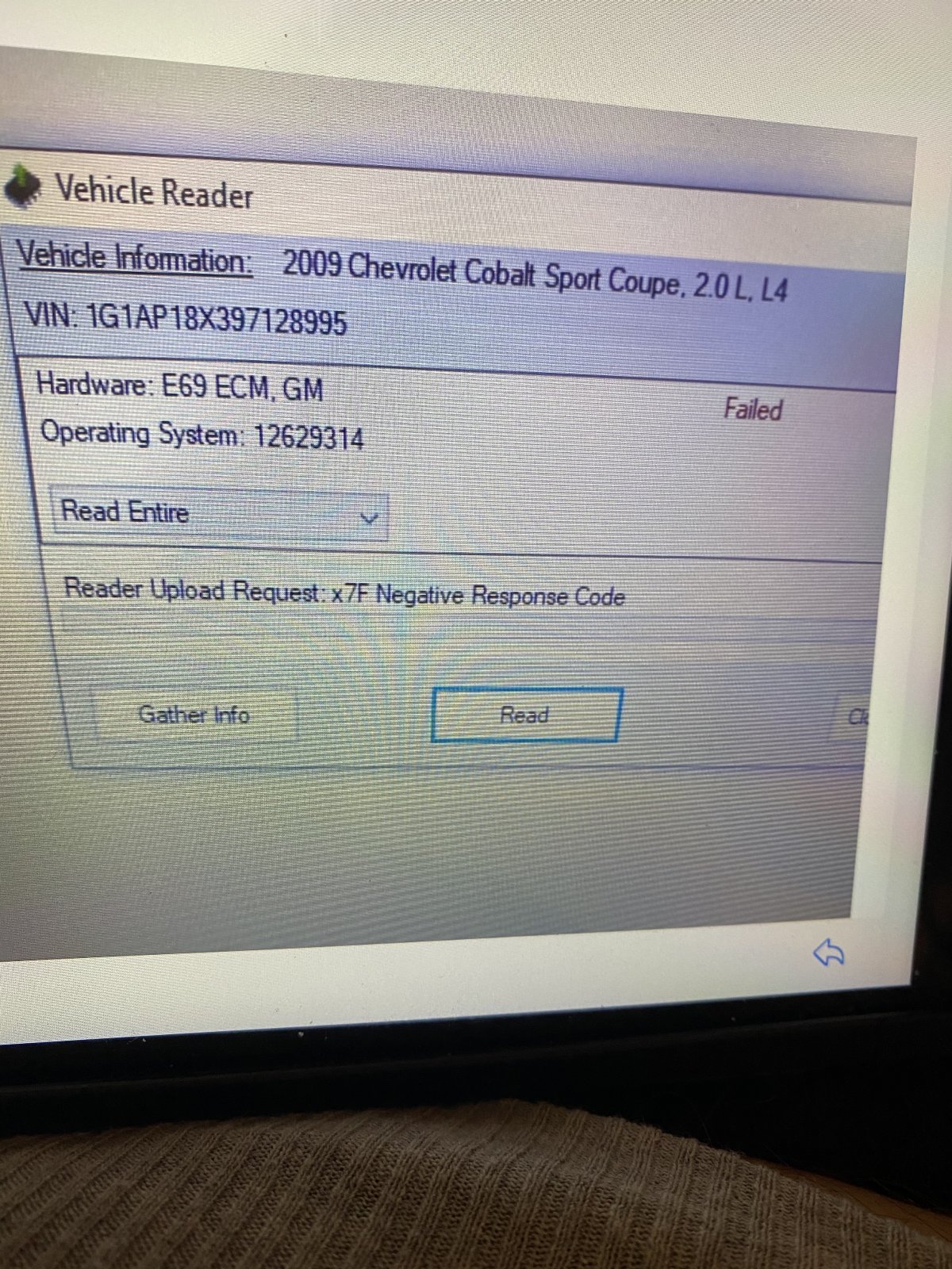

No mine would read the vin. Information
Re: X7F Negative Response Code is what it would show. If it’s conn it should show the vin # at least

I have OBDLink and I didn’t even think to try that when I had everything connected up. It worked before I tore the donor apart as I pulled some codes with it. Dropped the chassis at the fabricators today so I might need to get creative with some steel plate for grounds and connect everything up again.

Before you mess with HPT or anything else, hook up a generic scanner and see if you are getting good bus data and a handshake. Anything else on the CAN (Aeroforce gauges, ect) may corrupt it. I plan to talk to Cory at AIM tomorrow but my experience with hooking up to the bus has been very coincidental and intermittent...Sometimes it works, sometimes it doesn’t... seriously senseless.
The most very basic thing you can do is multimeter the beige and beige with black stripe wires and ensure you are reading 60 ohms to ensure proper termination. From there, if any basic scanner is not interrogating the bus, then ensure nothing else is on the bus that may be interfering. Keep trying.
R
I don’t have any other gauges connected to the OBD. Did even have the factory boost gauge plugged in at the time. Was really just trying to check that I got dash lights, fuel pump tried to pick up, and that the starter would try to start. Figured if it’d do that, then my harness was good including data wires, but guess I was wrong haha. When I get some free time over the next week, I’ll have to reconnect everything and see what OBDLink reads, if anything, and then try HPT again if OBDLink works.

Well anyone who comes to this thread seeing what a locked PCM looks like, my error is NOT related. OBDLink adapter couldn’t connect to the vehicle, but it does have power so I definitely have a wiring issue >.<

I have the same "x7f negative response code" reading the PCM with hptuners. It can read the VIN. HPtuners said it doesnt have a locked tune, he thought it was electrical connection issue. But I swapped PCM with my Solstice and I can read that PCM in the kit car and still cant read it in the Solstice. Sounds like I might need to get a new PCM too, I'm thinking it's locked but not by HPtuners.
