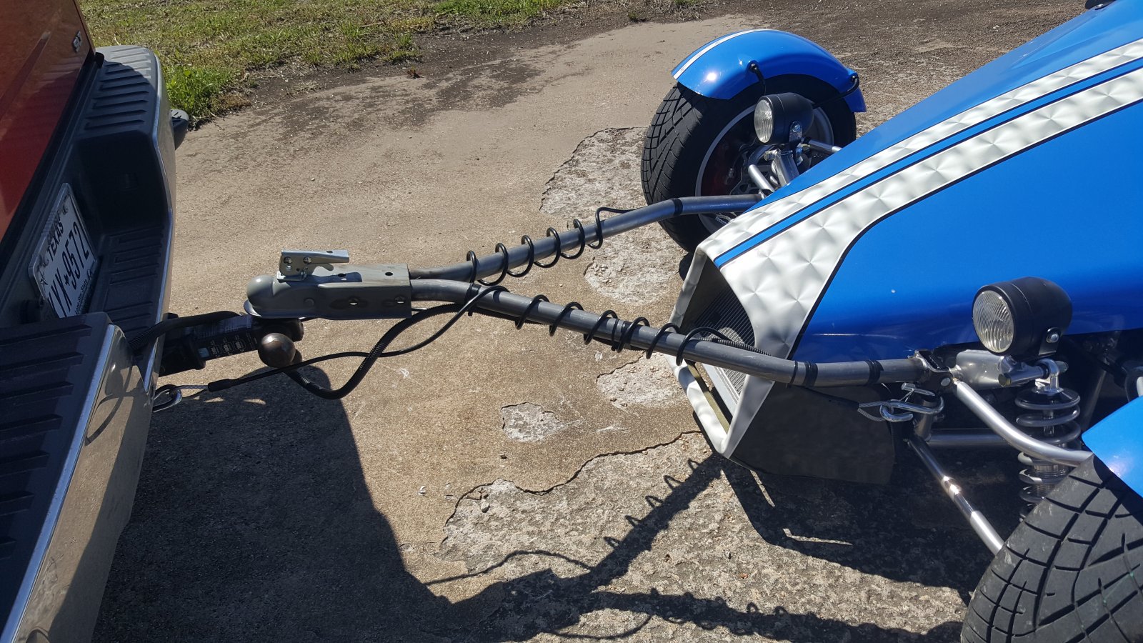

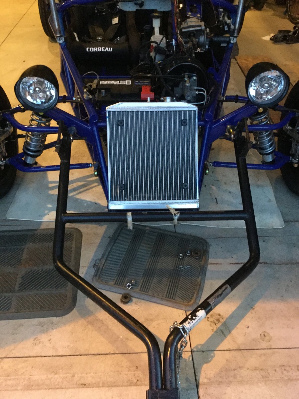

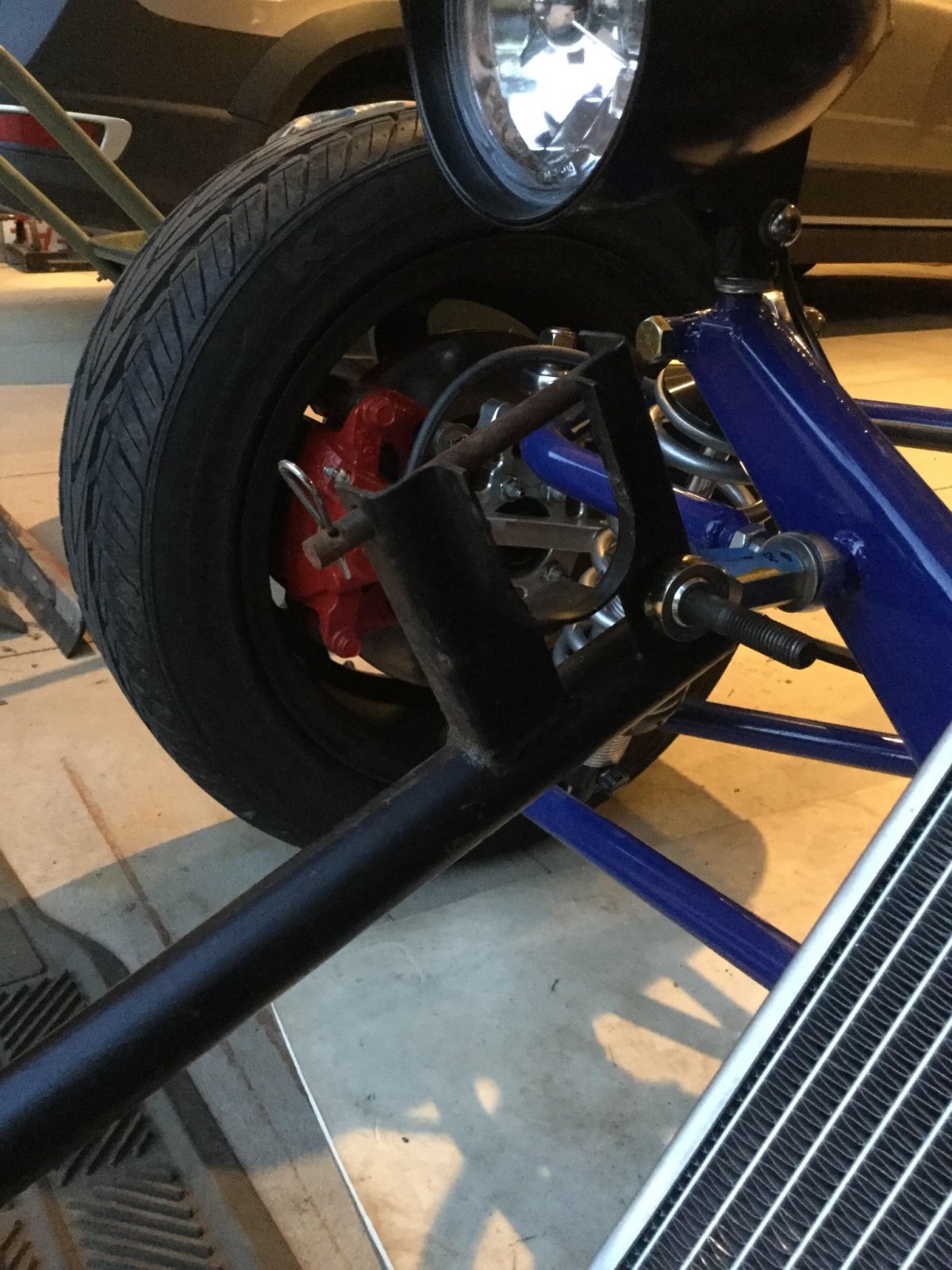

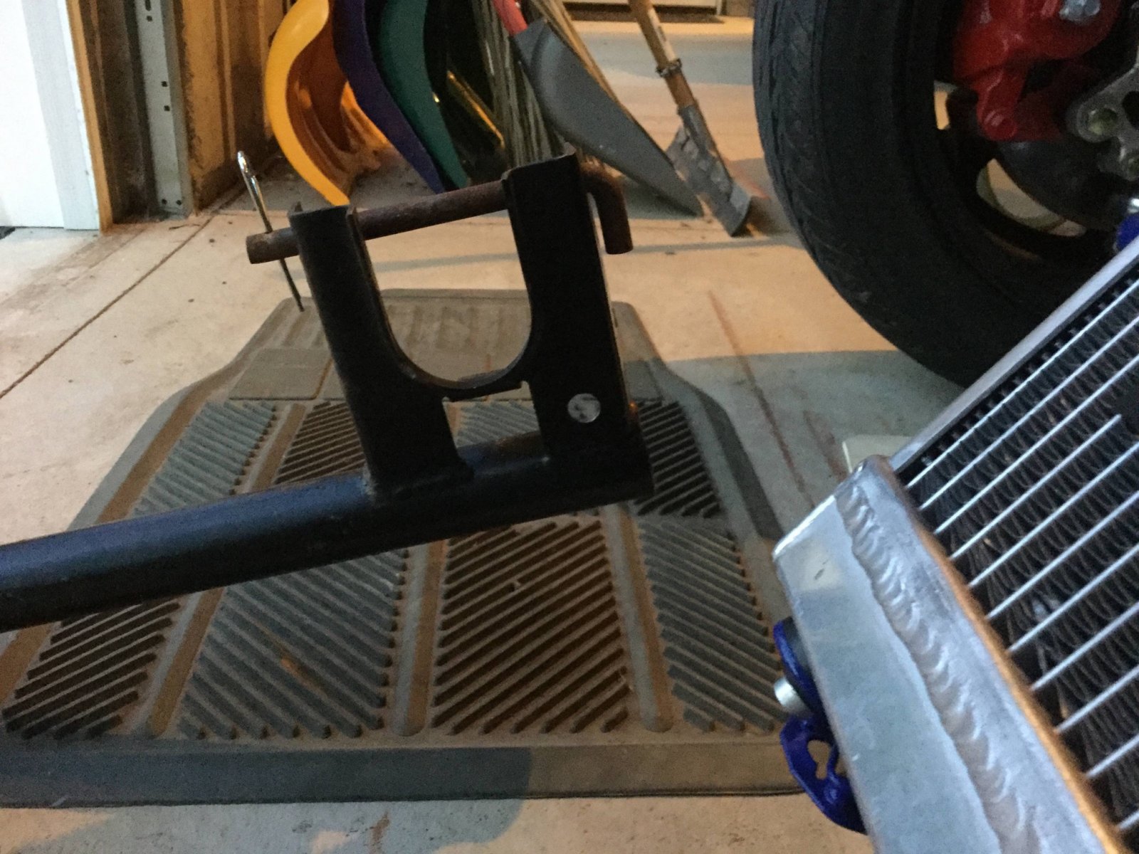

We received the tow bar brackets from the laser cutters and welded out one to test. Now we are waiting for hitches to come in so we can weld out several units to take to powder coating.
The tow bar kit comes with a pigtail that you will permanently hook to the brown, yellow and green wires on the big red BCM plug and also a wire to ground to your frame. The pigtail will be accessable near the drivers side lower control arm.
The tow bar has a wire with a four pin trailer plug on each end. When in use one end plugs into the tow vehicle the other end plugs into the pigtail that was installed in your goblin.

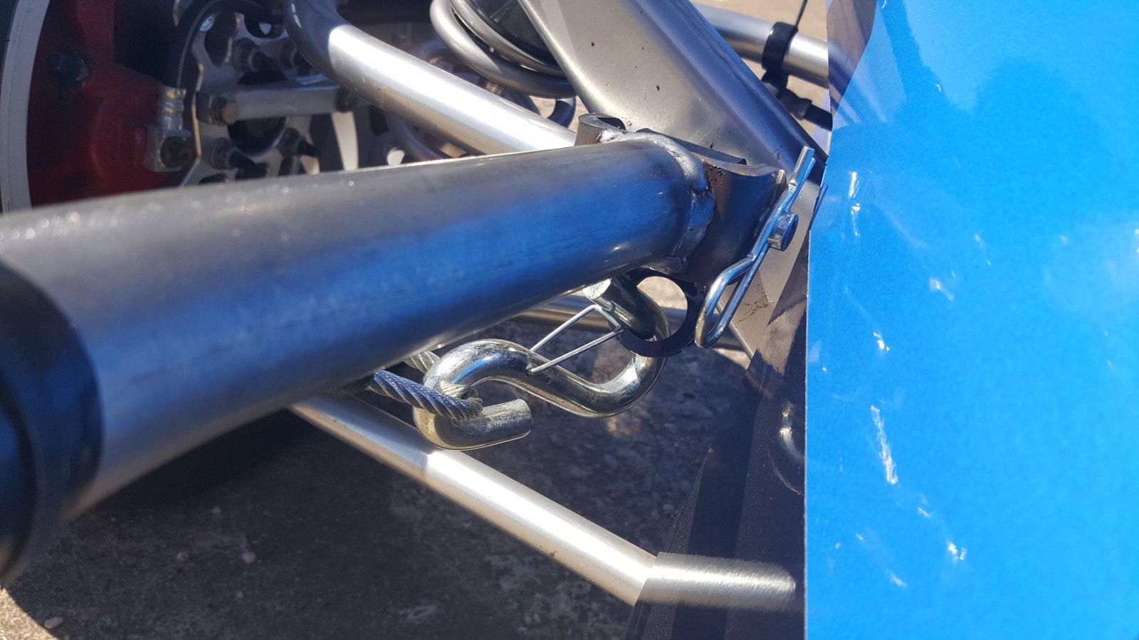

There are loops for safety cables but we are not going to include safety cables with the tow bar kits.
