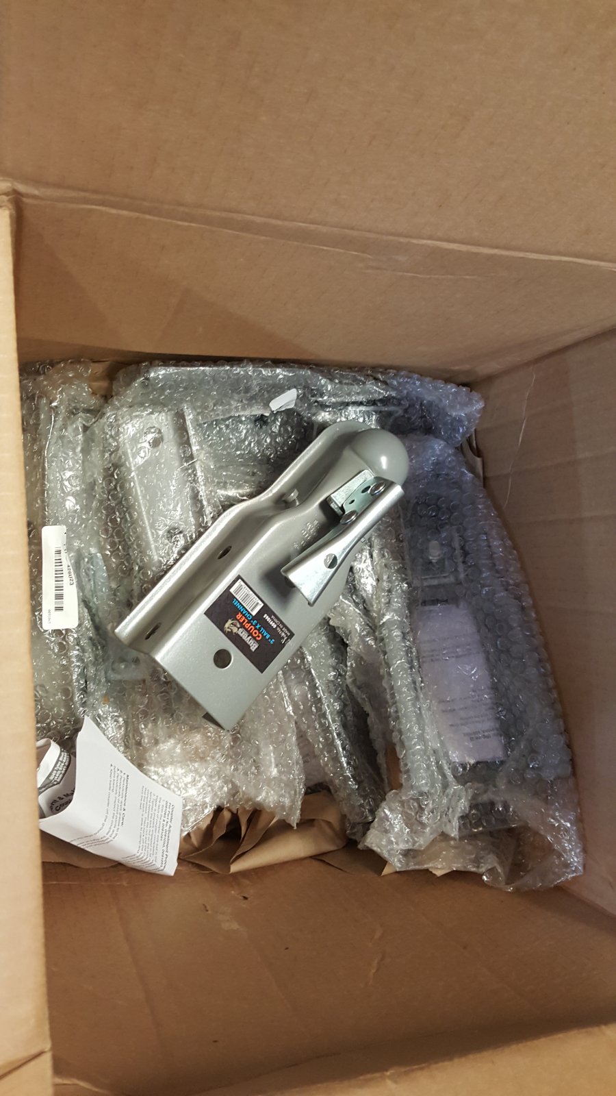

We received the tow bar brackets from the laser cutters and welded out one to test. Now we are waiting for hitches to come in so we can weld out several units to take to powder coating.

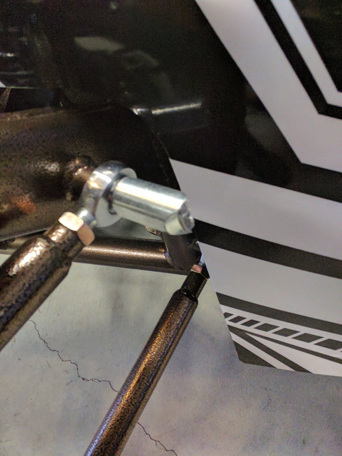

Well. That did not go well. Luckily my truck and the goblin didn't even get scratched. I'd say I had went about 3/4 mile. Was towards my home and it snapped off...
Is the quality of the ones I purchased just no good?
Back to the drawing board?

Yeah man. I don't even understand. I mean had I been going down a road quicker....could have hit a car etc. Luckily I was going slow and it basically just ran into the wheel of the goblin/bar at very low speed.

Looks like that was made from aluminum?
The issue with heim joints is the "outer eye" holding the ball, is the weak link.
I dont know if I'd even use a steel heim joint for towing the Goblin.

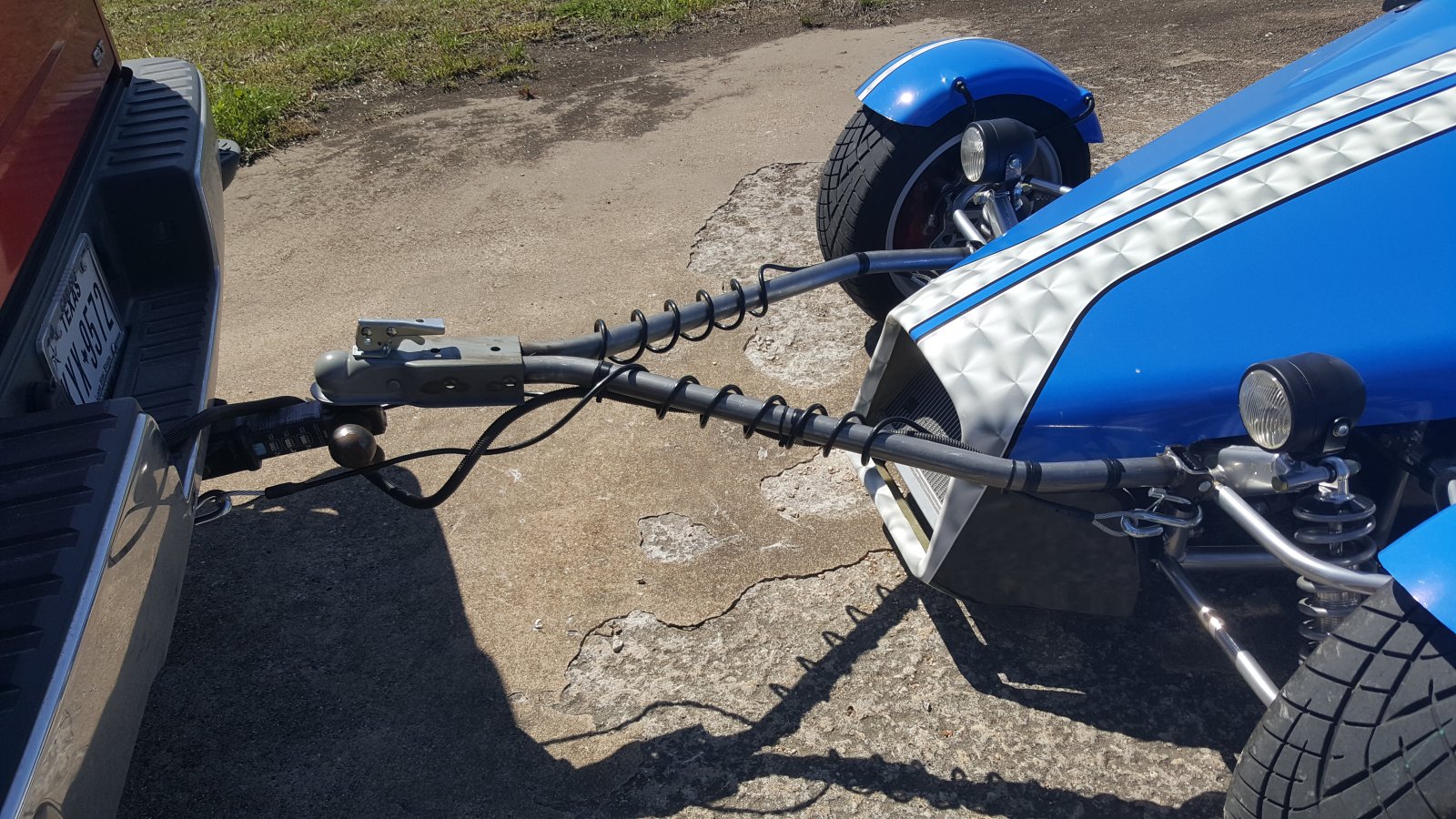

We just received our hitches for tow bars and have started fabrication.
I tested this one when we had the meetup in Arkansas.

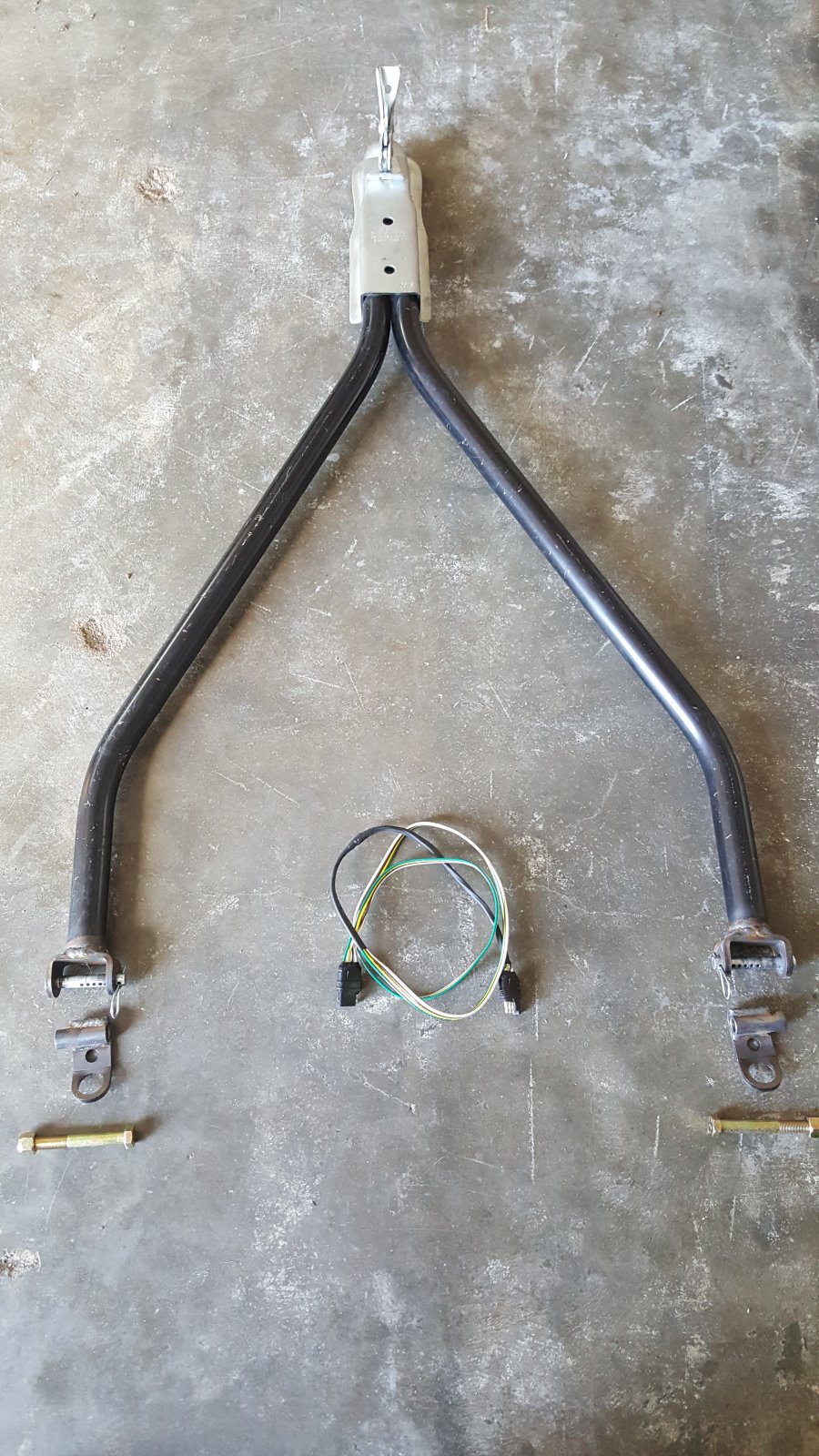

The kit comes with a two inch tow bar, a left and right bracket, two clevis pins with clips, a five foot extension cord, a pig tail that gets attached to your BCM, and longer upper control arm bolts.
The tow bar and brackets are powder coated.

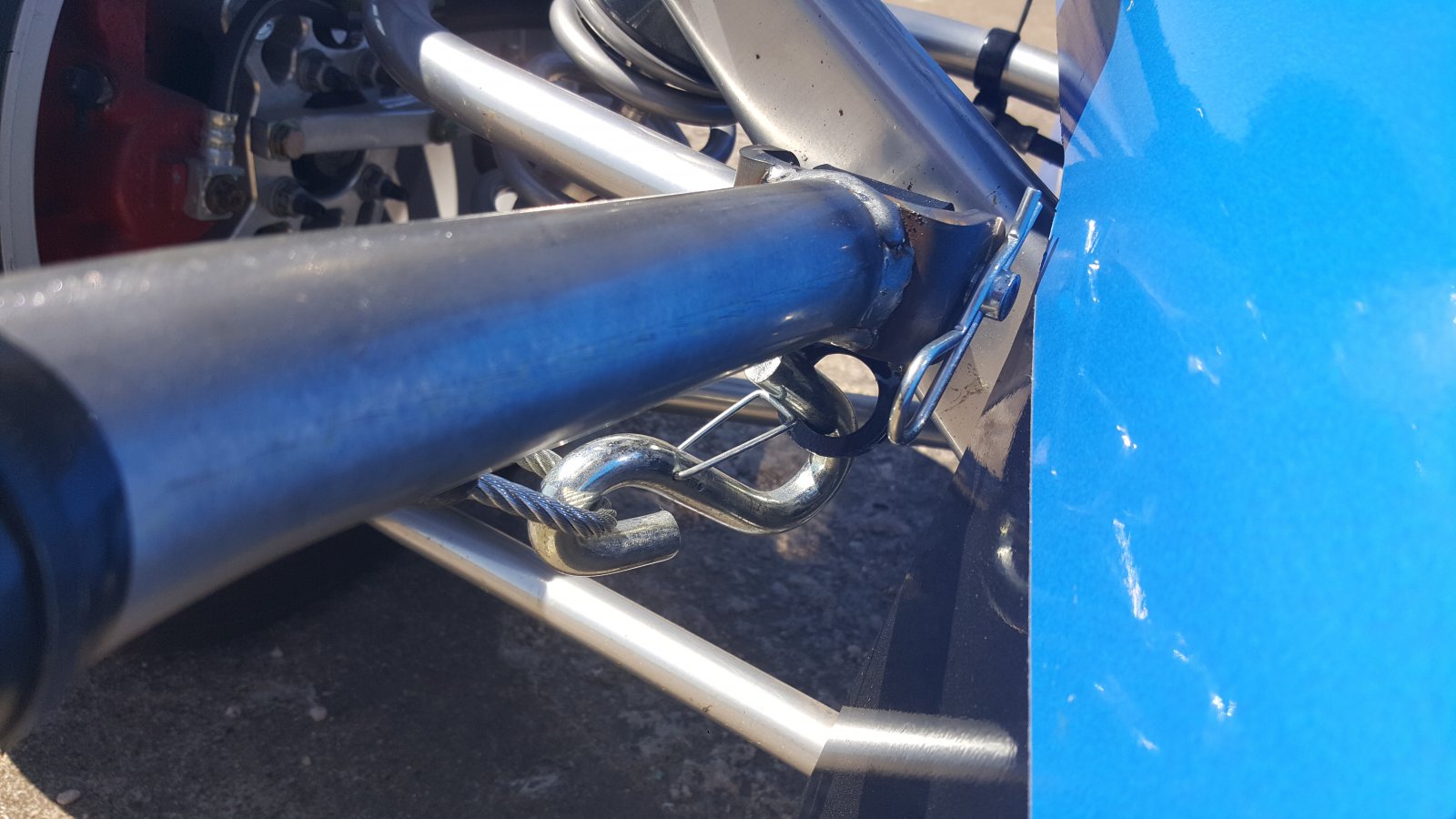

There are rings at the bottom of the brackets that can be used for safety cables. Safety cables are not included with the kit.
$250 plus shipping
