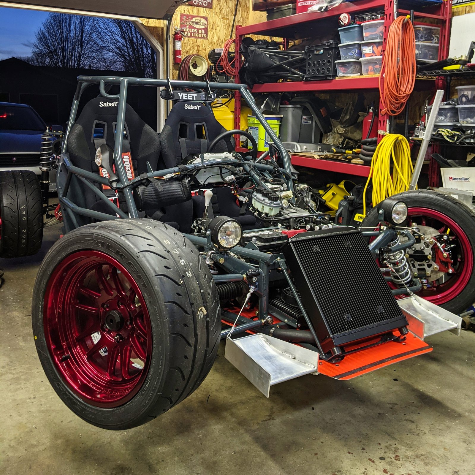

I'm hoping! I really wanted the taller tire to avoid having to go into 3 gear for a few seconds at a bunch of events but there's plenty of other benefits switching to this setup as well!The shorter sidewalls should crispen up the turn-in a bit and just put a more solid feel on it altogether.
Wheels and tires look great! Clash with the front splitter tho...Got the new shoes on! This setup is quite a bit different from last year so hopefully it helps a lot! Last year I had 225 wide Hankook S4's on 15x8 with 4x100, this year is 255 wide Falken RT660's on 17x9 with 5x114.3. Trying out some flashy wheels to see how I like the look too. I need to get the hood on and push it outside in the daylight to get a better look at it.
What aspect ratio?Got the new shoes on! This setup is quite a bit different from last year so hopefully it helps a lot! Last year I had 225 wide Hankook S4's on 15x8 with 4x100, this year is 255 wide Falken RT660's on 17x9 with 5x114.3. Trying out some flashy wheels to see how I like the look too. I need to get the hood on and push it outside in the daylight to get a better look at it.
