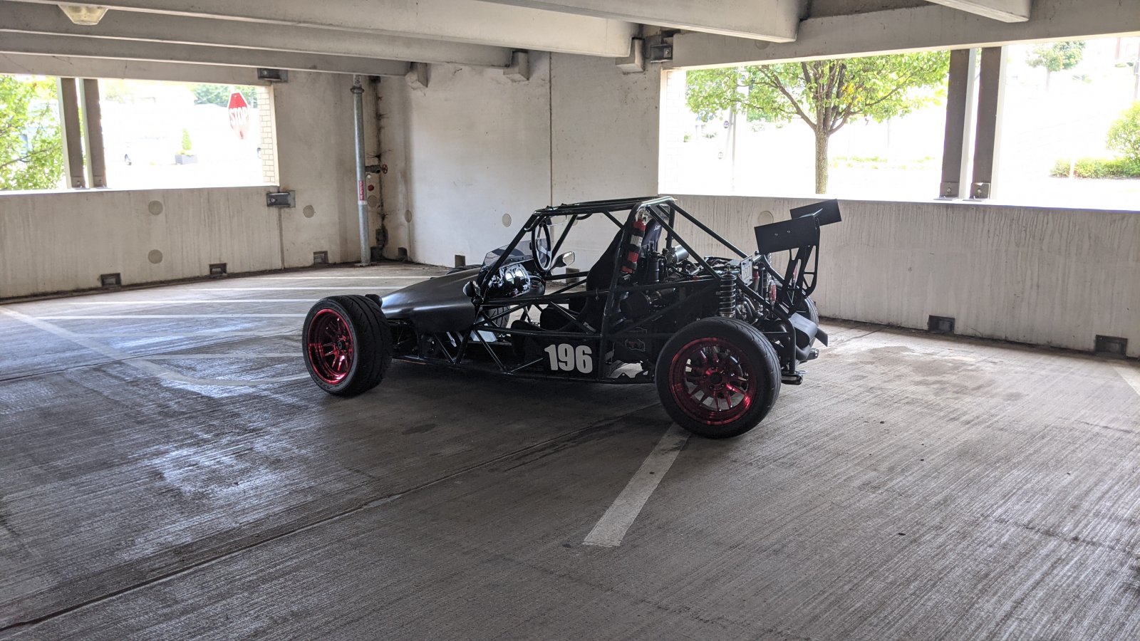

Added a wing to the Goblin last week. I was skeptical on whether or not it would make a positive improvement since the car is already so rear biased. However, after putting this relatively inexpensive wing that has an attempt an airfoil design to it on the car, these things seem to NEED a rear wing! Now that I know it helps, I'll be investing in a legit wing from 9livesracing to get the car to grip up even more. Check out the video of the install and testing!

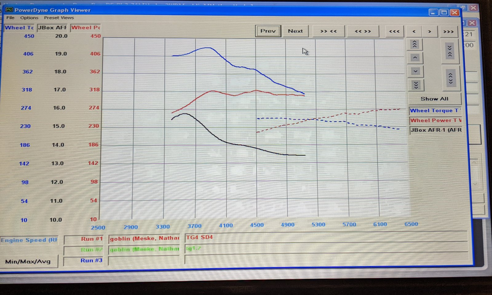

Switched to turbo over the winter and had it dyno tuned last week. It made about 320whp and 430wtq on a Mustang dyno which is WAY MORE than I expected it to make! Of course I'll be turning the boost controller down quite a bit since the car is quite the handful at that power level! The dash lines on the right are from one year ago with a 2.7 pulley on the stock blower.

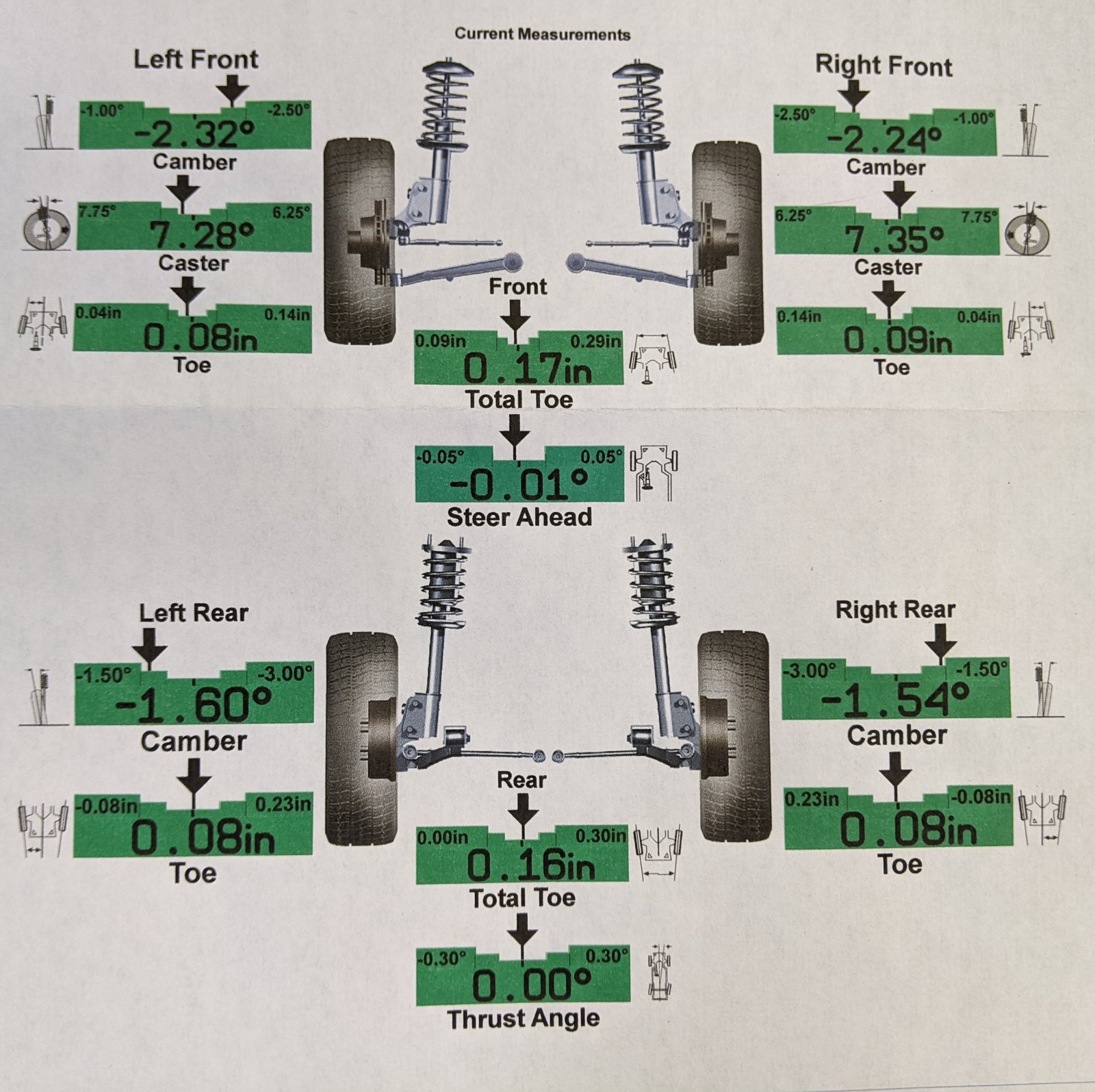

After the tune we took it over and put a fresh alignment in it. Pretty standard alignment numbers I think.

Which turbo did you go to ? How much boost are you allowing ?
It's a stock K04 on 23lbs of boost.
It was tuned all the way out to 8200rpm but the power falls off up top so it wasn't revved out on this run.
You don't find that much camber to only load the inner edge of the tire?
It does but it sure helps during hard cornering. I may dial it back up front a little but I want to get it out on the track some more to play with it. It's slightly less camber than I was running last year and I've never had any understeer.
ccannx
Boost drop was more significant when I installed the stage 2 turbo cams the same time the b207r went in. It had a blast of power up to about 5200 and then fell off instead of tapered off. Car felt way better on the stock LSJcams+k04 before the motor overhaul. The stage 2 cams really came to life when I swapped in the EFR turbo.
The k04 was a huge seat of the pants difference from the m62 for sure.
