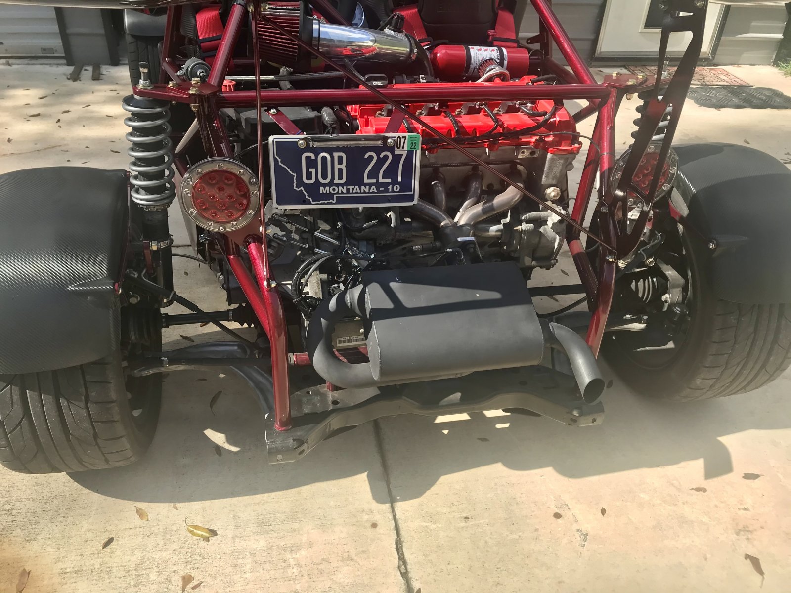

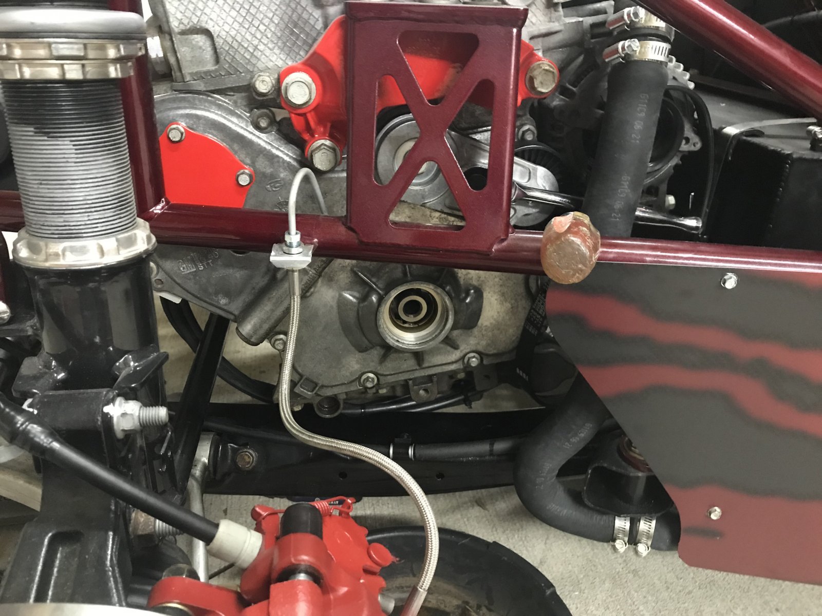

After my first drive I noticed an oil leak behind the Harmonic Balancer. As the song goes ..."You picked a fine time to leave me you seal" $10 and 30 minutes later the new Crankshaft seal in in. Time for a test drive.

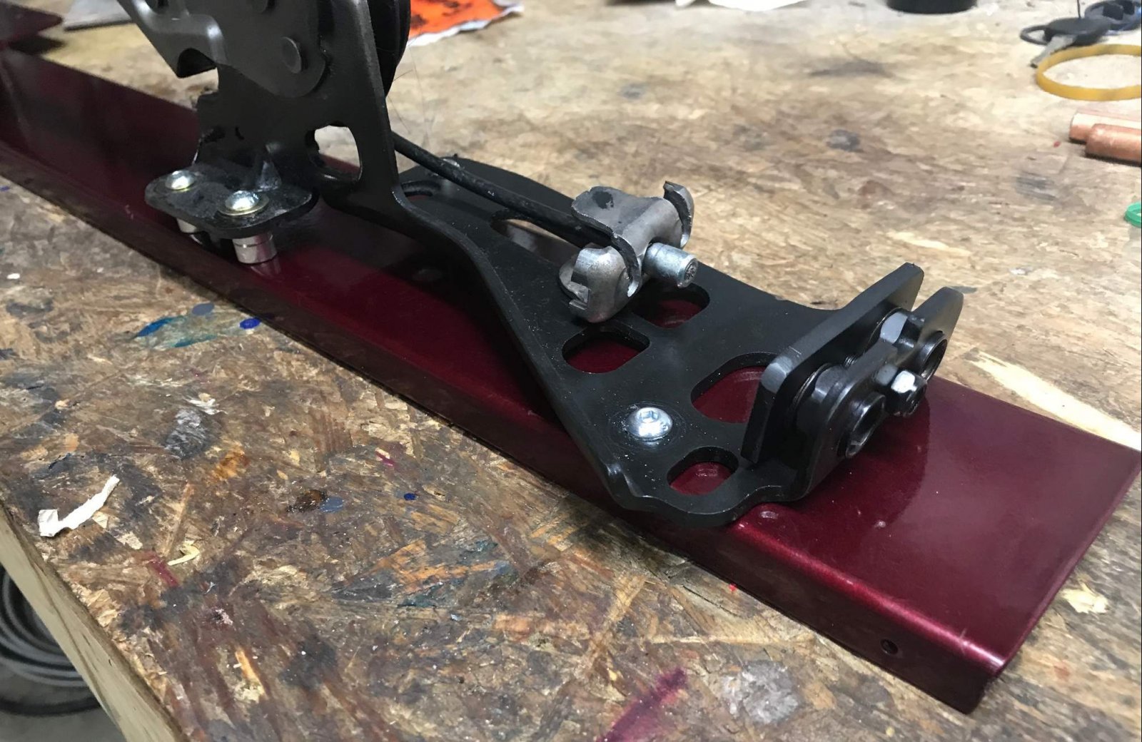

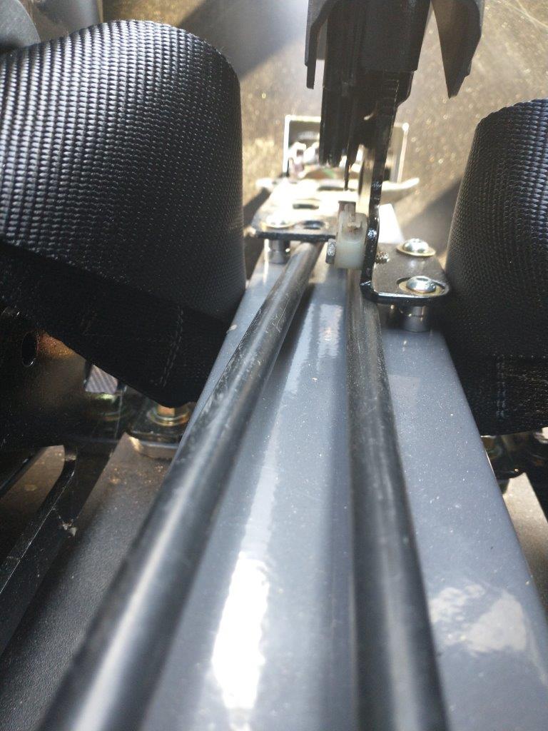

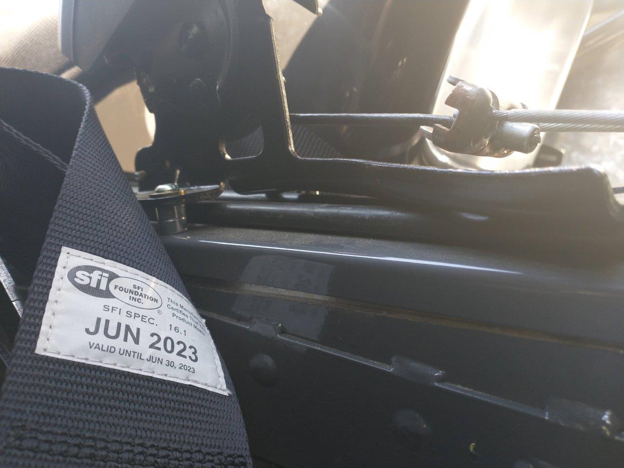

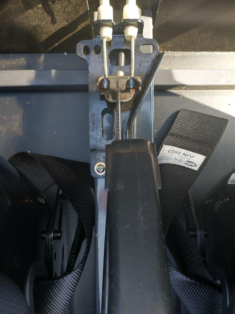

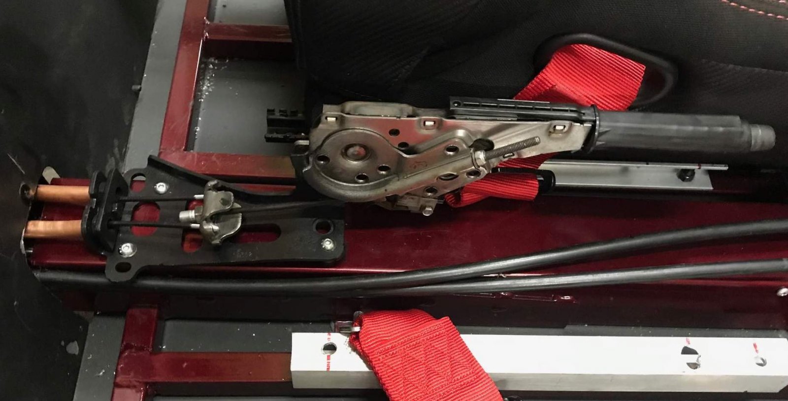

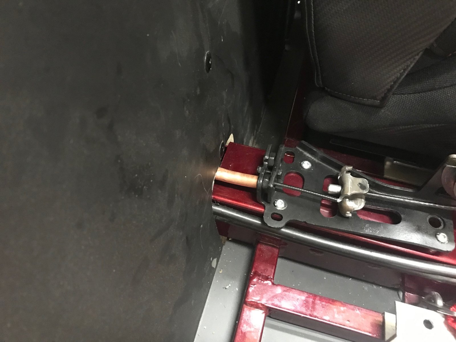

E-Brake/Parking Brake - Unfortunately I did not save my E-Brake hardware so I had to build it from scratch. Did not see much info on here so I took a lot of pictures of what I did. The E-Brake handle is readily available (Ebay) as are the cables (Rock Auto). The rest I had to cobble together. As we say in the Navy "Works fine, failsafe & drains to the bilge".
Did you run the shifter cables over top of the Ebrake assembly? Off to the side? I don't see enough spacers, so I'm guessing they didn't go under it.
I'm currently trying to mount mine, and I think the shifter cables are going to go under. It's the straightest shot to the the lever, though it requires a bunch of spacers to get it high enough.
CaptFrank2001
The shifter cables are off to the passenger side. The last picture shows the spacers. Just in front to level the E-brake assembly.
From behind the drivers seat looking slightly forwards:
25817
From just behind the shifter looking backwards:
25818
From above:
25819
