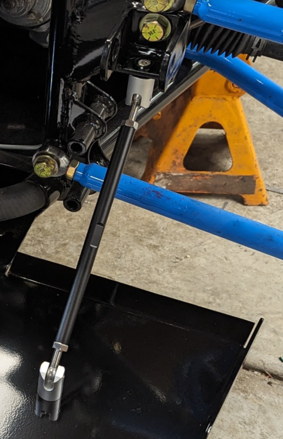

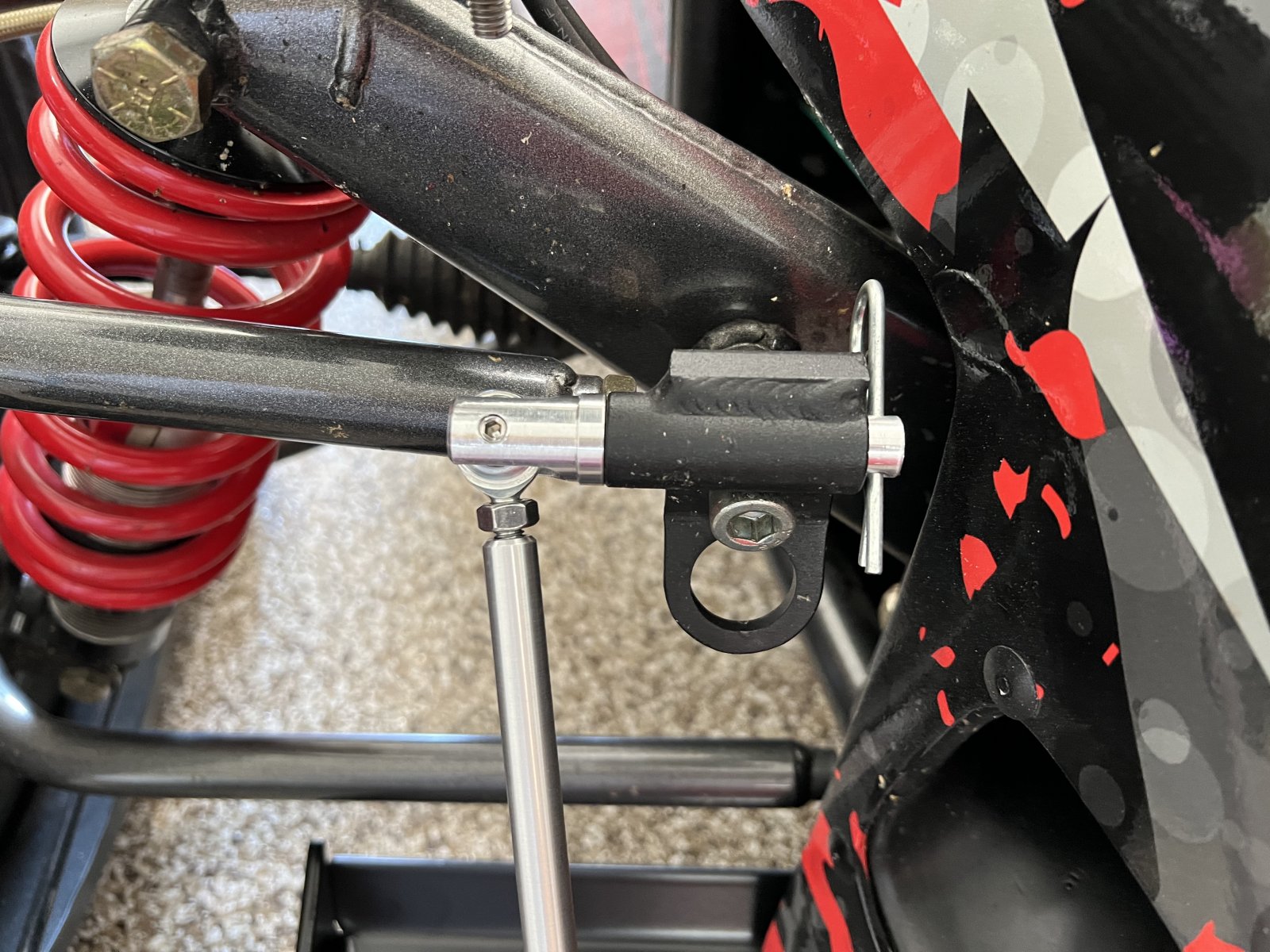

Thanks @Sluggonaut. I knew what I wanted, but didn't know what to search - "clevis" and "jaw jaw turnbuckle" were not words in my vocabulary lol
I used these.Thanks @Sluggonaut. I knew what I wanted, but didn't know what to search - "clevis" and "jaw jaw turnbuckle" were not words in my vocabulary lol

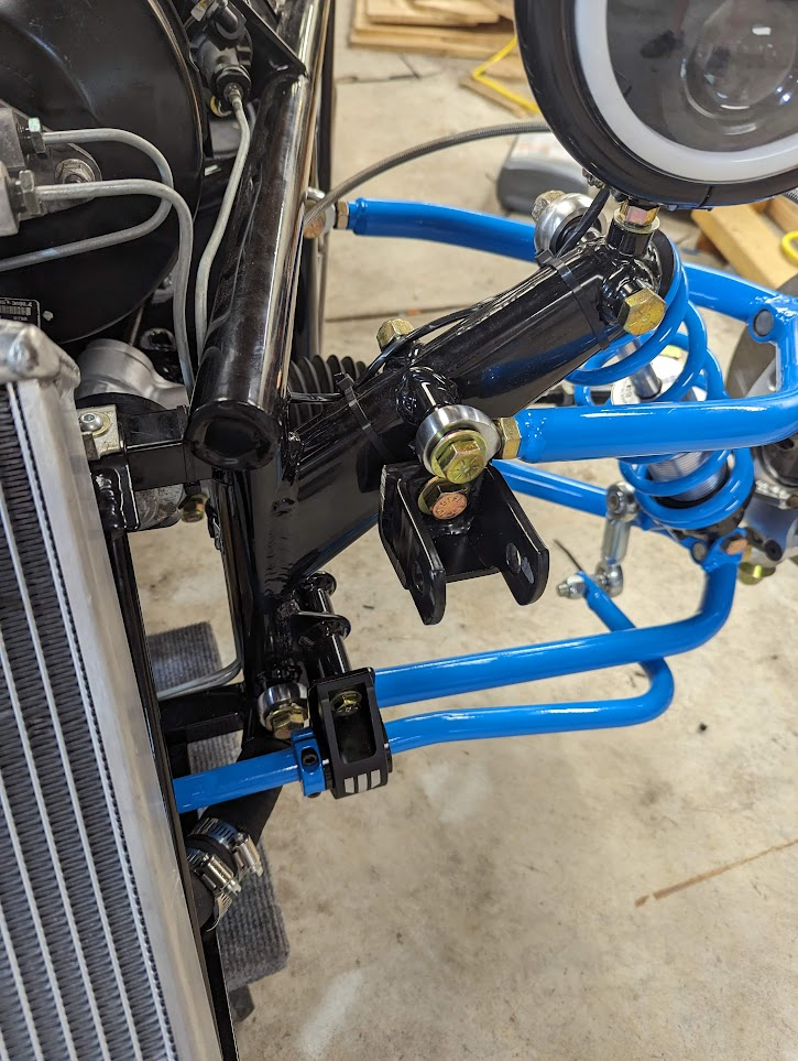

The black bracket is my harbor freight tow bar mount. It is bolted through the tube where the upper control arm originally mounted (I moved the mount for my setup).How is the black bracket attached? Is there another bracket behind that bolted in front of (or behind) the upper control arm?
Ohhh, I see that now. Thanks!The black bracket is my harbor freight tow bar mount. It is bolted through the tube where the upper control arm originally mounted (I moved the mount for my setup).
That's going to throw everyone for a loop trying to figure out how to bolt through the shock mount 'ear'.The black bracket is my harbor freight tow bar mount. It is bolted through the tube where the upper control arm originally mounted (I moved the mount for my setup).

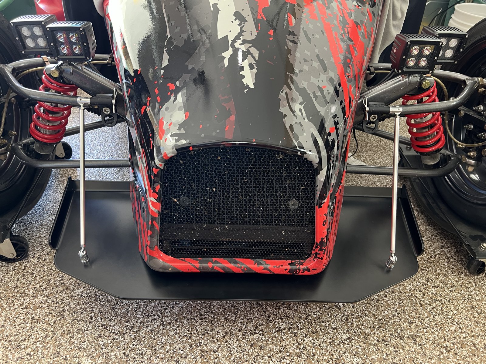

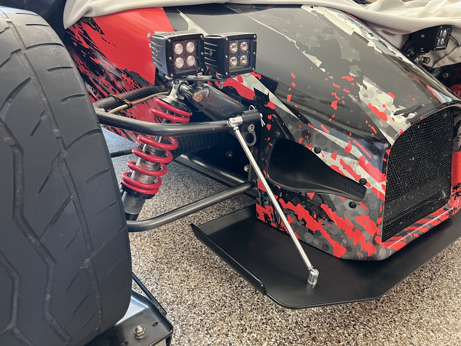

Got my splitter finished up today.
Using supports really firms it up! Before adding them it was possible to push down on it and see it flex.
I had custom pins made that utilize the tow bar mount. Using the retaining pins on the top will allow them to be removed easily when I tow the car. (Which isn’t often)

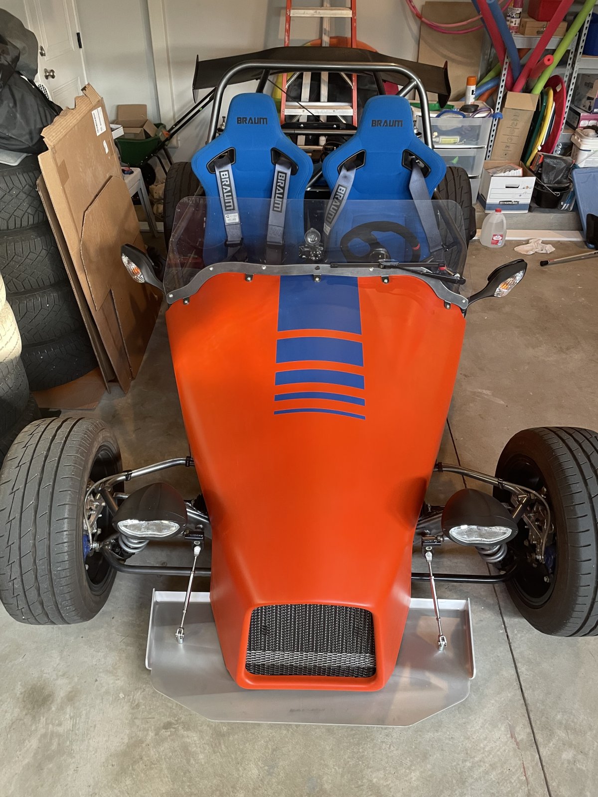

Took mine for its first drive. I have to say the primary reason I got it was for the look. Well I took it out in Mexico and hit 115 MPH. Holly carp was the front end planted. I didn’t expect that big of a difference
Sure we will go with that.125 KPH - somewhat legal, eh?![]()

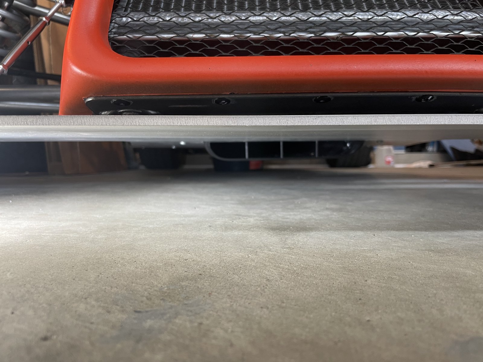

Did you buy a scoop or make it? If bought, which one?A little late getting this on but it works great. Trying to show the hood scoop underneath too.
View attachment 47024View attachment 47025
It’s the one Rttoys shared, in the forward position like he said.Did you buy a scoop or make it? If bought, which one?
