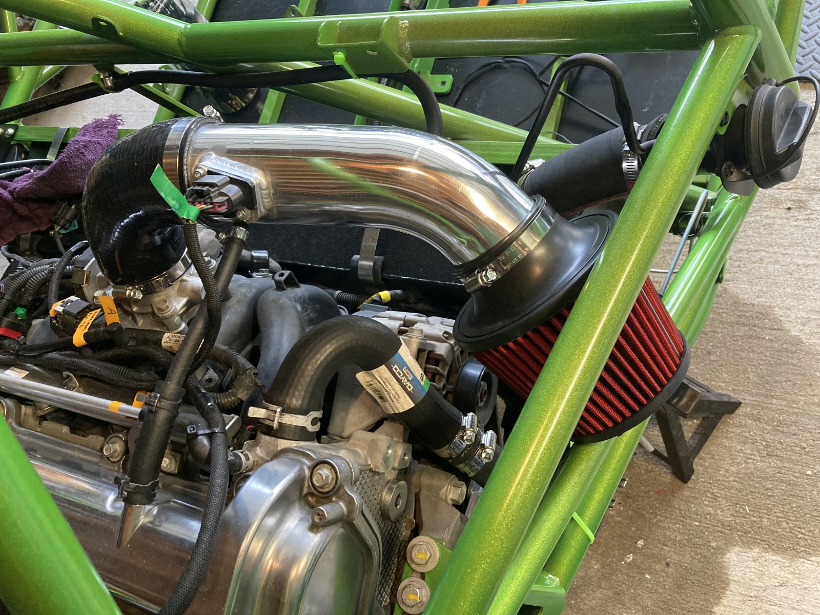

Your intake should look like this.

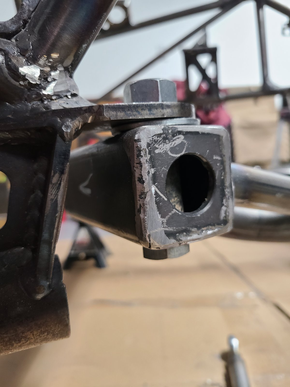

The carriage bolts are used in the front locations:
The bolt head is on bottom with the nut on top similar to the above photo. The square section under the bolt head will grip into the subframe - so only tighten the nut on top.
The carriage bolt head leaves just enough room to pull the radiator hose through and not rub, which would happen with a normal hex bolt head (ignore mine, it's a temporary installation in a custom subframe different than the Cobalt subframe).
