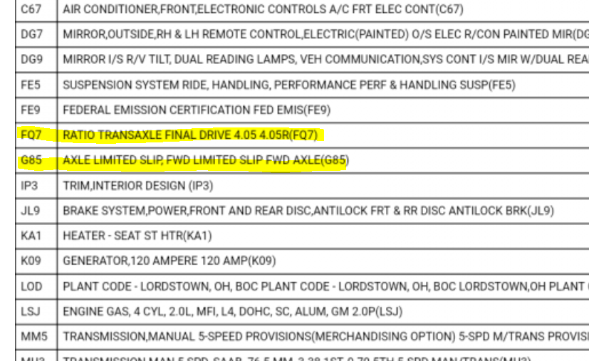

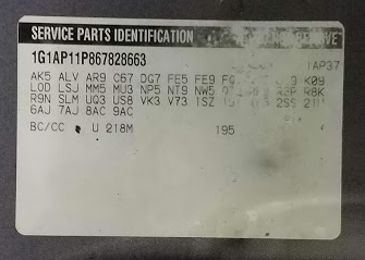

The trunk plate will show code G85 if you have the LSD. (At least for LNF, but I believe it's the same for LSJ)

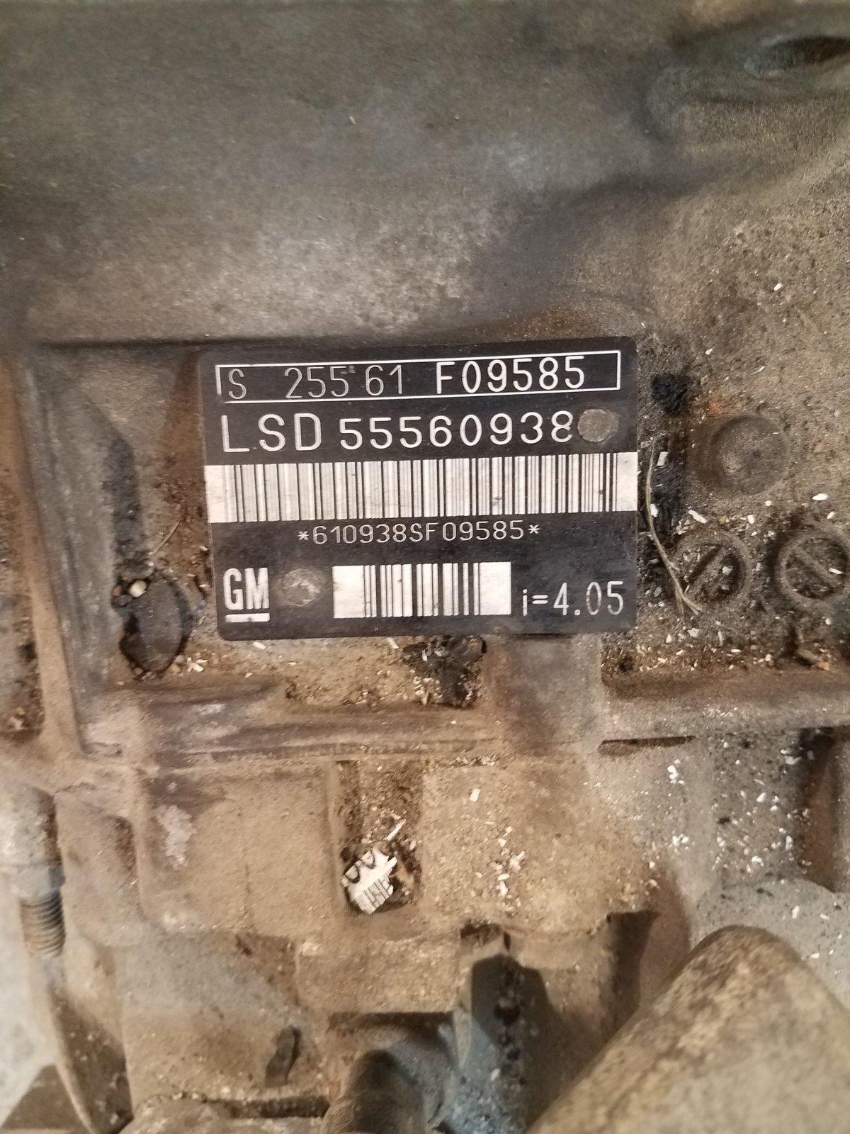

LSJ cars are the same. If you can see the plaque on the trans it will say LSD 20181204_201359.jpg
There's a metal plate riveted to the floor of your trunk, under the carpet. Or, like Luke said, you can just look for "LSD" on the transmission.

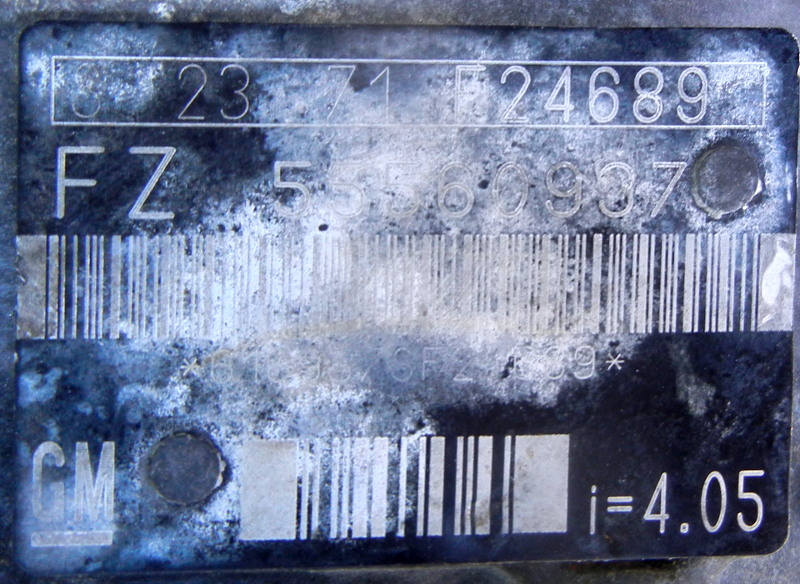

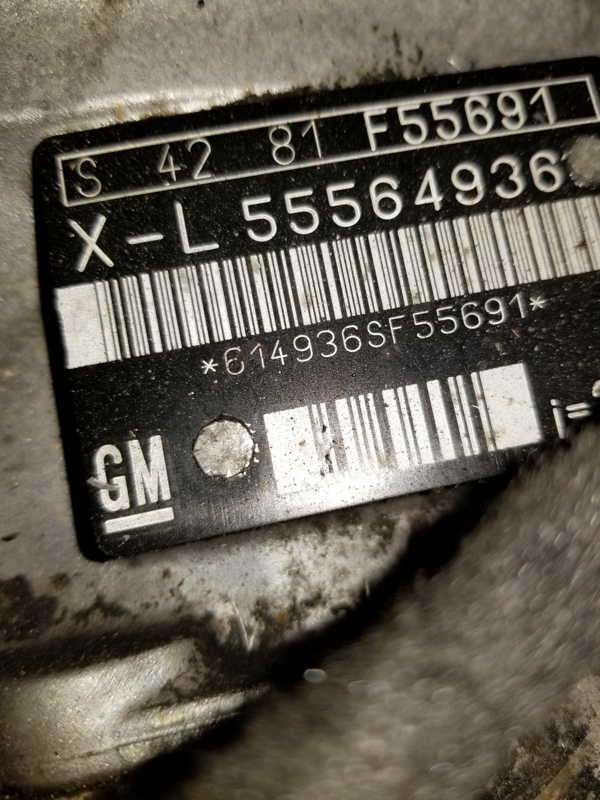

I know this LSD issue has been beaten to death over time, but I have another question. My 2009 SS/TC has the G85 code. The guy I bought the car from said he trashed 2nd gear and replaced the LSD transmission with a non LSD. I have the transmission he said he removed but the tag does not have LSD on it. He even told me he preferred the LSD. Do some of the LSD transmissions not have LSD stamped on the tags? Is there a way for me to confirm whether or not I have LSD?
Not all of them have "LSD" on the tag. Mine doesn't have it on the tag but does have it on the build sheet. I have no reason to doubt that it does in fact have the LSD.
By the way, don't use degreaser on tag. Eats the paint off immediately. :mad:

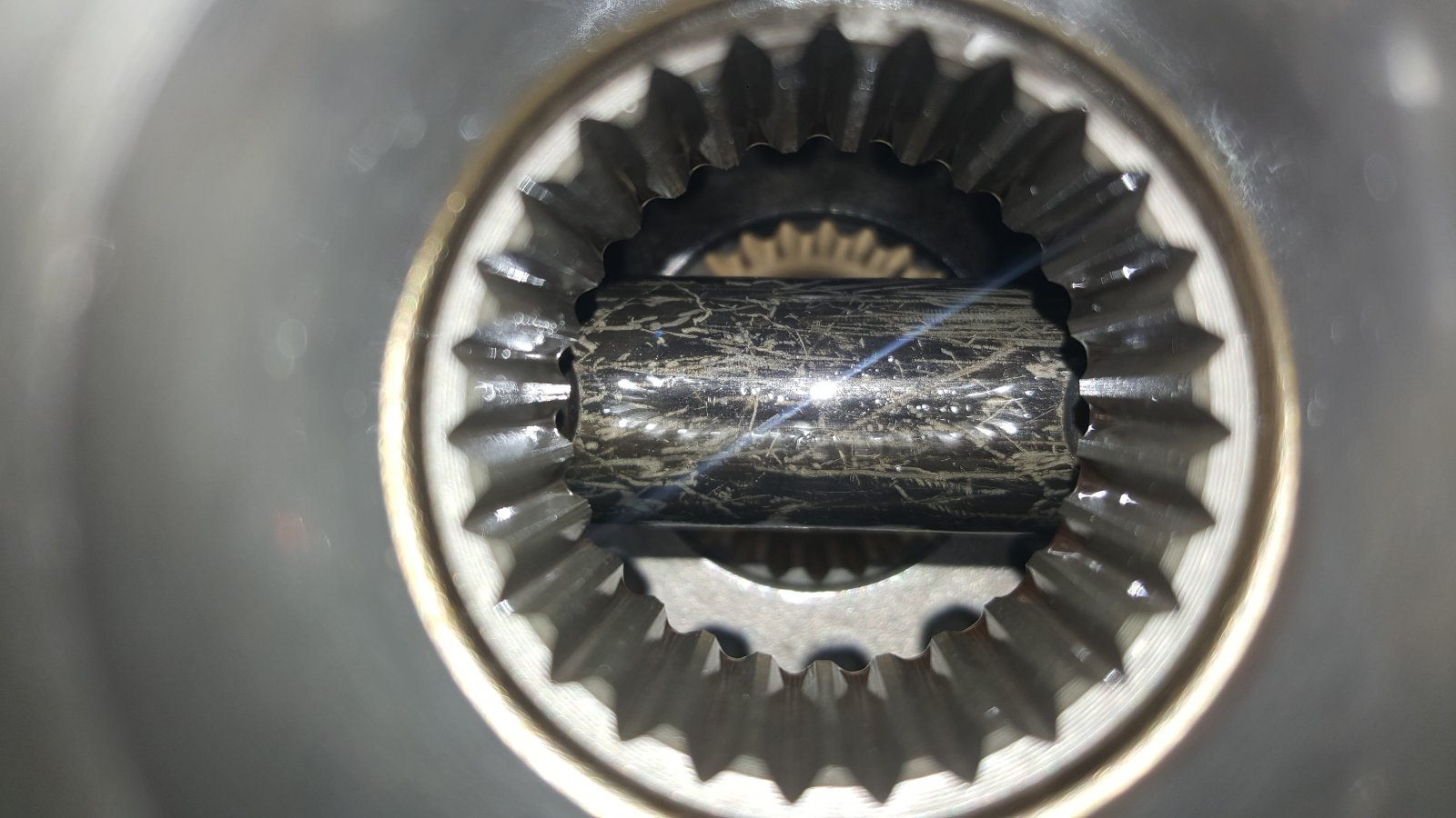

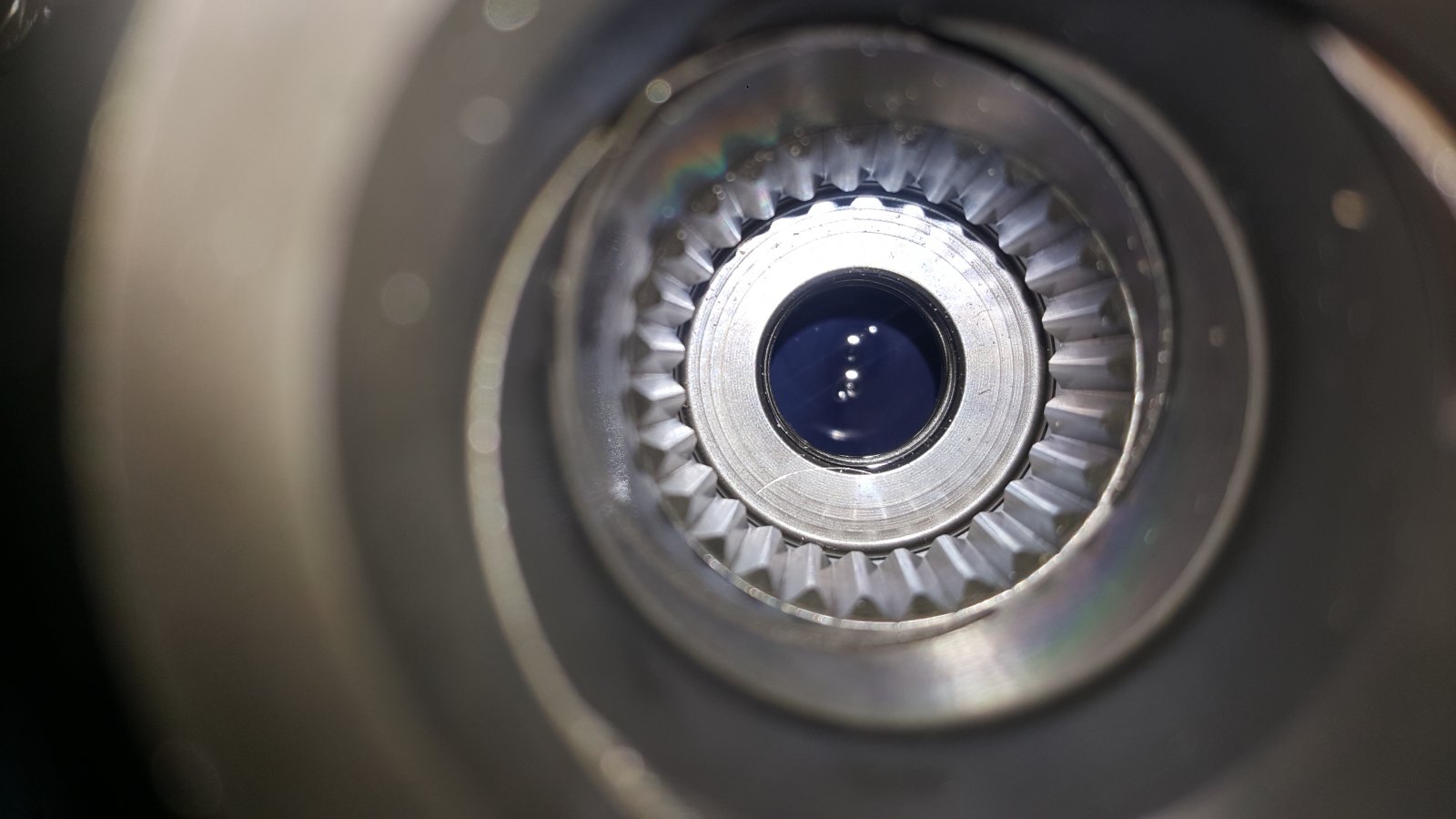

Lonny: When you add the Quaife LSD to a transmission at the factory, do you alter the plate and stamp it in some way?
Lonny, the images you had were great. Three extra transmissions were included with the purchase of my car. Two are LSD and the third is not. This is just as the seller said. And now it's confirmed that not all LSD transmissions have LSD stamped on the tags. You must look in the axle hole to know for sure.
