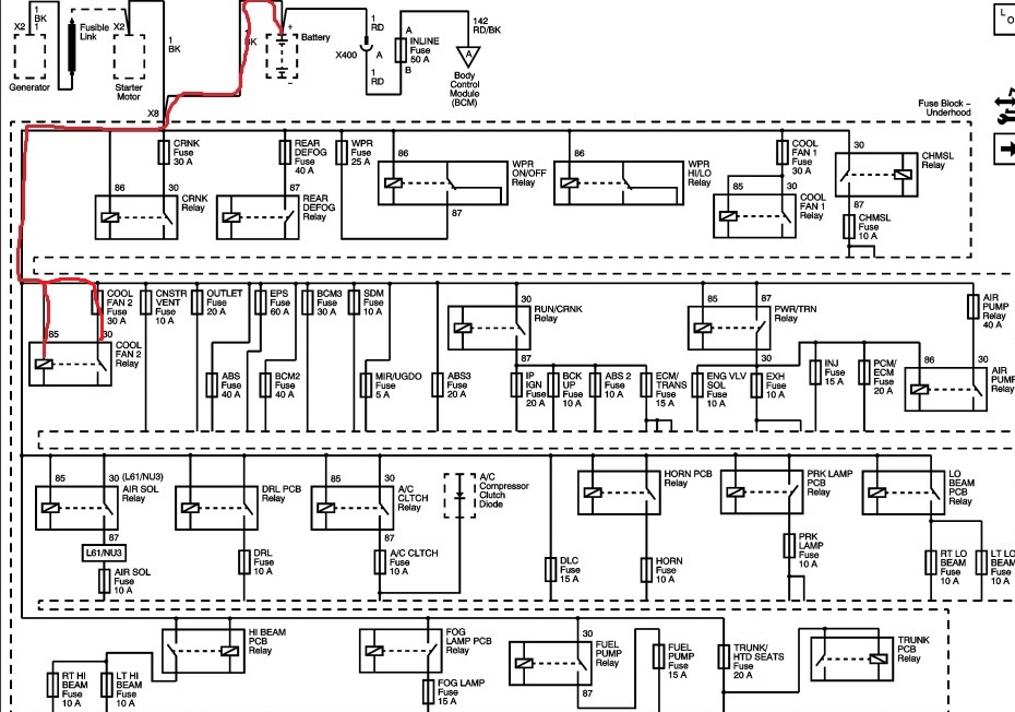

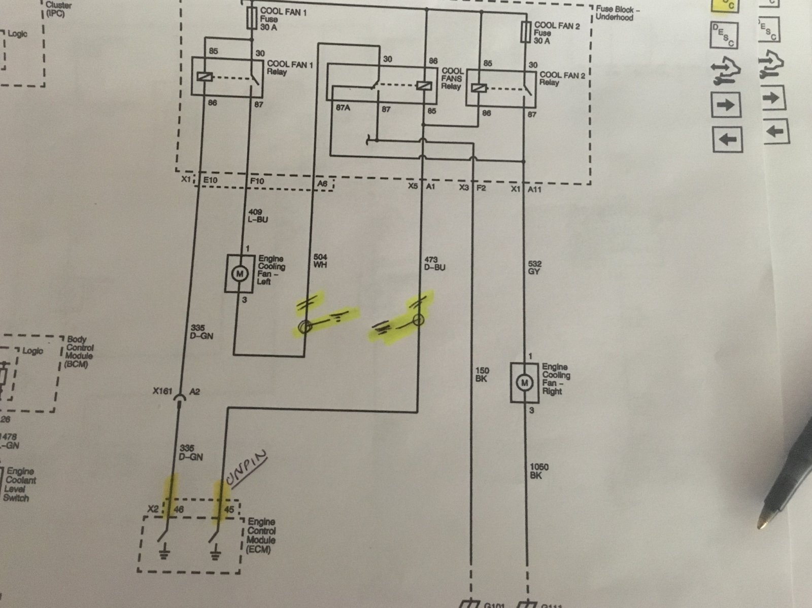

Not the BCM. Leave the BCM alone. The fan circuits are switched on by the ECM. Fan one trigger is a green wire; fan 2 trigger is a blue wire. Regardless, these circuits are grounded by the ECM in order to provide power to the fan relays (lt. blue & gray 12 gauge wires). 2007 & below also has its own dedicated intercooler pump relay. 30 amps is plenty to run the pump & fan. You can run either of the fan relay trigger wires to ground to run the fan at all times when the key is on. I recommend letting the ECM run the COOL FAN relay 1 with the Goblin radiator and grounding the blue COOL fan relay 2 to run your intercooler fan & pump.
The top side of the cooling fan relays are connected to B+ voltage. If you ground out the wires on pins 45 & 46, then the fan will run regardless of ignition status. You'll basically end up with a straight hot wire from the battery.
At least that's my understanding of the power distribution schematics. I could be wrong. I'd rather use a circuit that I know is connected directly to the run/crank relay.
Maybe I'm not following. Pins 85 and 30 on the cool fan 2 relay should be always hot regardless of the position of the ignition switch because they're both connected to B+. If you ground out the dark blue wire (473) right where you have it highlighted, the cool fan 2 relay will be constantly closed and send battery voltage through the 30A fuse, through the relay, and out the gray wire.
Brian74
I stand corrected on the battery voltage being direct to the fan relay. Thanks for pointing that out. I still wouldn’t use the run/crank relay though. If a fan motor shorts out later on, you will find yourself stuck with no way to diagnose the issue vs. a blown fan fuse. Also, those fan motors draw significant amperage. The best way to do it would be to wire in an additional relay near the power dist. block that switches to ground when the key is on, and use that relay to ground the fan relay trigger.

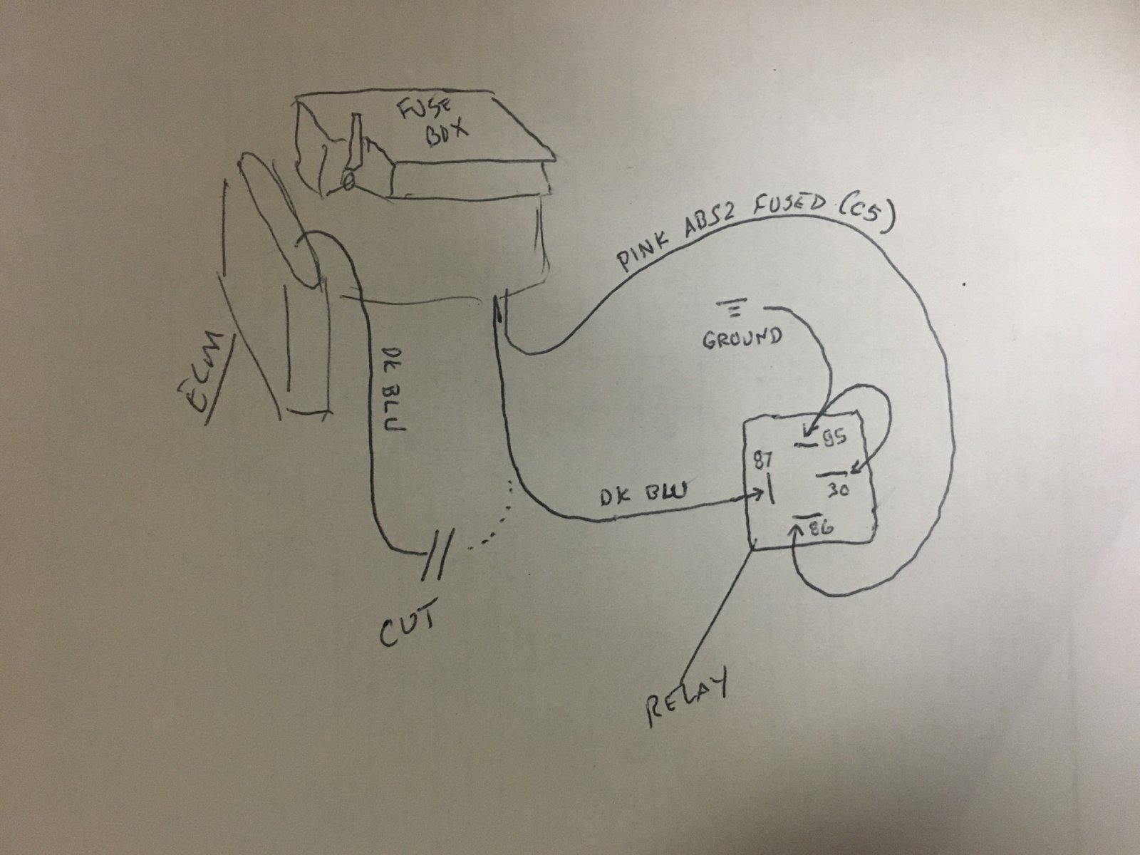

I ended up running the pink ABS 2 wire from the C5 fusebox connector to a relay. When key is turned on, relay kicks closed & provides ground to the blue fan relay trigger wire. Works great.

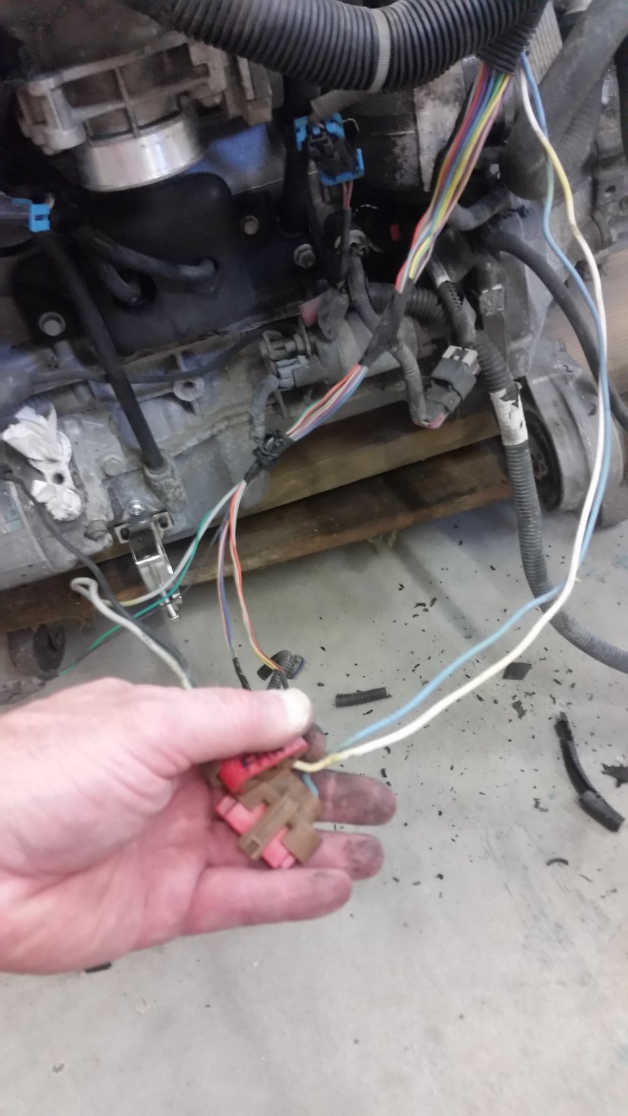

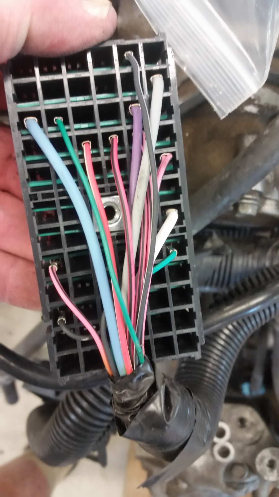

Just to clarify so I don't screw something up, I attached pictures of both fan wires... the passenger side fan #2 (I think) is the gray with a black ground that connects to the engine. The drivers side (fan 1) is the light blue and white wire. The gray, lite-blue and white wires goto the large black multi-plug.
I can cut the blue wire at the plug connection and solder it to the black wire that is references in the build guide. I need to ground the white wire since it goes to the fan relay switch which grounds the circuit. The gray wire can be hooked to the positive wires on both the pump and inter-cooler fan. Black wire to a ground or do I add in a new relay using the ABS wire Brian74 talks about?
