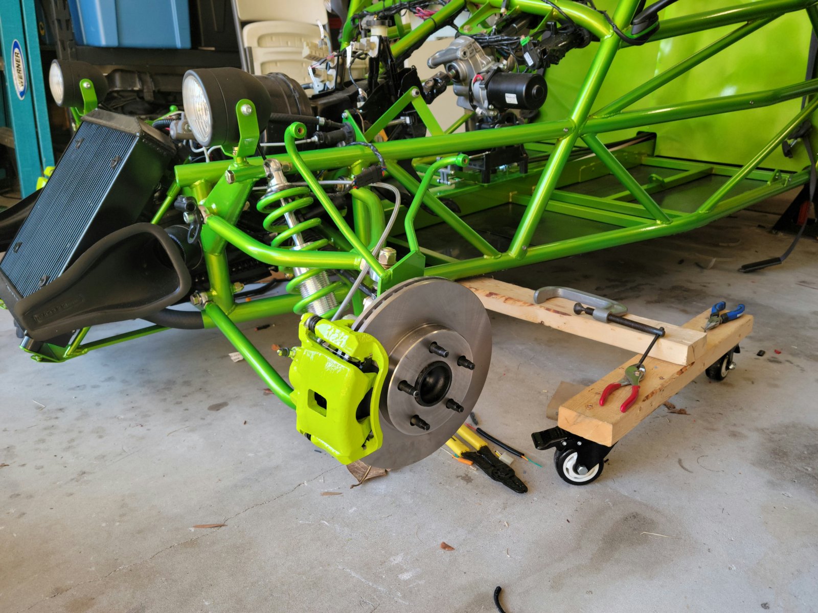

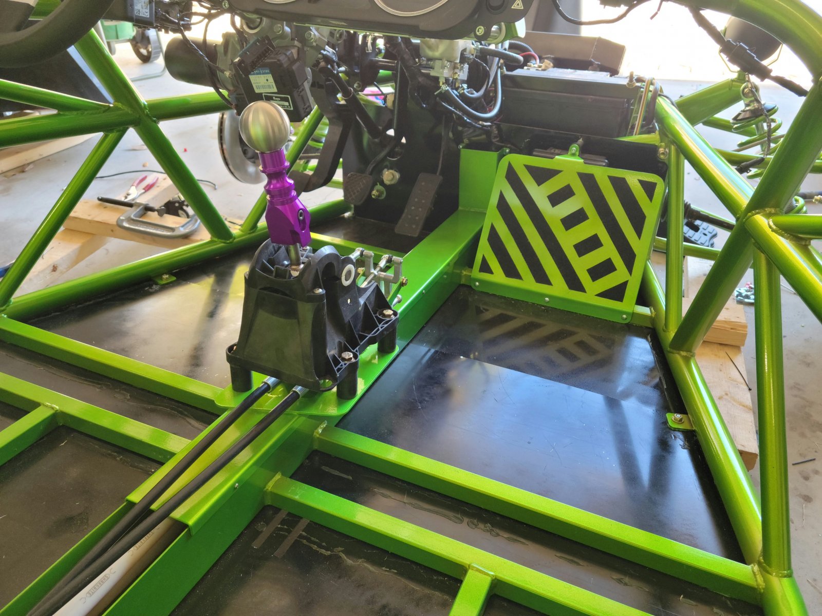

Well I've been slow rolling it a bit. I got all the lights wired up with plugs. Miswired the pax rear light the first time but fixed that. Got the front and rear ends put together and discovered I was missing the bolts to attach the rear calipers, so Adam has those in the mail. Today I torqued a couple of the front end bolts, put on the kick plate and center tunnel cap front half, and assembled the shifter. My wife was kind enough to put the anti skid tape on the kick plate and added a creative touch...I really like it. And finally ran it up to temp. No leaks, the fan kicked on and off around 217 degrees. Fluids seemed to be circulating just fine. Hopefully tomorrow those caliper bolts will arrive and then to bleed the brakes and clutch and hopefully take it around the block!

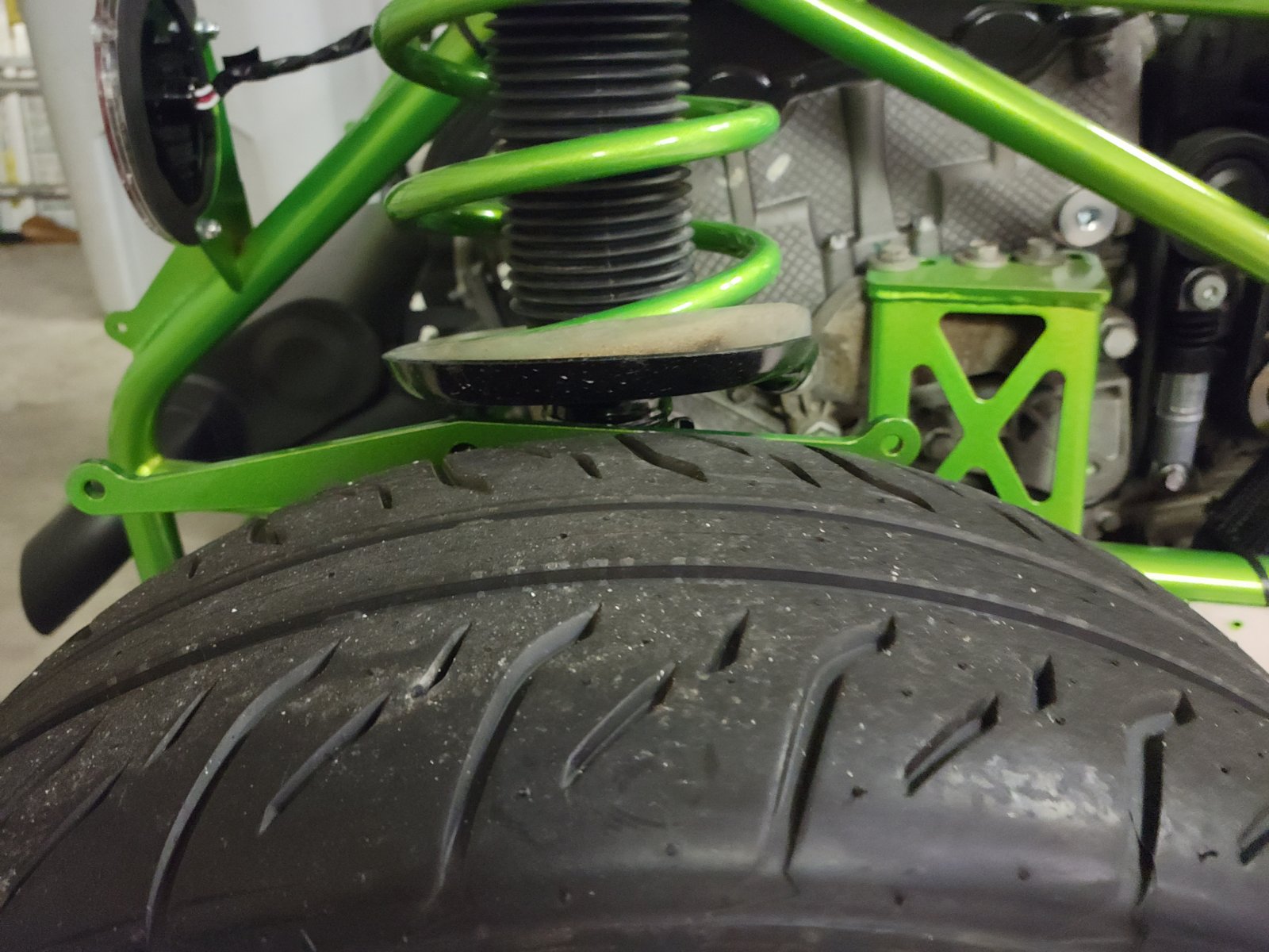

Also, discovered that the standard fenders are too narrow for the SS wheels\tires. The standard fenders are good up to 205 and looks like my stock SS tires are 215s. I don't think I've seen anyone else bring this up on their build logs. I think I'm just going to trim the outer lip and try and use them up front. But the rear is going to be totally l tricky. I'm using the stock shocks and there is very little clearance between the bottom of the shock and the tire.
