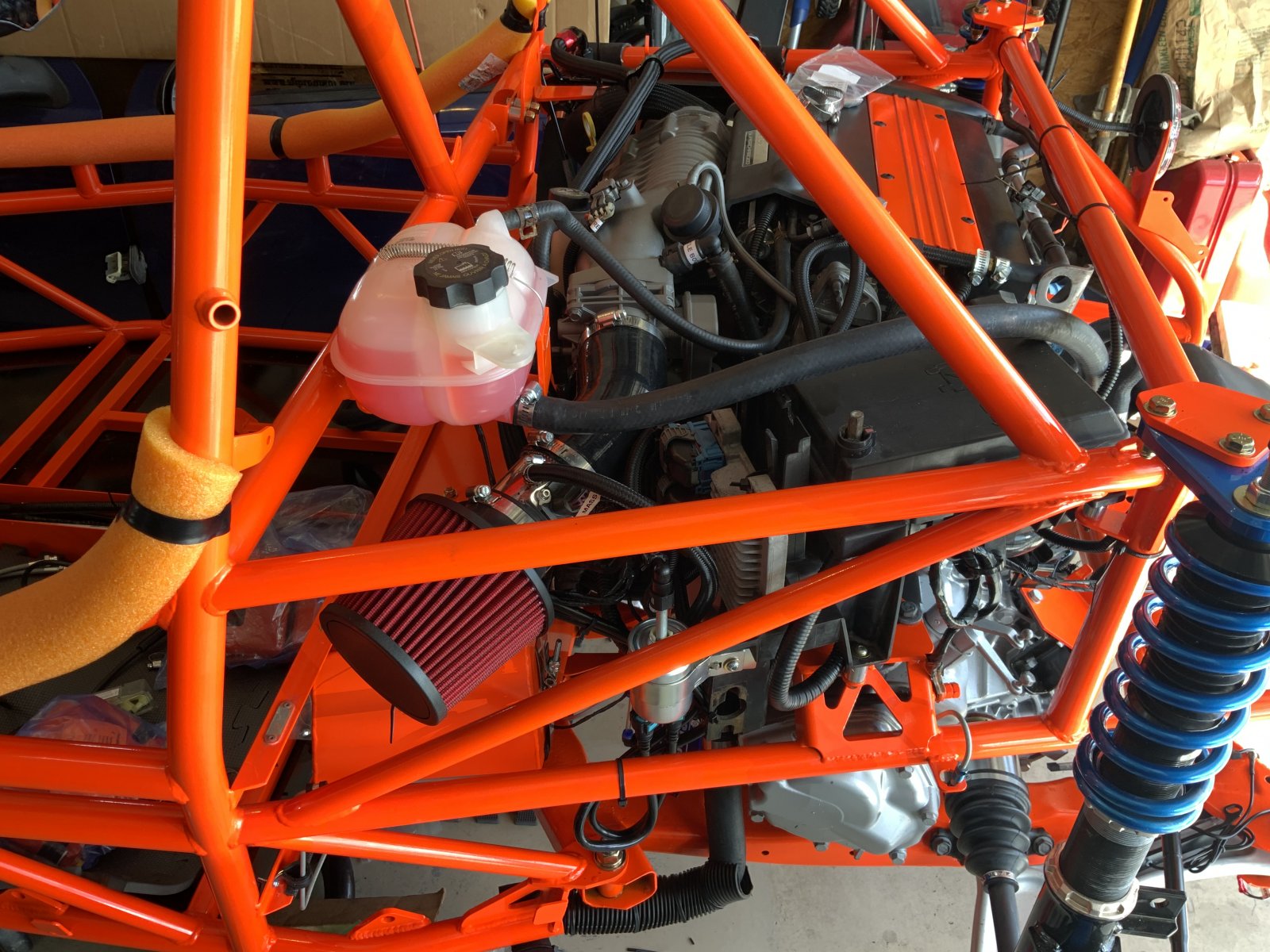

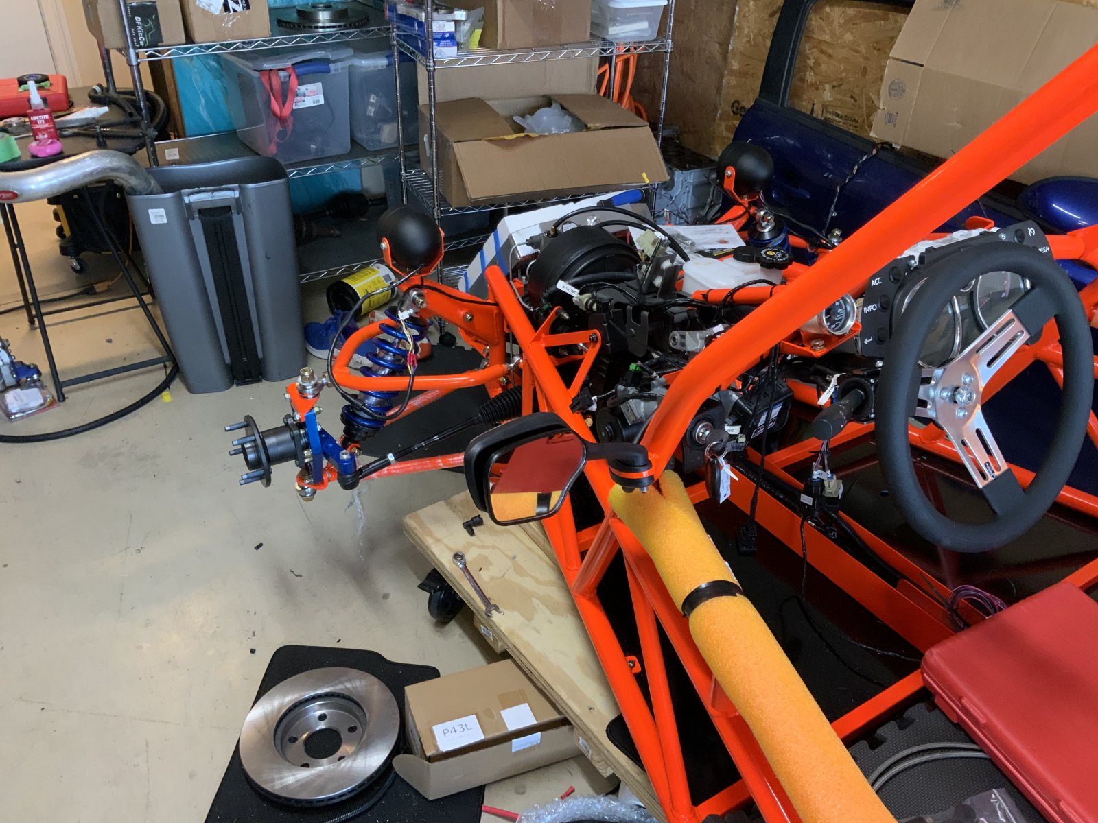

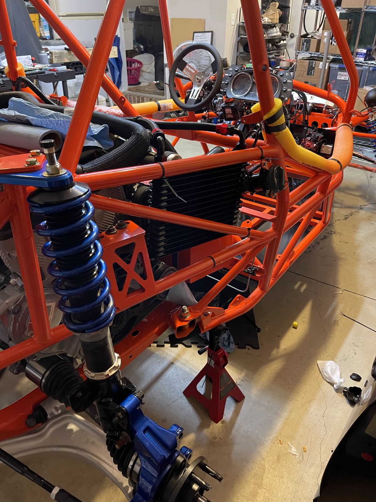

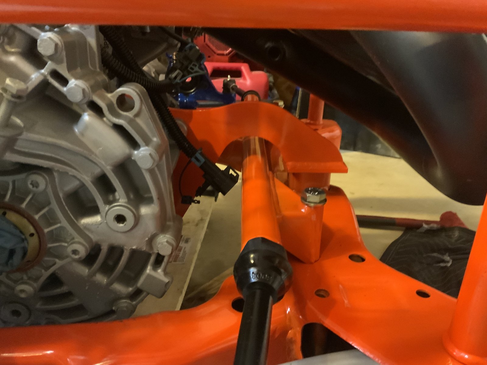

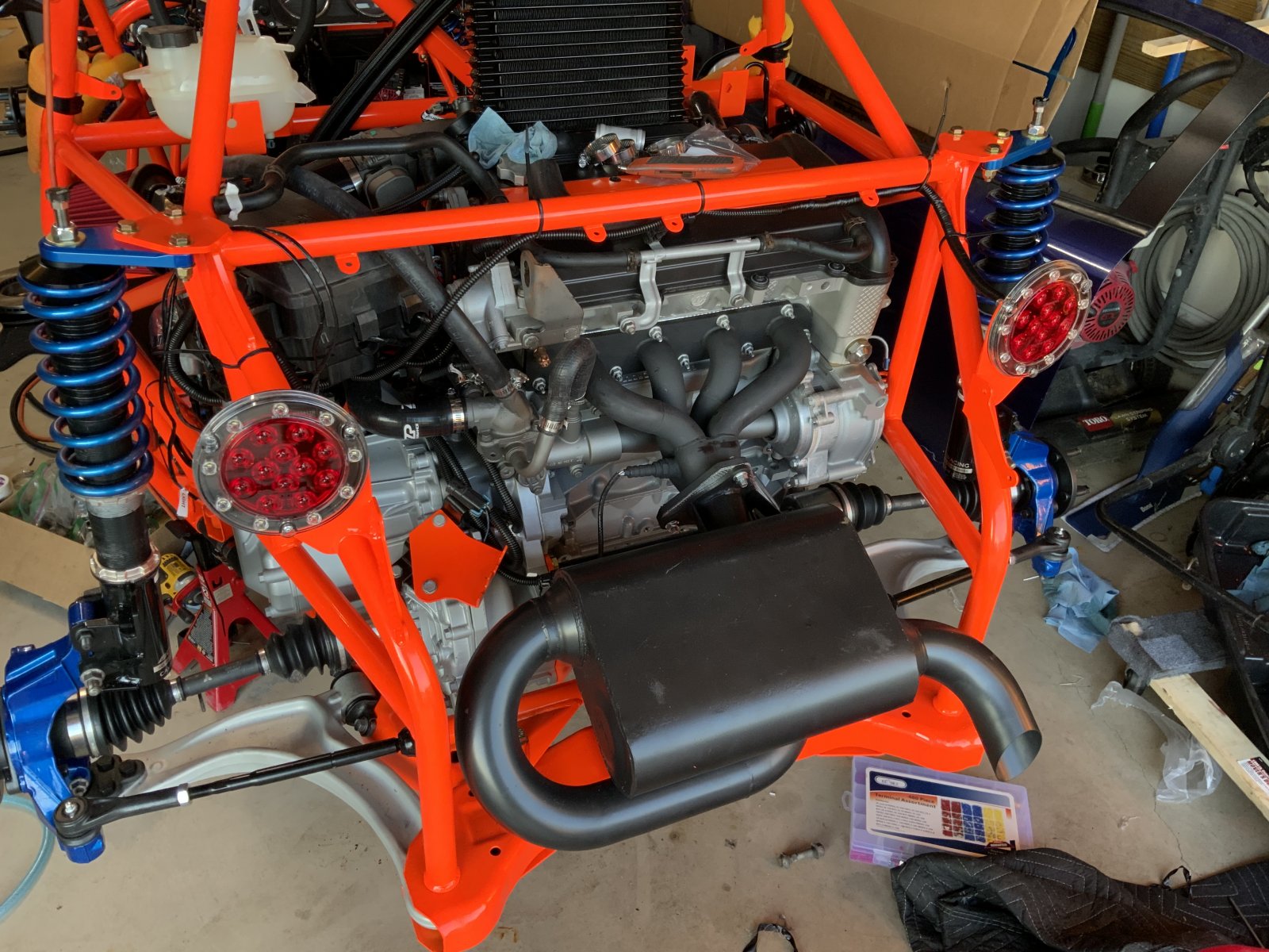

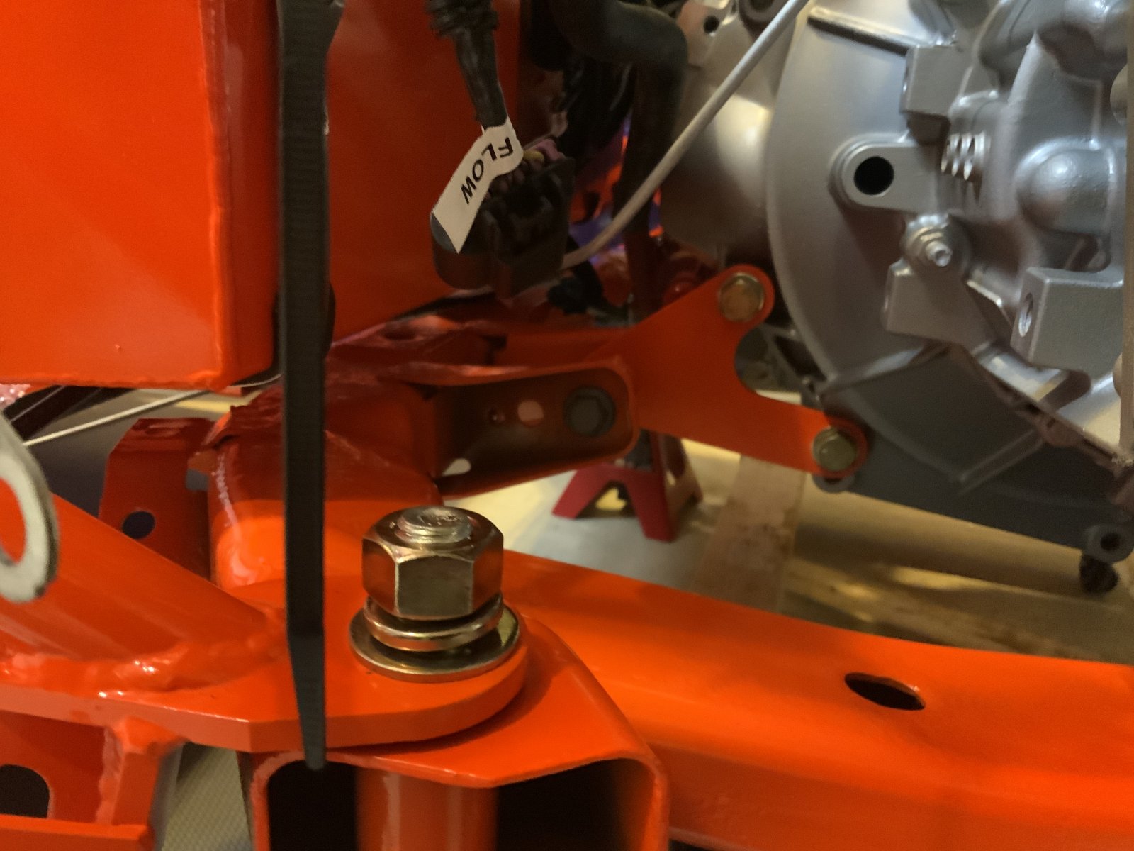

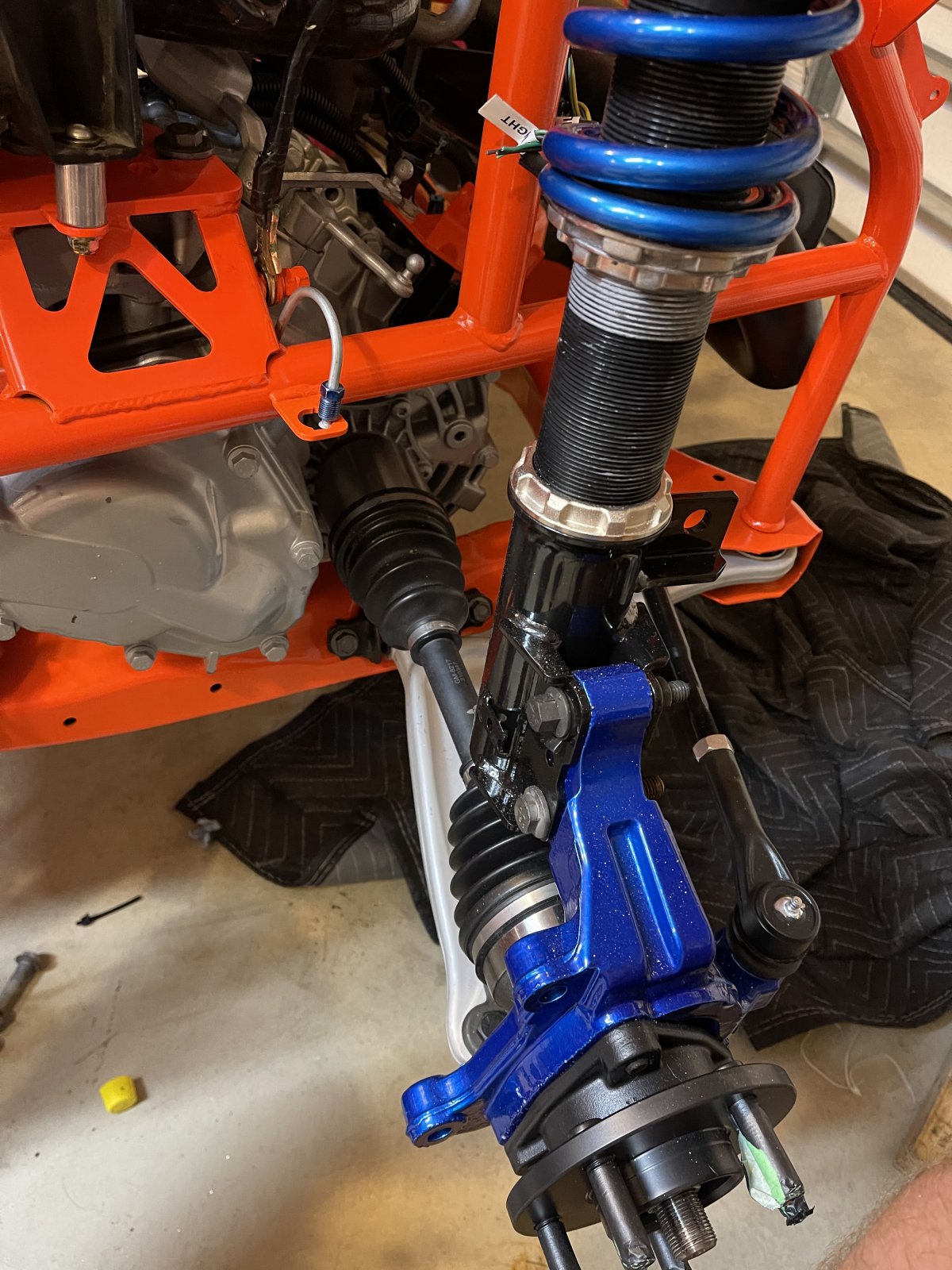

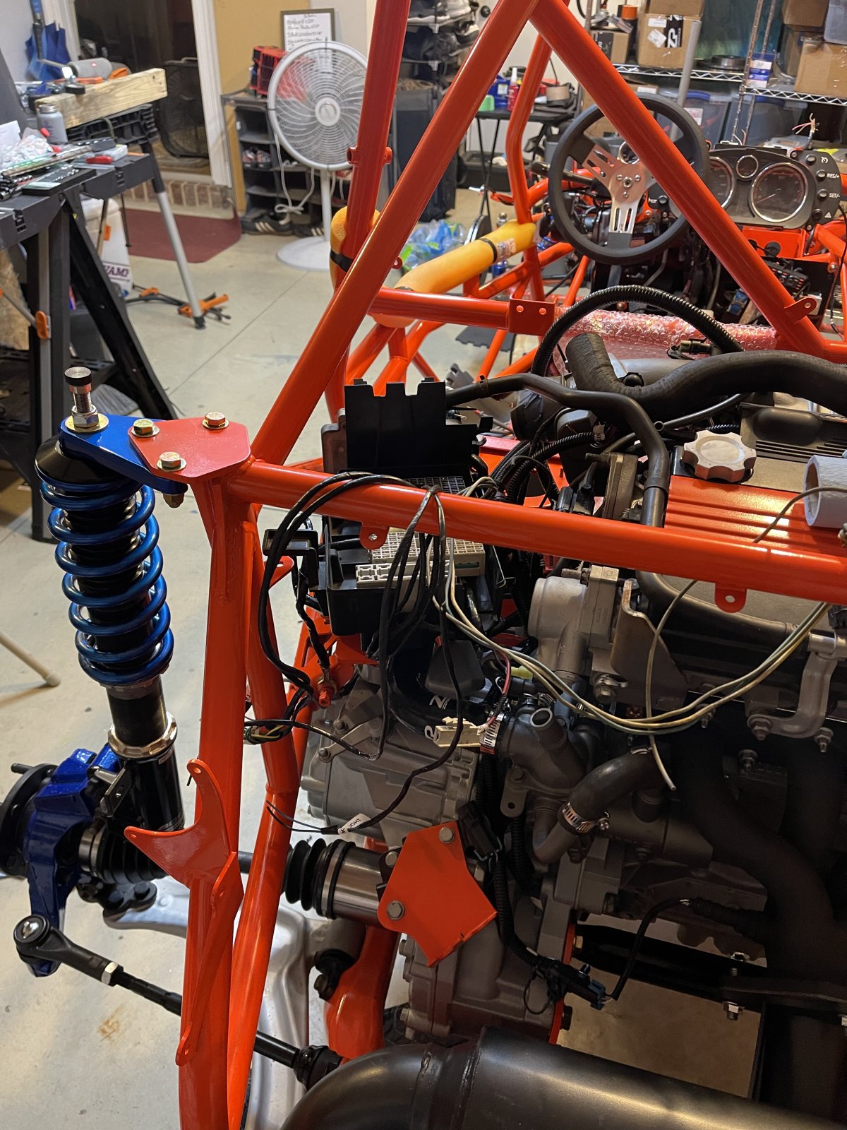

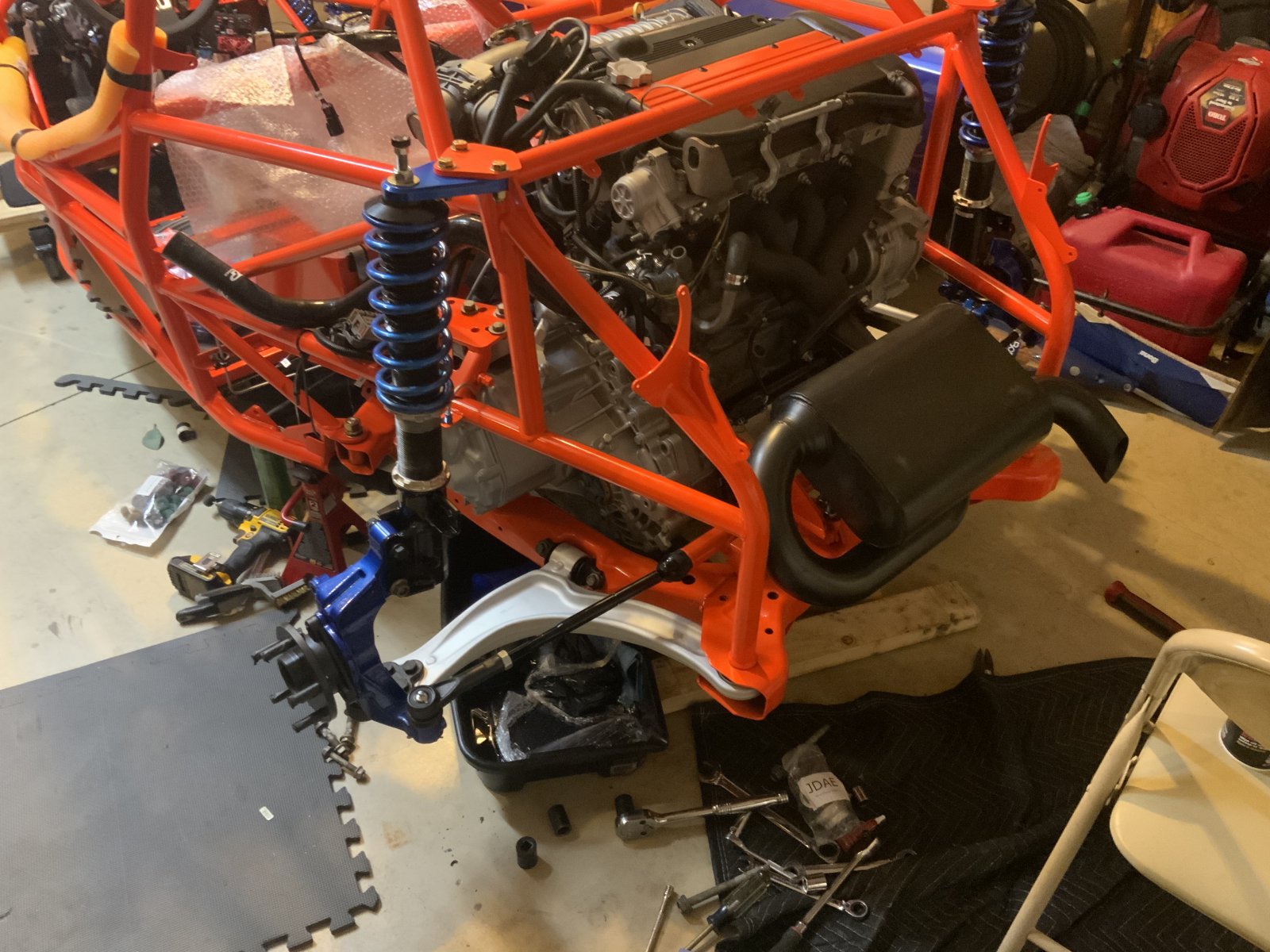

Assembly Day - 5

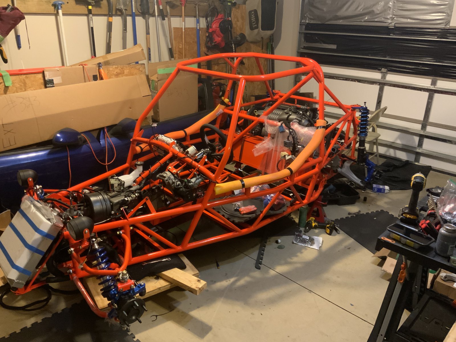

Subframe mostly installed, solid transmission mounts installed, rear coil overs, tow link and knuckles installed. Just need to torque everything down. She’s really starting to look like something. Goal is to get the first start this weekend.

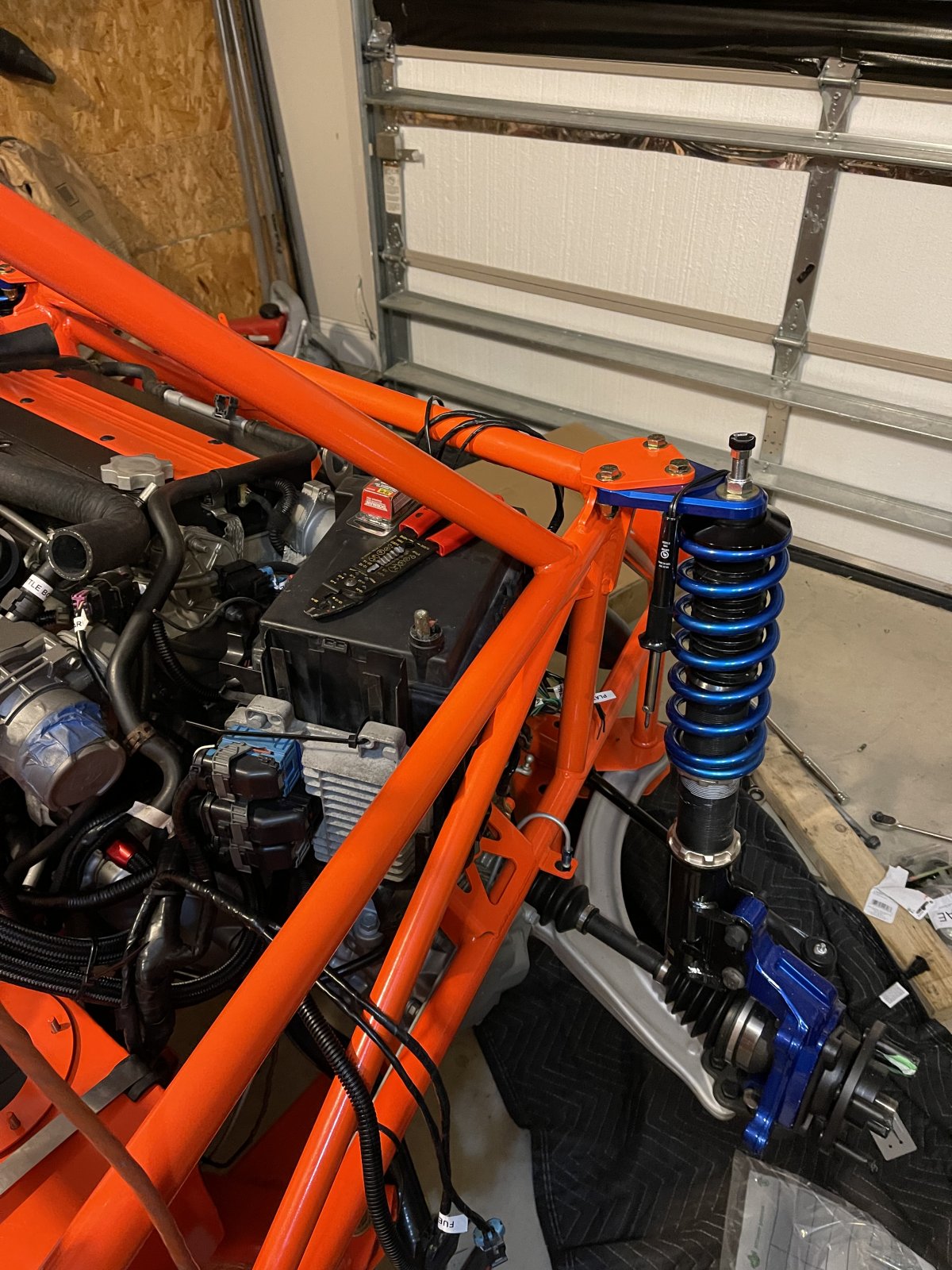

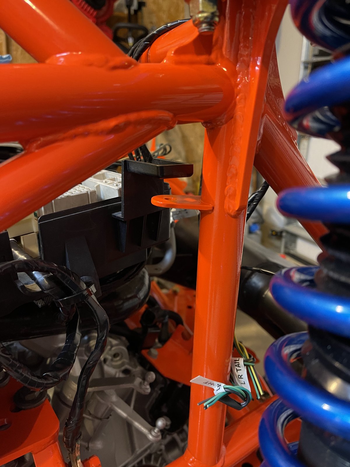

jayrolls
Assembly Day -6

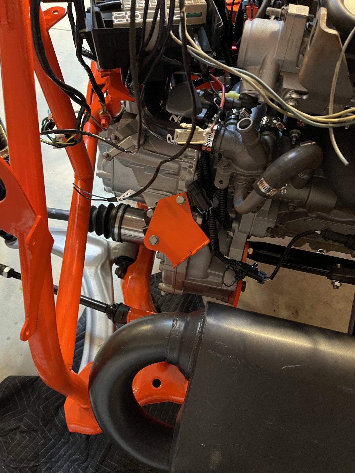

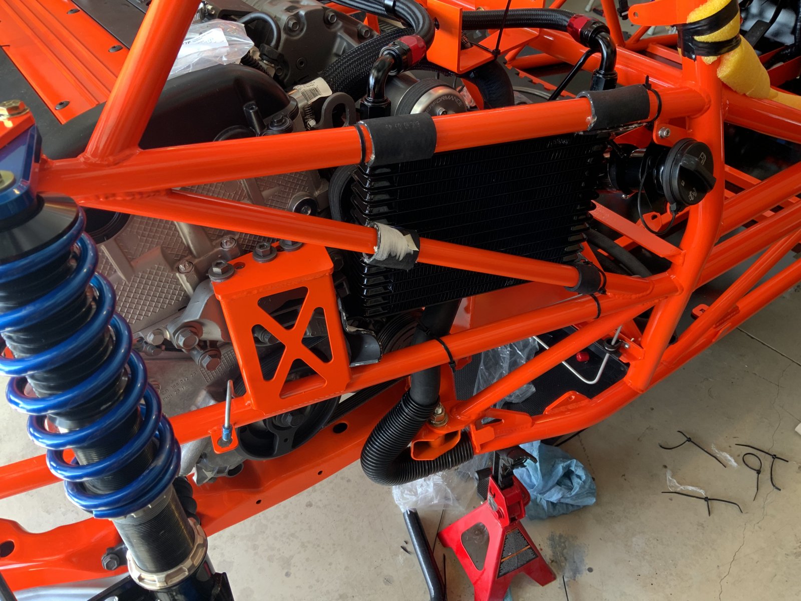

Grounds are connected. Shift cable bracket installed. Fuse box loosely stalled. It appears my frame has a tab welded in for the upper fuse block mounting point. My hardware bag still had the coated clamp and the 90 degree bracket. I’m assuming that is no longer required. It does look like I need a spacer. Drive axles installed. Oil cooler loosely installed. Lines are ran, topped off the oil cooler with oil. Main power cable from battery to starter installed and from starter to fuse box ran.

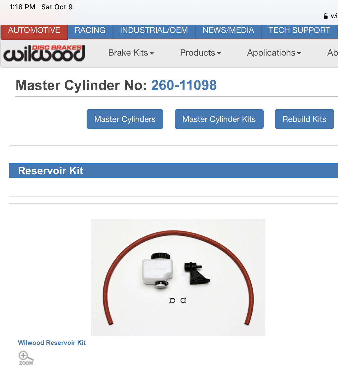

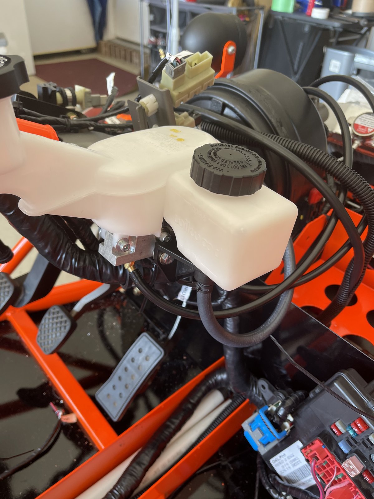

Didn't like the mounting options on the first remote clutch reservoir that I tried. Order a different one from Wilwood and am much happier With the mounting. It’s knowing I was going to run a remote clutch reservoir I ordered a new brake reservoir from an automatic. its slow going so far today, just too hot in the garage at the moment. Hopefully more to follow today.

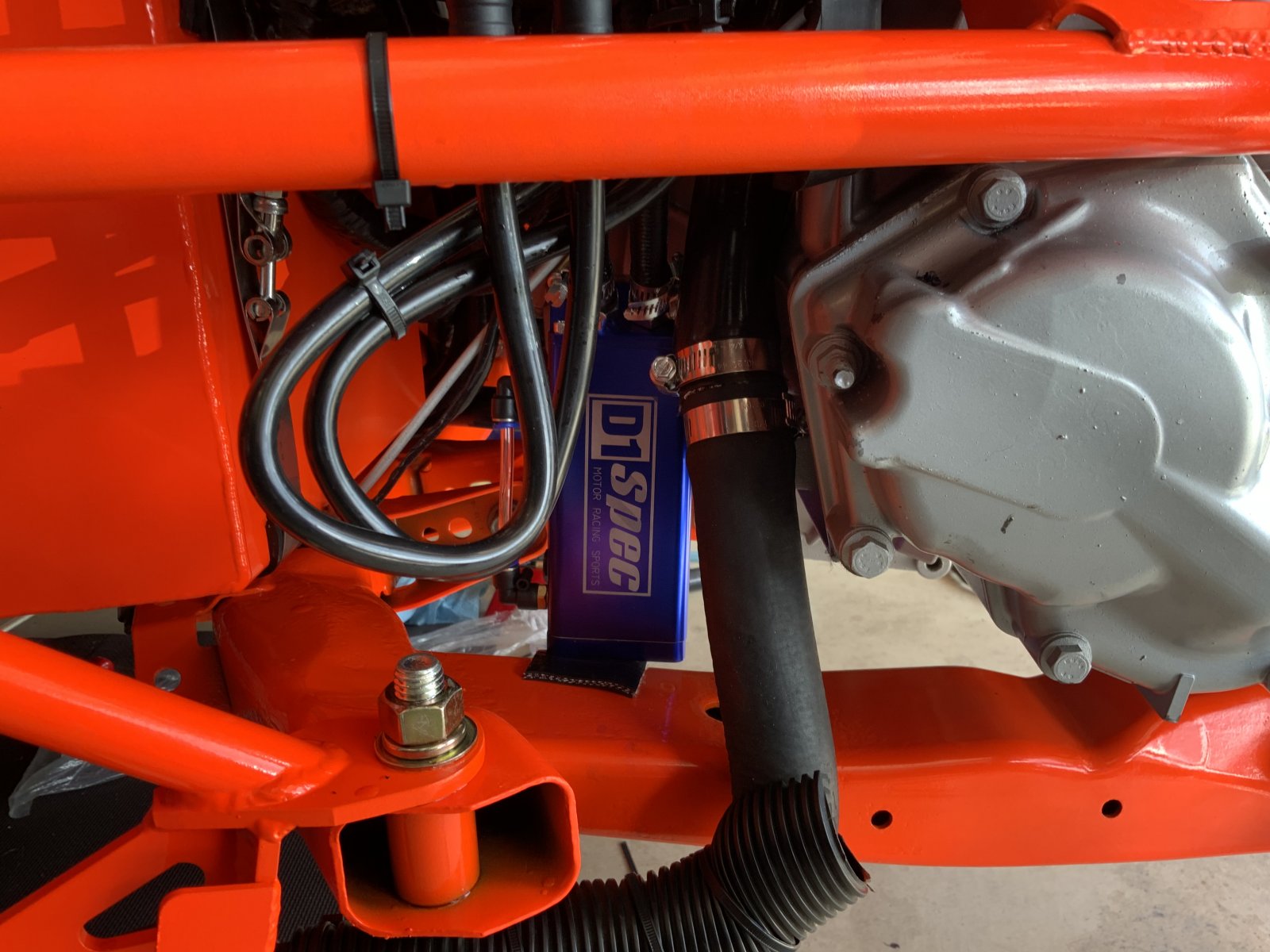

Officially have all the coolant lines run and topped off with Dexcool. Got all of the supercharge coolant lines installed as well. Ran into my first real problem. The heat exchanger fan does not turn on. With key on, verified 11.6 VDC on the wires going to the heat exchanger fan. The fan just does not turn on. Gonna have to email about it. Installed an oil catch can. Had to get creative with where to put it. Installed lower front of the engine, attached to the transmission. Will still be able to see the sight gage, so I think it will work. I am officially ready to start the motor. Just waiting for the wife to get home. Want her to video the first start.
