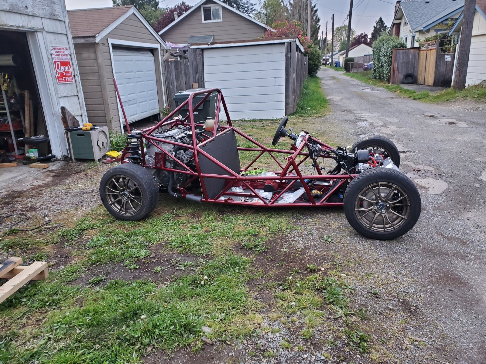

Boy I may get a ride in a Goblin by the end of a week end as long as I didn't mess up the wiring harness

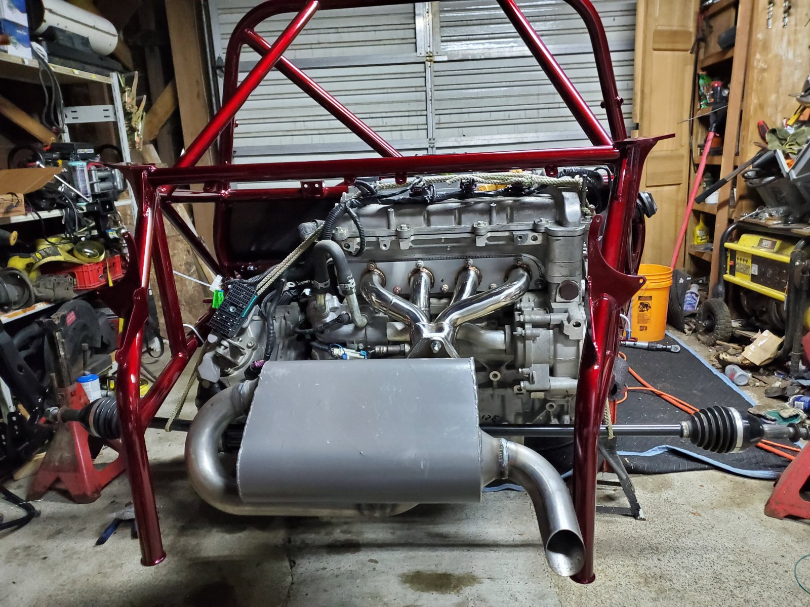

I am in high Hope's that it will last another 5000 or so miles as I want to do some tranny mods and up grade clutch and do the timing set next winter. I found out tonight just how easy it will be to remove the engine compared to the donor.
While on that topic I would love to say HATS off to Lonny and Adam every one of the steel lines went right into place no bending nothing. Clutch line looked as if it was out in the middle of nowhere but when I rolled the engine in the line almost ran itself into the clutch slave. The vids on the wiring are good as well so far if I would have followed to the letter would have been spot on. I just added a few inches to make sure I would not be short now I have extra LOL. Engine bolted straight in. My wife gave me a hand putting the engine in and could not believe how easy it went in. With in a few minutes we was standing there admiring how nice it looked and I was making varoom sounds. So I will say a top notch kit

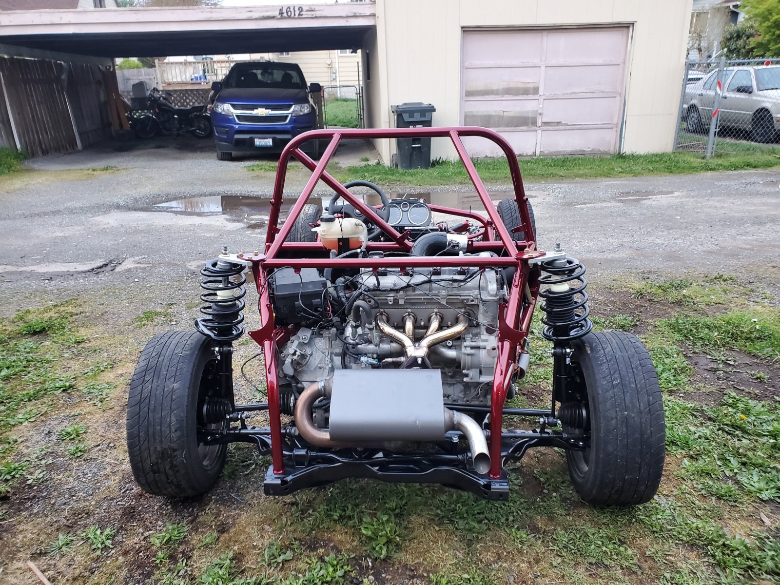

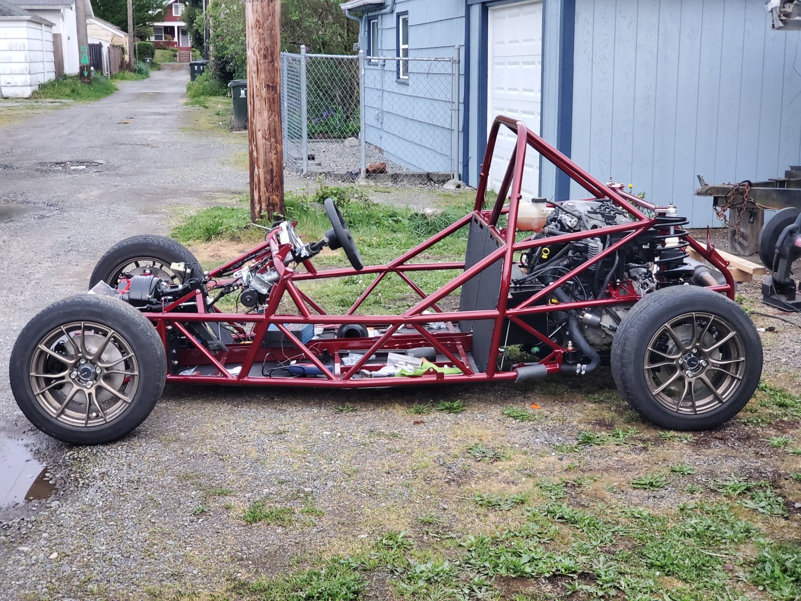

Well if all goes well I might get the first test drive tomorrow. Then spend the week tiding up things. It's nice if you can have most of the donor parts prepped. It goes together nice.
