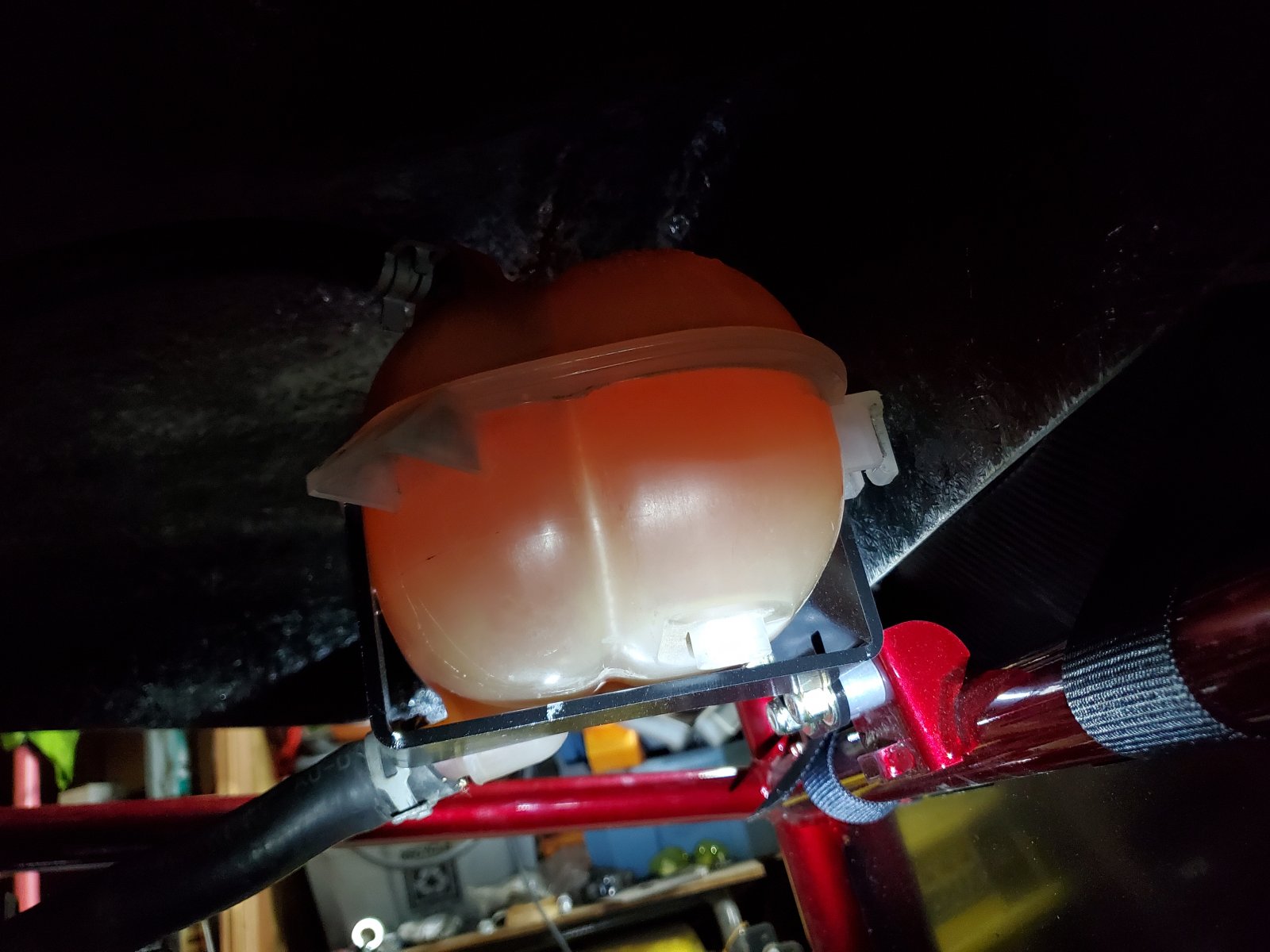

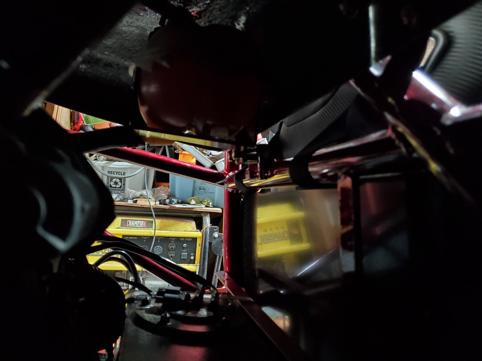

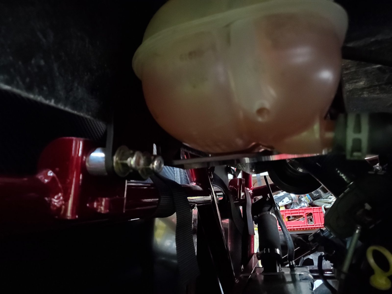

I do not know if these will help as I have the engine cover bolted on and can only take photo from underneath
The first is taken from drivers side the second is from passengers side.
Use two bolts to mount to the mount behind the drivers seat in engine compartment mount so that it cradles the tank the spring goes over it to hold it in place. It sits higher than the old clip style so is easier to burp
