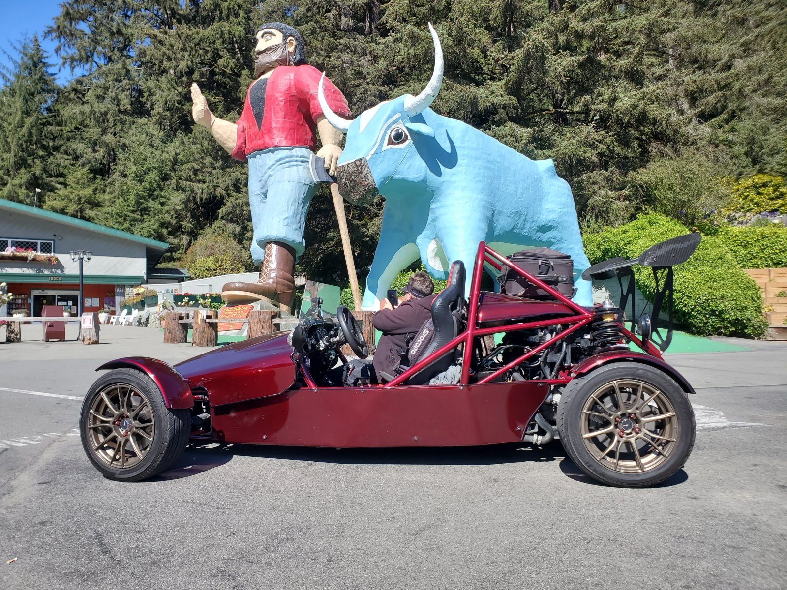

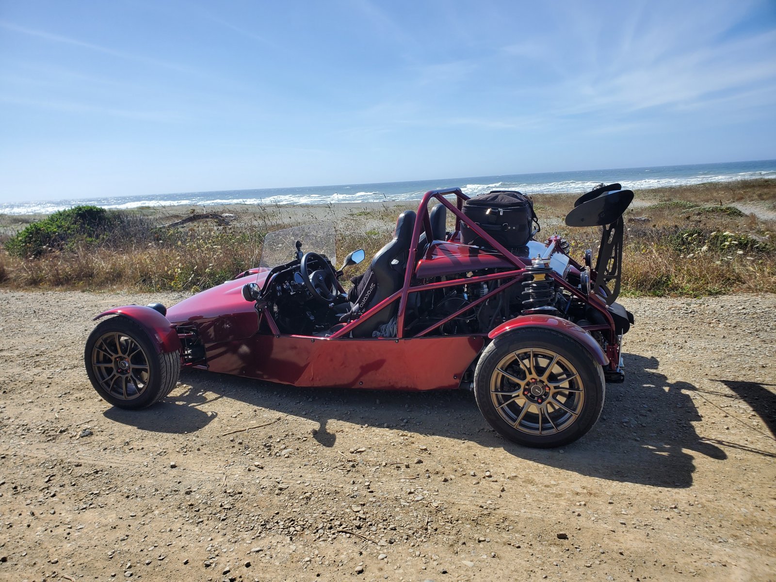

So here we are we made it up to Newport Oregon. Running 101 along the coast is so great we are now wishing that we had a couple degrees of heat that we had on the first few days but it is so great.
